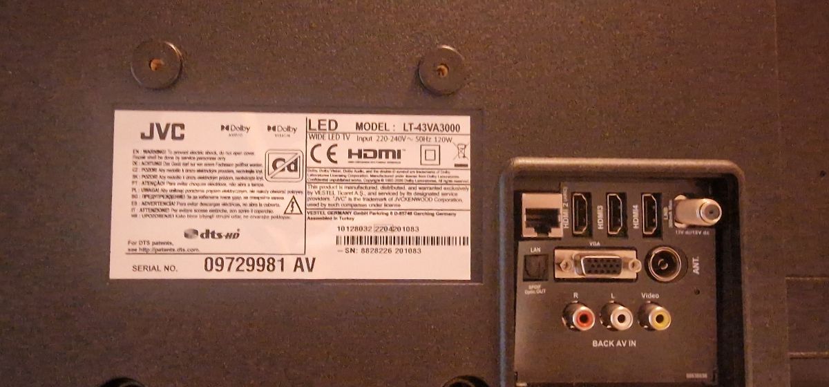

    post a photo of the sticker on the back of the tv: product code and serial number required
  • #10 21892903
    Elenabian21
    Posts: 10
    Adjunto foto
    JVC LT-43VA3000 17MB170 VES430QNDC-2D-N41 firmware for black screen?

    billobirillo
    Posts: 1141
    Help: 338
    Rate: 798
    main 17MB170, panel VES430QNDC-2D-N41, tcon V430DJ1-Q01
    nothing in my database, sorry
