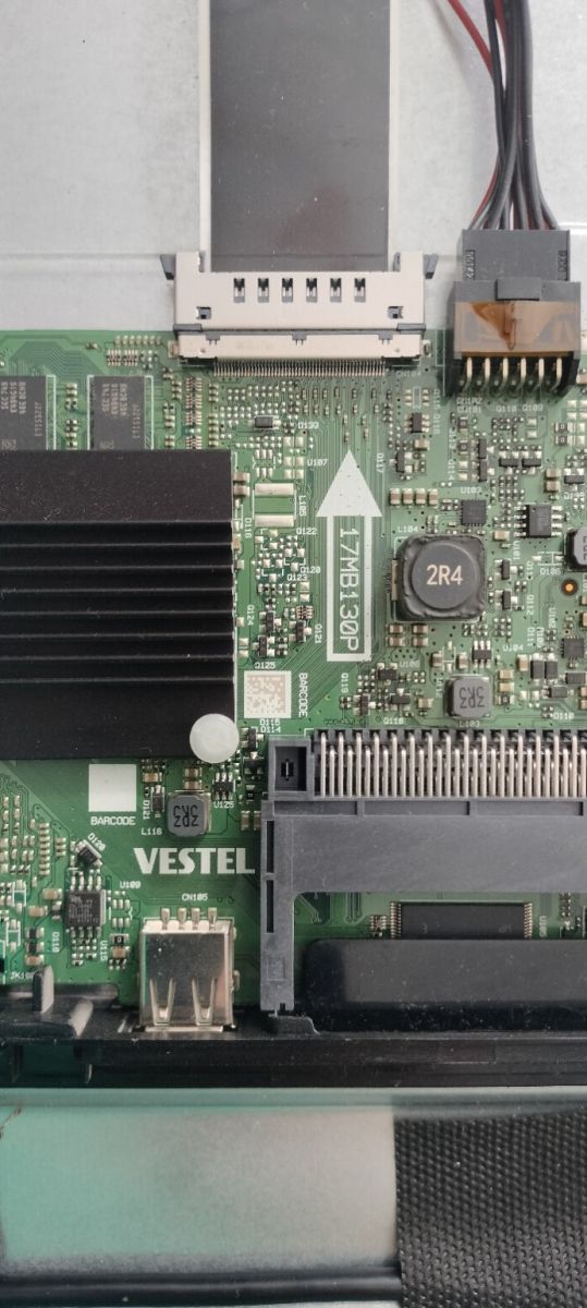

    I am looking for the correct USB recovery firmware for:
    Brand: JVC
    Model: LT-55VU850
    Mainboard: 17MB130P
    PSU: 17IPS72
    Panel: VES550QNDL-2D-U11
    History:
    I received this TV already in faulty condition. It was most likely flashed with an incorrect firmware before I got it.
    Original symptoms:
    TV powered on.
    Bright JVC logo appeared during startup.
    TV never completed booting.
    No menu and no normal operation after the logo.
    I suspected corrupted firmware and unfortunately flashed a firmware package intended for:
    17MB130S
    VES490QNDL-2D-N11
    Telefunken
    After that the situation became worse.
    Current symptoms:
    No JVC logo anymore.
    Short startup beep.
    Screen briefly changes dark/blue shades during power-on.
    Backlight activity is visible.
    TV does not boot and does not react to remote commands.
    Only power ON/OFF works.
    When connected to a Windows PC, the computer detects the TV as a display ("55UHD_LCD_TV", 1920x1080 @ 60Hz). Windows plays the normal monitor connect/disconnect sound when the TV is connected or disconnected. However, the TV screen itself remains dark and does not show the PC image.
    Additional observation:
    A FAT32 USB stick with a recovery trigger file causes the front red LED to start blinking, which suggests that the bootloader may still be alive and attempting USB recovery.
    Could someone please provide:
    Correct USB recovery firmware for JVC LT-55VU850 / 17MB130P / VES550QNDL-2D-U11.
    Recovery package files (USB_AUTO_UPDATE, MB130 files, etc.).
    Full dump (SPI/NAND/eMMC) if USB recovery is not sufficient.
    Thank you.

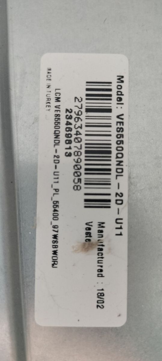

    Close-up of a Vestel PCB with heatsink, ribbon connectors, and marking 17MB130P

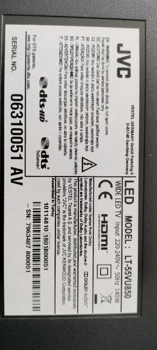

    Back label of a JVC LED TV, model LT-55VU850, showing serial numbers and CE/HDMI markings

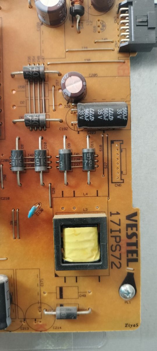

    Close-up of a VESTEL 17IPS72 power supply PCB with capacitors, diodes, and a transformer
    Label with barcodes on a metal surface, showing model VE6560QNDL-2D-U11

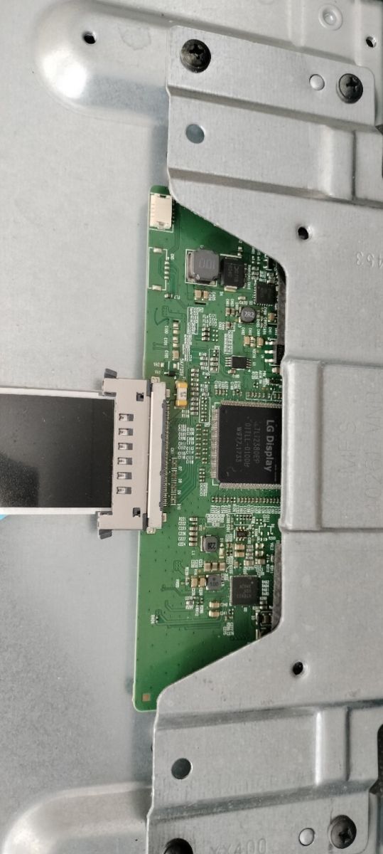

    Close-up of a Vestel PCB with a heatsink, ribbon connectors, and wires.
    Printed circuit board with chips and a flat ribbon cable mounted on a metal housing.
    Can you post the full sticker/barcode info from the main board and TV rear label (all Vestel/JVC numbers, serial, and any 17MB130S suffix/revision)?
