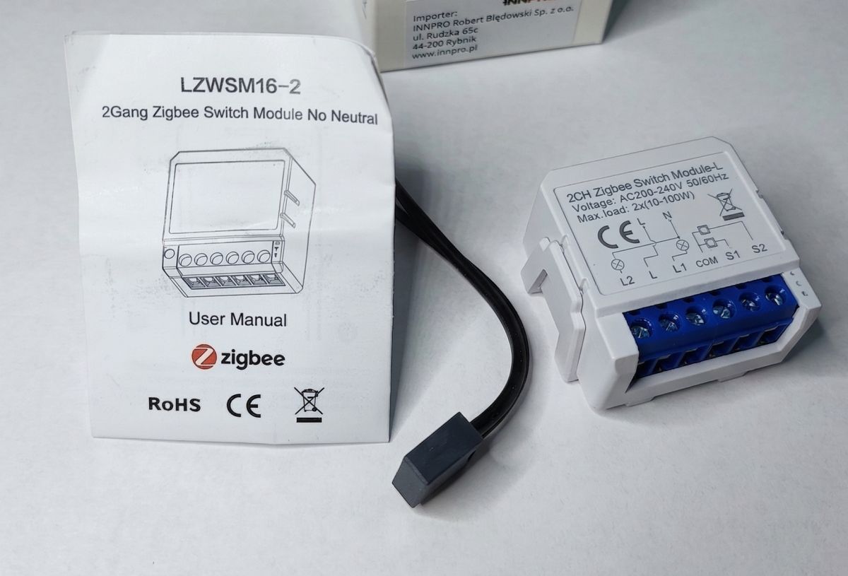

    I bought the LZWSM16-2 for £65 from the Polish importer. The LZWSM16-2 is characterised by its small size, only 39x39x19 mm. The device has two channels, can control two devices and allows two buttons to be connected. It supports a load of up to 200 watts.

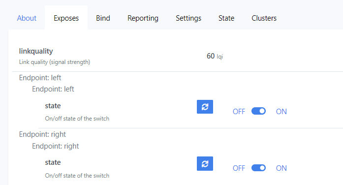

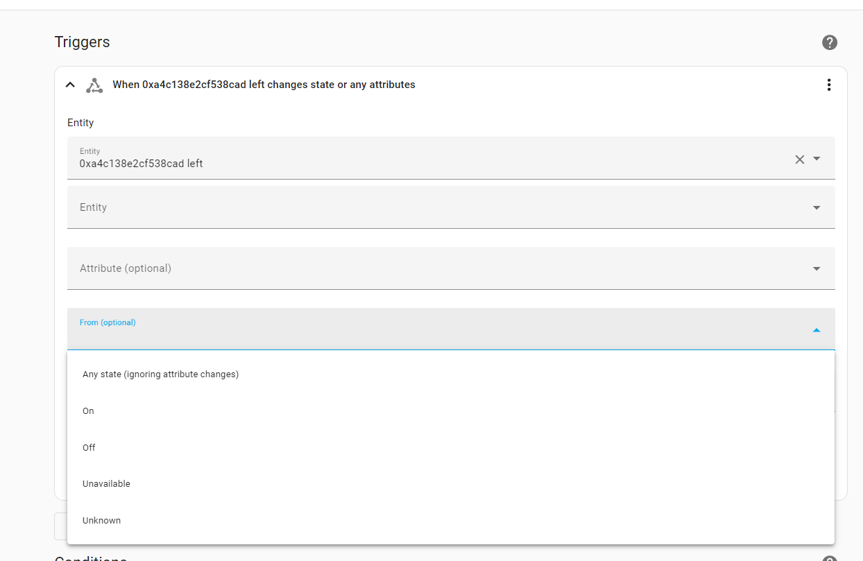

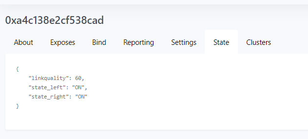

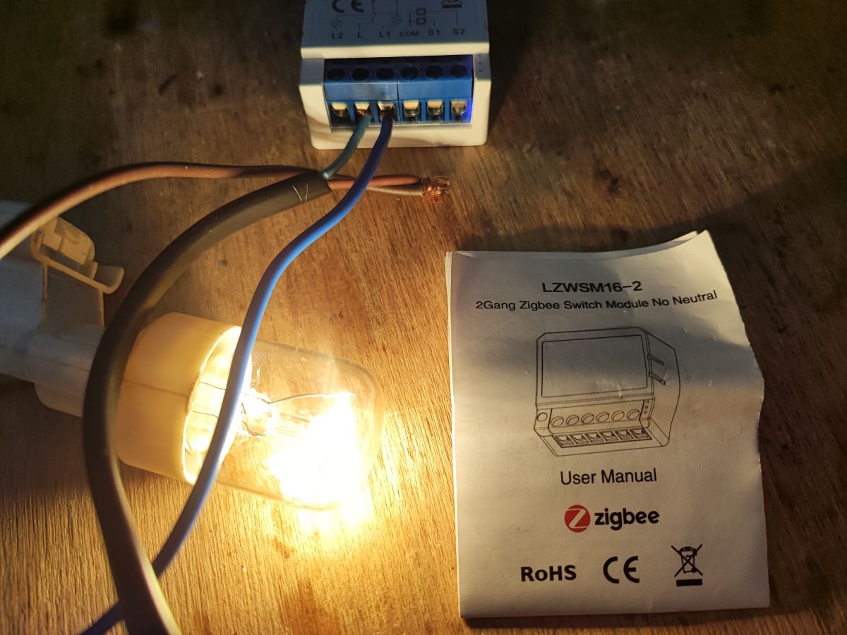

    The device normally works with the Tuya cloud, but I tested it with Home Assistant via Zigbee2MQTT and CC2531. It is seen as TS0012, but oddly enough, HA suggests it is powered by a battery.
    Which silent lighting controller on Zigbee? Two-channel LZWSM16-2 without neutral wire Which silent lighting controller on Zigbee? Two-channel LZWSM16-2 without neutral wire Which silent lighting controller on Zigbee? Two-channel LZWSM16-2 without neutral wire
    However, this does not affect its performance. The whole thing is indeed noiseless and can cope with a connected bulb. I tested the whole thing quickly on a table before plugging it in, forgive the cottage industry aspect of the experiment.

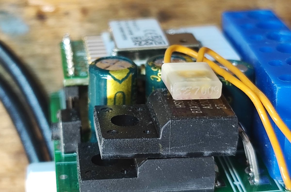

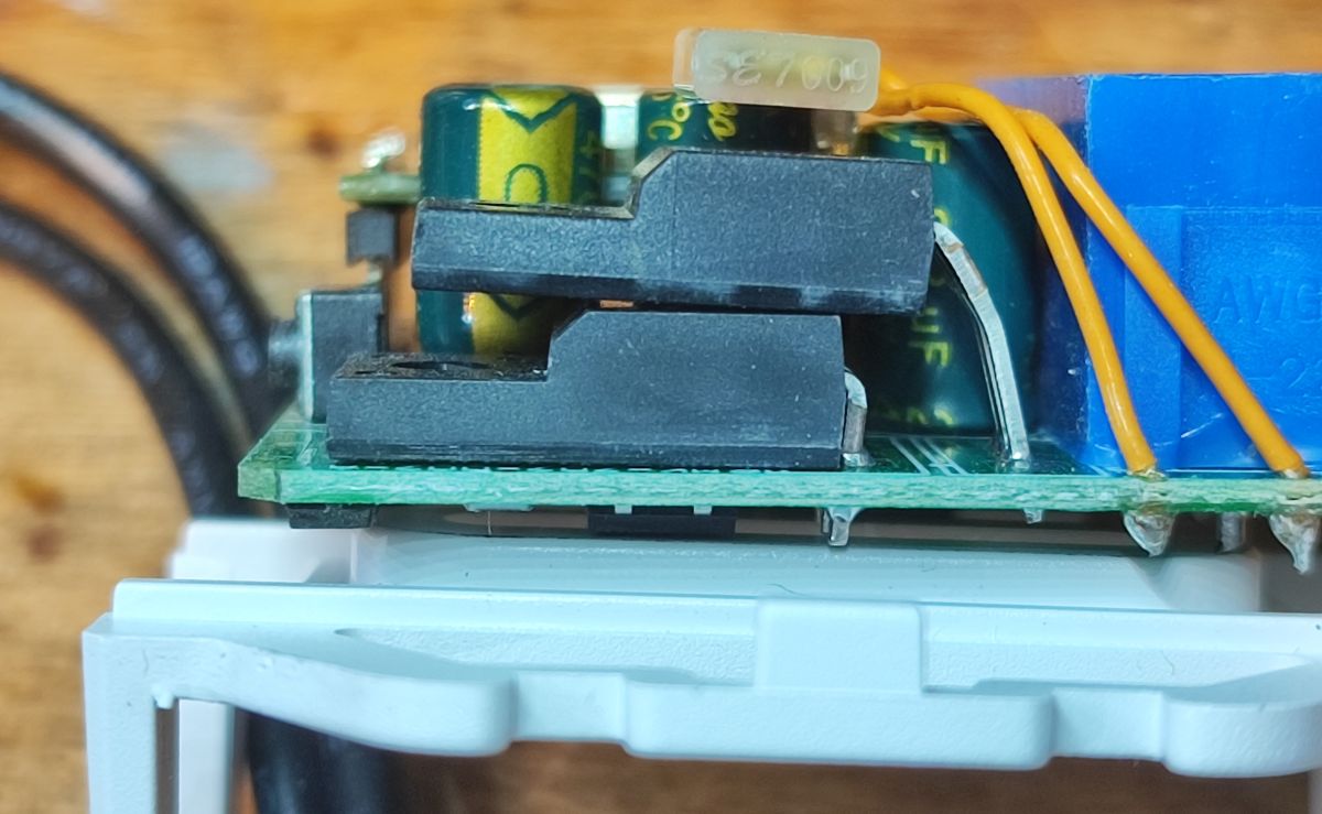

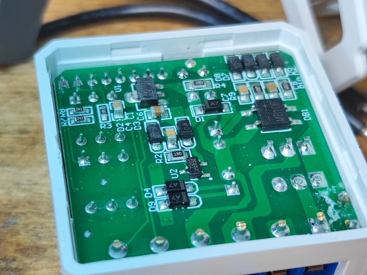

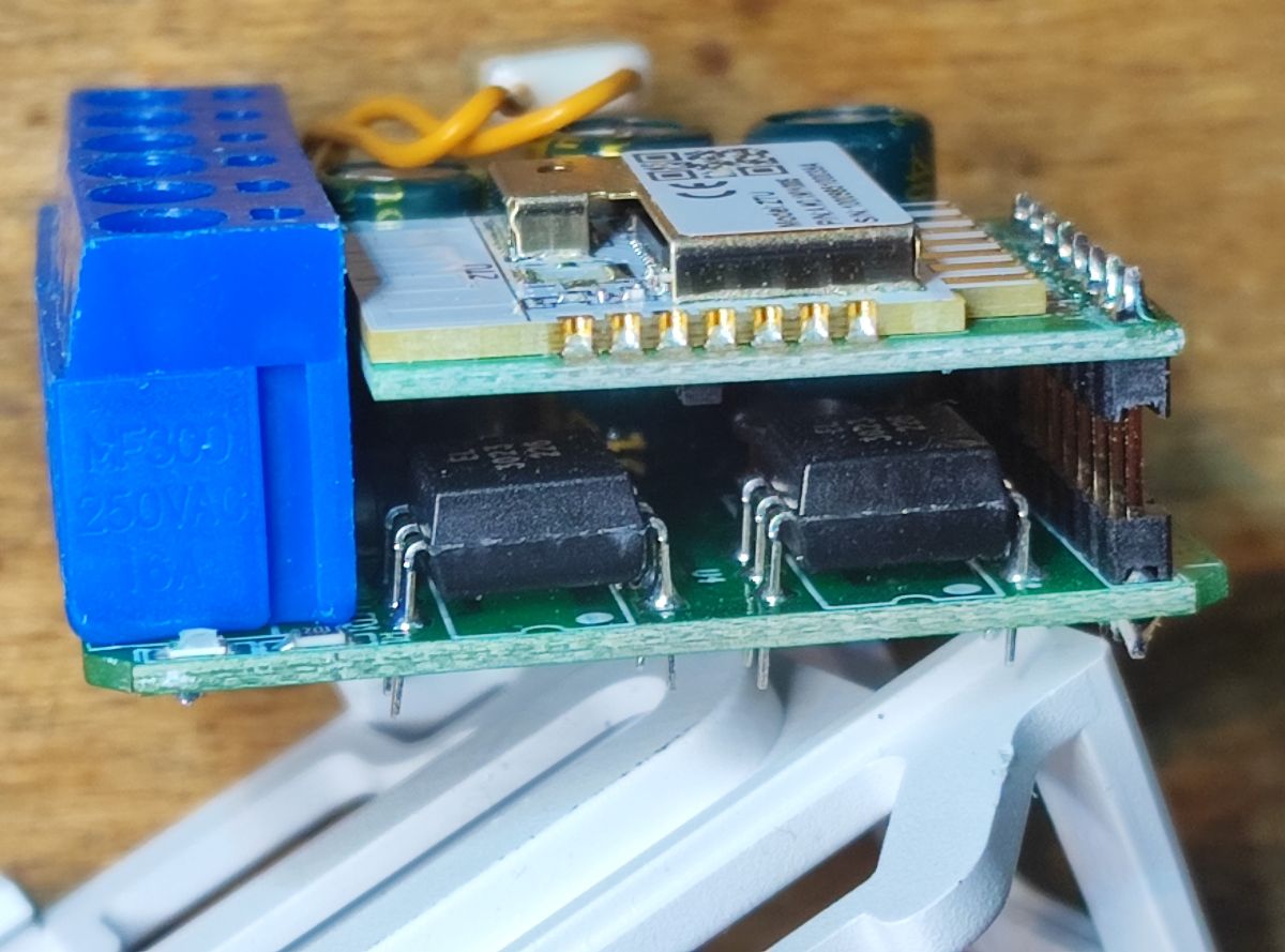

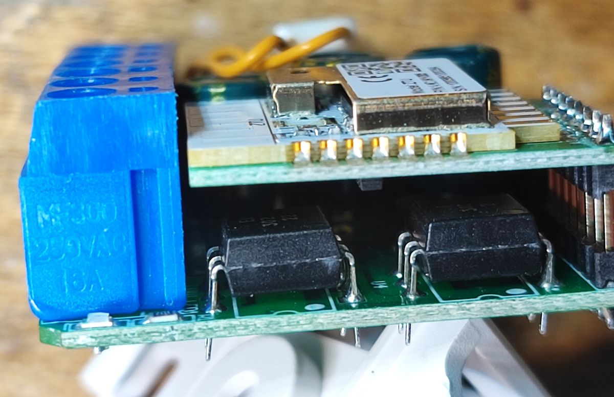

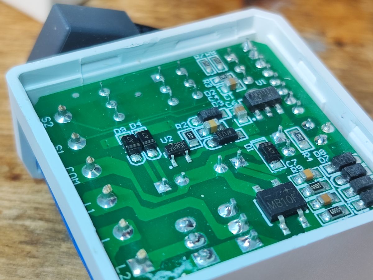

    This is where it could end, but I still wanted to look inside.
    First we see the rectifier bridge, additional rectifier diodes (from the mode without neutral wire?) and the LDO AMS1117. The traces of moisture inside are a bit worrying.

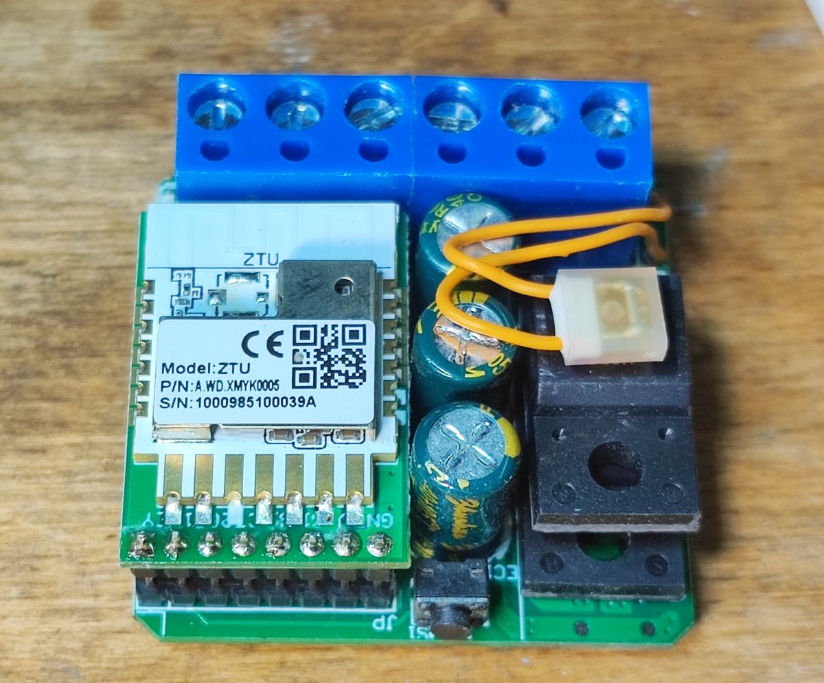

    After removing the whole thing from the case, you can see how everything has been nicely packed by the manufacturer. The communication module is a ZTU from Tuya. Next to it we have capacitors and two BTA16-600BW triacs. These triacs replace the relays. In addition, we have thermal protection.

    Device page according to my HA:
    https://www.zigbee2mqtt.io/devices/TS0012.html#tuya-ts0012
    Potentially a more fitting site (they may have updated the listing after I tested):
    https://www.zigbee2mqtt.io/devices/LZWSM16-2.html
    I recommend an update, because according to the LZWSM16-2 profile there are additional entities, allowing, among other things, to specify the type of connected button.

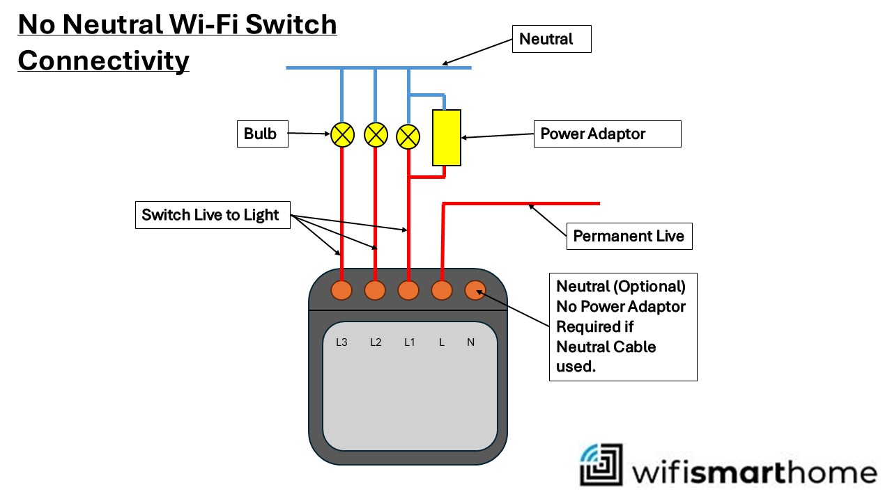

    At my place, the relays on the smart switch are genuinely louder than when switching the lights with the classic switch.
    The LEDs are then connected to what is colloquially known as an "adapter", i.e. a capacitor. It is even shown in the first title picture.
    You can also see it in the instructions. Clearer graphics:
    Wiring diagram for a no-neutral Wi‑Fi switch with a power adaptor connected near the bulbs

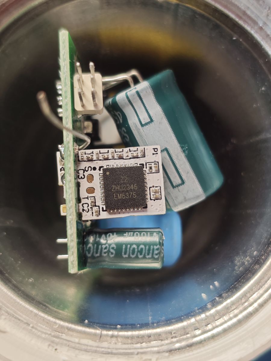

    was there a boot log to be captured from the module? Maybe UART_TX - B1.
    Did you manage to dump firmware from the Z2/TLSR8258?
    I've a Z2 in a Moes bulb that I've not got round to scoping out yet.
