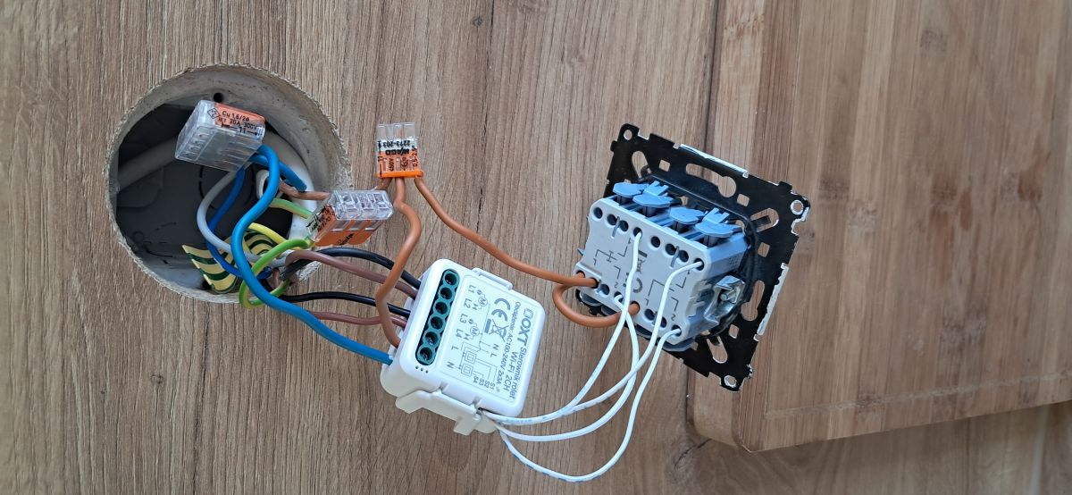

    I have a problem with a double roller shutter controller I connect it seemingly displays in the app, but when I click the button it burns the controller.
    What is wrong?

    Hi
    It looks like you have connected the phase wire "L" to this control button and according to the diagram on the housing you should connect the neutral wire "N" blue
    Greetings
    Peter

    As far as the driver is concerned, I think it's fine from left neutral, then L.

    On the control unit it is fine, but to this wall button there is a brown L and there should be a blue N

    So where it says L on the wall button, I should connect N and it should work?

    Exactly like this
    will work if you have the roller shutter motors connected correctly - you can't see that in this picture

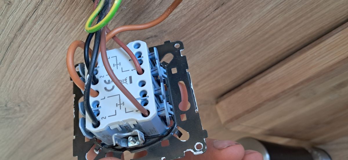

    Without the controller, everything on the button worked fine with a connection like the one in the photo
    Close-up of a light switch mechanism wiring with brown, black, and yellow-green wires on a metal frame
    i have ordered a new controller, it will come on Wednesday and I will see, but strangely I have to connect N to L I do not understand but I will check

    This direct connection (without controller) is correct
    but with the controller it is different - you have to connect exactly according to the diagram on the housing - now you have the wrong one
    The key inputs on the controller must be connected to neutral N and not to phase L

    @melon2 aptly diagnosed - I just want to add why this specifically burned the controller, because from what you write you don't quite understand the logic, and before Wednesday and a new unit it's worth catching on.
    Tuya roller shutter controllers (and similar - Sonoff, MOES) have opto-isolated low-voltage gates on the key inputs (S1, S2). In the internal schematic, the manufacturer connects them to N (reference potential ≈ 0 V) and expects the physical key to short-circuit this potential to the input via the key. So the logic goes like this: the key on the wall has one terminal connected to N from the box, the other to S1 or S2 of the controller. You press the key - it short-circuits N with S1 - the optoisolator sees "0" - the module knows there is a click.
    What has happened in your case: instead of N you have fed L (230 V phase) to the S1/S2 input. The optoisolator has no such isolation - it typically withstands 20-60 V between inputs. At 230 volts, the input capacitor or Zener diode breaks through immediately, carbon trace on the PCB, controller smokes. Burned out, to the rubbish.
    It worked for you before without the controller, because then the key directly fed L to the roller shutter motor - roller shutter motors are normally controlled by 230 V AC, phase. With a controller in between the logic is reversed: the keys are a low-voltage input, not a direct motor switch.

    SyncLeadWafer
    Posts: 6
    Thanks for your help. The new sensor has arrived and everything is running smoothly.
