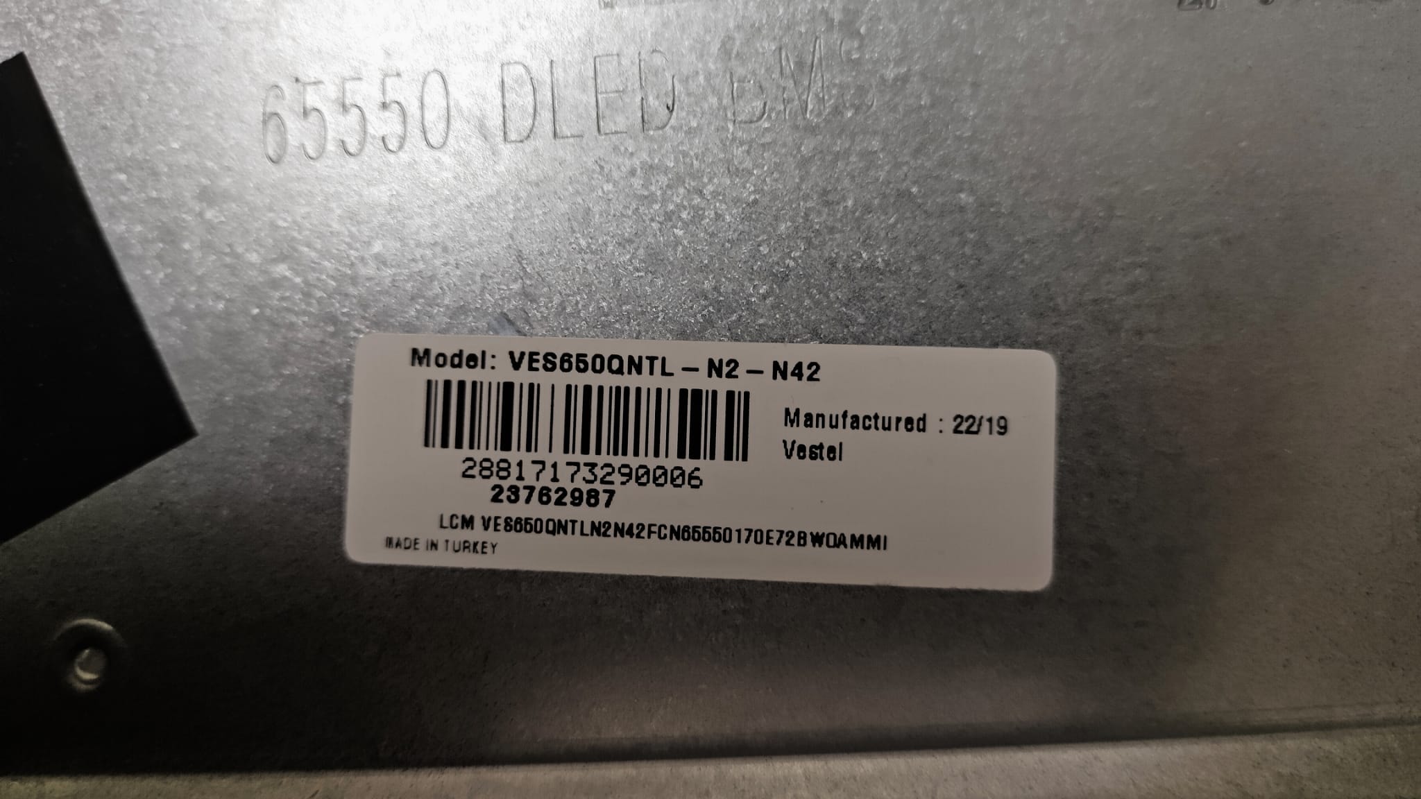

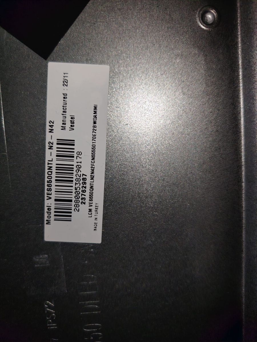

    Ciao tutti, sto cercando il firmware per la TV Hitachi mod. 65HAK5353 con mainbord 17MB170E n°28800538290178 serie VES660ONTLN2N42FCN65550170E72BWOA MMI
    Barcode label on a metal casing, model VE65600NTL-N2-N42 Hitachi product label with technical and warning text on a black textured device casing
    Ringrazio anticipatamente, grazie mille per l'aiuto.
    Che difetto fa esattamente la TV e per quale motivo ti serve il firmware (bloccata sul logo, non si accende, riavvii, schermo capovolto, nessun canale, ecc.)?
    Ha la memoria piena, è entrata nel ciclo di riavvio continuo e non funziona la TV, solo Netfix.

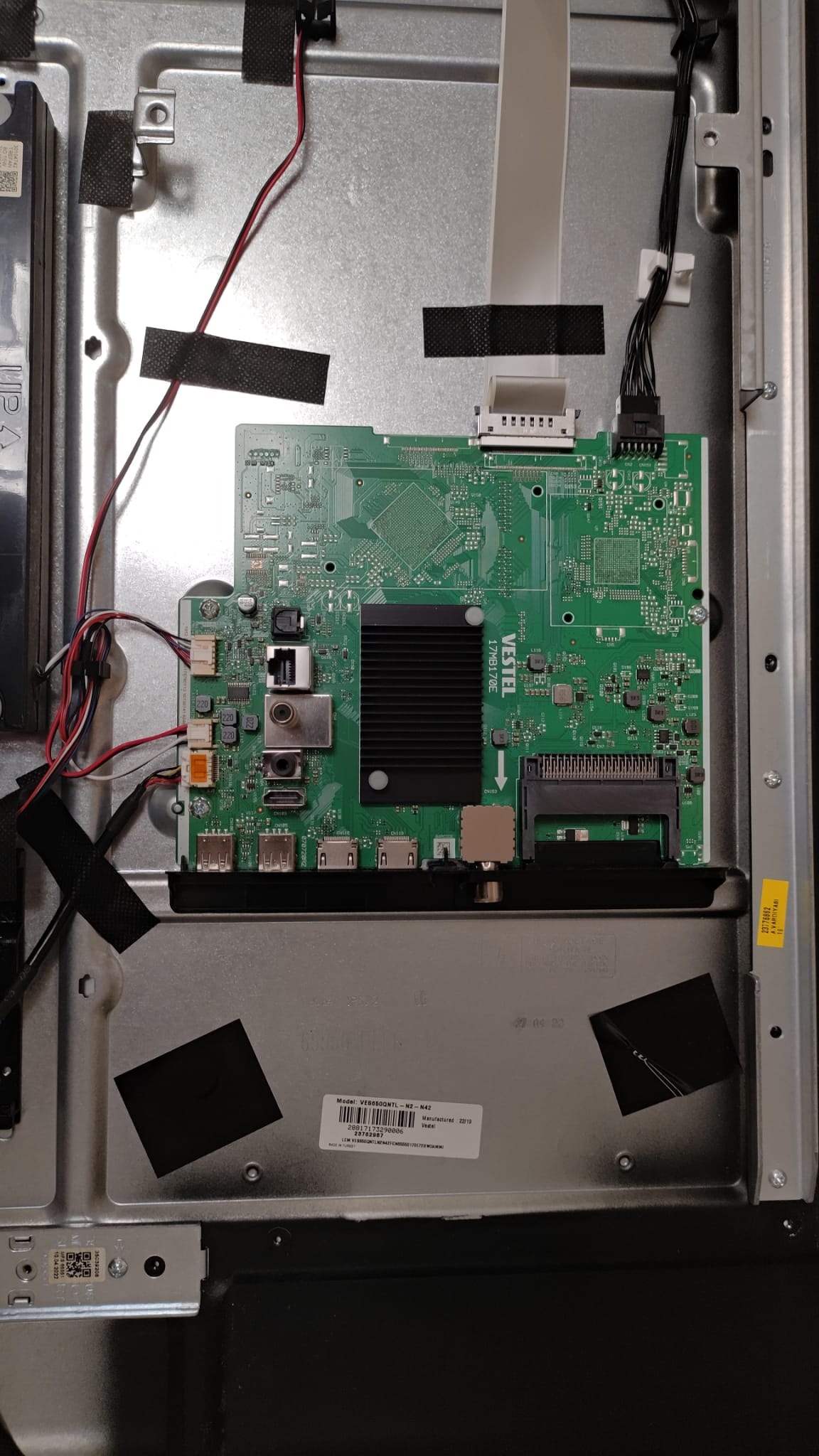

    model HITACHI 65HAK5353 10136741
    main 17MB170E, panel VES650QNTL-N2-N42, tcon LG 2D LC650EQQ-SMA3
    here is the software you need link
  • #3 21912509
    Radyboy
    Posts: 7

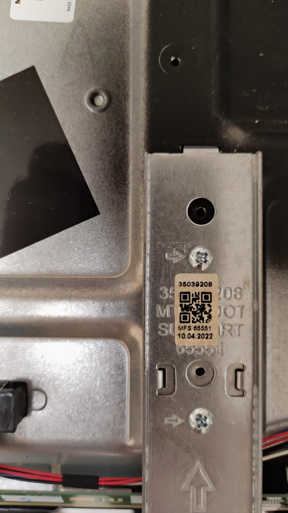

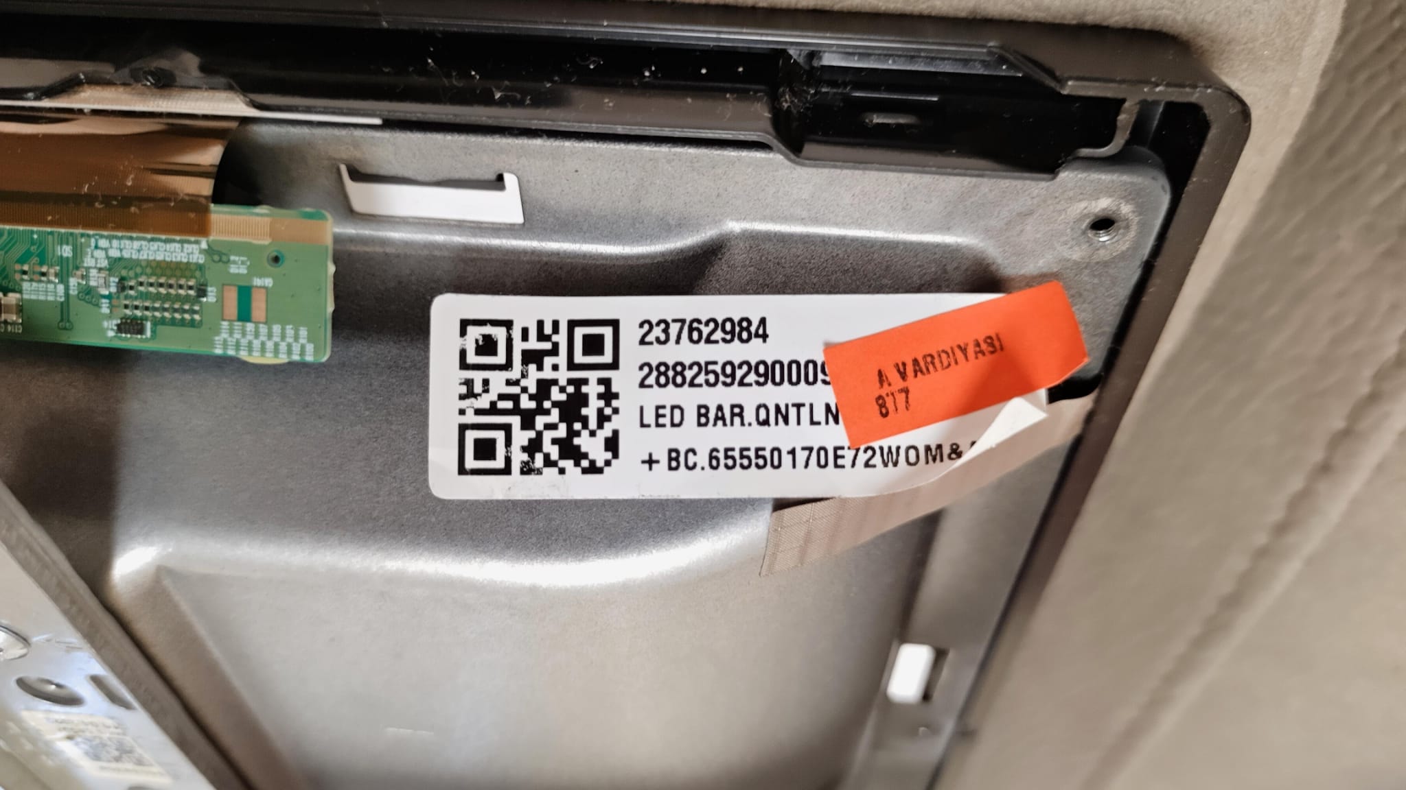

    Ciao, ho smontato la tv.
    Carico le foto per i dettagli, cosi da avere conferma di poter caricare il firmware che hai allegato @billobirillo
    • Firmware Hitachi 65HAK5353, 17MB170E: bootloop continuo memoria piena 44444.jpeg (179.62 KB) You must be logged in to download this attachment.
    • Firmware Hitachi 65HAK5353, 17MB170E: bootloop continuo memoria piena 22222.jpeg (247.85 KB) You must be logged in to download this attachment.
    • Firmware Hitachi 65HAK5353, 17MB170E: bootloop continuo memoria piena 3333.jpeg (211.39 KB) You must be logged in to download this attachment.
    • Firmware Hitachi 65HAK5353, 17MB170E: bootloop continuo memoria piena 1111.jpeg (189.73 KB) You must be logged in to download this attachment.
  • #4 21913392
    Radyboy
    Posts: 7
    @billobirillo fixed thanks!!!

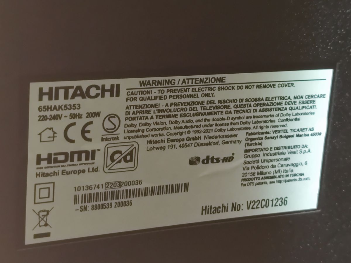

  • #6 21924010
    doomgrave
    @billobirillo hi.
    Please can you reshare?
    Same Tv, same problem, cannot boot it up, it freezes.
    Do you know also how to reach the recovery menu?
    Ps Hi from Italy!
    Rating label of a Hitachi TV with warning text and logos including HDMI and dtsHD.
  • #8 21924726
    doomgrave
    Ty!!! Testing right now
