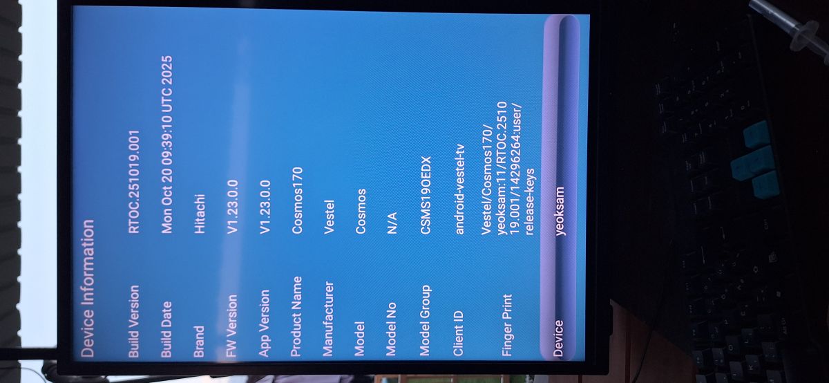

    Hello. I need a full recovery firmware for my Hitachi 50HAK5350 TV 17MB170E VES500QNDT-2D-N41. Can anybody help me?
    “Device Information” screen showing device details: Hitachi, Cosmos, Android TV, and version numbers
    What is the problem with the TV now — stuck on logo, bootloop, no standby, black screen, or failed update?
    Bootloop and I think this is for a failed update. Recovery mode not helped.
    Can you provide the full label information from the back cover/mainboard, including serial number, chassis/version, and current software version if available?

    I try it several times, but the TV turns off and on at random times. That's why I try to make a force firmware update because it is my last chance before I change the main board. If anyone has got the correct firmware, please send me the link.

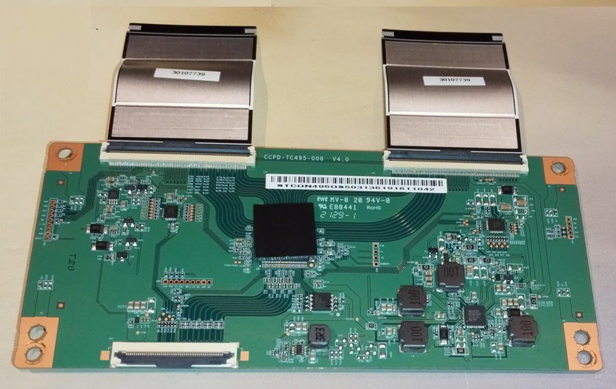

    can you post a photo of the tcon module?

    It used to be available on (eBay)
    HITACHI 50HAK5350
    MPN: CCPD-TC495-008 V4.0 T-CON
    Hitachi 50HAK5350 17MB170E - bootloop after failed update, full recovery firmware?
    * and the T‑CON Board V500DK1‑CKS1 Hitachi 50HAK5350

    I have got this firmware but will the remote controller work too? The firmware is for Daewoo TV and mine is Hitachi. VES500QNDT-2D-N41 is my TV screen main and the firmware has got VES500QNDH-N2-N45. Is this compatible?

    Hello. I’ve updated the firmware and so far everything is working, including the remote control.

    Now the only question is how to change the boot logo, because this firmware is for Daewoo and mine is a Hitachi. Does anyone have any idea how to change it?
