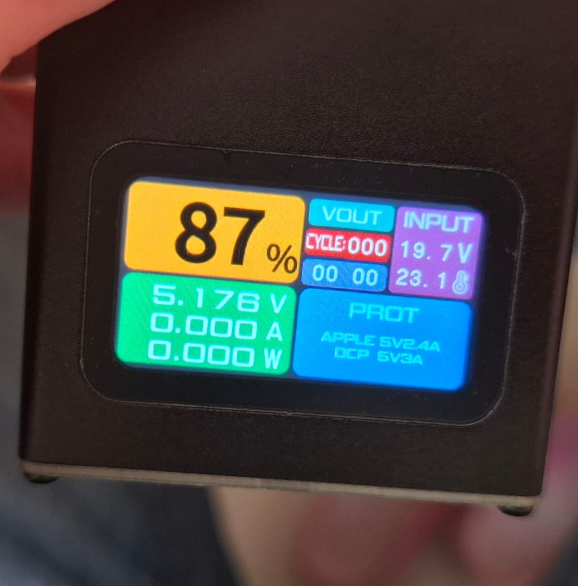

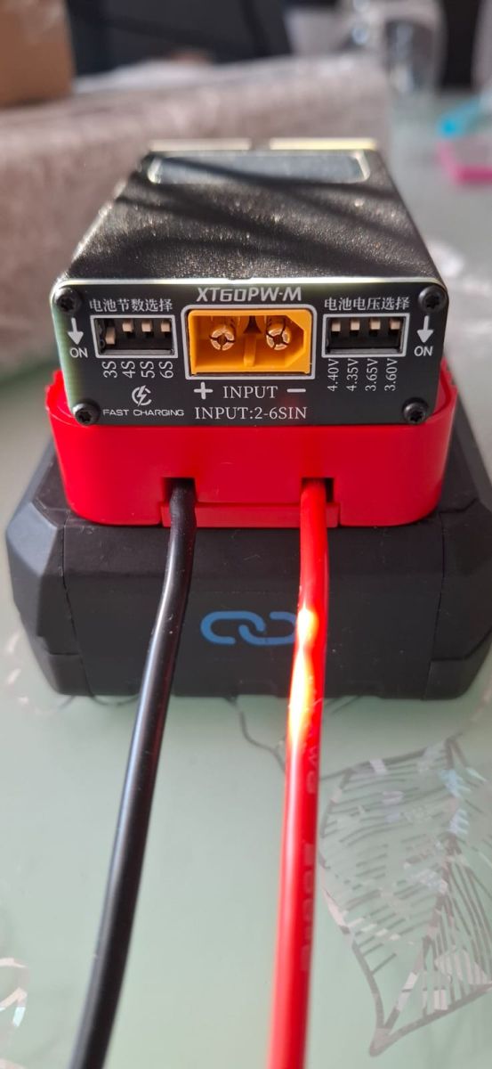

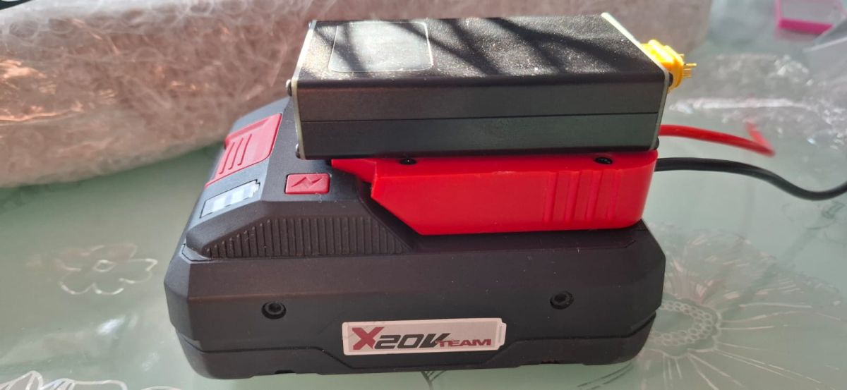

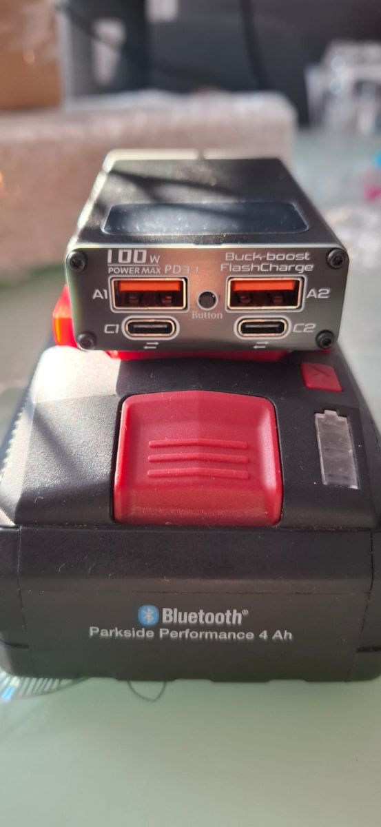

  • #15 21920588
    KangBahar7238
    Posts: 9
    Yes, I bought a ready-made one and hopefully I’ll soon be able to see the results - fingers crossed for me.
✨ The discussion focuses on charging Parkside X20V lithium battery packs from a 12V AGM battery in a location without mains power. The original Parkside charger requires 230V AC input and outputs about 21V DC, so several solutions are proposed: using a 12V-to-230V inverter with the original charger, using a DC-DC step-up converter directly from 12V to about 21V, or using a model charger such as an iMax B6 / i-charger 106B. The recommended direct-charging approach is a ready-made boost converter with adjustable output voltage and current limiting, set around 21V and a safe charging current. The topic author ultimately reports success with a DC-DC step-up inverter/converter and confirms that Parkside 20V batteries can now be charged from the AGM source.
