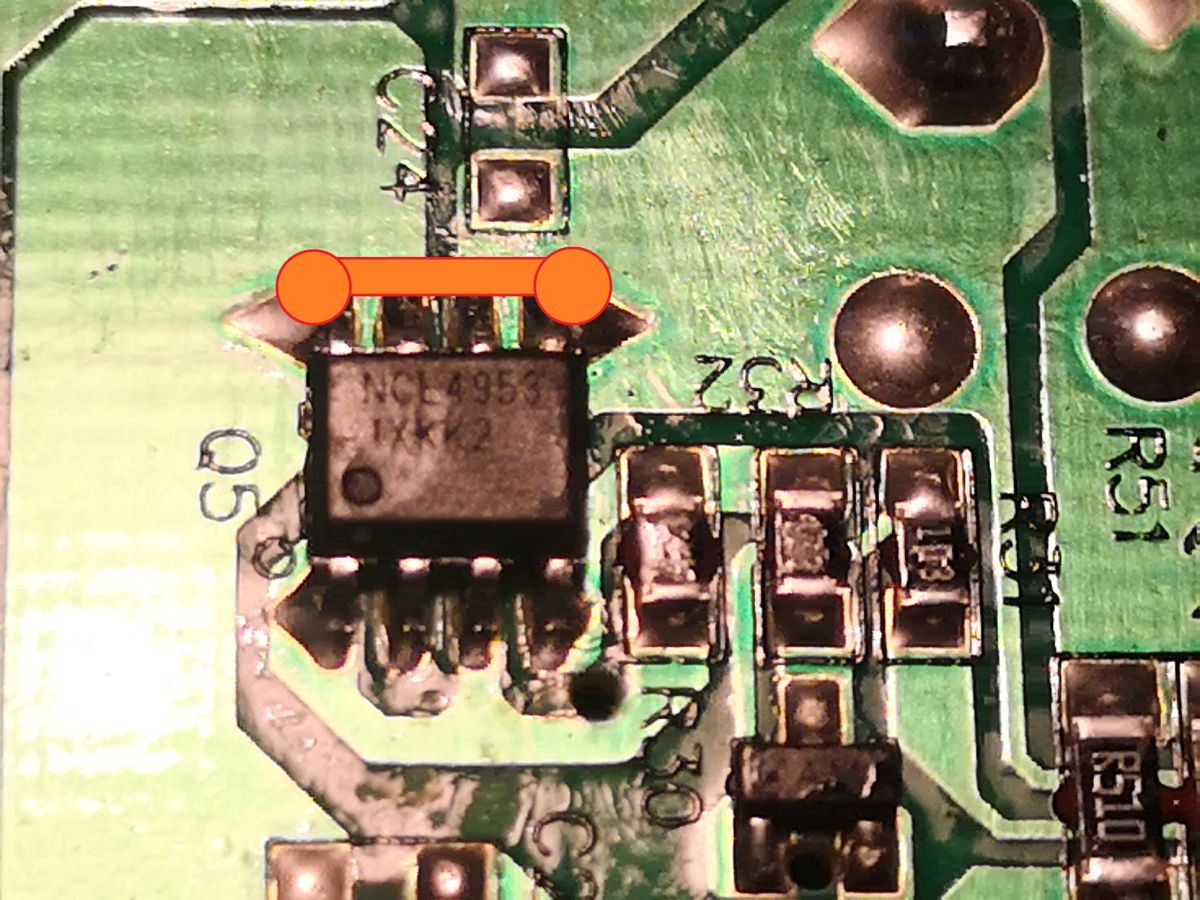

    olsefb
    >>18221073
    Hi. Q5 is a dual P-MOS (usually 4935/4953), trigger it to "on" state or short the DS terminals (PIN 5 to 8 on SO-8 case) so your battery will be always (or when needed) connected to 21VDC, therefore charging constantly. However, consider somehow monitoring the state as overcharging/exceeding the charging time could result in fireworks. Cheers

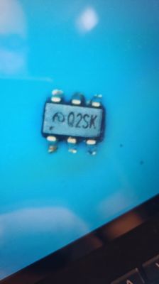

    diogobreis
    Hello all!!
    Any idea about the PWM driver? on label is written Q2SK.
    Close-up of an integrated circuit with Q2SK marking on a blue background.
    KR
    **Solved**
    Replaced with LD7536

  • #14 21797975
    bezzinatrevor
    >>21033992
    Can you kindly clarify PIN 5 to 8 on SO-8 case ? as i am trying to fo this modication. I got the pin 5 to 8 bit but what is SO-8 ?
  • Bridge double MOSFET chip for constant output voltage

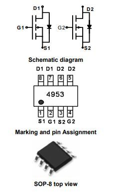

    #15 21856002
    WALDERAMA 7!
    Posts: 55
    Rate: 8
    >>21797975
    @bezzinatrevor Bridge that double MOSFet chip, (pins 5-6 and 7-8 are outs) then You will have constantly output voltage (MOSFet works here as a switch to avoid overload of acu)
    If You use Parkside acus make just a switch ON/OFF to have auto switching charger mode too

  • #16 21879178
    artoor200sx
    Posts: 7
    >>21856002
    I have done according to your diagram, but the effect is half-hearted. With no load, 21 volts appears on the pins, while when the battery is connected it only charges it to 17 volts and not a thought more. I read something that the charger has two operating modes, but I don't know how to activate the stronger one.
