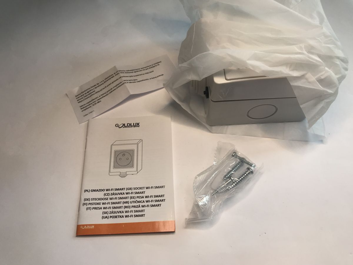

    It must be said, however, that the importer has made an effort. The manual is in Polish! Probably anyway, the whole thing is printed and packaged in China. Inside it is explained a little about the Tuya application, but I have a different plan.

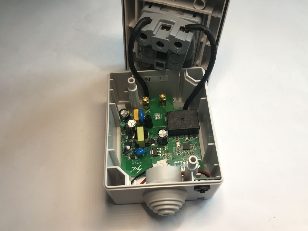

    So we take a look inside. It's interesting to note that the earth directly mounts to the pull-out front. The socket also has a protected small button to control it without an app. There is a single electronics board inside. PCB designation: 16-WPXV1.1
    External IP55 surface-mounted socket controlled by Wi-Fi - Sanico TM-WP-04

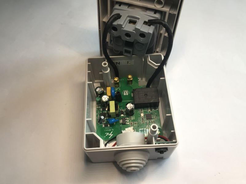

    The relay used is an XT76-SS-105DM, up to 16 A, worse that the whole thing as usual only cuts off one wire - if you connect it right, the phase. The rest is also standard, power supply, LDO 3.3 V and ESP.

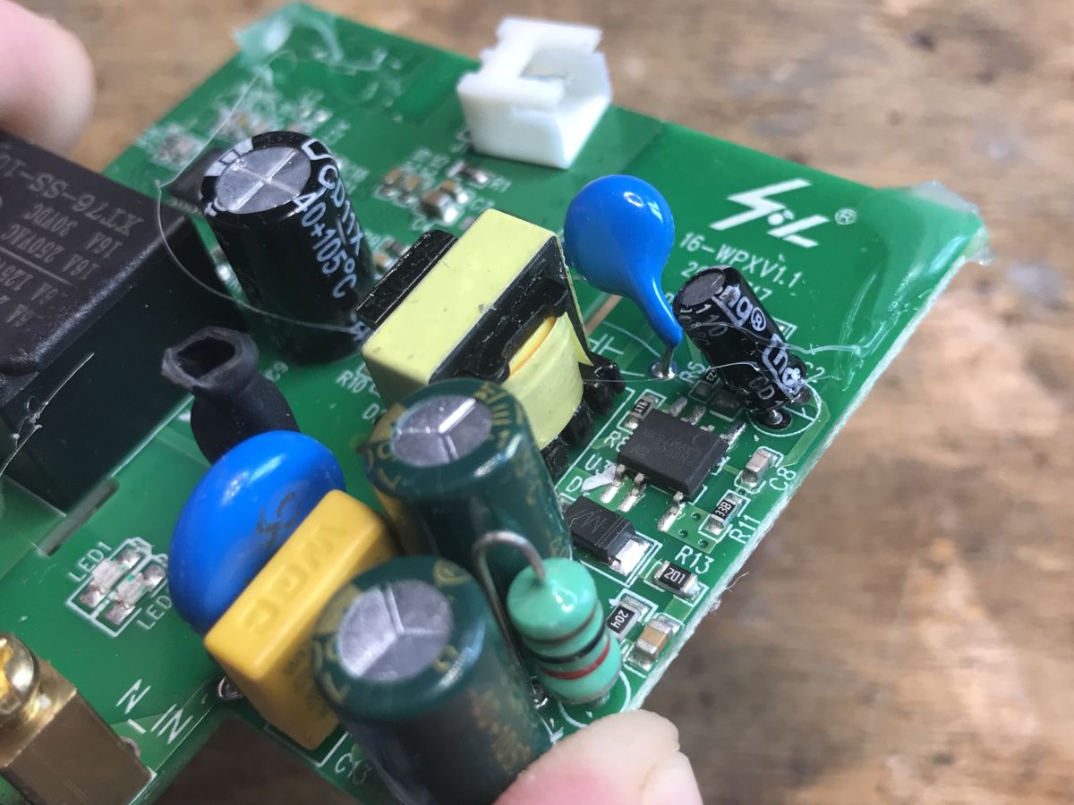

    In the power supply section, as far as I can see, there is a PN8395.

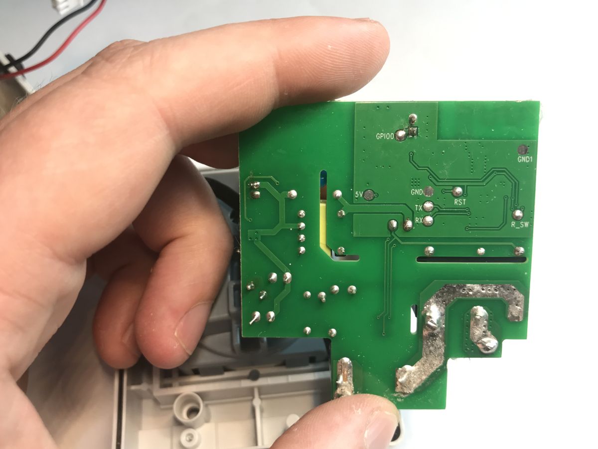

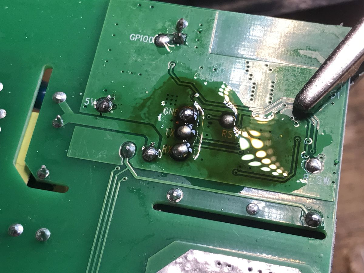

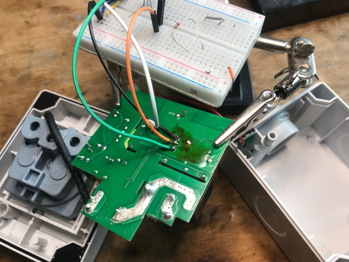

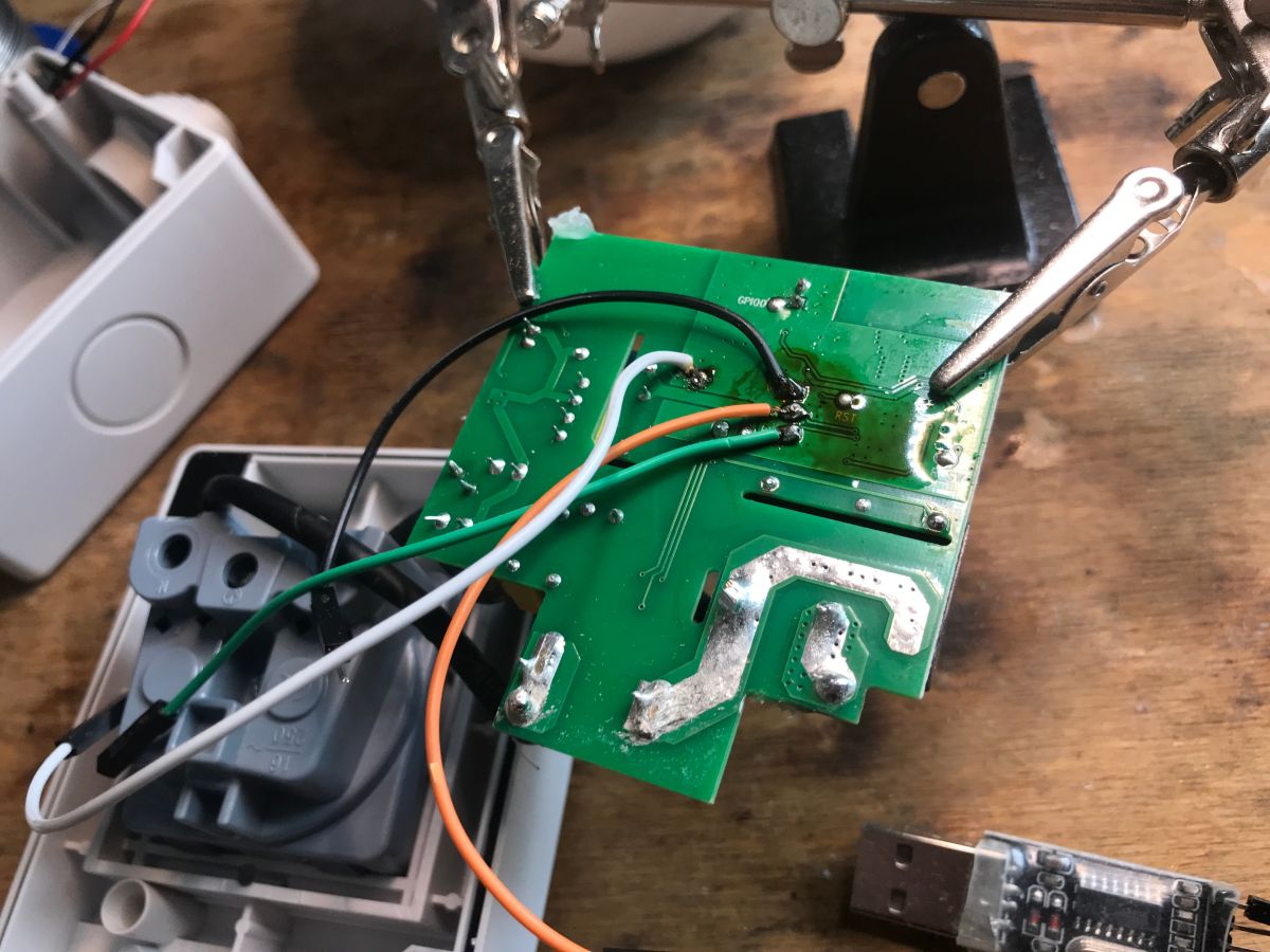

    On the bottom we have the signed UART programming pads, including GPIO0, the distinctive pin needed to put the ESP into bootloader mode. I download the pins before programming, then solder the wires:
    External IP55 surface-mounted socket controlled by Wi-Fi - Sanico TM-WP-04 Green PCB with soldered wires connected to a breadboard on a workbench

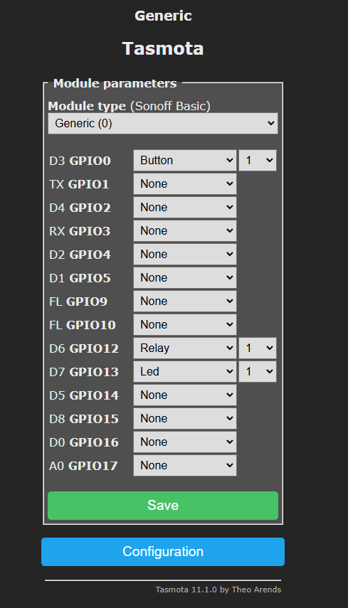

    After uploading Tasmota you need to configure the button - it depends on the board, here it is on GPIO0 and the relay is GPIO12.

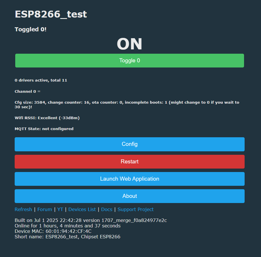

    Now you can upload normally Tasmota or and OBK (port on ESP8266):
    ESP8266 and Tasmota - WiFi relay control step by step
    Tasmota “Module parameters” screen mapping GPIO: Button on GPIO0, Relay on GPIO12, LED on GPIO13
    Web UI for “ESP8266_test” showing large “ON” status and a green “Toggle 0” button

    GPIO0 is on the button so you don't need to solder anything, just hold the button down for programming.
