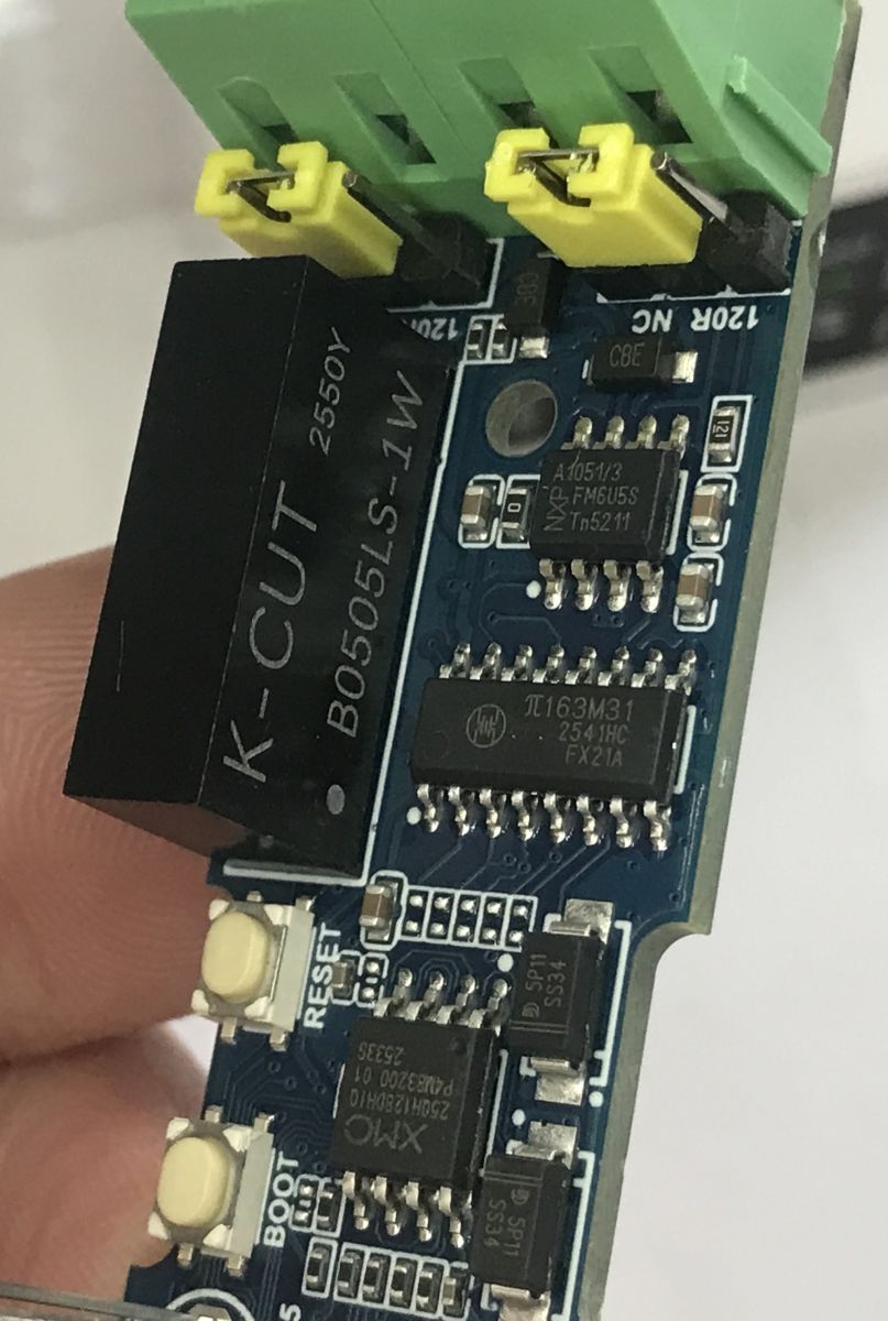

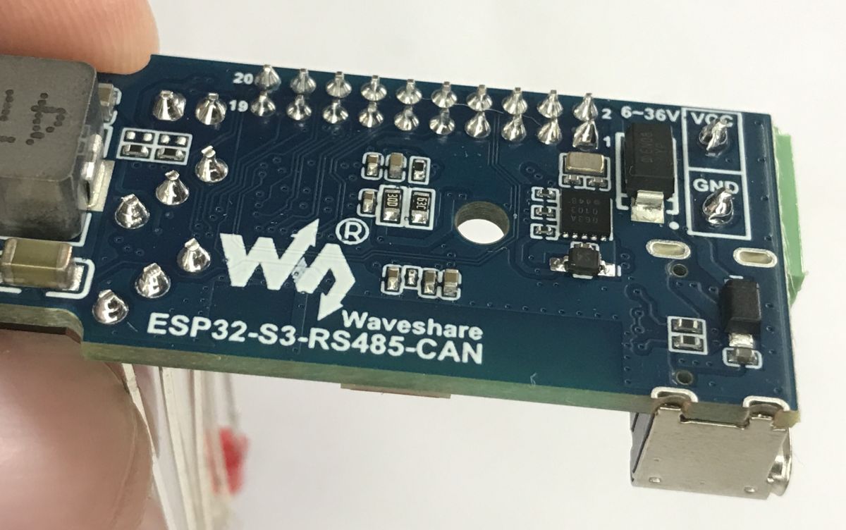

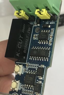

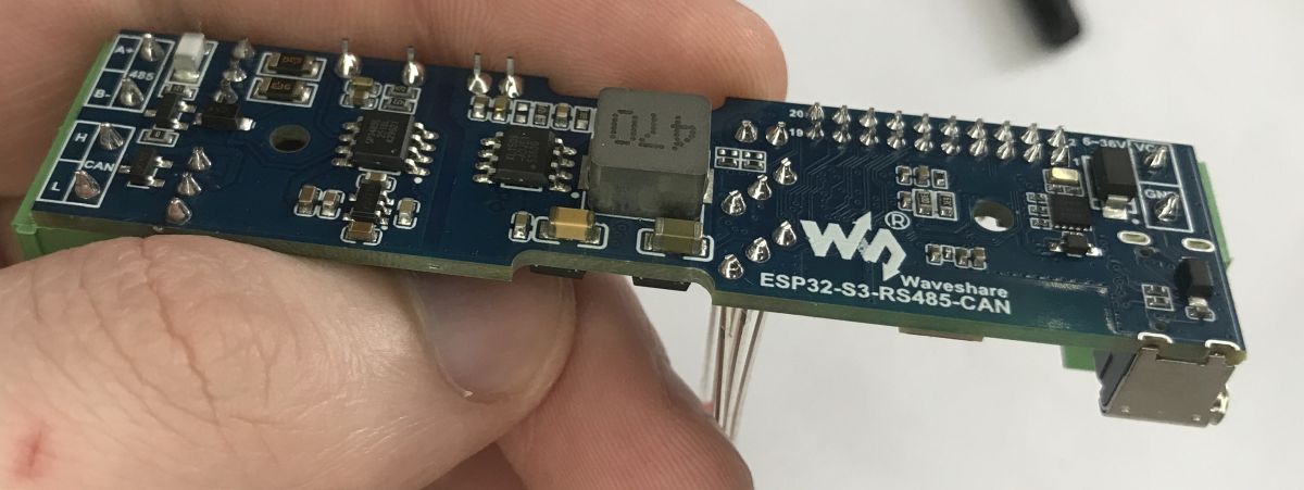

    Photos from inside:
    Industrial ESP32-S3 module with 16 MB Flash, 8 MB RAM, RS485 and CAN buses Industrial ESP32-S3 module with 16 MB Flash, 8 MB RAM, RS485 and CAN buses Industrial ESP32-S3 module with 16 MB Flash, 8 MB RAM, RS485 and CAN buses

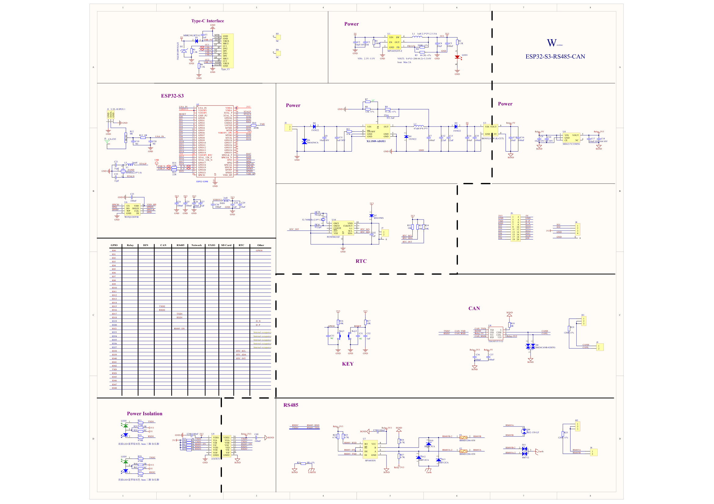

    Scheme:
    Electrical schematic of Waveshare ESP32-S3-RS485-CAN with power, RTC, CAN, and RS485 sections

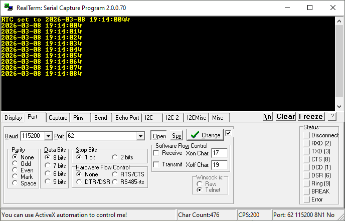

    RTC activation
    The board uses a PCF85063AT real-time clock connected to pins IO38 (SCL), IO39 (SDA), IO40 (INT). It is a simple RTC communicating over the I2C bus, so you only need the standard Wire library to operate it. The package structure is simple enough that a separate library for PCF is not needed. Only auxiliary functions for the BCD encoding standard are needed.
    Code: C / C++
    Result:
    RealTerm screenshot showing RTC log: time 2026-03-08 19:14:00 and subsequent seconds
    In a practical situation, the current time is set once and the RTC maintains it thanks to the battery even when the main power supply is disconnected.

    What is the "industriality" of this module? It looks cool, but just because it can be DIN-rail mounted doesn't mean it's of industrial quality, industrial design or has to comply with industrial standards.

    I would love to see, maybe it would be possible to look inside too? We have an appliance interior section...

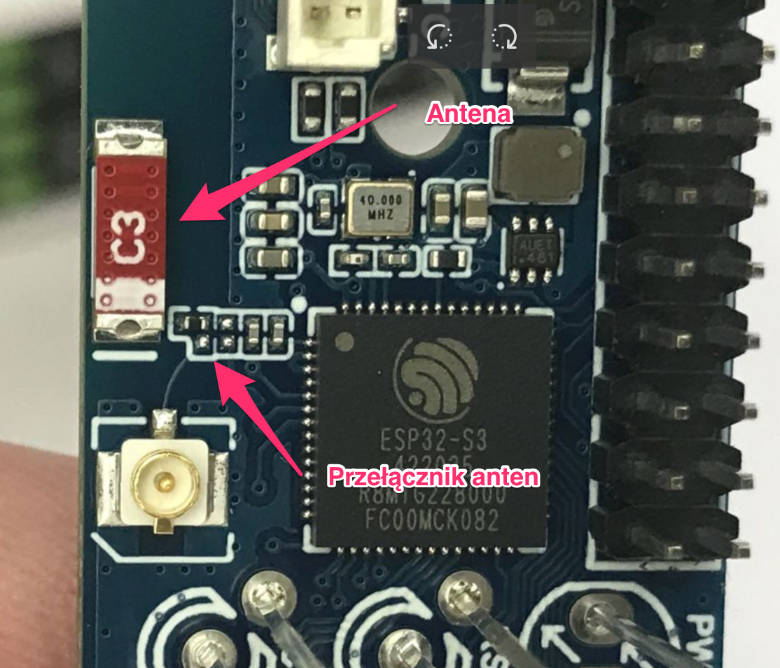

    Where is the Bluetooth antenna located?
  • #12 21911569
    Chris_W
    Posts: 8479
    Help: 386
    Rate: 1051
    Esp uses alternately the same antenna.
  • #13 21911574
    Mateusz_konstruktor
    Level 37  
    Posts: 4322
    Help: 270
    Rate: 1110
    @Chris_W
    And where, physically, is this antenna located?
  • #14 21911579
    electro
    Posts: 488
    Help: 9
    Rate: 109

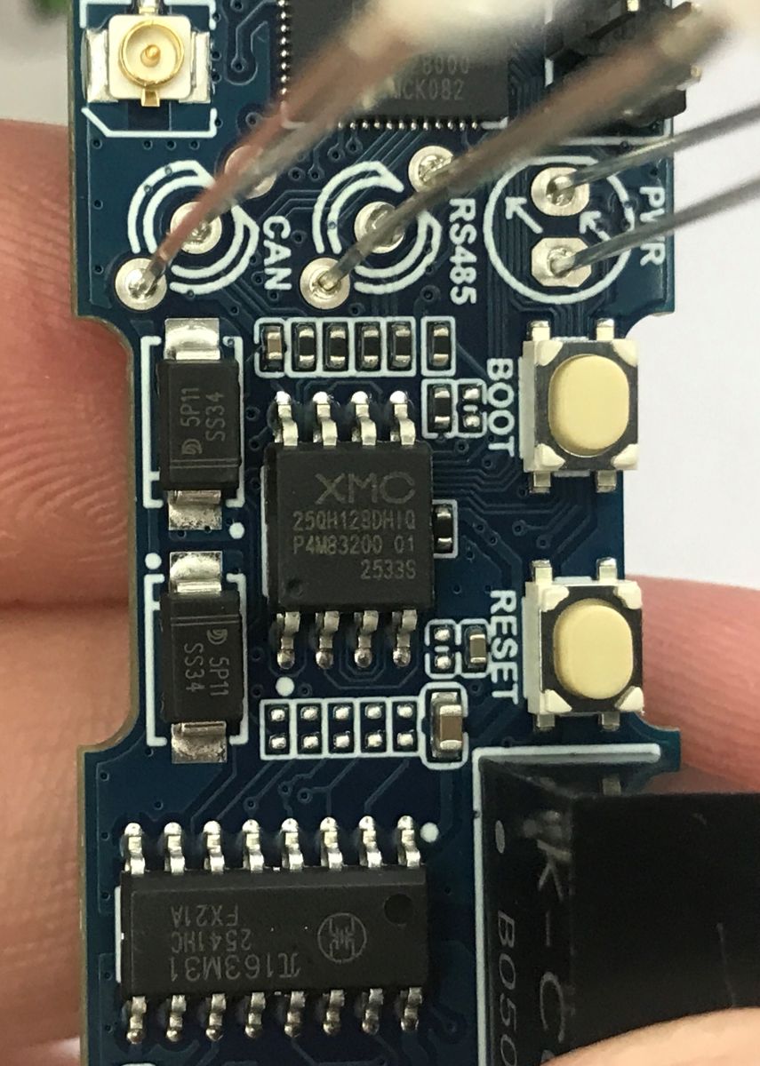

    A red SMD element labelled C3, unfortunately to use an external antenna I have to solder a resistor
    Close-up of an ESP32‑S3 PCB with a red SMD part marked “C3” and arrows labeling the antenna path and switch

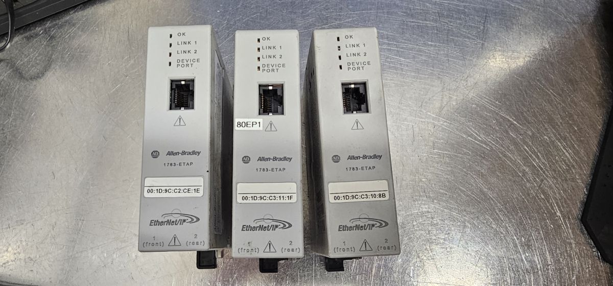

  • Photos of Allen-Bradley equipment for later teardown

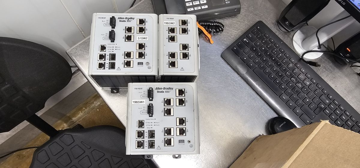

    #19 21911886
    altar3
    Posts: 173
    Rate: 21

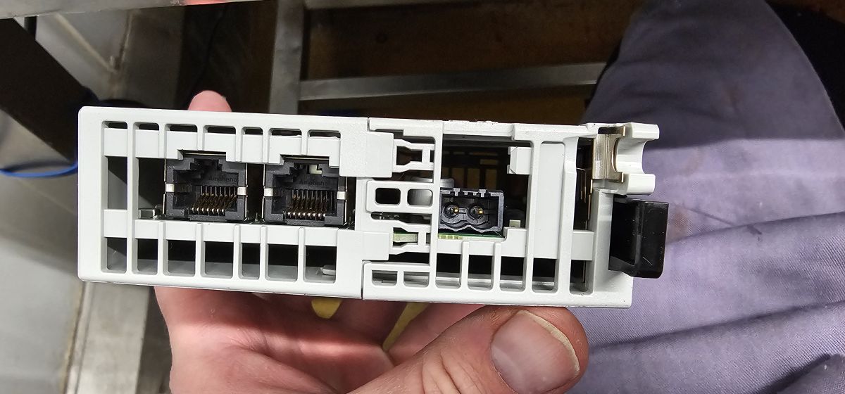

    These are some pictures of the Allen-bradley equipment at the moment I don't have the opportunity to take any more pictures and I'm going on holiday now so I have to put the phone pictures away until after my holiday. I will take some photos of other equipment and then if those modules from the photos are still available I will try to take them apart and take some
    Three Allen‑Bradley Stratix 8000 industrial Ethernet switches on a metal desk beside a keyboard
    Three Allen‑Bradley 1783‑ETAP modules with Ethernet ports and LED indicators on a metal surface
    Close-up of a module rear panel with two RJ45 ports and a power connector, held in a hand.
    inside photos.

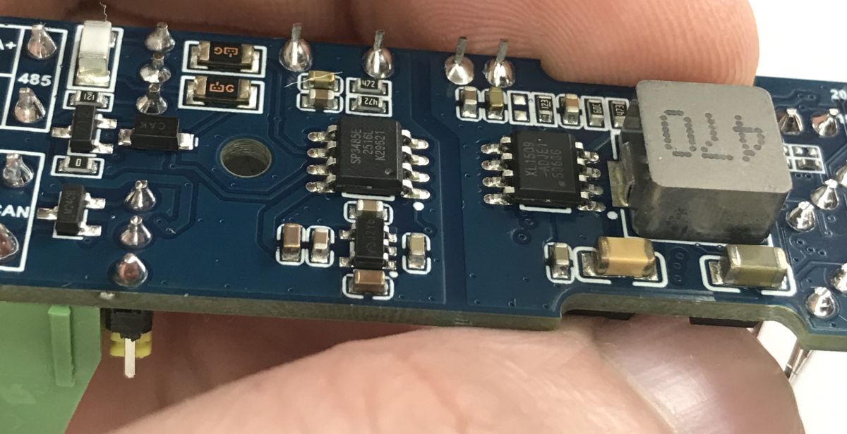

  • Power supply uses MP1605GTF and XL1509-ADJE1

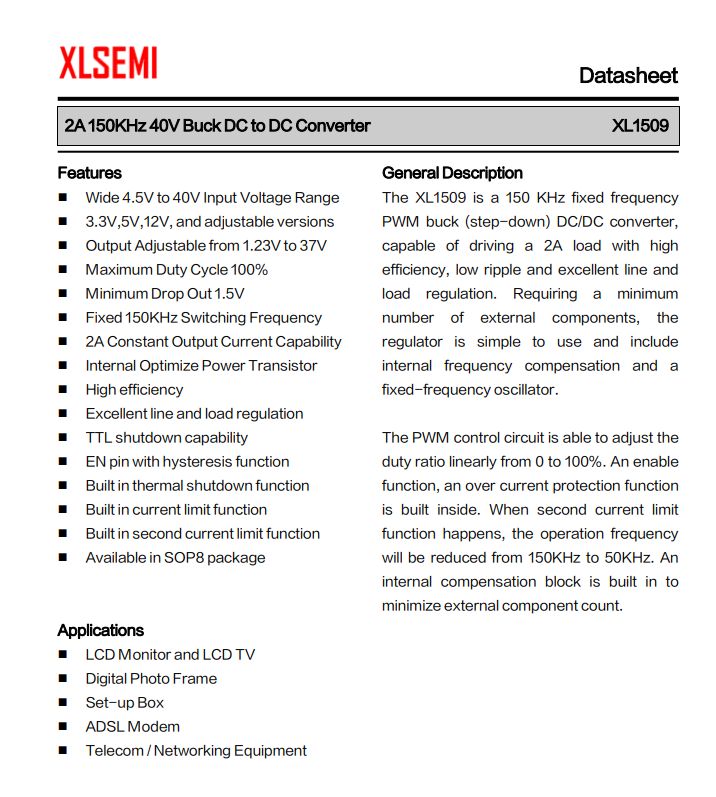

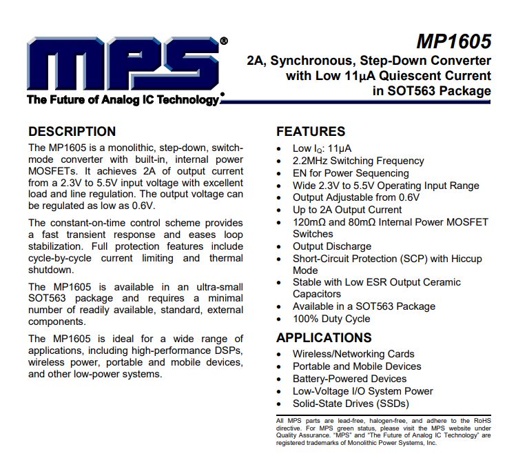

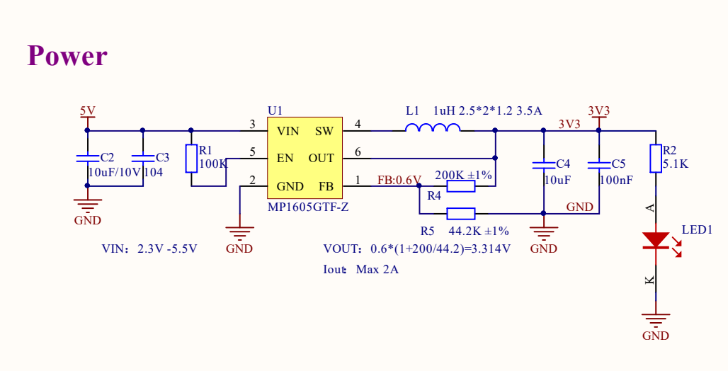

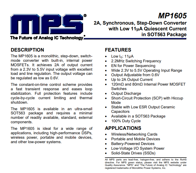

    @gregor124 it's probably best to check on the schematic. As far as I can see, the power supply is based on the MP1605GTF, although there is an XL1509-ADJE1 separately before that.
    MP1605GTF:
    XL1509-ADJE1:
    Screenshot of the first page of the XL1509 datasheet for a 2A buck DC‑DC converter
    You should also still take into account that the ESP32 also draws its own - up to a few hundred mA - depends on the radio mode and which ESP.

    #21 21912630
    gregor124
    Posts: 1698
    Help: 101
    Rate: 882
    >>21912484
    That's what I mean, because to my eye, according to what the documentation states, that 2 A is already too little for what is ;)
    https://documentation.espressif.com/esp32-s3_datasheet_en.html#electrical_characteristics
    Since theoretically from all I/O outputs I can load up to 1500 mA in total, Wi-Fi TX at worst case 340 mA RX 88 mA, Bluetooth TX 335 mA, RX 93 mA, DualCore at 128-bit access instruction 108 mA.
    And the w25q128 memory can also take its 25 mA.
