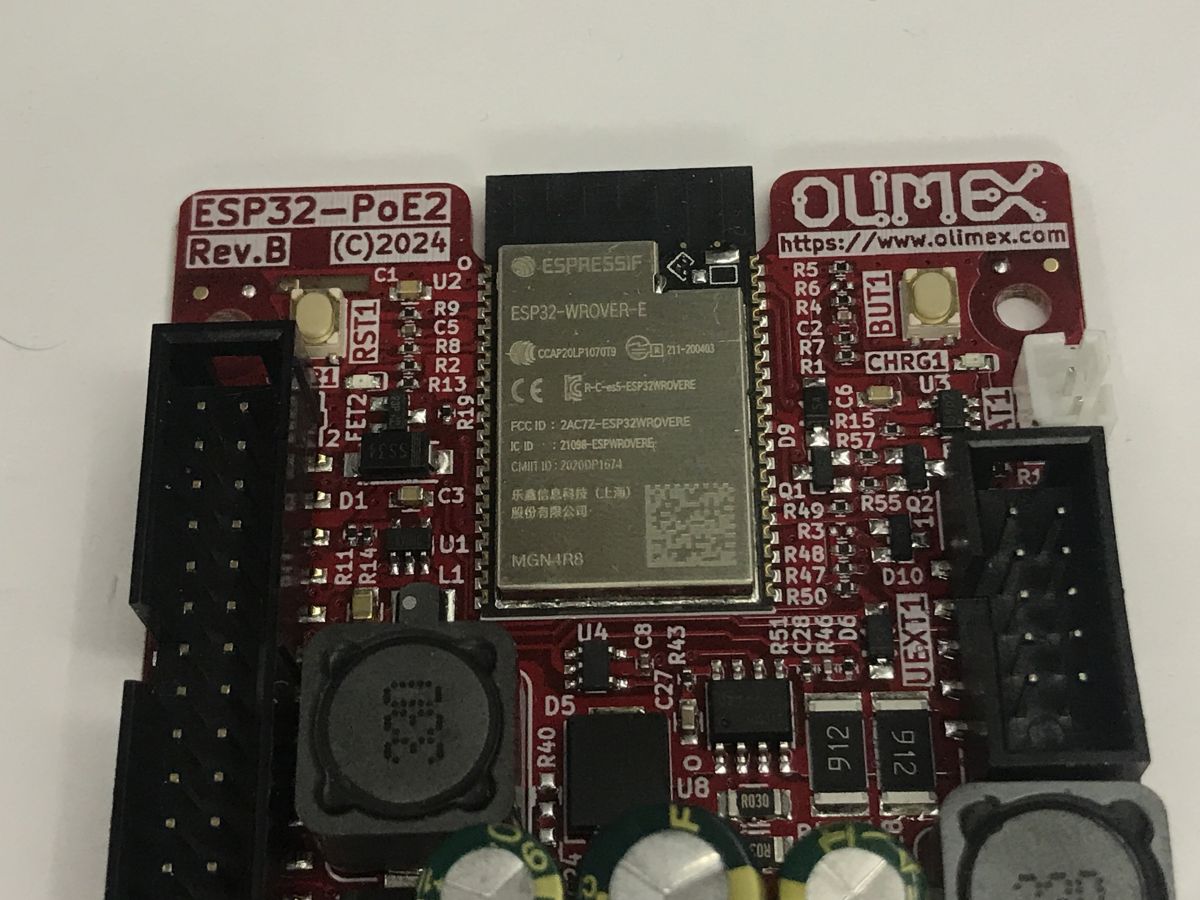

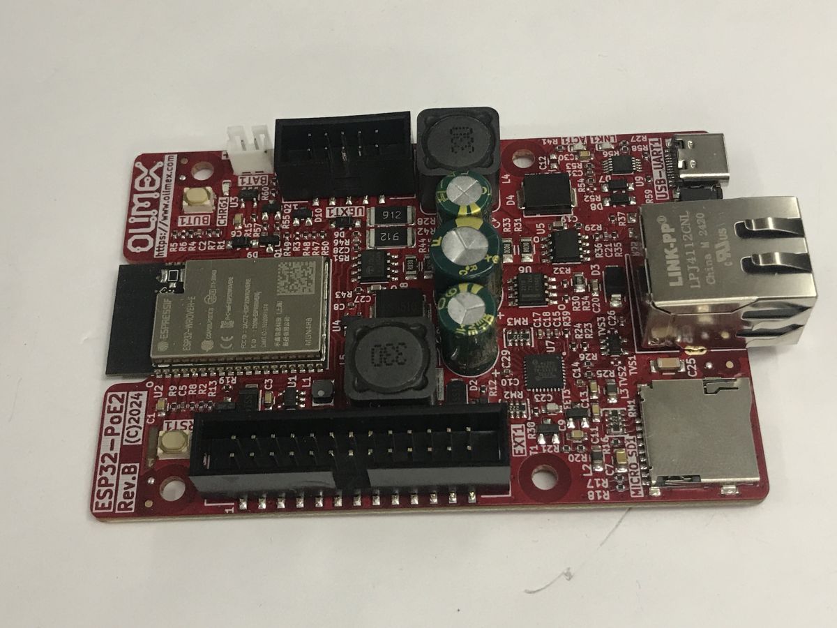

  • Olimex ESP32-PoE2 is an open-source ESP32 board with Wi‑Fi, wired Ethernet via LAN8720, and PoE support.
  • The design adds TPS2378PW PoE power, a CH340 USB-to-UART interface, microSD, LiPo charging, UEXT connectors, and PlatformIO-ready Ethernet examples.
  • The tested version uses ESP32-WROVER-E-N4R8 with 4 MB Flash and 8 MB PSRAM, and Olimex rates external output power up to 25 W.
  • Ethernet setup obtained a DHCP address, resolved google.com, sent an HTTP request, and received a 301 Moved Permanently response.
  • The board lacks galvanic isolation on the Ethernet power path, so ground loops are possible; disconnect Ethernet during USB programming if PoE is active.

    The ESP32-PoE2 is an open-source and open-hardware project from Olimex. The full project sources (including the PCB in KiCad) are available on GitHub . I bought my unit for 120 zł. I chose the version with extra memory, i.e. the one based on the ESP32-WROVER-E-N4R8 with 4 MB Flash and 8 MB PSRAM.
    ESP32 board with Wi-Fi, wired Ethernet and PoE power supply – ESP32-PoE2 Olimex

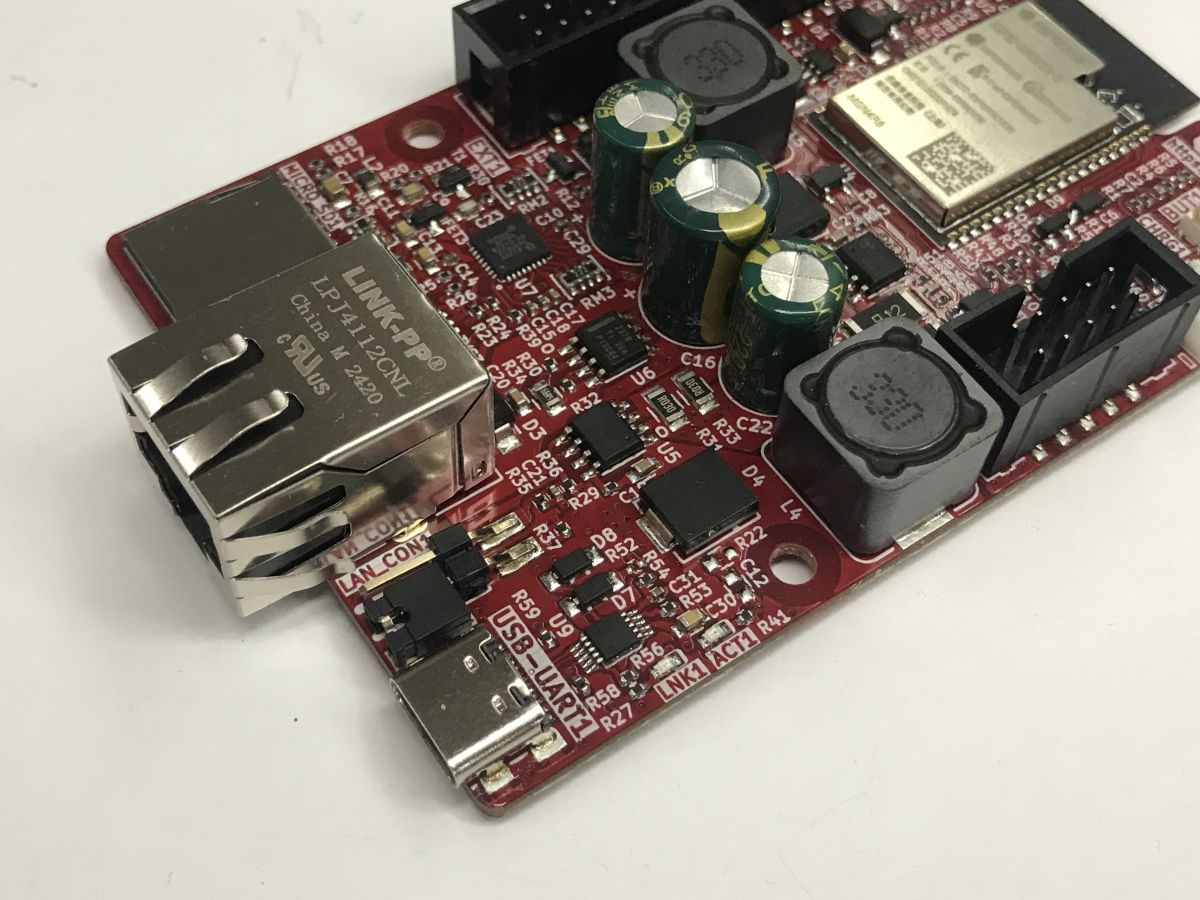

    The TPS2378PW provides PoE power and complies with the IEEE 802.3 standard. An input voltage of at least 37 V is required. The board itself is capable of powering external circuits – it has 24 V / 0.75 A or 12 V / 1.5 A, as well as 5 V / 1.5 A and 3.3 V / 1 A, with a total output power of up to 25 W.

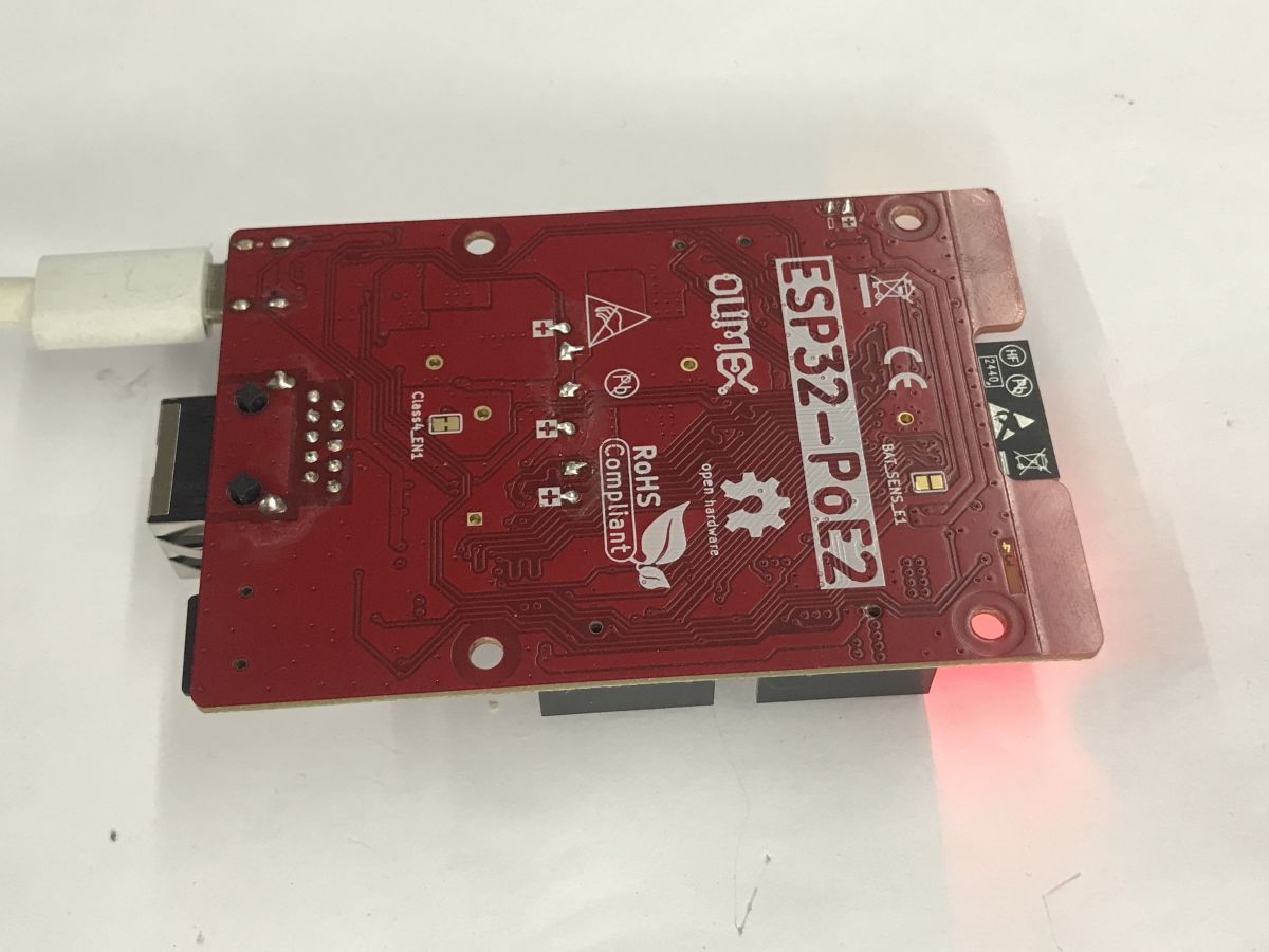

    Note: The ESP32-POE2 does not have galvanic isolation from the Ethernet power supply, which may cause ground loops. When programming via USB, disconnect the Ethernet cable (if PoE is active). Connecting an external power supply may be dangerous – it is recommended to use the Olimex USB-ISO to protect your computer and the board.
    Additional peripherals include a microSD card slot, a built-in USB-to-UART converter for programming (CH340), a BL4054 controller for working with LiPo batteries, and a wide range of connectors, including Olimex’s UEXT.

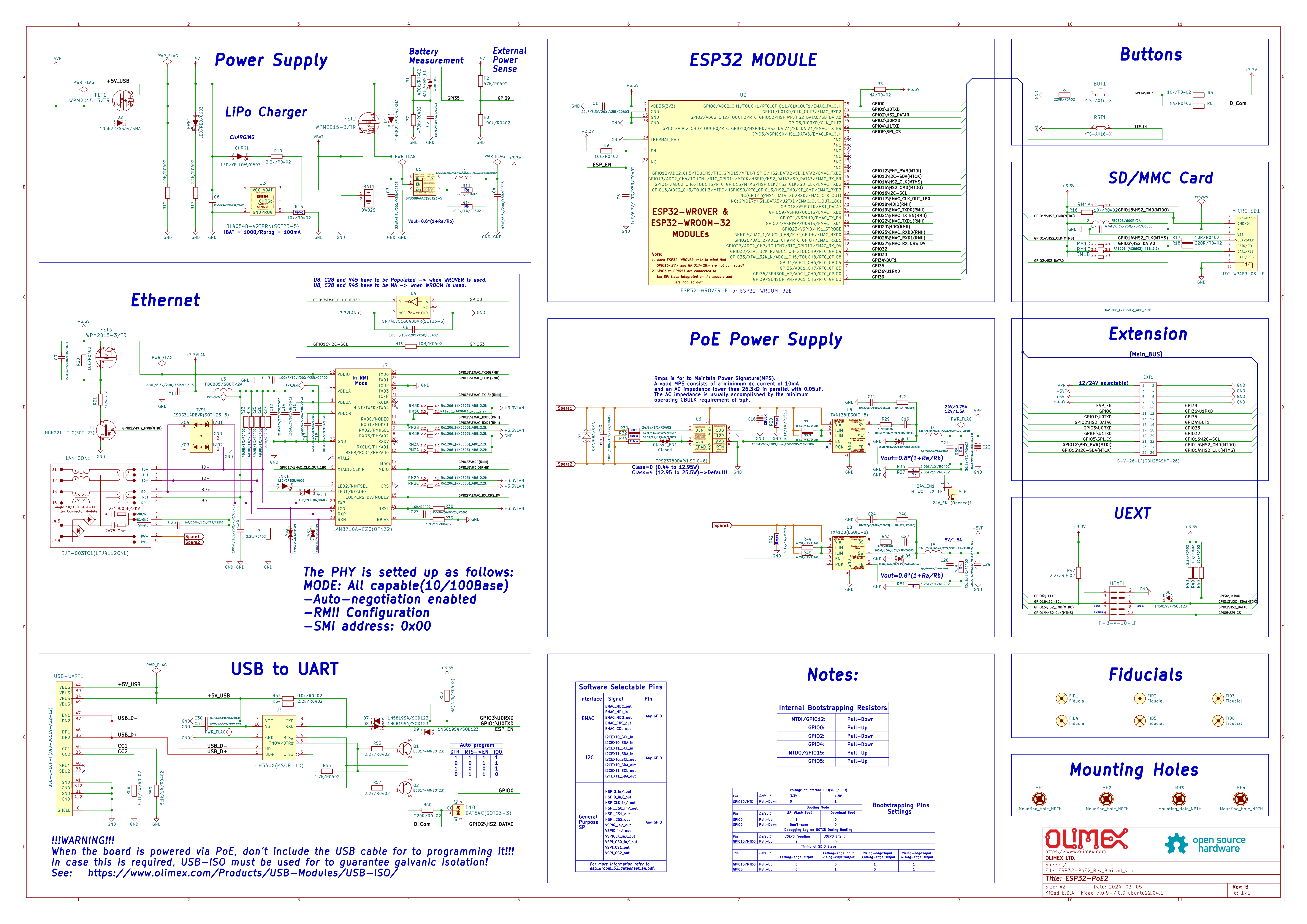

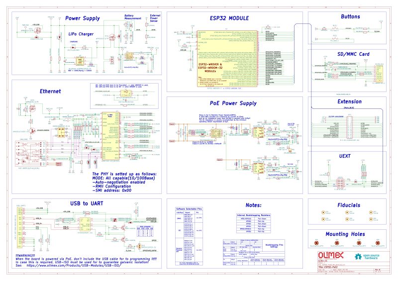

    Schematic:
    CAD schematic of the ESP32‑PoE2 board with labeled blocks for power, PoE, Ethernet, SD, and USB‑UART

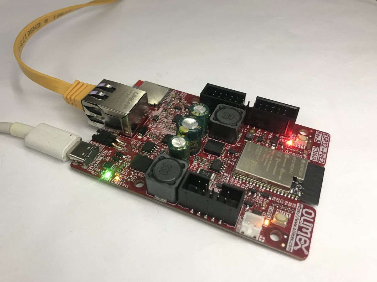

    The LAN8720 is what makes this board stand out the most, and that is what I will focus on here. First, platformio.ini – the PIO libraries already have a profile for this board (esp32-poe-iso), and there is also a ready-made library for the LAN8720.

    The board successfully obtains an IP address via DHCP from the router, and is then able to convert the hostname to an IP address and send a simple HTTP packet there. The response is also received; we can see here that Google is attempting to redirect us. The ESP also appears in the router’s list of DHCP clients.

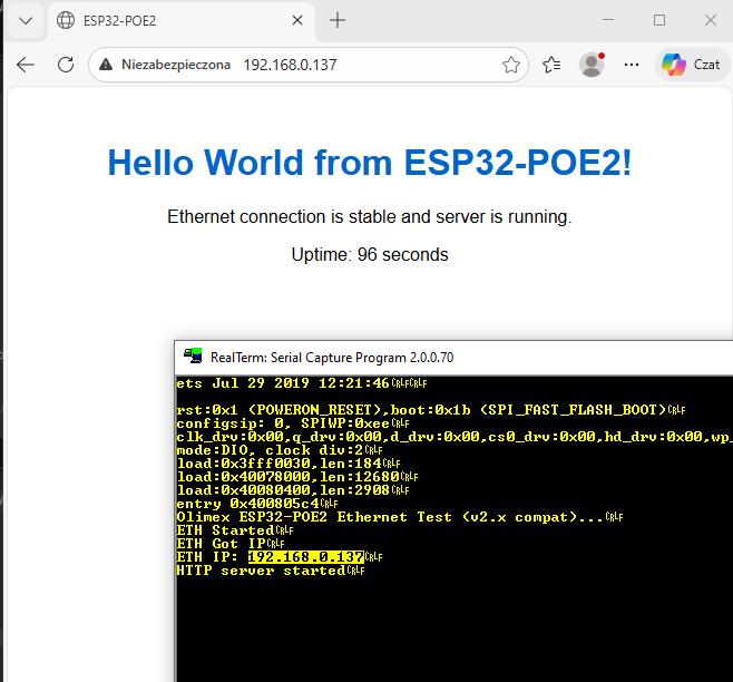

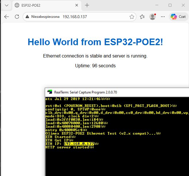

    I was also wondering whether it was possible to do the opposite – not establishing a connection, but waiting for one. So I set up a simple server that listens on port 80 (HTTP) and receives packets via the LAN cable:

    The libraries handle everything – the server is accessible without Wi-Fi:
    Browser window showing “Hello World from ESP32-POE2!” and an embedded RealTerm terminal log screenshot
