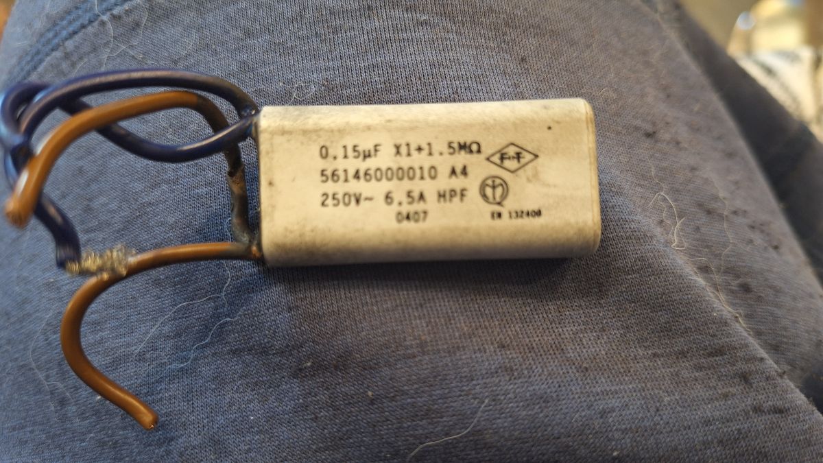

    Looking for 56146000010 A4 250 V 6.5 A part for Metabo PSE120
    Metal cylindrical 0.15 µF 250V capacitor with three wires on a gray fabric surface

    can you post a photo of the part or say what it is in the Metabo PSE120, e.g. switch, capacitor, fuse, etc.?
    Think it's a capacitor

    neila343 wrote:
    I think it’s a capacitor
    And it’s an anti-interference capacitor. The tool should work without it. How did you determine that it was faulty?

    neila343
    Its burnt and split on the back

    meaverick
    Posts: 853
    Help: 113
    Rate: 246
    Without a capacitor, the rotor will leave a trail behind it. 150 nF/250 with leads, in a plastic casing – the leads can be wires. It makes no difference; any electronics shop will stock them. TME, CONRAD or another. Alternatively, if there’s no shop nearby, have a look for a local household appliance repair service.

    Wawrzyniec
    Posts: 4011
    Help: 392
    Rate: 1079
    With a built-in resistor. Can be used with higher AC voltages (not for DC; symbol ‘~’).
