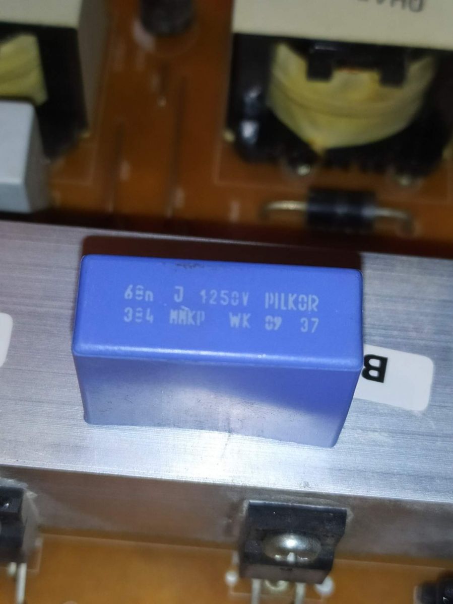

    TV Samsung PS50B450B1W Capacitor Pilkor 68n 1250V 384 MMKP WK 09 37 Hello and welcome
    I am looking for a capacitor as in the subject or some replacement.
    The TV crackled, there was a short circuit and it turned off, then the standby diode started blinking every 2-3 seconds after using the remote control it flashes. TV Samsung PS50B450B1W Capacitor Pilkor 68n 1250V 384 MMKP WK 09 37

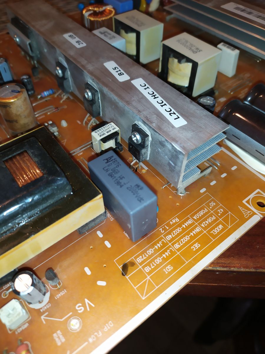

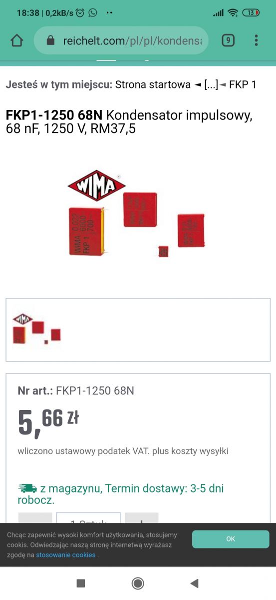

    MIT1000 wrote:
    ... And wouldn't this one be better?
    The "mine" for 2000 V, that is with a considerable margin to the required 1250 V. "Yours" 1: 1. Consider.

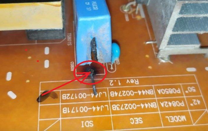

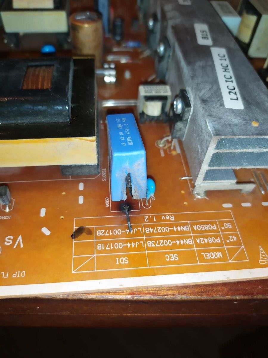

    Cause He was not damaged extension cord. The reason was "cold solder" on the plate in the doomed place with a red arrow. It sparkled, heated and gave such an effect. It happens.
