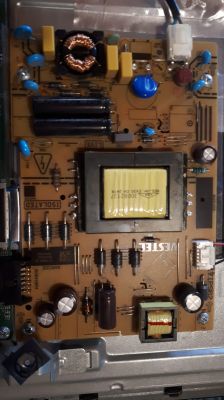

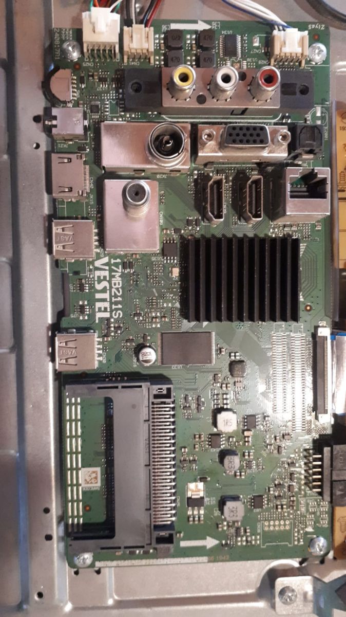

Main board: Vestel 17MB211S-R1

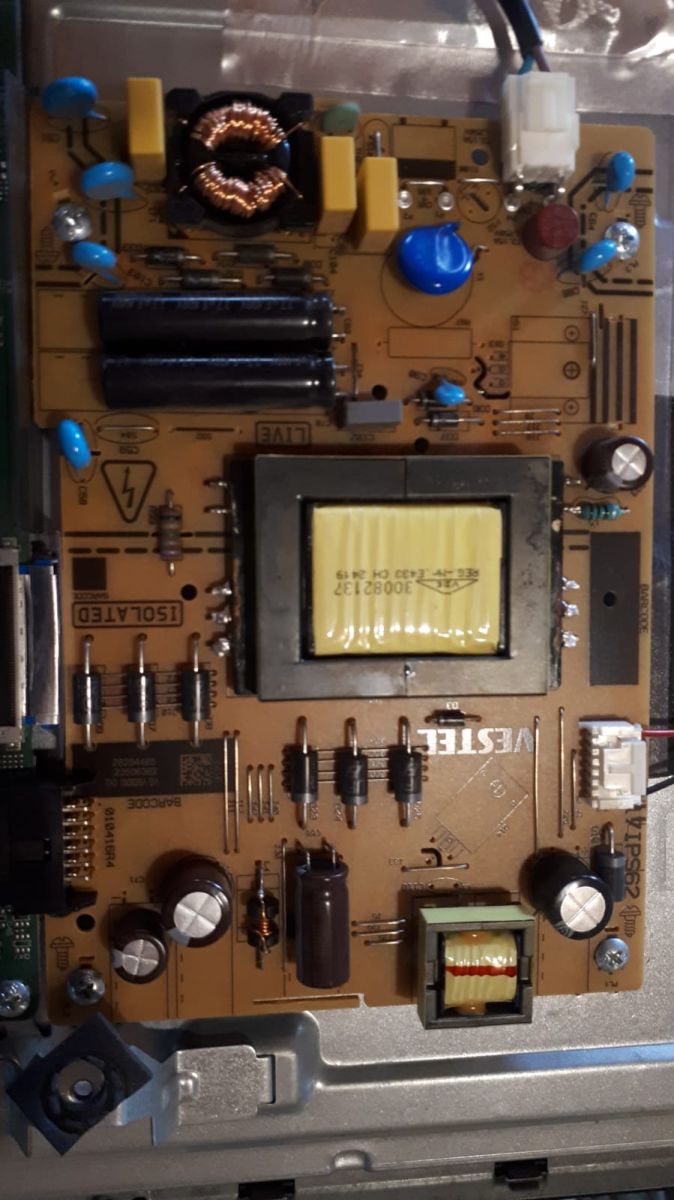

Power supply: 17IPS62

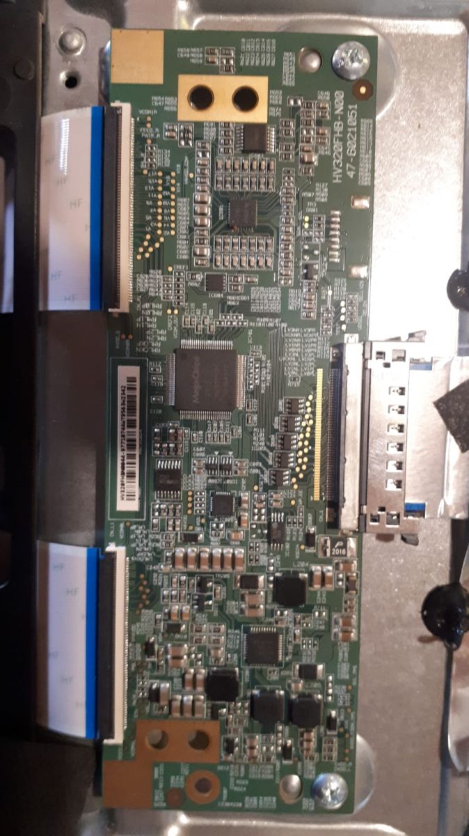

Panel/T-CON: HV320FHB-N00

- 5V rail = 5.07V
- 3.3V rail = OK
- CPU heatsink becomes warm.
- USB ports work correctly.
USB behaviour:
- Every USB stick is detected.
- The TV automatically creates the DVR folder structure.
- The USB LED flashes continuously while the TV is running.
Firmware:
I tried USB recovery using the package:
MB211_TOS_QUI_Shredder_V333100_SVN_312912
(files:
shredder_usb_update.bin
shredder_usb_update.scr)
The TV behaviour changed slightly after the update attempt, but the fault remains.
Could this be:
- wrong firmware,
- corrupted SPI flash,
- corrupted eMMC,
- or another common failure on the 17MB211S-R1?
