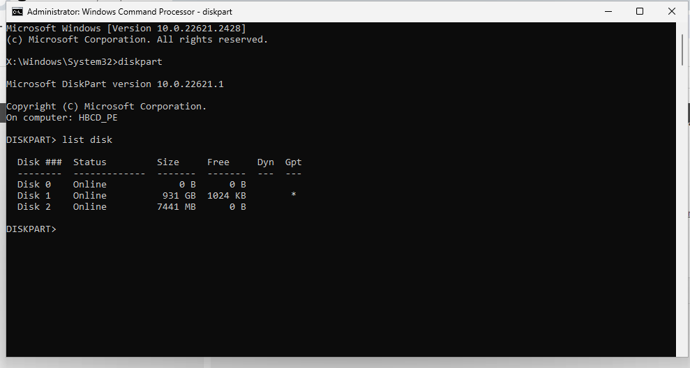

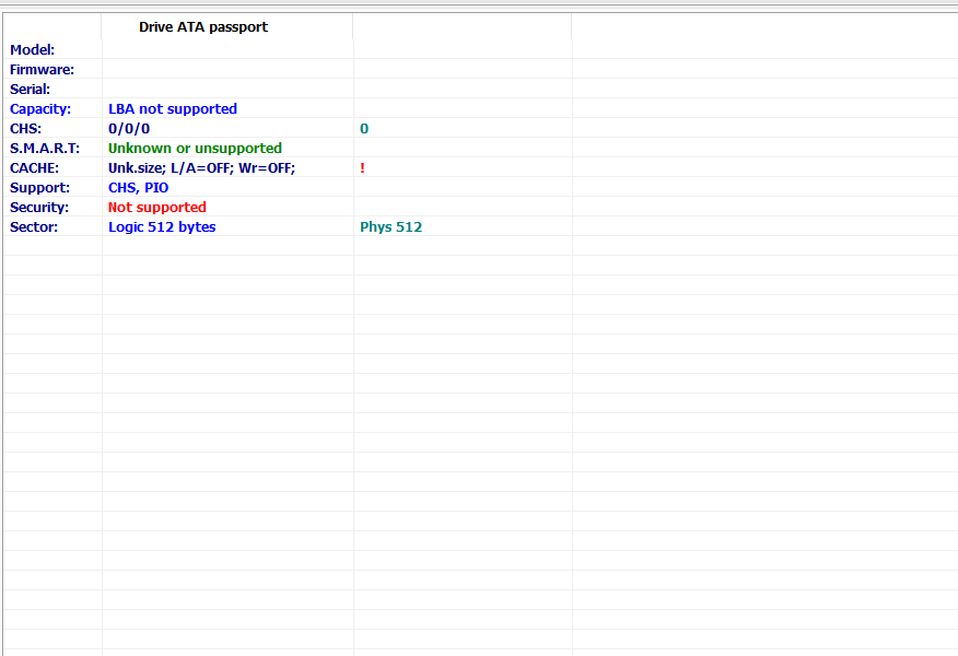

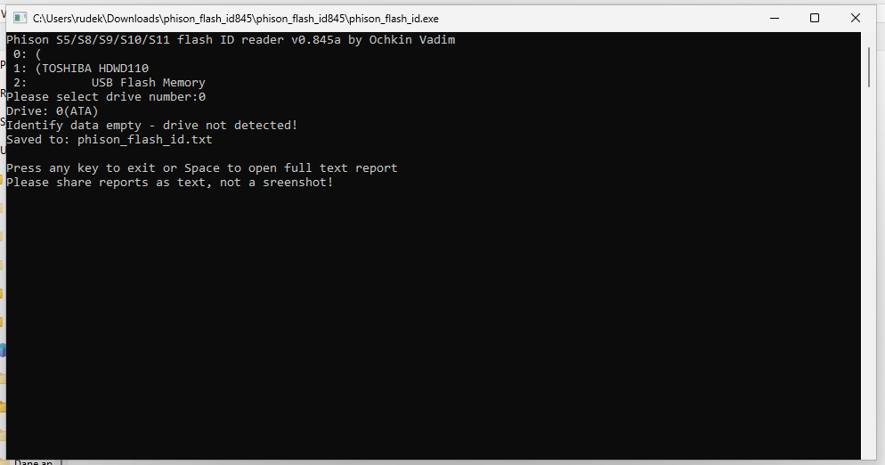

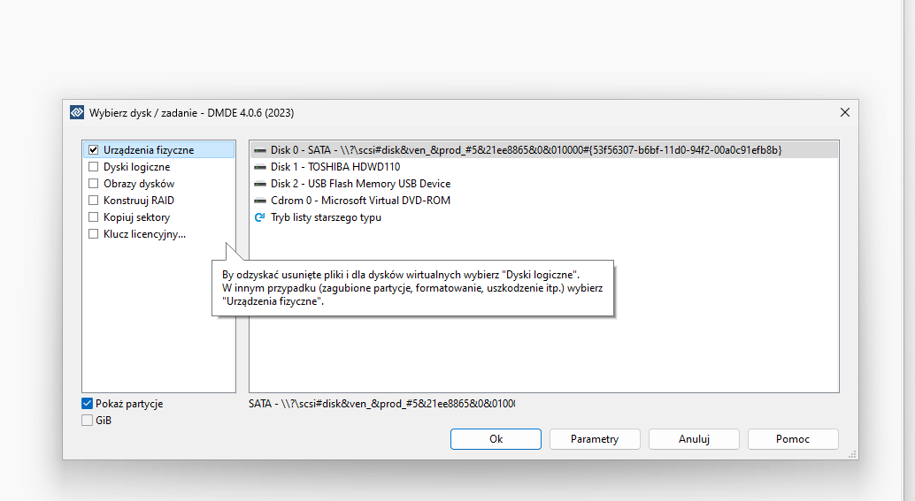

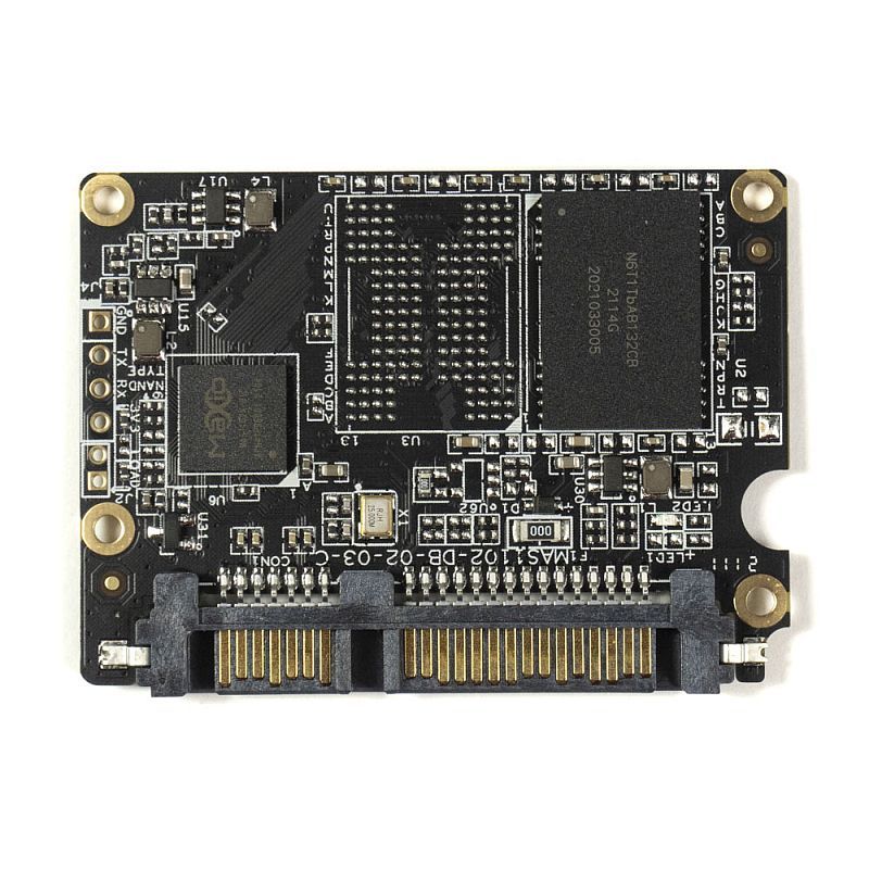

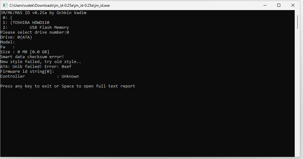

Is it possible to force the drive to start up? I have a GoodRama CX400 512 GB. When I noticed it was starting to act up, I quickly installed Windows on an HDD. I copied about 30 GB of data, but in batches, because the drive would disconnect after 10 minutes. I enabled Hot Plug in the BIOS, and about 5 or 6 times the drive came back to life, handed over the data and then died. Now it’s just warm, but nothing recognises it. When I start the computer with it connected, it freezes on the ASRock boot screen. When I try to wake it up by connecting the cables on the fly, nothing happens. No SATAFIRM. Nothing....
