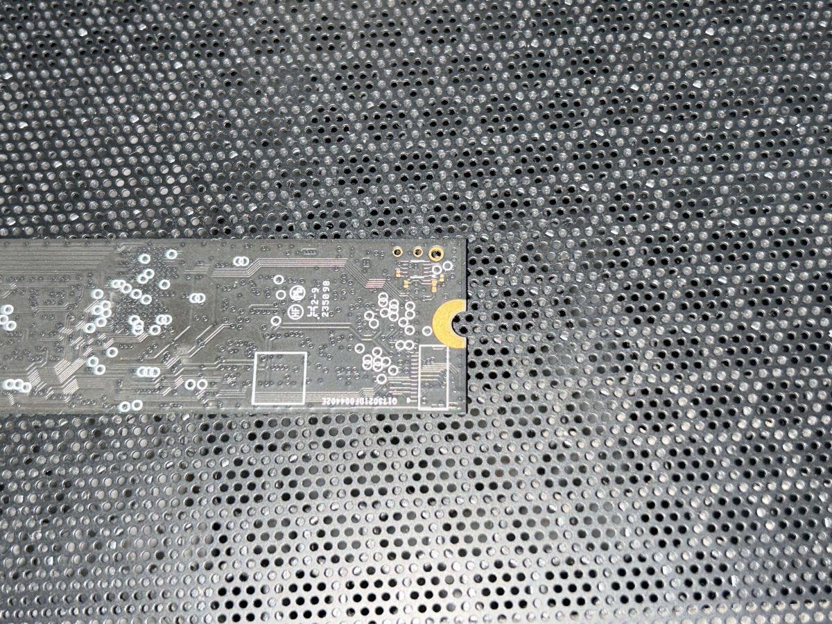

    My Gigabyte Gen4 4000E 1TB SSD has been bricked after a Windows 11 bluescreen following the KB5063878 update. The drive is completely invisible — not detected in BIOS, not showing in Device Manager even as unknown device.
    Drive details:
    • Model: Gigabyte Gen4 4000E 1 TB
    • Controller: Phison PS5021-E21T
    • NAND: Micron QLC
    • I do not need data recovery — I only want to revive the drive itself
    What I have tried:
    • Different M.2 slots
    • Different PC
    • Gigabyte Phison E16 reinitial tool (does not detect the drive)
    • Drive is completely invisible to all software
    Current situation:
    The sticker has been removed. I can see the PCB clearly. There are three exposed pads on the top edge of the drive — two larger ones with circle silkscreen markings, and one smaller pad beside them. I am attaching a photo.
    I believe these may be UART/debug pads based on the PS5021-E21T datasheet, which lists built-in UART and GPIO. Can anyone identify which pad is TX, RX, and GND so I can attempt firmware recovery?

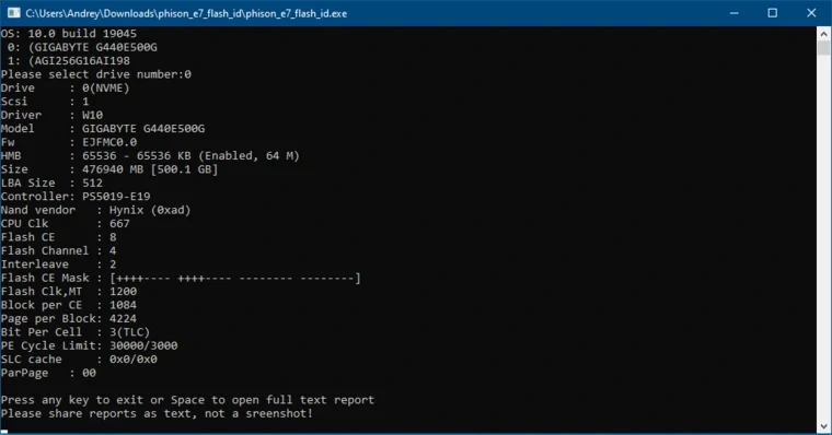

    Program ( phison у7 flash id ) read SSD ?
    or W.Oczkin ( phison nvme flash id2 ) ?
    - If the update had a bug, you will not do anything
    it read with 500GB SSD Gigabyte Gen4 4000E , ctrl PS5019-E19.
    Gigabyte Gen4 4000E 1TB PS5021-E21T UART pad ID after KB5063878 brick
    You need to find where in Phison (which pin's) are USART1_TX and USART1_RX ?
    * You need to find where in Phison (which pin's)are USART1_TX and USART1_RXTX, RX

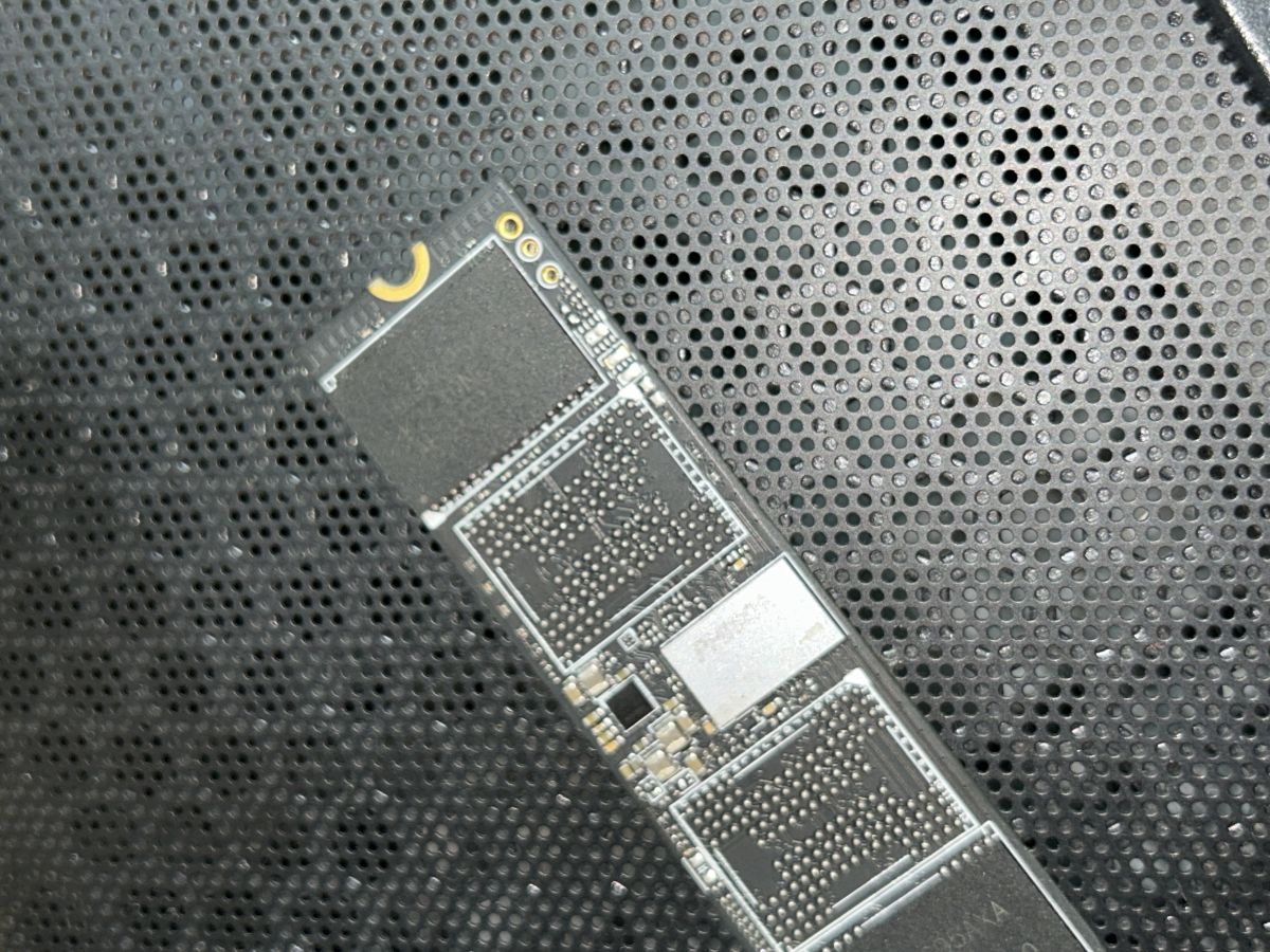

    @lisek — Phison NVMe Flash ID2 does not detect the drive at all. The drive is completely invisible. I have attached a photo of the PCB showing 3 exposed pads on the top edge (2 larger with circle silkscreen markings, 1 smaller). Can you or anyone identify which are USART1_TX and USART1_RX?

    this is the correct firmware to recover PS5021-E21T
    - provided the drive is operational
    Do you have power on the circuit board?
    Controller PS5021-is it warm?
    POd under Live Linux (e.g. Ubuntu) visible ?
    p.s
    Nowadays almost all new SSDs only have these 3 fields/points (UART)
    So on one of them the power is both when the SSD is not specified and when it is specified.
    But on the other only when the SSD is seen.
    As the program ( W.Oczkin ( phison nvme flash id2 ) ) does not see it .... NOTHING you can do , dead controller

    >>21880996 Update: I found the Phison E7 Flash ID tool, which mentions ROM mode via shorting contact holes near the retaining screw. I have measured the 3 pads:
    Left pad: floating, no connection
    Middle pad: 13.9 kΩ to ground
    Right pad: confirmed GND (beeps to M.2 mount)
    Which two pads should I short to enter ROM mode for PS5021-E21T?

    I have a faulty Kingston NV2, I'm trying to fix it too. It uses PS5021-E21 (without T).
    To put it into ROM mode, short the 2 smaller holes (the bigger hole is not used).
    In ROM mode, you'll be able to use Phison E7 flash ID, but the sad part is, currently I didn't find a software to write a new firmware.
    Maybe in the future. I'm in Brazil, and this is a very expensive drive here. I'll keep it for a future fix maybe.
