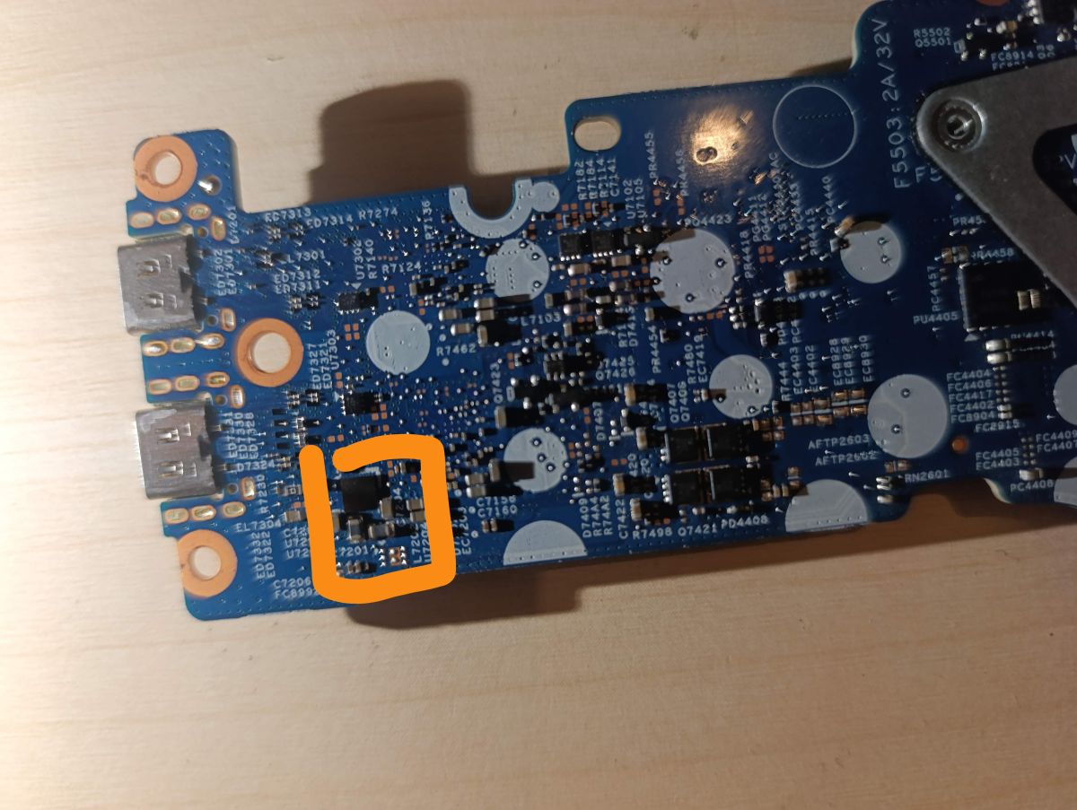

    Hello everyone,

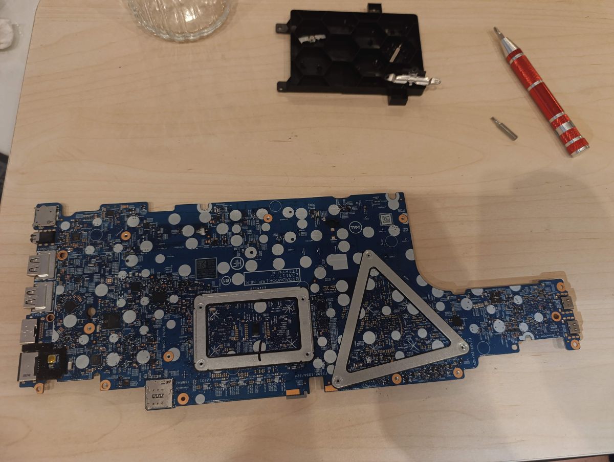

    I have a Dell Precision 3571 (i9-12900H, RTX A2000) that stopped working after it was dropped directly onto the USB-C charging connector, which broke and caused damage to the charging circuit.
    The laptop no longer turns on and shows the following LED diagnostic code: 1 amber blink + 6 white blinks (EC code flow error according to Dell service manual).

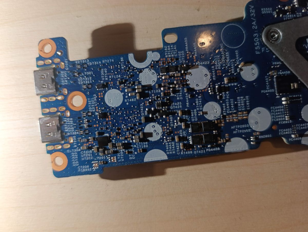

    After inspection, I identified a black component with no visible marking located near the two USB-C ports on the daughter board (board reference: BROADMOOR15P MLK 203117-1) that gets very hot when power is applied.
    I am attaching a photo of the board with the component circled.
    My questions:
    Can anyone confirm the exact reference of this component? (I suspect it could be a TPS65988 or similar USB-C PD controller)
    Is the full schematic for this board available?
    Would replacing this component fix the charging/boot issue?
    Thank you very much for your help.

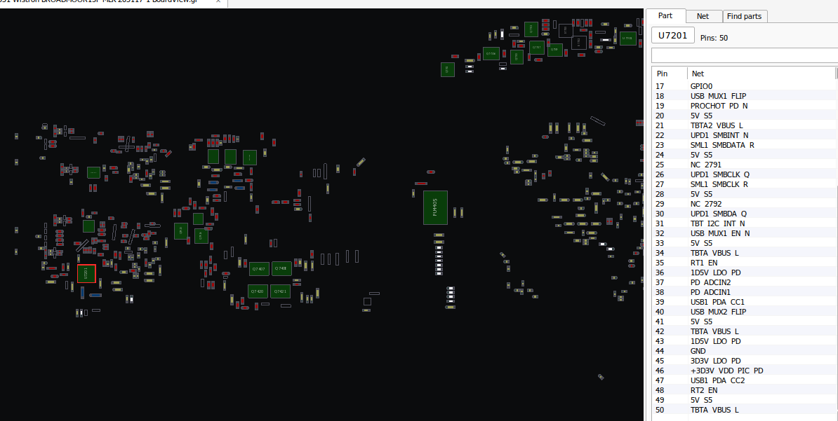

    50-pin BGA chip identified by pinout and balls

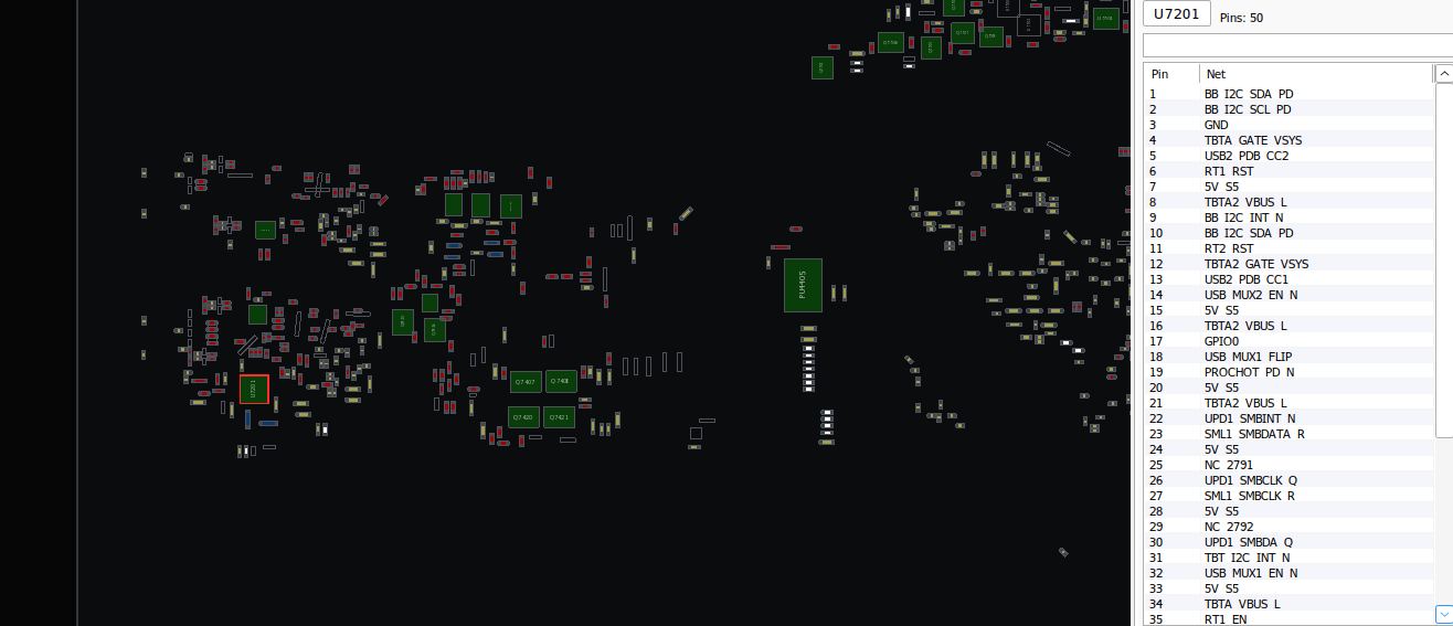

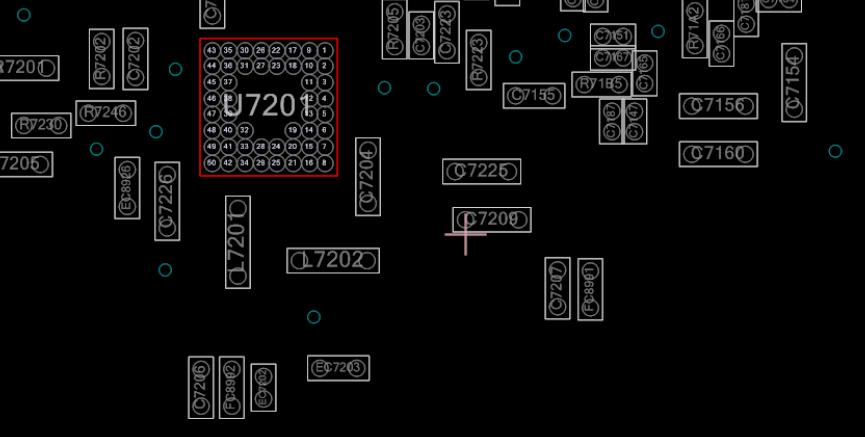

    boardview downloadable https://www.elvikom.pl/schemat-dell-latitude-...admoor15p-mlk-203117-t70580.html?hilit=203117 unfortunately there is no information in it about the installed components.
    It is a 50 pin BGA chip. Maybe you can find it by the leads. I am attaching pictures with pinout identification and ball placement.
    Boardview screenshot with PCB layout and U7201 (50 pins) pin/net list on the right.
    Boardview PCB screenshot; right panel lists U7201 pin table (50 pins) Boardview PCB screenshot; right panel lists U7201 pin table (50 pins)
    Boardview screenshot showing J720 area and a 50-ball BGA pinout diagram in a red box

    Do you have any descriptions on the U7201 housing ?
    In my opinion, Dell service remains (expensive).

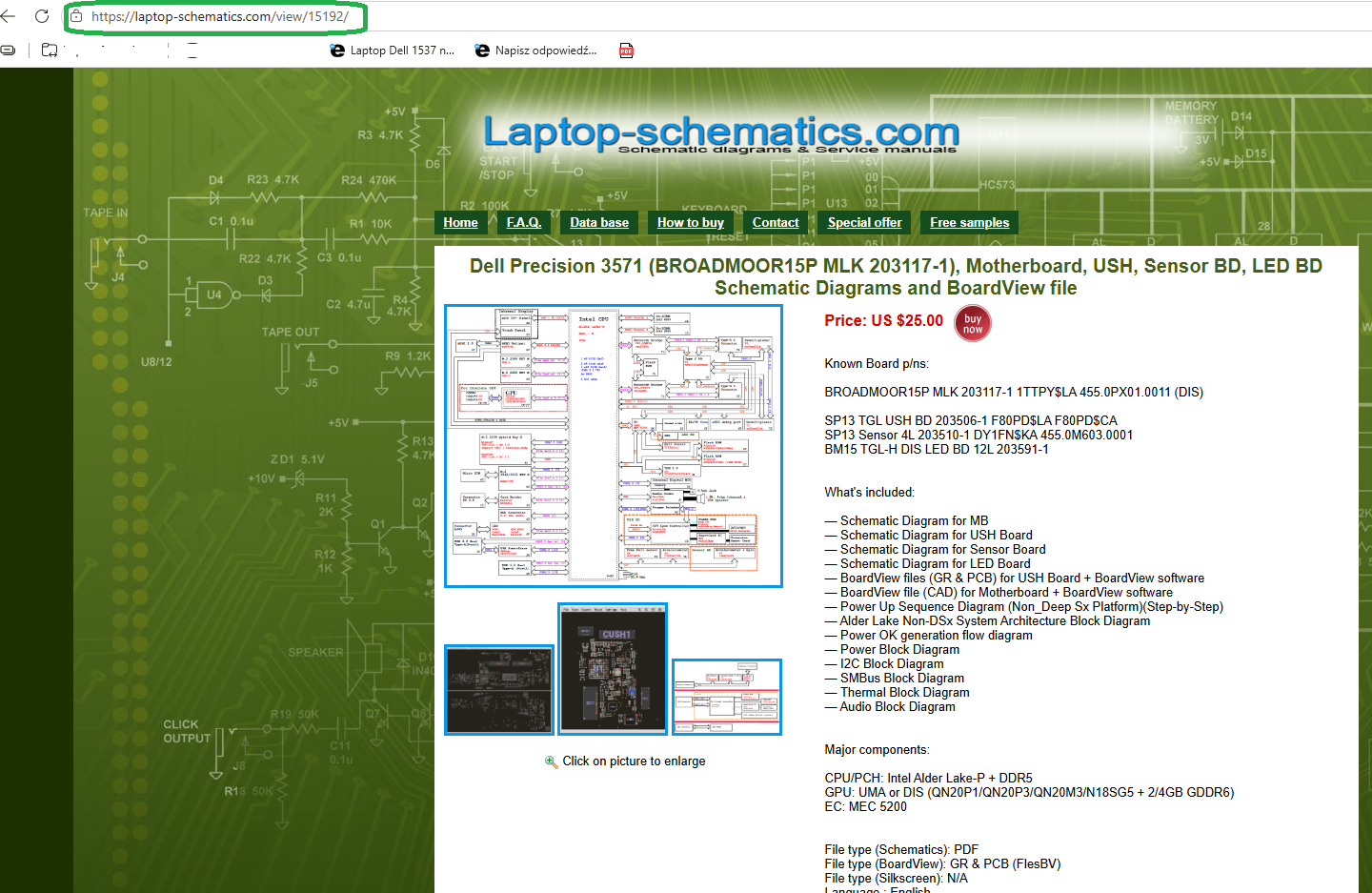

    I found a paid SM (US $25 ) under this model (203117-1)
    - they send to email after payment
    - type in(google.com) the phrase: Dell Precision 3571 shema, you will quickly find a contact for SM

    - this is TPS65994AE (AD)

    It's not TPS as you write , look in Link_ from 11:27 , shown this TPS , then after spilling its pins

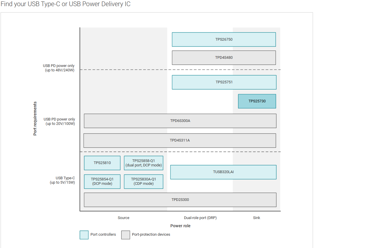

    Possible ctrl USB_C+PD below
    Dell Precision 3571 no power after USB-C drop, 1 amber 6 white
    plus is
    Spoiler:
    AP33772 USB Type-C™ PD Controller USB-C
    * 4mm x 4mm x 0.5mm W-QFN4040-24 package
    * PD3.0/PPS support with up to 100 W power
    CYPD5126-40LQXIT similar in Dell Latitude 3310 (board 19717-1 )
    CYPD5225-96BZXI to BGA 96-pin
    STUSB4500QTR jw qfn24, working circuit
    url=https://www.allaboutcircuits.com/news/stusb4500-usb-type-c-power-delivery-controller-sink-stmicroelectronics/]Link
    CCG3PA jw, 24-pin
    MCP22350 28-pin
    TPS65988 to qfn59

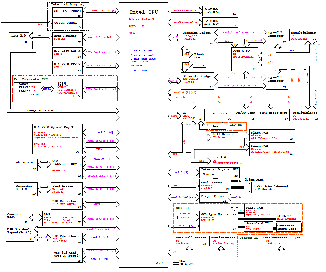

    Thank you very much for your help and for the boardview link!
    After further investigation, we were able to find the block diagram schematic of the Dell Precision 3571 (BROADMOOR15P MLK 203117-1), which clearly shows that the USB-C Power Delivery controller used is the TPS65994AEYGBR from Texas Instruments.
    This matches perfectly with your description: it is indeed a 50-pin BGA chip located near the two USB-C connectors on the board.
    We have already found the component on AliExpress (TPS65994AE, BGA package) and will bring it to a local technician
    Block diagram of a laptop platform with Intel Alder Lake‑P CPU, DDR5 SO‑DIMM, GPU, USB‑C and HDMI
    for BGA rework (reflow and replacement).
    The laptop was dropped directly onto the USB-C charging connector, causing a short circuit that killed this chip (it gets very hot when power is applied).
    We will update this thread after the repair to confirm if the TPS65994AE was indeed the only faulty component.
