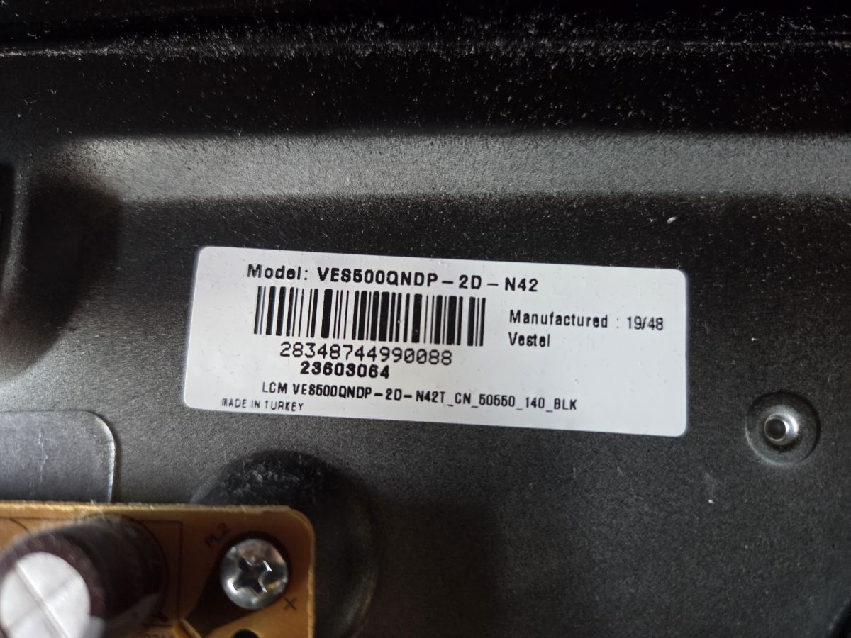

    panel code? VES500...
    post also a photo of the tcon module

    "I am sorry, but opening the TV and removing the metal shield is too complicated for me as a lady/non-technician. I can't take a photo of the T-CON board. But I am 100% sure about my Vestel VPA code: 10124570 and Barcode: 8348744. This is an original, unmodified JVC LT-50VA6900. Can you please find the upgrade_loader.pkg based strictly on this factory 10124570 code?"

    based on my research, panel should be VES500QNDP-2D-N42
    here is the software link
    the software is from a Toshiba, it will change only the startup logo
    copy the file upgrade_no_tvcertificate.pkg on an empty usb stick
    insert the usb stick in the tv
    then plug the power cord: the recovery will start automatically
    let me know if it works

    "Thank you so much for the Toshiba software! Before I proceed with flashing, I just wanted to ask if you happen to have the exact file for VES500QNDP-2D-N43 (since mine is N43, not N42)? If you don't have the N43 version, do you think using this N42 Toshiba software carries a high risk of inverted picture or solarized colors for my N43 panel? Thank you again for your amazing help!"
  • #6 21944622
    billobirillo
    Posts: 1136
    Help: 337
    Rate: 790
    panel VES500QNDP-2D-N43 has a different tcon than N42
    the software for N42 works, but with high risk of inverted picture or solarized colors
    it's not a problem, you just need to repeat the usb recovery with the correct file
    here is the correct file for N43 panel link
    from a F&U model

    Thank you so much for your amazing support! You were absolutely right from the beginning. I decided to open the TV just to be 100% safe, and I physically verified that the panel is indeed VES500QNDP-2D-N42. I will use your first link (the Toshiba software). I am going to flash it via USB now and will let you know how it goes. Your expertise is highly appreciated!
