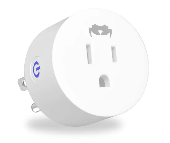

Crabtek Smart Plug 10A CTE-P13 - RTL87X0C WBR2 Tuya Cloudcutter OTA flash
remleikawura 12 1
  • CTE-P13 successfully flashed via Tuya Cloudcutter
    #1 21951905
    remleikawura
    Posts: 7
    Crabtek Smart Plug 10A (CTE-P13)
    Tuya firmware version: v1.1.0
    Tuya-Cloudcutter OTA Flashable: (YES) Using oem_rtl8720cf_rnd_switch profile
    Config:
      "vendor": "Tuya",
      "bDetailed": "0",
      "name": "Crabtek Smart Plug 10A,
      "model": "CTE-P13",
      "chip": "RTL87X0C",
      "board": "WBR2",
      "flags": "1028",
      "keywords": [
        "TODO",
        "TODO",
        "TODO"
      "pins": {
        "11": "Btn;1",
        "14": "WifiLED;0",
        "19": "Rel;1"
      "command": "",
      "image": "",
      "wiki": ""
    Images:
