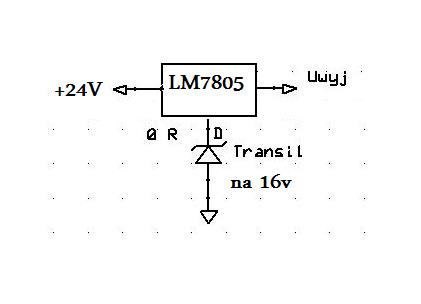

    inincjusz
    Posts: 114
    Rate: 10
    From the posts above, everything is clear and logical to me, but... I came across such a case. What did the poet mean????
    The patient is the automation controller, some inputs/outputs have disappeared, there is no power to the operational amplifiers.
    The system is based on a 7805 smd 8 pin stabilizer, the diode in question is BUM GP716, the internet is silent, I assume it is a bidirectional 17v one
    The effect is that the stabilivolt has no ground reference point and does not work, nothing heats up
    the diode on the diode test behaves like a normal unidirectional diode, I thought it was in one direction, I soldered it in the opposite direction and nothing.
    I don't understand this way of using transil
    • Transil - please help me understand the principle of operation? transil.JPG (10.3 KB) You must be logged in to download this attachment.
  • #13 18607804
    TvWidget
    Posts: 4426
    Help: 472
    Rate: 700
    This is a quite common way to increase the output voltage of the stabilizer. Most often, it's about gaining a little height. For example, the stabilizer is at 3.3V and the diode is connected in the forward direction (voltage ~0.65). The output will be 3.3+0.65=~4V. 3.3V stabilizers are cheap and easily available. The same cannot be said about the 4V ones.
  • #14 18608472
    inincjusz
    Posts: 114
    Rate: 10
    However, yesterday's fatigue came out today and I used to increase it with regular diodes
    Thanks
