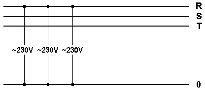

    Is it possible to check with a meter what voltage flows in the power socket, i.e. 380 V?

    Of course. Meter between each phase and neutral ~230V.

    OK, but with 3 phases and zero?

    Between each phase and zero.

    • How to measure the voltage in a three-phase network? 3fazy.gif (1.49 KB) You must be logged in to download this attachment.

    Don't mislead people!!!
    The voltage of 400V is the phase-to-phase voltage (measured between any two phases), and the voltage between each of the phases and "neutral" is 230V.

    oopss, lechoo You're 100% right, I made a fool of myself.
    Corrected drawing.
