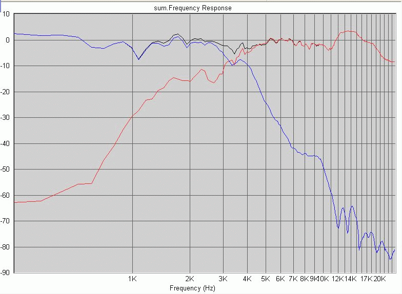

    I paste one crossover. She was also for STX GDWK 11-200, Tonsil GDWK 11-100.
    • Connecting 6 Ohm STX Woofers and 8 Ohm TVM Tweeters to Diora WS442 Amp soundwave_charakterystyka_stx_arv.gif (105.64 KB) You must be logged in to download this attachment.
    • Connecting 6 Ohm STX Woofers and 8 Ohm TVM Tweeters to Diora WS442 Amp soundwave_zwrotnica_stx_arv.gif (9.96 KB) You must be logged in to download this attachment.

    You will not burn, because this speaker is more effective than the bass one, so it will work with an attenuator. I would prefer the tonsil. Look for the Allegro. As much as a lot depends, the treble affects the perception of the entire frequency range. The ARV is sharp so the whole thing will be sharp. A good example are Yoshi's speakers on the ARN - they start with ARV and end up with Audaxes for PLN 100 each :D
