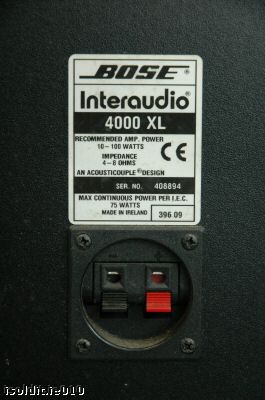

    Is this connection of these speakers correct? notice that the speakers have 4-8 ohms and the amplifier has 6-16 ohms? can it play like that

    Columns must be either 4 or 8R - take the meter and measure.
    If they have 8R you can play it safe, if 4R is already below the permissible impedance and such connection is not recommended. It may damage the amplifier.

    thus they write:
    Understanding 4-8 Ohm Speakers: Impedance, Amplifier Compatibility, and Selection Guide
    and what a man should know when he buys such speakers and does not have a meter with him
    Added after 41 [minutes]:
    I checked these loudspeakers in the 200 range, it shows 4.3 ohms, so in a word, a failure, I will buy another amplifier, and in 2 weeks a party; /.

    Seems to be getting a little hysterical. Concluding. Your loudspeakers have a minimum impedance of 4 ohms, and your amplifier is 6 ohms. If you absolutely want to apply them to this amplifier JUST, you will apply them and nothing so terrible should happen. Just don't set the volume to a maximum of, say, 60%. Check that it has the correct safeguards on the secondary side. So not protection from the network side. If it is an amplifier that is relatively well made and not "trimmed", then first the protection in the power supply will "instruct". And at one party, the controlled one shouldn't burn up like that right away. This is a bit of hysteria and data fetishism. It is supposedly a DIY. So it is also uncertain whether his data is correct. The 6 ohm impedance in the amplifier is a bit strange, rather rare.

  1. Bring a portable multimeter.
  2. Measure Rdc; 3 Ω–3.6 Ω hints at 4 Ω, 6 Ω–7.2 Ω hints at 8 Ω.
  3. Compare with the amp’s minimum rating shown near its binding posts.
