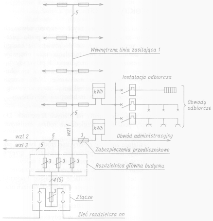

    Installation example: Comprehensive List of 230V Electrical Installation Symbols and Devices
