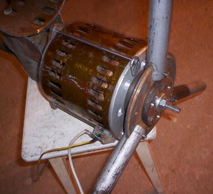

    Here is an example Polish page - experiments with a converted washing machine motor,
    parameters rather bad:
    http://www.elektrownie.tanio.net/motor_pralka.html
    (achieved power of 40 W)
    :cry:
