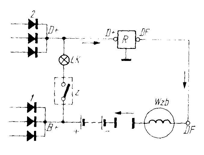

    does the alternator need to be aroused, and if so, how to do it??? thanks

    Sure you must.
    A voltage is applied to the rotor winding, the flowing current creates a magnetic field, the magnetic field "crosses" the stator winding, a current is induced in the stator windings.
    This current is rectified in a six-diode bridge.

    There is a bulb in the excitation circuit of the alternator - the one that signals the lack of charging, its burnout can lead to a situation where the alternator will not excite.

    this bulb is probably a joke
    She is just a loading indicator. The alternator rotor is not powered by it.

    This bulb is exactly the same. From the battery we give + to the light bulb and then we go to the alternator connector. This connector seems to be the output of the auxiliary rectifier of the alternator, rectifying the current for the excitation system. The current that the bulb passes through is enough to energize the alternator.

    Hello, regarding the alternator, it is so that if it has a 6-diode rectifier, it is separately excited, and if the alternator has an auxiliary rectifier, it is a self-excited alternator (the simplest example is an altek from Polonaise) and if such an alternator is properly connected to the voltage regulator and the rotor it will rotate at least with the minimum revolutions needed to generate the nominal voltage (usually 400-500 rpm) such an alternator will generate voltage at the output terminal without connecting the battery, and the charging indicator works (lights) on the basis of the voltage difference between the rectifier output auxiliary and the voltage of the battery. :D

    if we take it out with the engine running (i.e. it is charging), then yes, because it is already excited, but if the bulb is not there before starting, the excitation current will not flow. But it is not always the case that without a light bulb it will also work

    Hello. Here is the solution to the riddle of why the light bulb goes off and on.
    Z-ignition off
    R-voltage control
