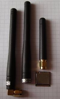

The Dorji Company has made available to users of forum elektroda.pl free of charge 20pcs DRF4463F modules based on Silicon Labs Si4463.
This article presents the results of external tests performed for elektroda.pl.
As you can see modules have very small dimensions, but they have a lot of functionality.
The module board is covered with a solid solder mask and the description of the pin makes it easy to test.
The input/output signals can be connected via goldpin strip or soldering wires directly, this helps working in test conditions such as bareboard.
Connecting the antenna can be performed directly on the board or using a short length of the coaxial wire, this should prevent damage to the test conditions.

Depends on the antenna we get different transmission ranges,
coverage map below is for power ~5 mW and different antennas.
The red dot is the base station.
The blue points are places where transmission has been possible.
Dot size depends of signal strength.
Horizontal division is about 50m.
Spring antena:
DAA043SA064S:
DAA043SA100S
