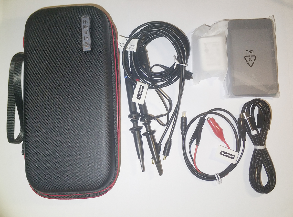

    Upon receiving the product, I performed a simple unboxing. It comes in a high-quality hard case that effectively protects the central unit and accessories inside. The package includes two custom probes, a signal output cable, a Type-C data cable, a charging adapter, and finally the DS100 central unit.

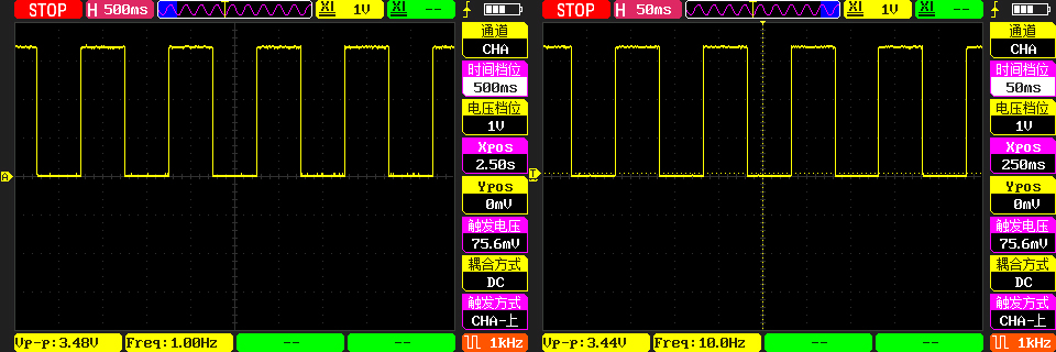

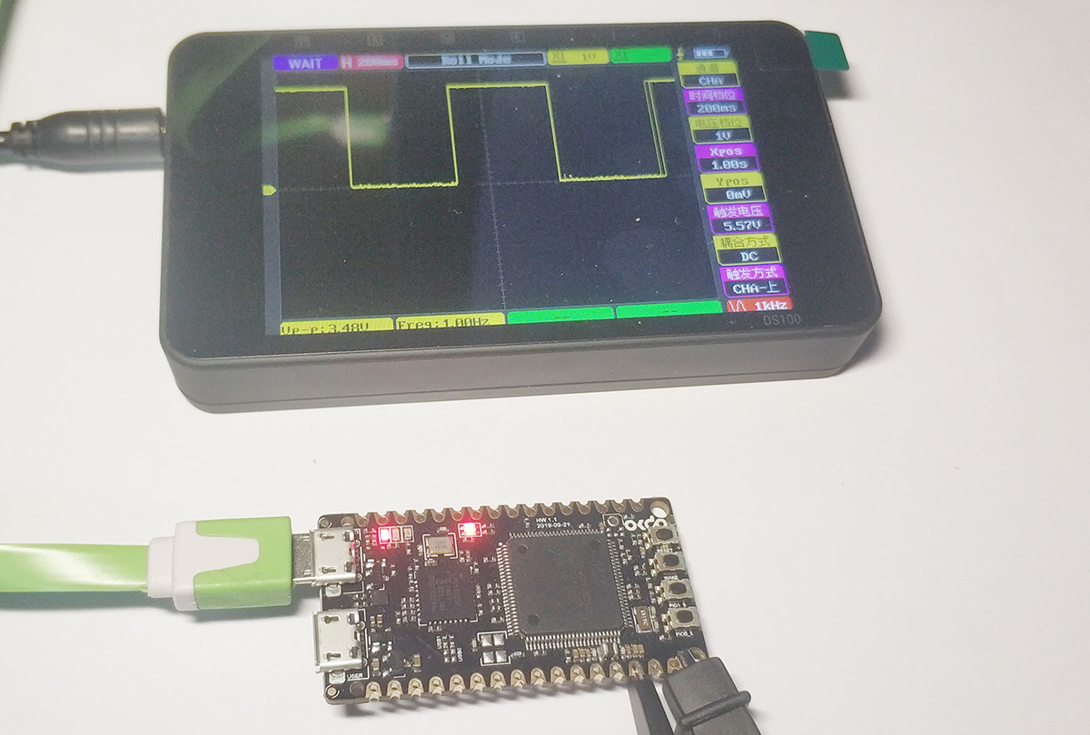

    To evaluate the oscilloscope's performance when measuring waveforms at different frequencies, I built a square wave generator using the OKdo E1 development board (MCU: LPC55S69). This generator primarily uses buttons to change the output waveform frequency, enabling square wave outputs at 1Hz, 10Hz, 100Hz, 1kHz, 10kHz, 100kHz, 1MHz, 2MHz, 5MHz, 10MHz, 20MHz, and 50MHz.
     Zhengdian Atom DS100 Mini Oscilloscope Review: Specs, Features, and Low-Voltage Testing
    First, I measured the 1Hz and 10Hz waveforms using an oscilloscope, and the waveform quality was excellent.

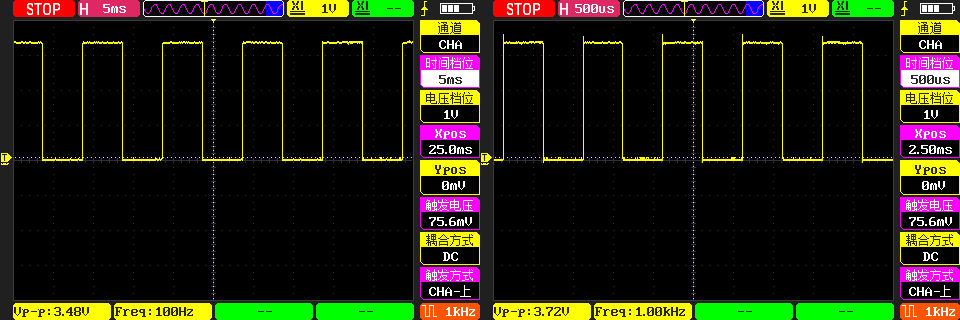

    Measurements at 100Hz and 1kHz were also satisfactory, though the 1kHz rising edge exhibited some overshoot.

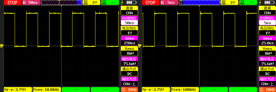

    Measurements at 10kHz and 100kHz showed overshoot on the rising edge again, and now the falling edge also exhibited overshoot.

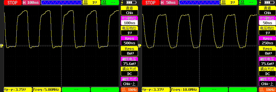

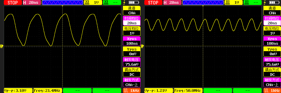

    Measurements at 5MHz and 10MHz show the square wave pattern is still visible but has become distorted.
    At frequencies of 20MHz and 50MHz, the square wave is no longer visible and has essentially become a sine wave. At this point, the third harmonics reach 60MHz and 150MHz, exceeding the nominal bandwidth of 50MHz. Particularly at 50MHz, this equates to only five sampling points per cycle, making waveform reconstruction from five points impractical. Nevertheless, the frequency can still be accurately measured, which is quite commendable.

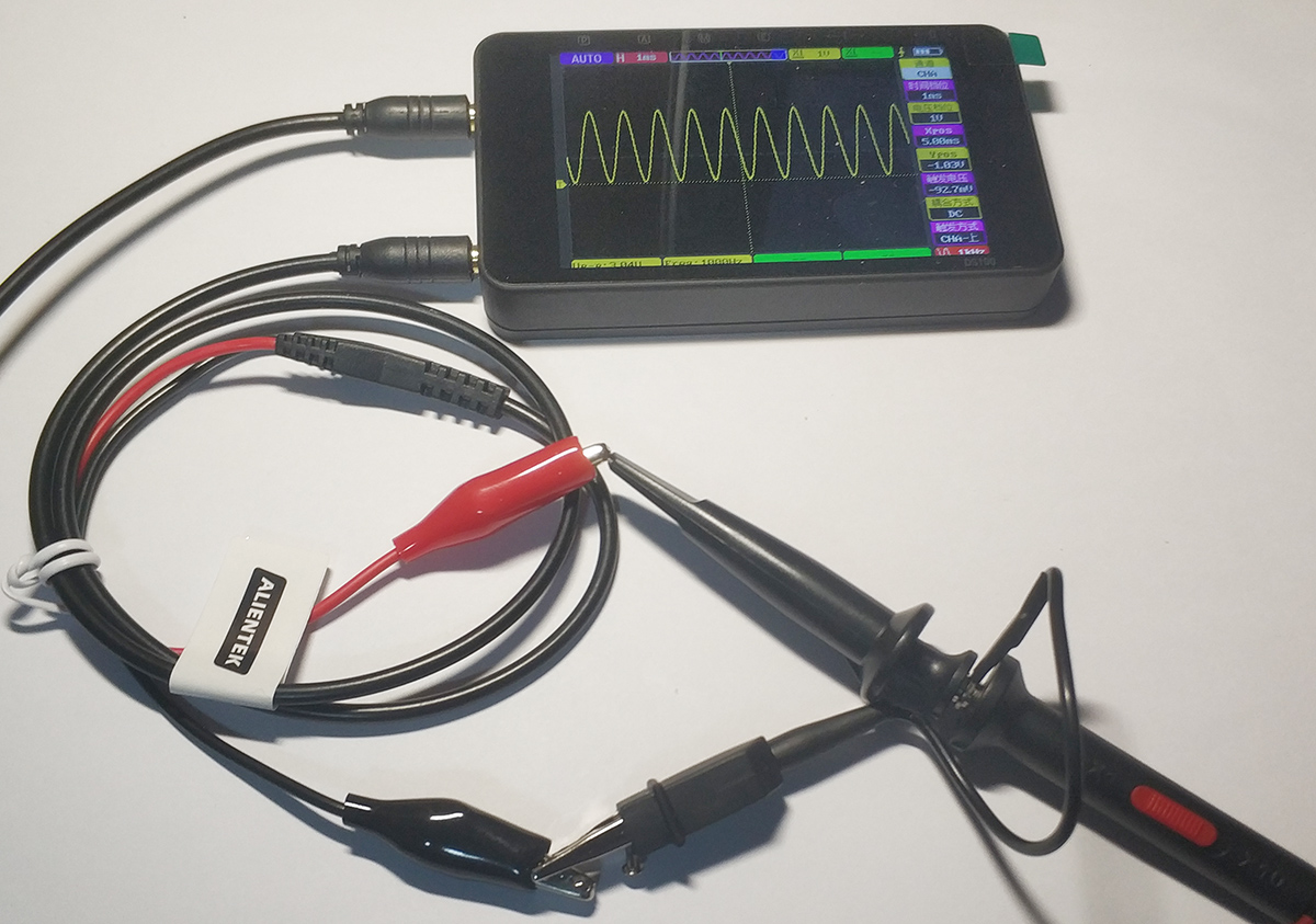

    For mains power measurements, the safest method is to use high-voltage differential probes. However, direct measurement is also possible provided safety precautions are strictly followed.

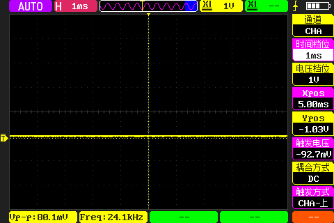

    According to the probe label, the 10X setting can measure 300V AC. Therefore, set the probe to the 10X setting and connect it to the L and N terminals of a 220V AC source. Note that battery power should be used whenever possible for floating ground measurement—do not connect the USB cable.
    Set the oscilloscope channel gain to X10—power on to observe the waveform. The sine wave appears quite good here.

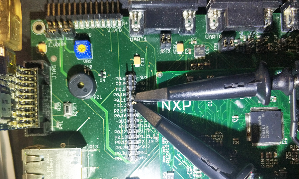

    As an oscilloscope, one of its primary functions is to measure signals for fault analysis. Therefore, we will use IIC signal measurement as an example for testing.

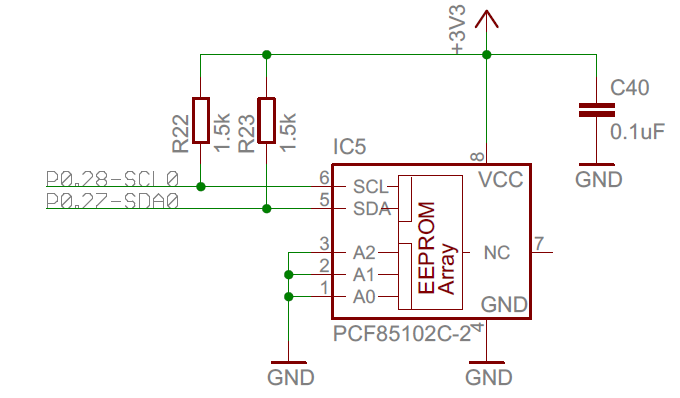

    Here we measure an EEPROM on an I²C interface with a clock frequency of 100 kHz.
    Two probes are connected to the I²C's SCL and SDA lines, respectively.
    The oscilloscope can accurately measure the clock and data signals on the I²C pins. By analyzing the waveforms, we can determine if there are any issues with signal transmission on the I²C bus.

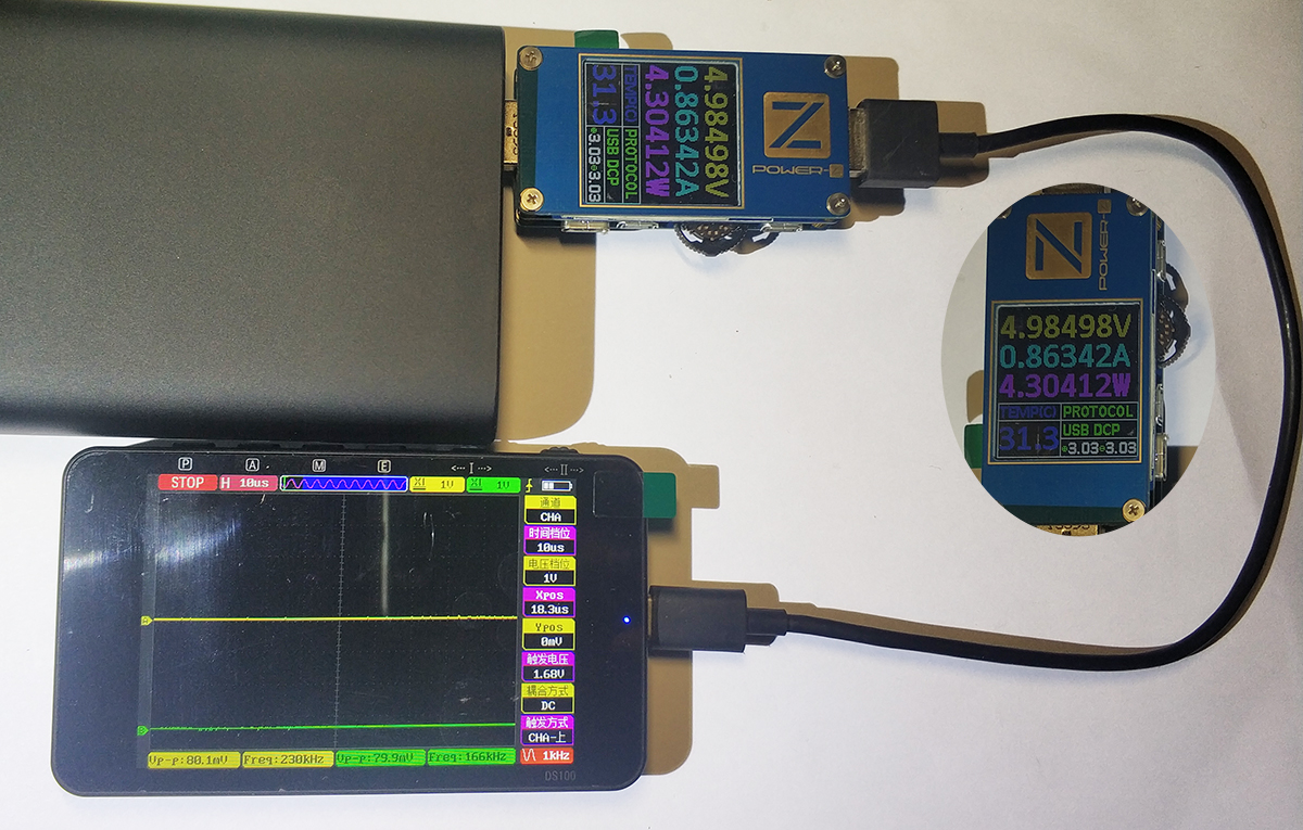

     VIII. Battery Life and Charging
    The parameter list does not specify battery capacity, but it provides an approximate battery life of 7 hours. When I received the device, it was not fully charged. After intermittent use over 3 days totaling about 4-5 hours, the screen rapidly dimmed and the device automatically shut down.
     USB tester and oscilloscope measuring power bank charging parameters
    After the battery was fully depleted, charging began. Rough measurements indicated a charging power of approximately 4.3W, likely the maximum charging power at this stage.
    Based on this measured maximum charging power, the "5-pin, 1-amp" power adapter included with the oscilloscope is reasonably sized.
