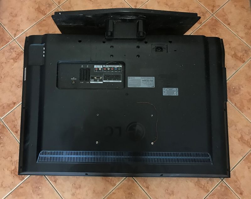

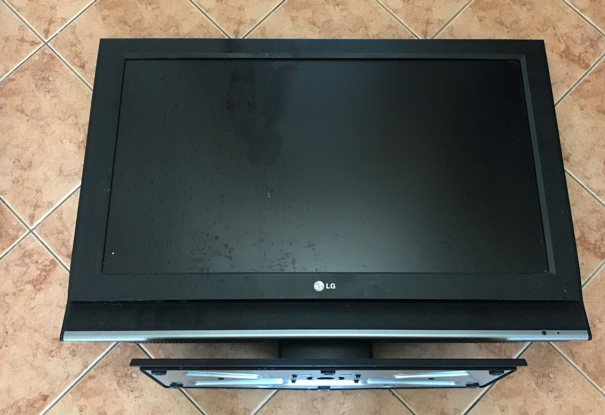

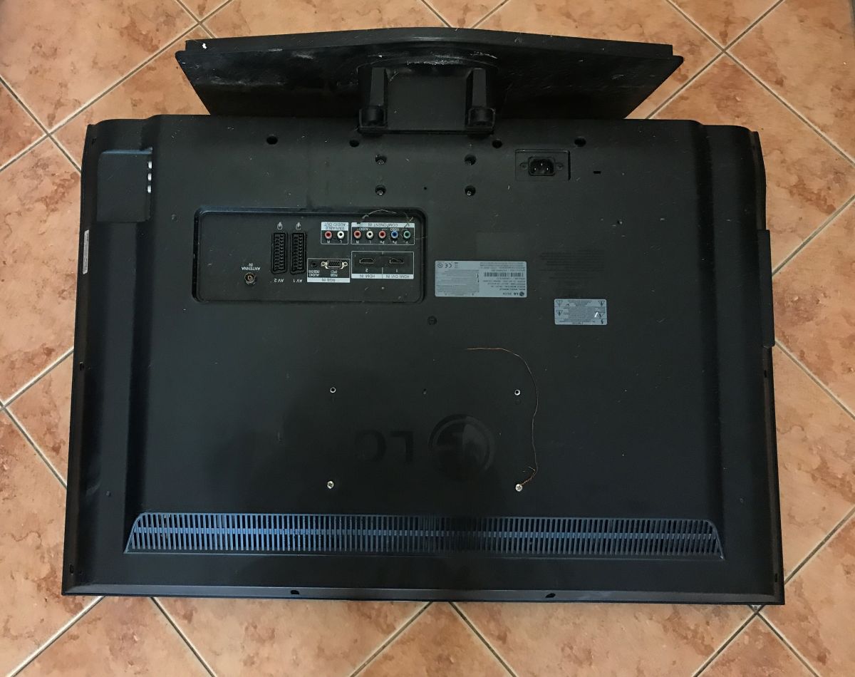

    Today another short presentation of the inside of an old piece of equipment. This time it will be a 32-inch LG LCD TV premiered in 2007, equipment still with fluorescent backlighting, a screen with a resolution of 1366 x 768 pixels. I'll show its interior here and see if anything from inside can be useful for DIY construction.
    Back of a 32-inch 2007 LG TV showing ports and base stand .

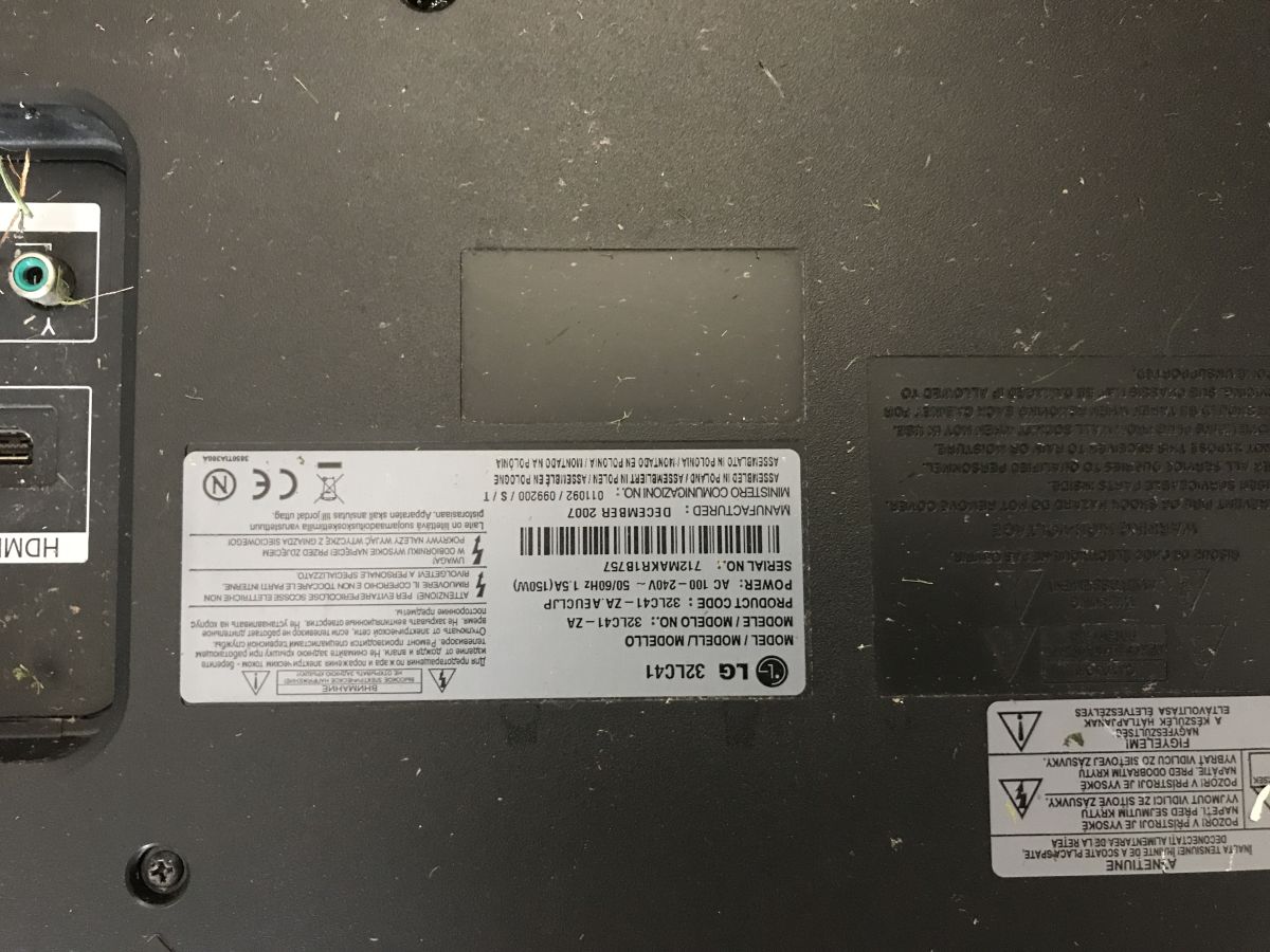

    On the back we have mainly two HDMI ports, two SCART connectors, component and S-Video inputs and an RGB (PC) input. There is also already a rather useless antenna connector - because the TV does not support the DVB-T2 standard, so it will not receive the current digital terrestrial TV channels without an additional tuner.
    Informational stickers on the back of an LG 32LC41-ZA TV chassis .

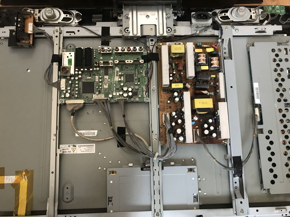

    After removing the rear casing, it is immediately apparent that there are far fewer electronics inside than in plasma TVs. Here we have separately the power supply module, separately the main TV controller module (video processing), and separately the board with the inverter powering the fluorescent tubes. In addition, you can also see the speakers and some side two boards, one with the IR receiver from the remote control, the other with the video connectors.
    Inside view of a 32-inch LG LCD TV showing power and main signal boards. .

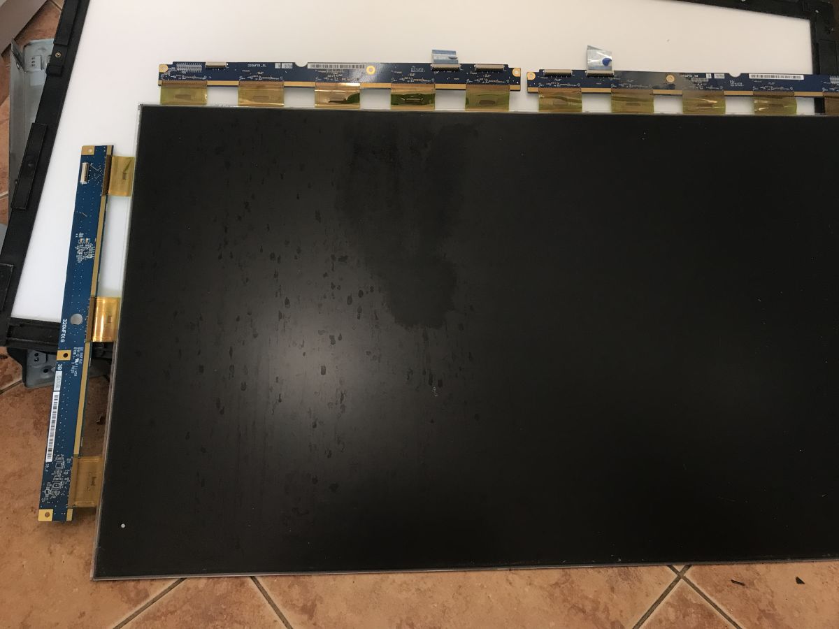

    Further disassembly reveals an additional module - the T-Con - or Timing Controller. The T-Con deals with the control of the matrix, with the LVDS signal being applied to its input. The LVDS itself can be generated from a universal matrix control board, but the T-Con is unlikely to be replaced by a universal board. There have already been topics about LVDS:
    Laptop LCD matrix as independent monitor .
    The second life of a TV with a dead motherboard as a DIY VGA monitor - (anti)guide .
    There are fluorescent tubes behind the matrix, but this is where I didn't look anymore:
    Disassembled LCD panel with signal ribbons and T-Con boards visible. .

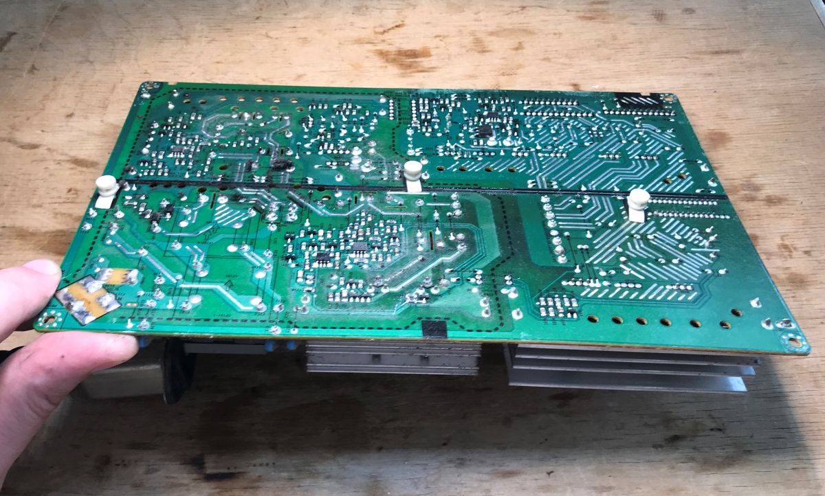

    It's now time to look at the plates.

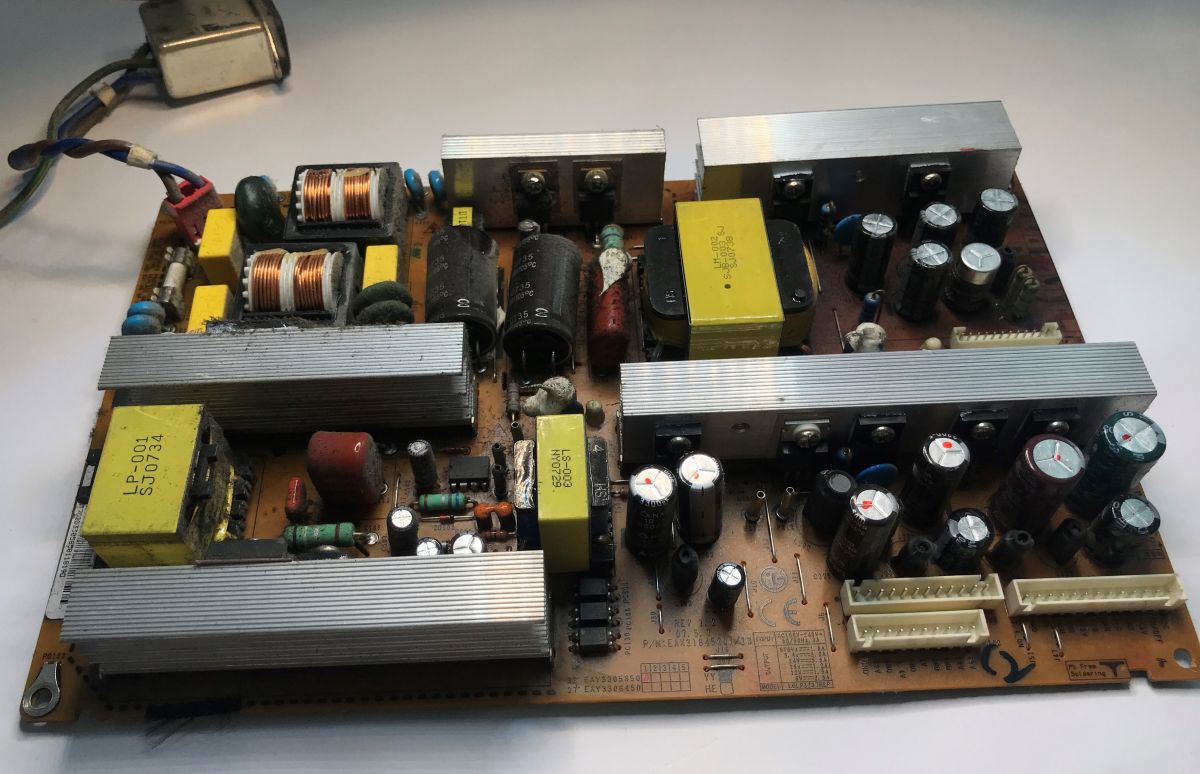

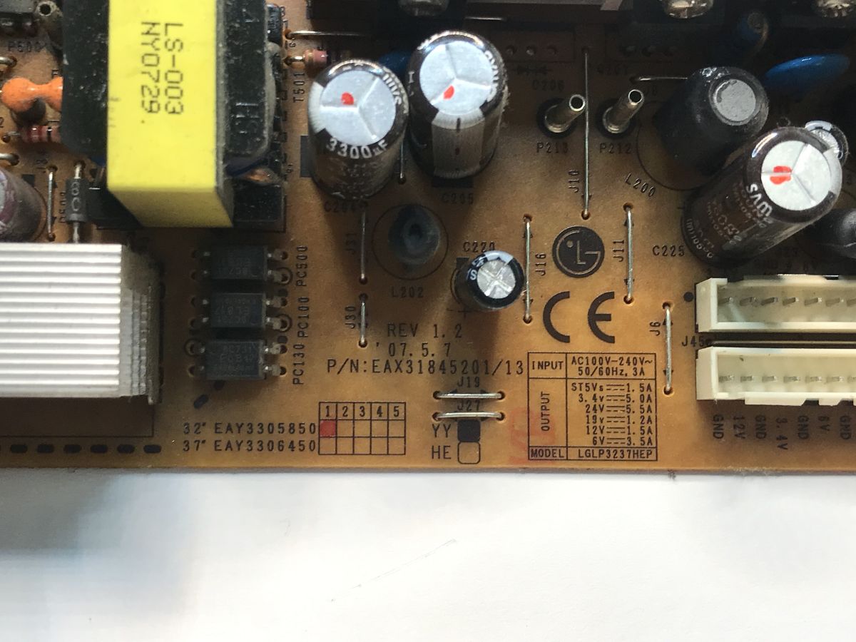

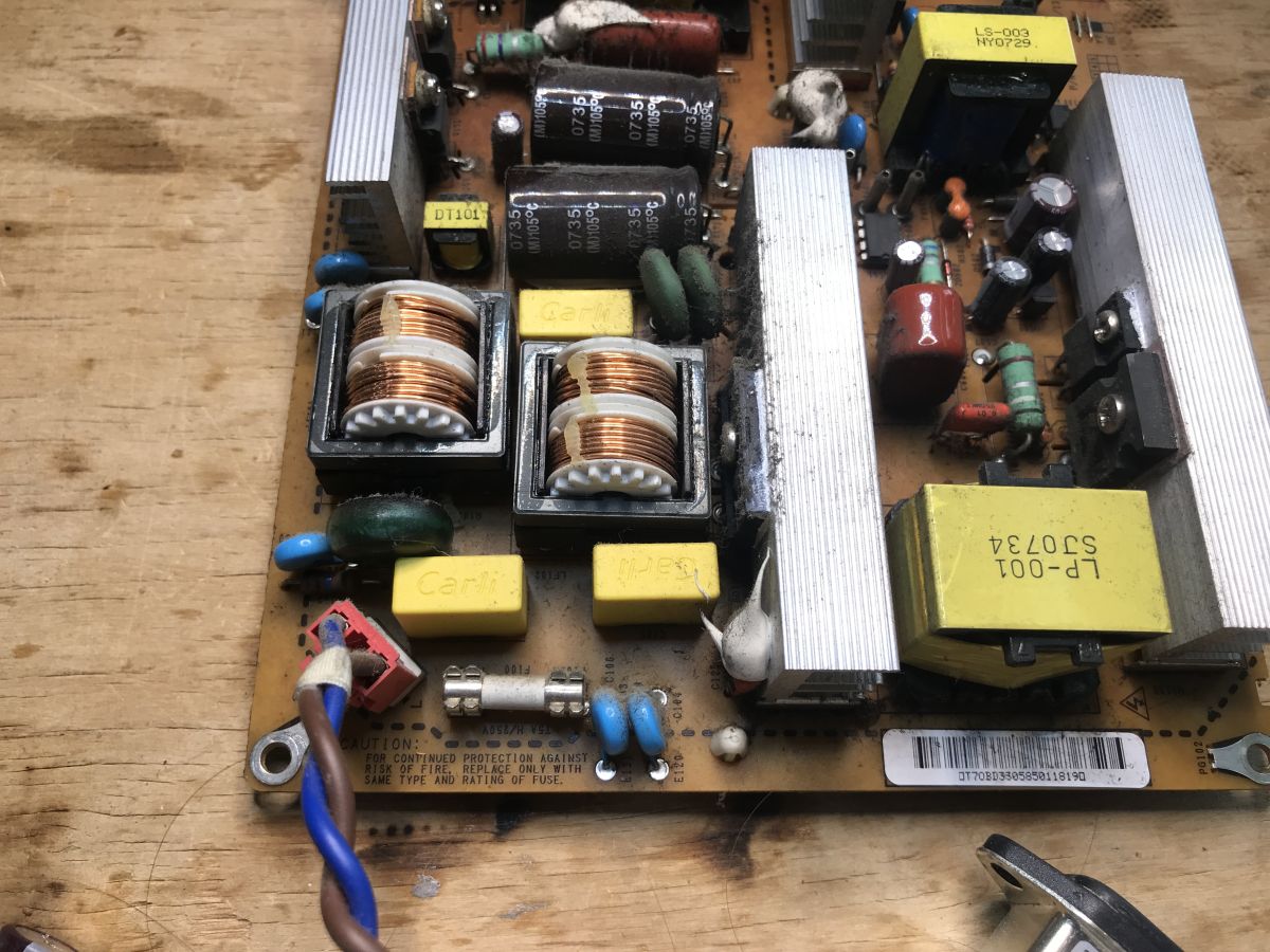

    The power supply is REV 1.2 07.5.7 P/N: EAX31845201/13 - 32" version EAY33058501.
    Power supply board with capacitors, coils, and aluminum heatsinks .
    The power supply module gets the mains voltage at the input and generates lower DC voltages for the rest of the TV. In this case these are 5V standby, 3.4V, 24V, 19V, 12V and 5V, as printed on the board.
    Close-up of LG TV power board with model markings and output voltage details .
    The board itself is primarily made in through-hole assembly, with only a few components surface mounted on the underside of the board. These include the inverter controllers.
    Bottom of an LCD power supply board with visible PCB traces and SMD components .
    At the input of the board we have extensive filters and surge protection, a fuse is of course also present.
    Power supply board with coils and heat sinks from a 2007 LG TV .

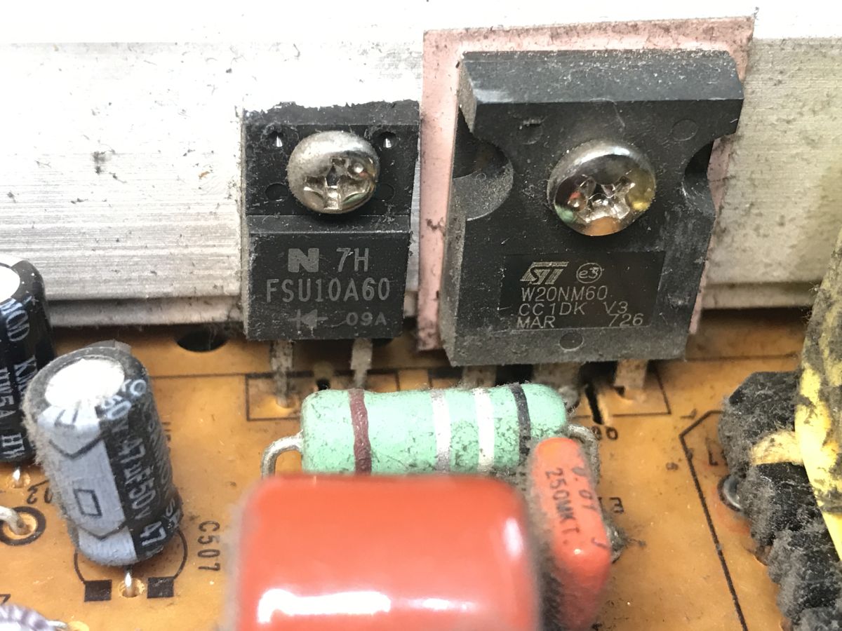

    Next we have a circuit which I have described as an active PFC:
    Close-up of FSU10A60 and W20NM60 transistors mounted on a power supply PCB .

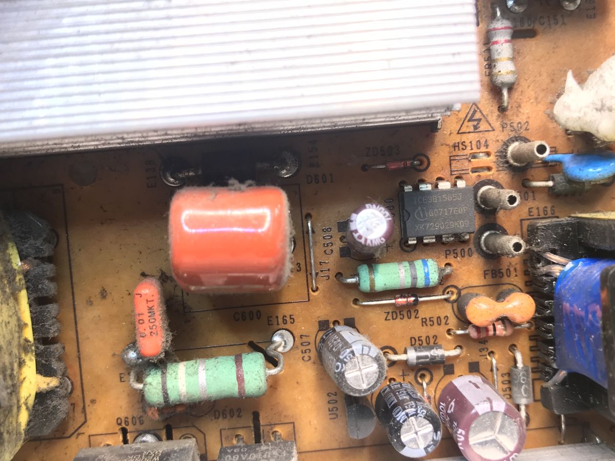

    Standby is implemented based on the ICE381565J:

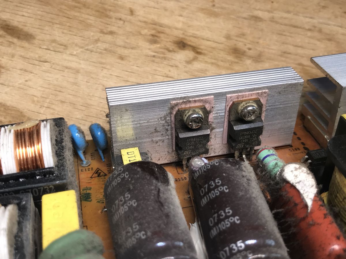

    The main inverter appears to be a half-bridge, based on two identical P9NK60Z transistors:
    Two P9NK60Z transistors mounted to a heatsink on a power supply board. .

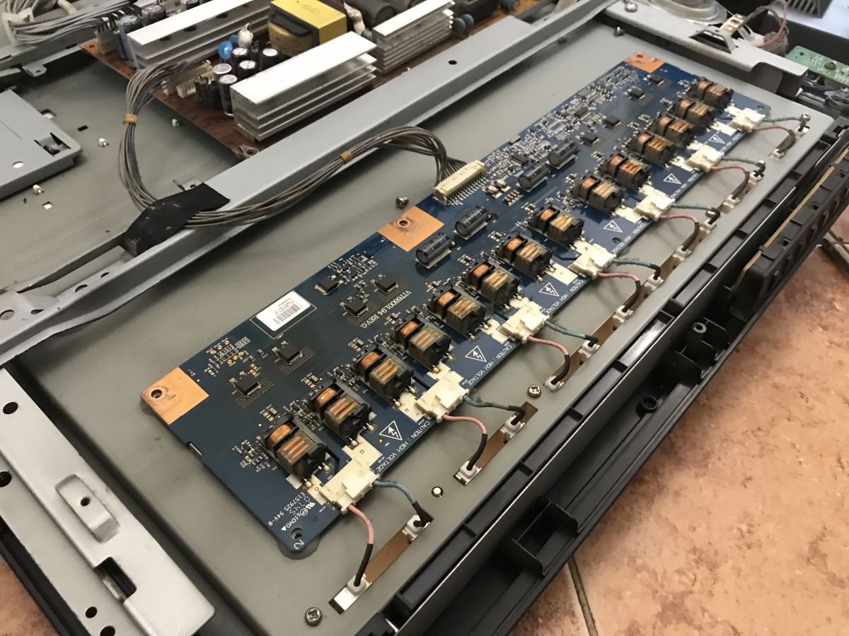

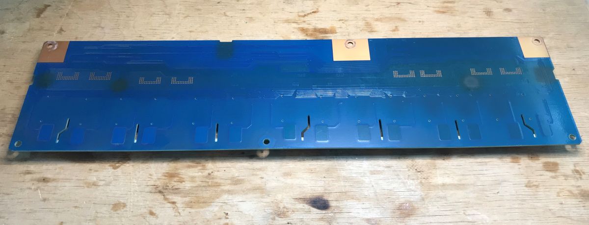

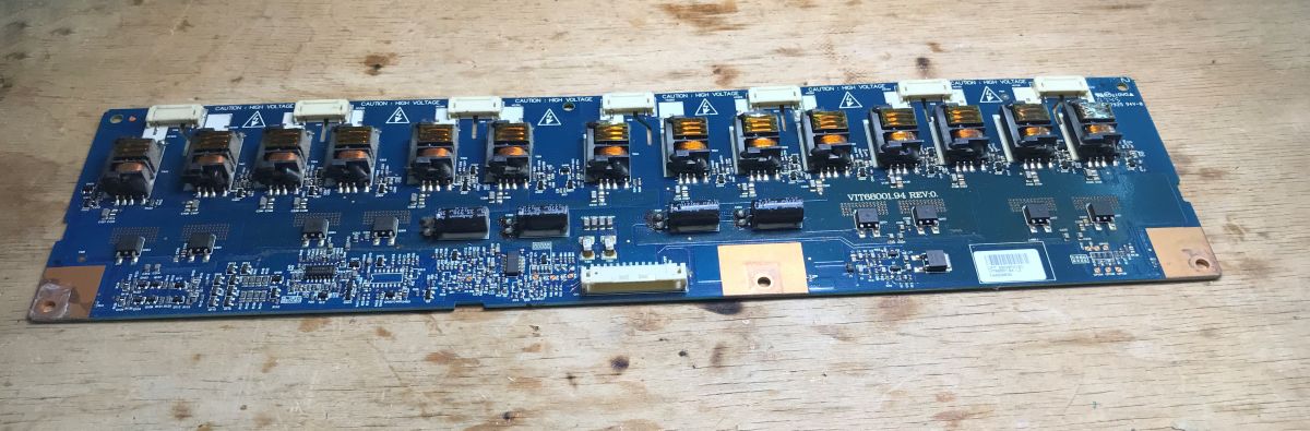

    The power supply from the backlight is a completely separate module. The whole unit is made on a thick laminate to dissipate heat effectively. All components are on one side and the soldermask is removed from the "feet" so that there is better contact with the rest of the TV skeleton.
    Fluorescent backlight power inverter board from a 2007 LG LCD TV model VIT68001.04 REV:0 Blue PCB back side with exposed copper pads and thermal vias .

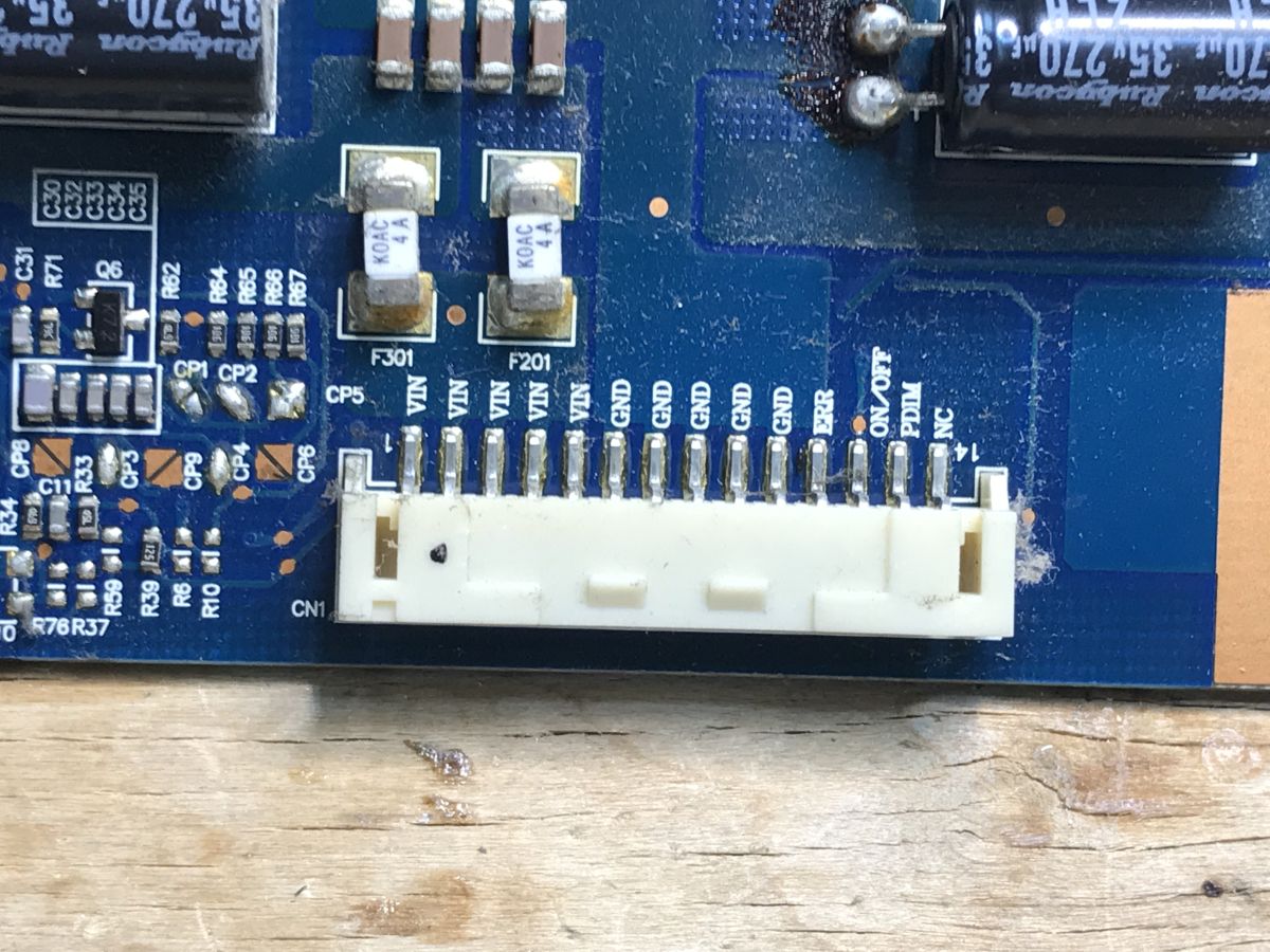

    Getting this module up and running is very simple. Most of the wiring is ground and power, as there is a lot of current flowing. The supply voltage is probably 12 or 24V. In addition, we have the ON/OFF signal and PDIM (dimmer), the P probably stands for pulse/PWM, i.e. control by PWM. In addition, there is also an ERR signal (the controller reports an error with it) and an NC pin, which... is simply not connected.
    Close-up of CN1 connector with labeled pins on LCD backlight power board .

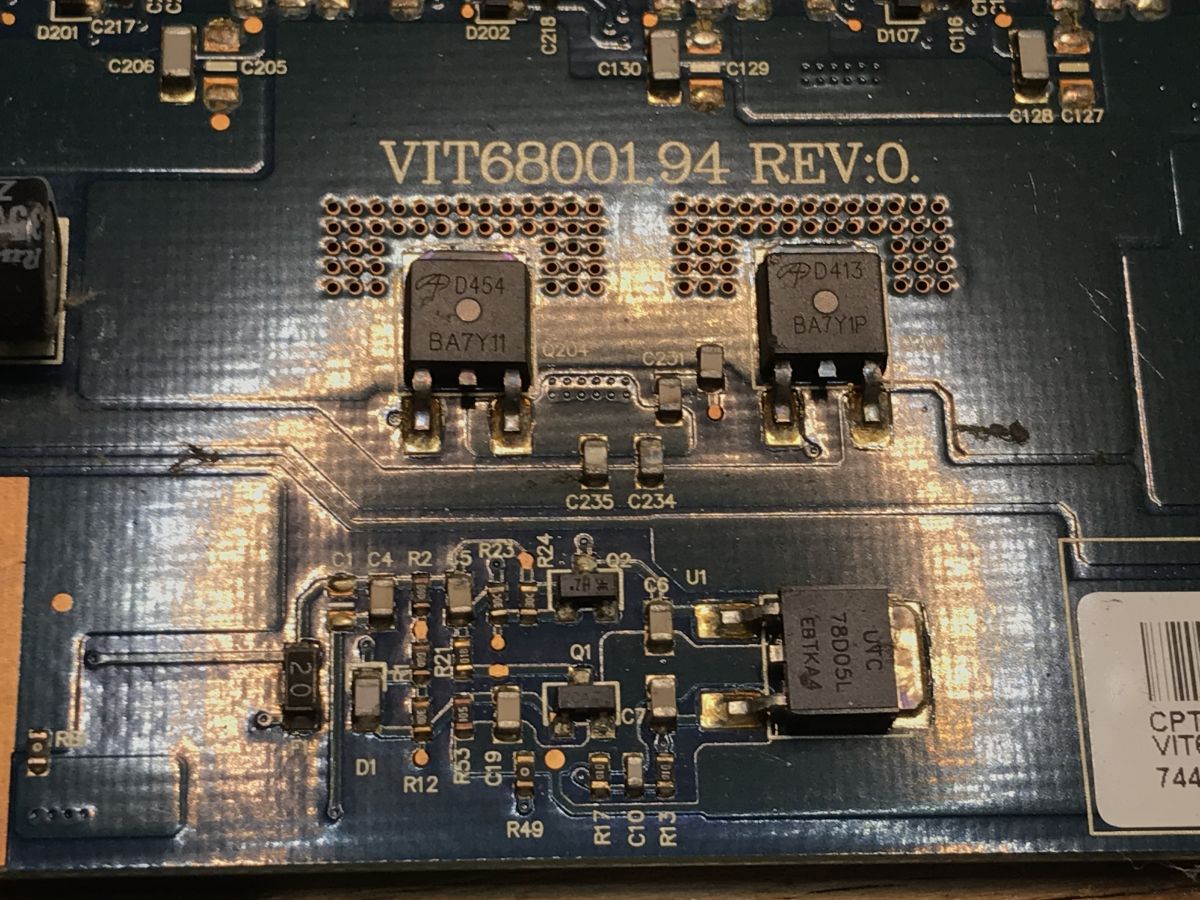

    At the output, the circuit generates a high voltage for the fluorescent lamps - higher than the mains, generally around 1000V.
    The greatest power is given off here by the transistors, of which there are as many as eight. They are soldered to copper spouts and vias facilitate cooling.
    Close-up of PCB with D454, D413 transistors and 7805L voltage regulator in LG LCD TV. .

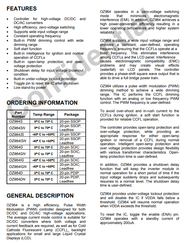

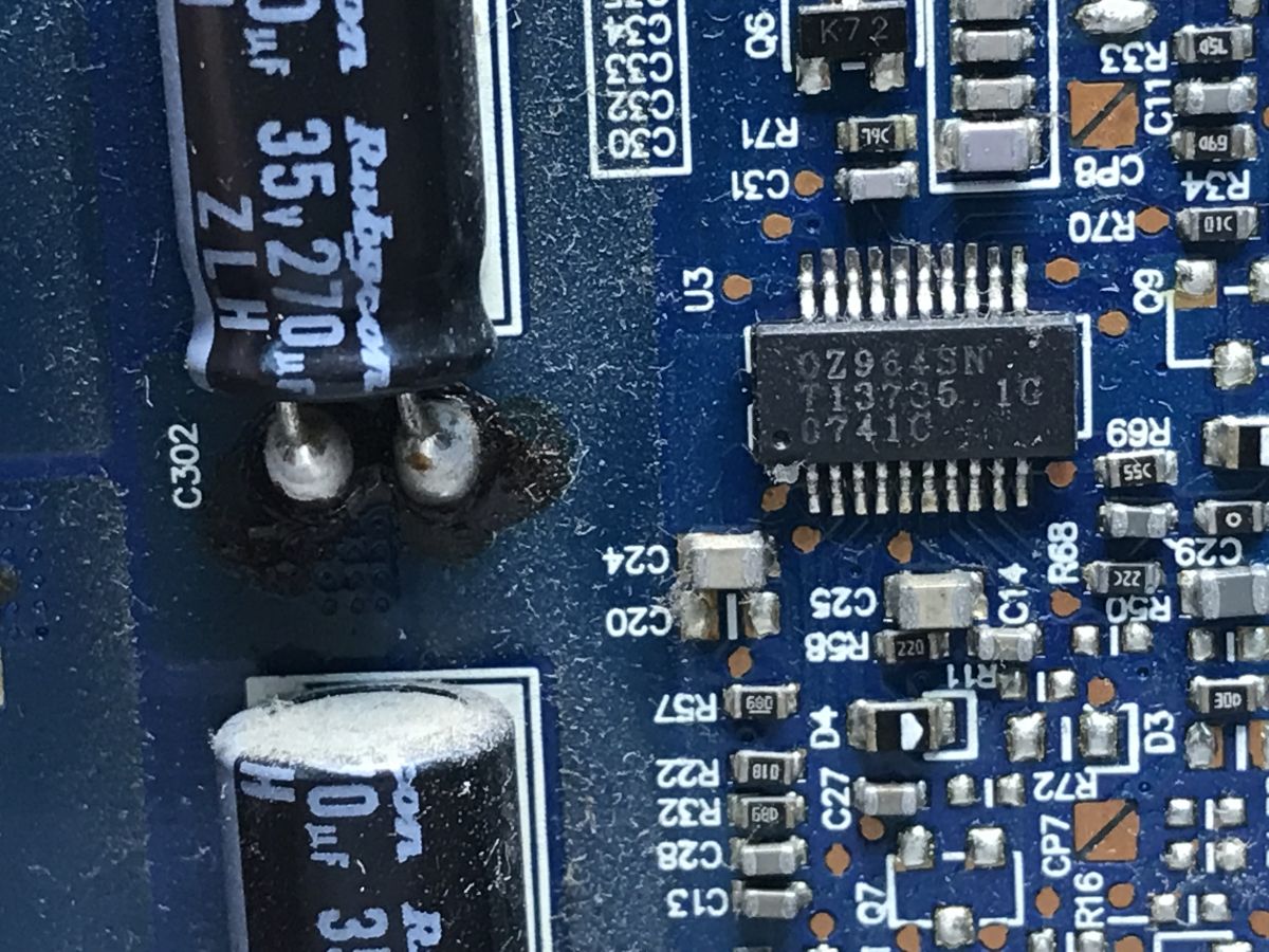

    The main inverter controller from the backlight is an OZ964SN.
    Close-up of OZ964SN chip on a blue PCB with capacitors and SMD components .
    OZ964 controller datasheet with feature list, ordering info, and general description .

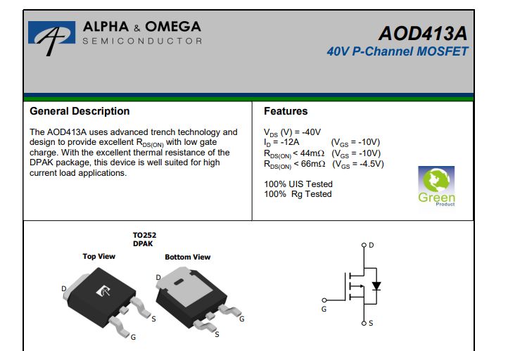

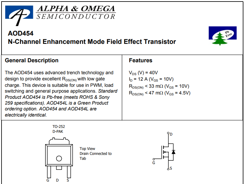

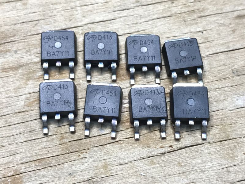

    Rather, the most interesting transistors to recover here are D454 and D413. Complementary pairs.
    Excerpt from the AOD454 datasheet showing key specs and circuit symbol. Excerpt from datasheet of AOD413A P-MOSFET transistor, rated 40V .
    The low Vgs parameter shows that they can potentially be easily driven from the microcontroller.
    They can be easily soldered out, but here hot air is already required.
    Eight D413 and D454 transistors on a wooden surface, top-down view

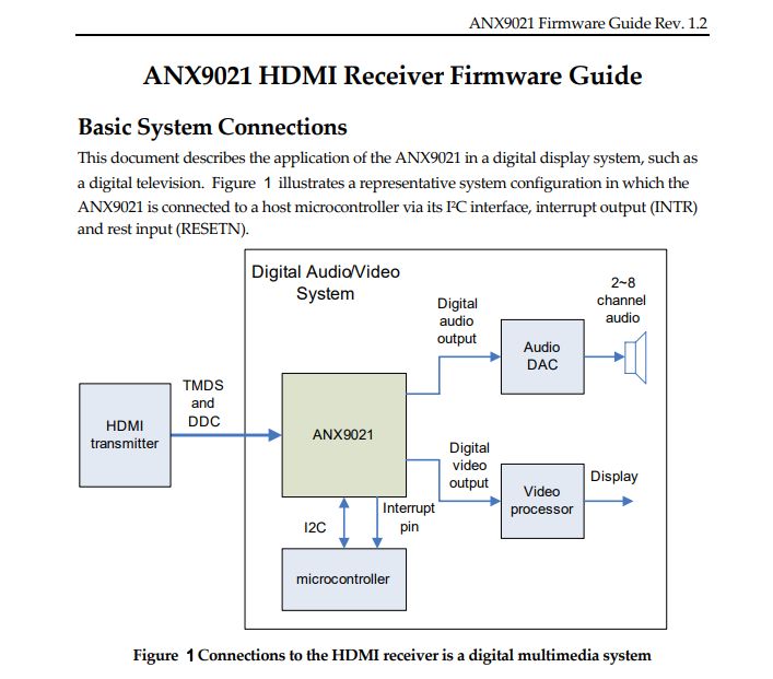

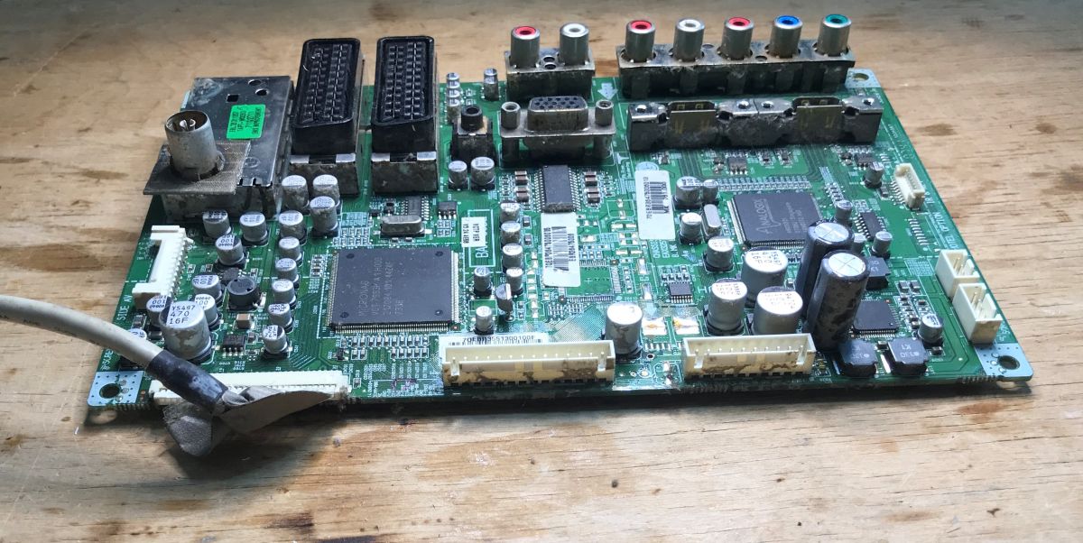

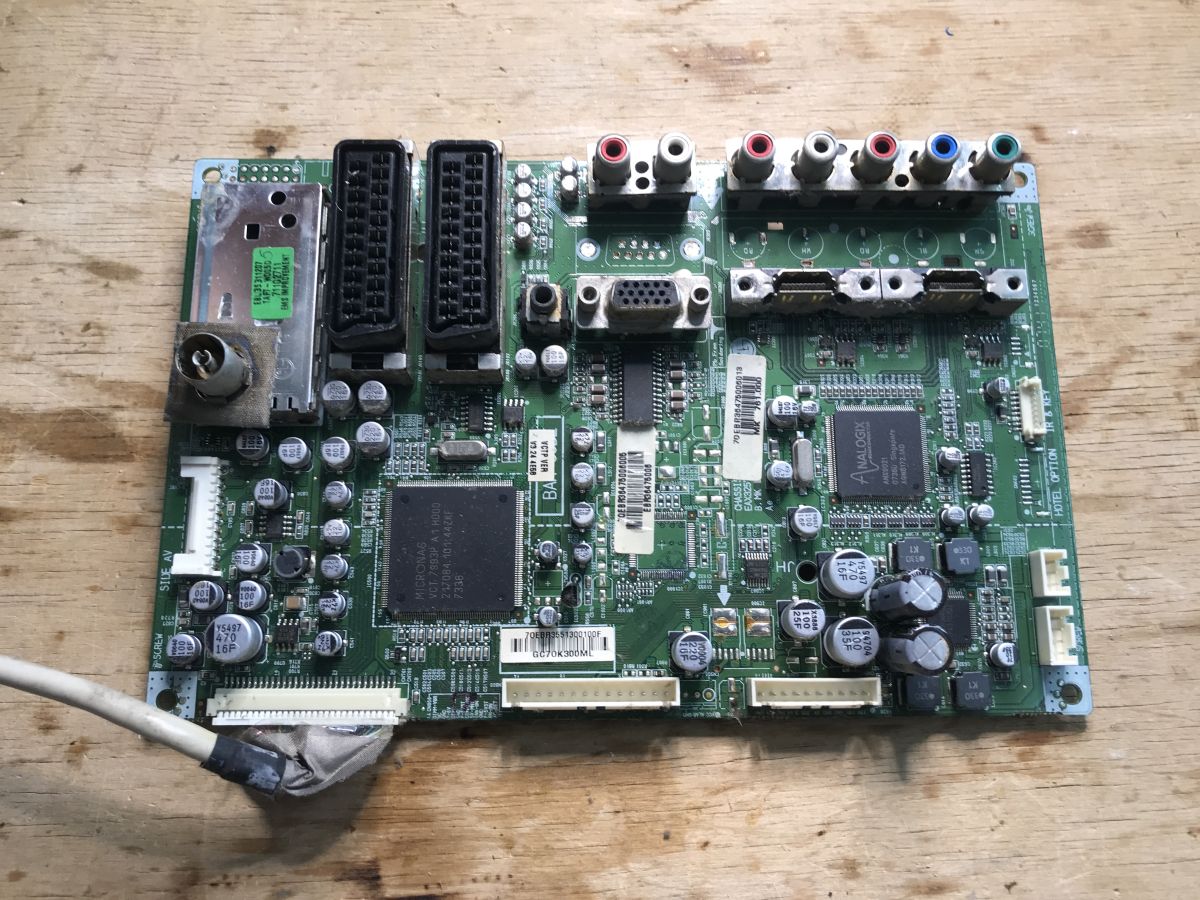

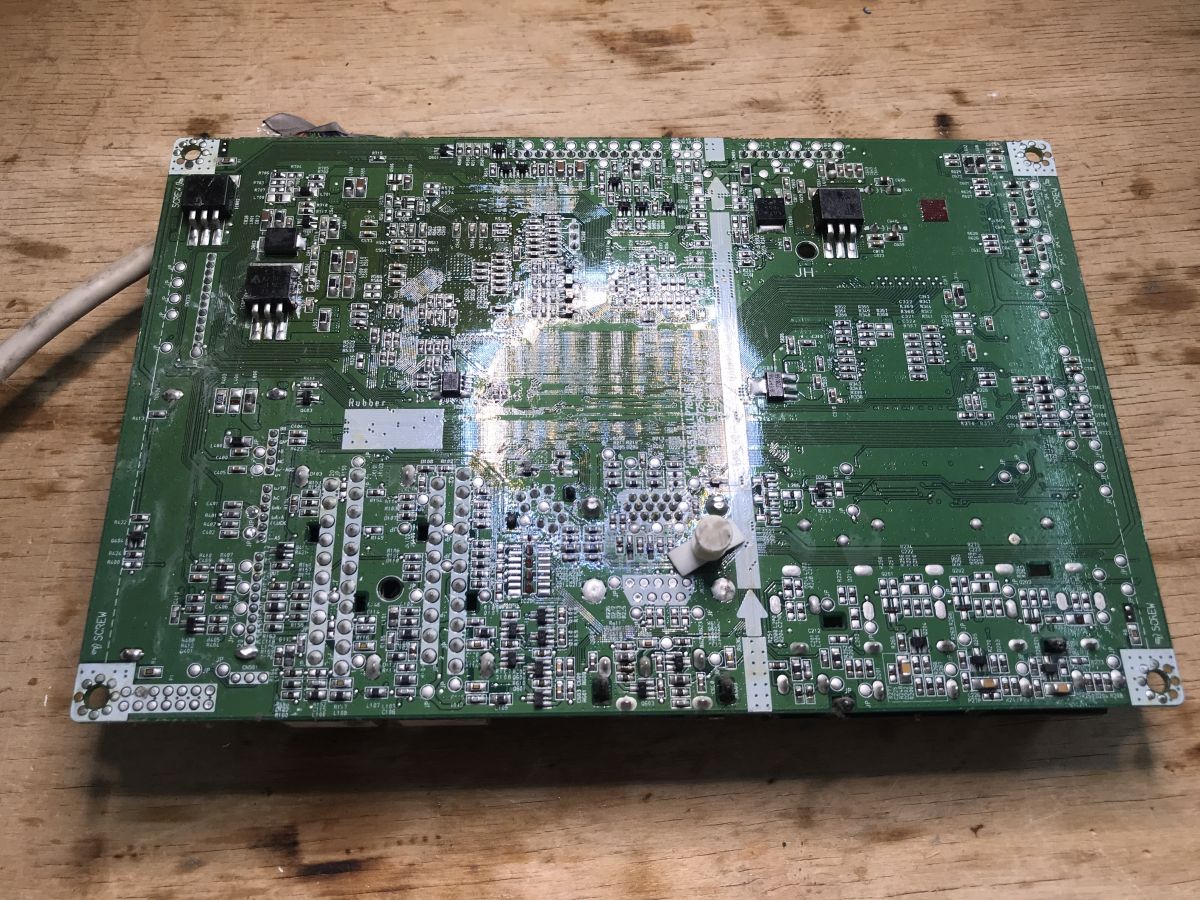

    On the main board are the video signal inputs and also present is the RF tuner module. It is here that we essentially have a 'small computer', along with inverters to power the CPU and memory.
    Mainboard from a 2007 LG 32-inch LCD TV with visible connectors and components Mainboard of LCD TV with SCART, Component, VGA connectors and various ICs Underside of a circuit board from a 2007 LG LCD TV with through-hole and SMT parts .
    On the bottom of the board I can also see an EEPROM and some sort of LDO regulator. I'm more likely to recover Flash memory from this type of board, as in newer TVs you can get quite attractive sizes such as even a few megabytes, all while retaining the eight-legged case, but here I didn't see one. The rest of the chips are quite specialised and it's hard to make something out of that. Interestingly, on the other hand, the AXN9021 used here has fairly good documentation available on the web.
    Block diagram of ANX9021 HDMI receiver connections in an A/V system. .

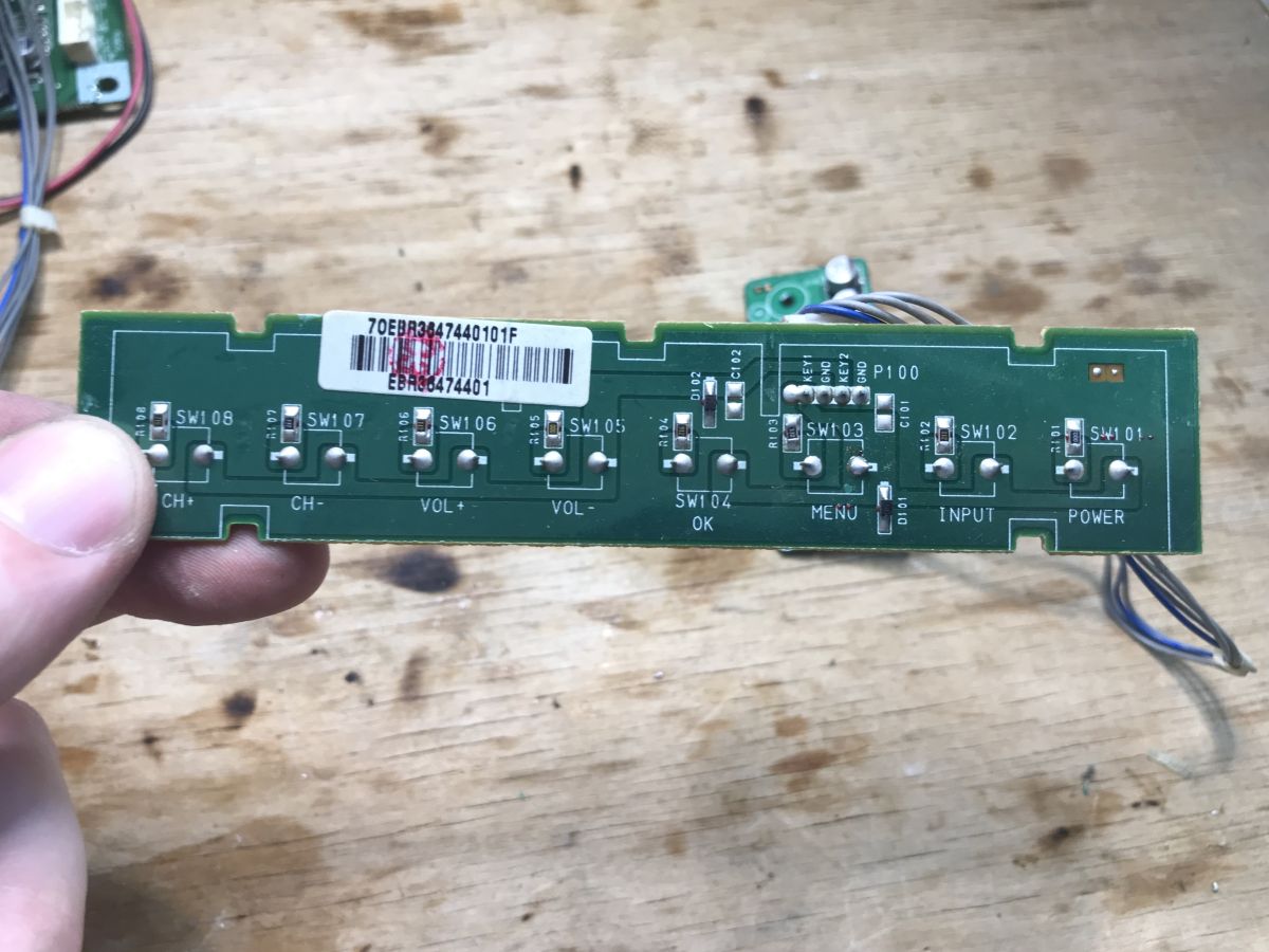

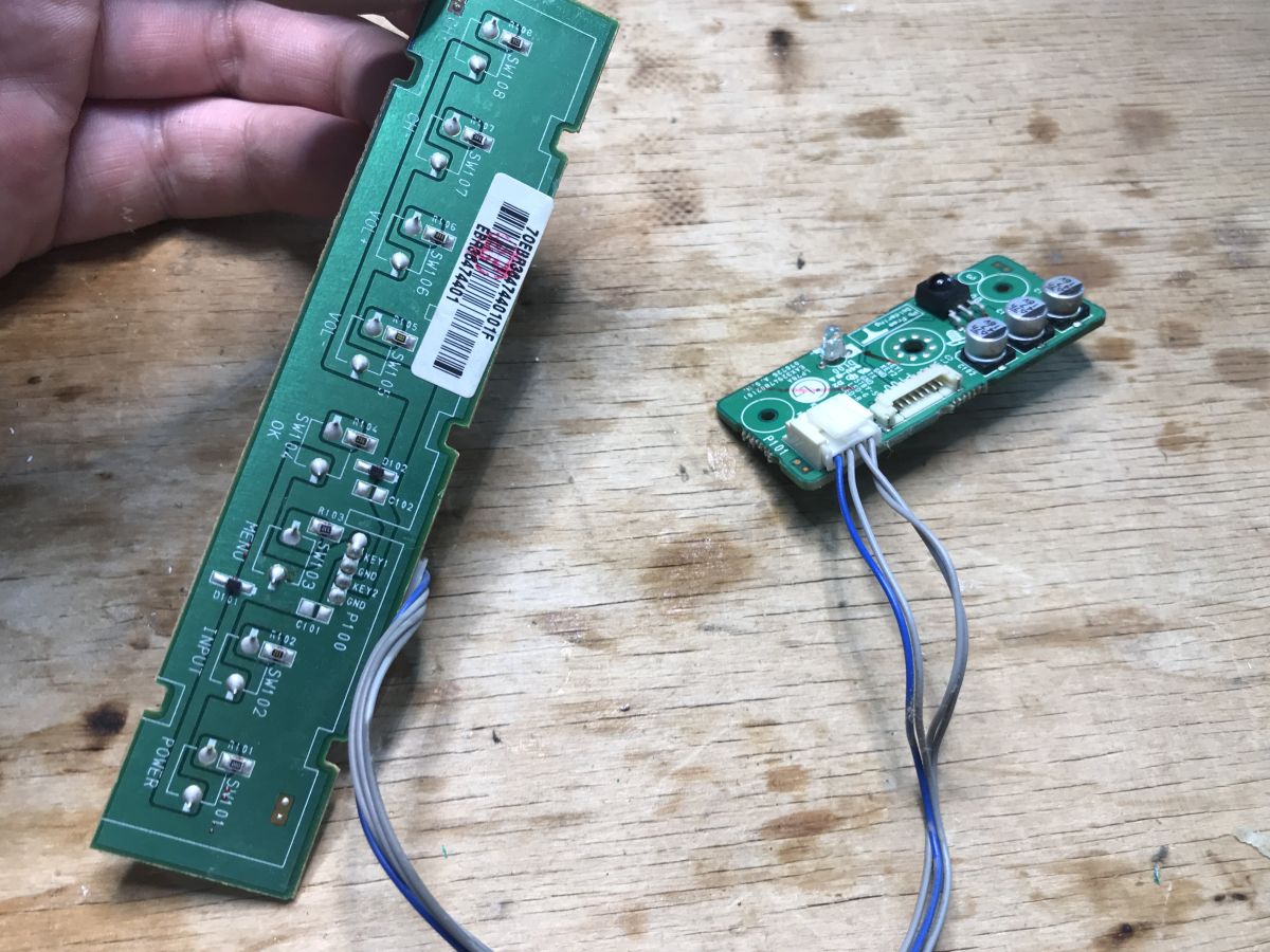

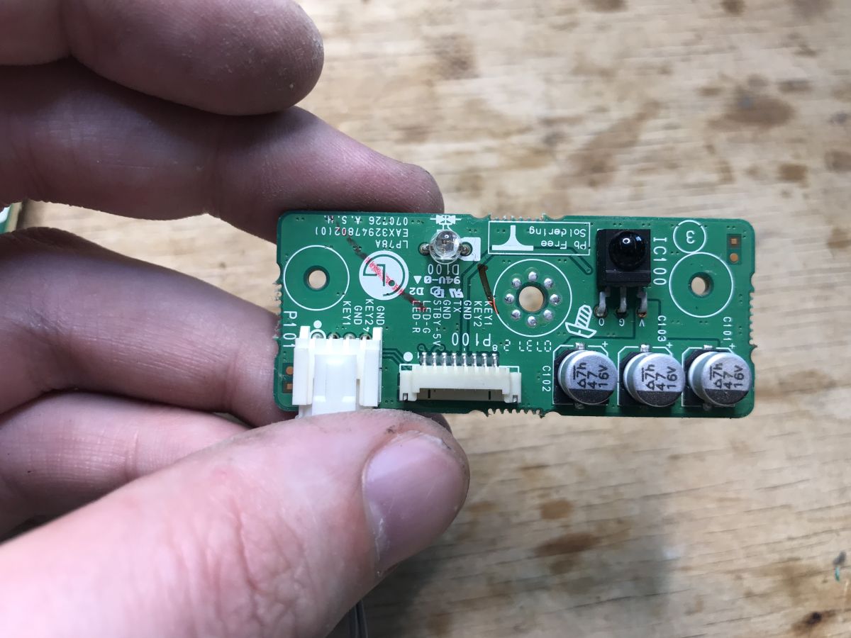

    Of the finer things, that leaves the keypad and the infrared receiver, and here too you can note their design. The keypad has 8 buttons and only two signals go to them - KEY1 and KEY2. The buttons in turn have different resistors next to them.... and so presumably each button sets a different resistance, and the main controller reads the value analogue, via the ADC, and so determines what was pressed.
    Circuit boards with buttons and IR receiver from inside a 2007 LG TV Circuit board with electrolytic capacitors and 8-pin connector Control button PCB from a disassembled 2007 LG LCD TV .

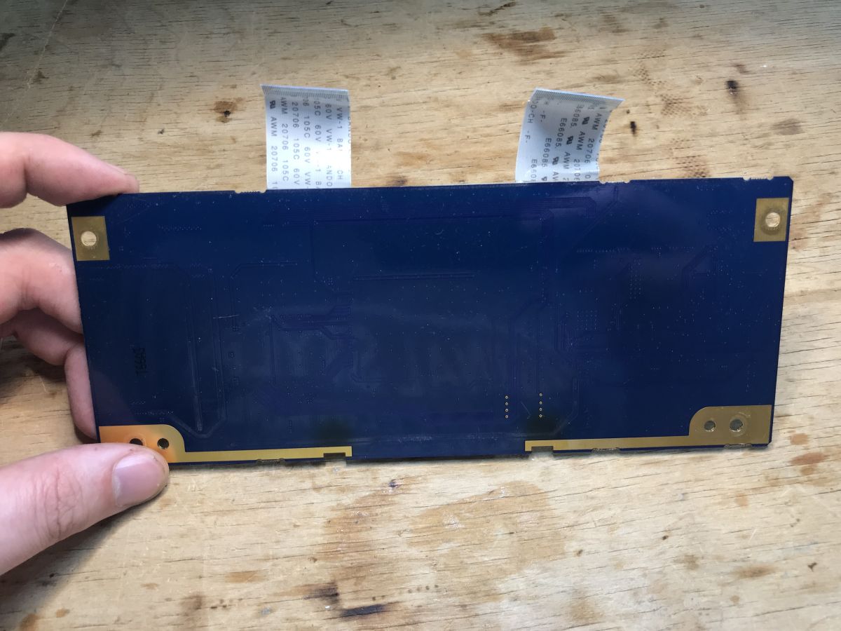

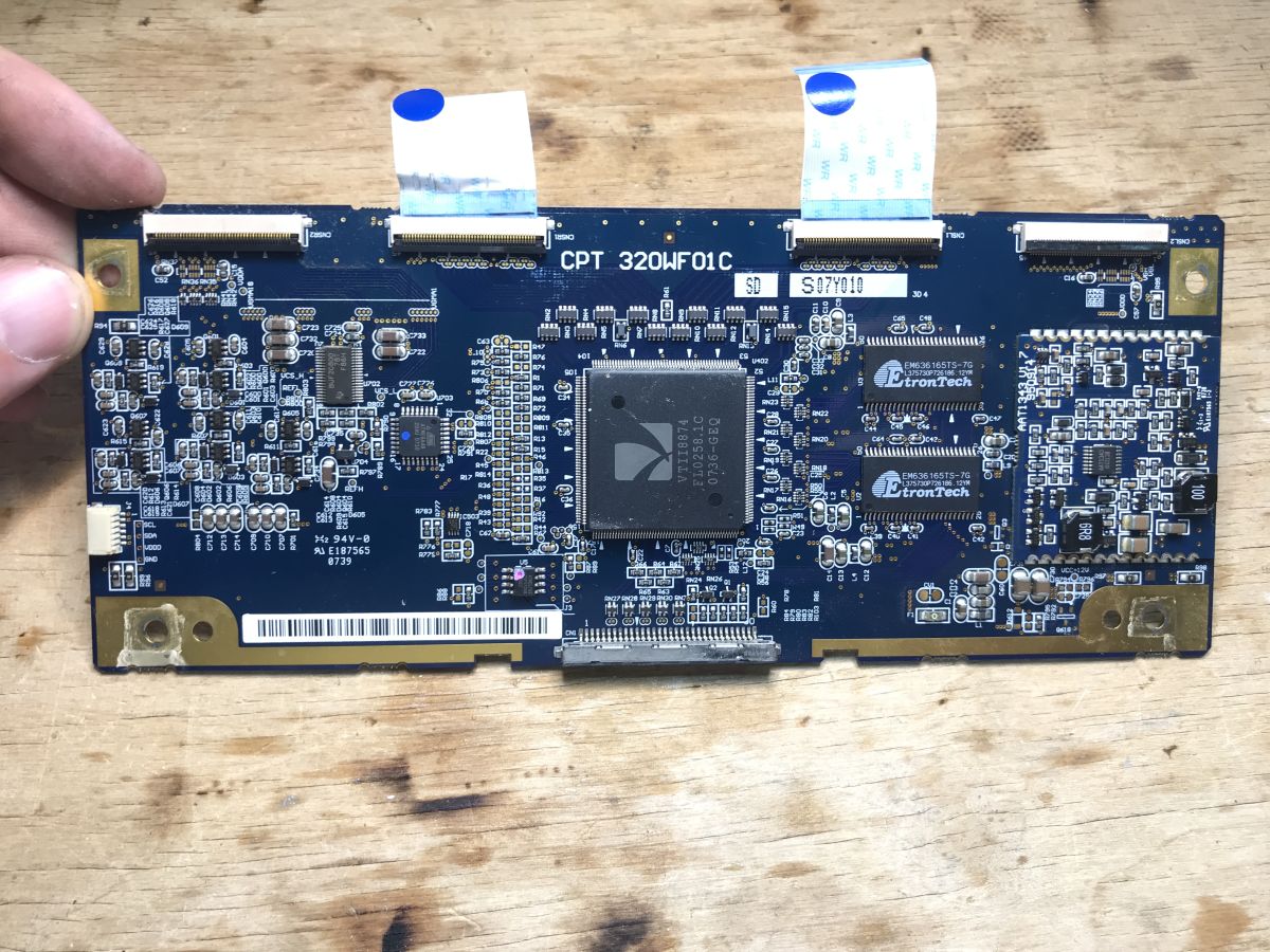

    That leaves the T-Con, here too the whole thing is one-sided:
    T-Con board with visible ICs and ribbon connectors on a wooden surface Blue PCB with signal flat cables connected, viewed from the trace side .

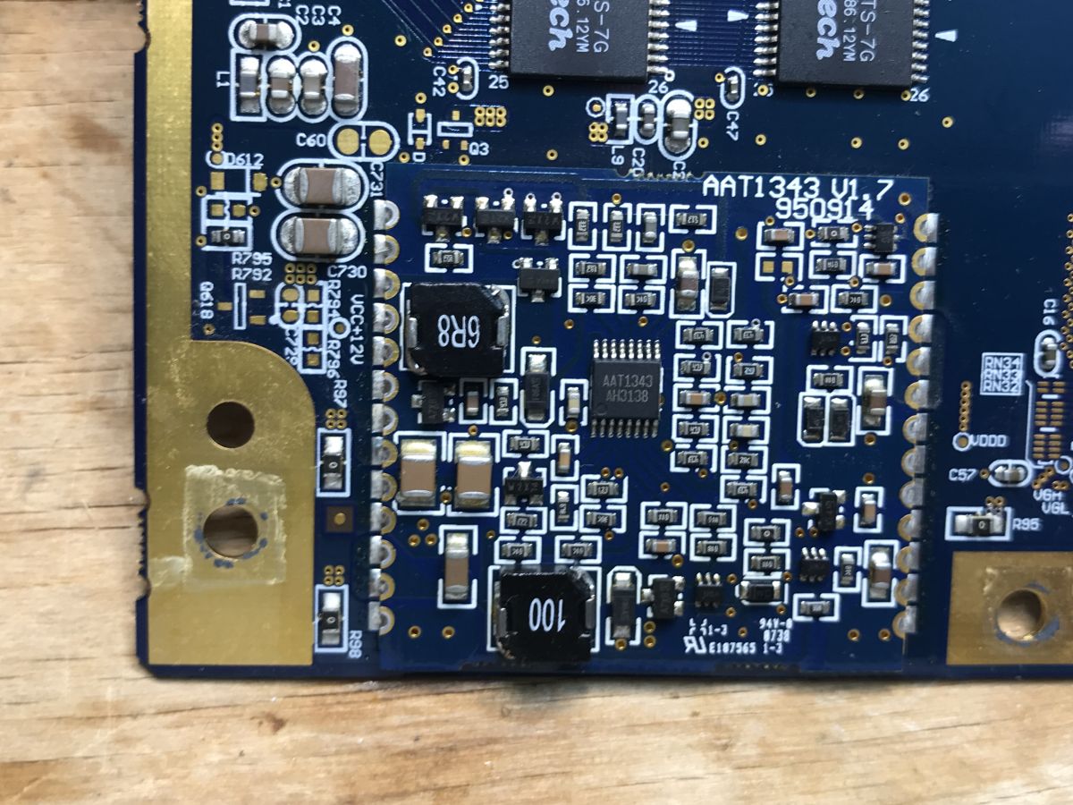

    In its construction, I was surprised to find an additional, add-on AAT1343 V1.7 module. This is again an inverter - a PWM controller for DC-DC.
    Close-up of T-Con board with AAT1343 V1.7 module and SMD components .

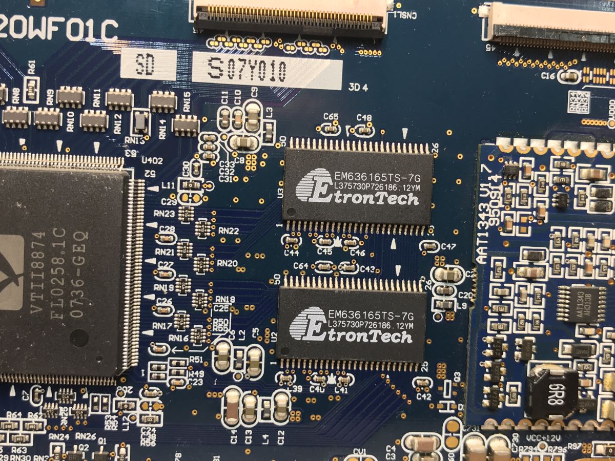

    Also on the T-Con is a VTII8874 FL0258.1C processor and EM636165TS-7G (1M x 16 bit Synchronous DRAM) memories.
    Close-up of T-Con board with EtronTech memory, VTII8874 processor, and AAT1343 converter .

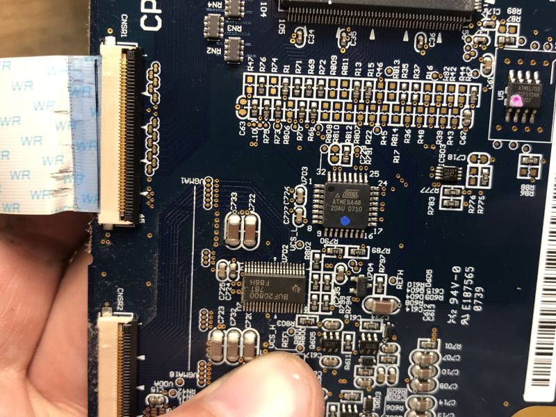

    What caught my attention most, however, was the Atmega48 present here:
    T-Con board with Atmel ATMEGA48 microcontroller and two ribbon cable connectors .
    I've done most PIC programming, although I've also played a lot with Arduino. I don't know the Atmeg itself directly, but it would probably be possible to hook up an ASP to it from USB and animate it for some DIY.

    On what circuit is the head i.e. the RF block made?
  • T-Con and backlight modules lack schematics
    #3 21623421
    acctr
    Posts: 4554
    Help: 389
    Rate: 2025
    Interestingly, the T-Con module and the backlight power supply are like parts attached to the LCD panel and the same can be found in receivers from other companies/brands.
    But looking through the service manual of the OTV described here you will not find schematics of these modules, even for the component symbols in the BOM there is a "hole" for the given index.
    On the other hand, the panel itself and the modules mentioned have their datasheets (chunghwa_claa320wf01-d_lcd_panel.pdf) , unfortunately without schematics and explanation of what the ATMEGA is for.

    Due to the significant power consumption, the power supply is a resonant inverter. The disadvantage is the narrow range of voltage regulation as a function of changes in current drawn and such a circuit must be supplied with a stabilised voltage, and this is provided by PFC.
  • PFC shapes mains current, not just smoothing voltage
    #6 21623576
    acctr
    Posts: 4554
    Help: 389
    Rate: 2025
    żarówka rtęciowa wrote:
    such a circuit must be supplied with a stabilised voltage, and this is provided by a PFC
    Then a capacitor is not enough? The grid has a low enough resistance to keep the amplitude value on it constantly.
    The PCF is there to make the current draw from the mains a nice, sinusoidal, voltage phase-consistent one, instead of almost pulsed (charging the capacitor from a certain voltage somewhere above 200 V).

    Standby is implemented based on ICE381565J:
    Minor correction: this chip is ICE3 B 1565J from Infineon Technologies.
