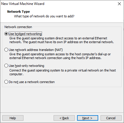

    It is a good idea to run the whole thing on a virtual machine - I used VMware for this. It is important to give the machine enough resources. For the map of Poland alone, I found that about 60GB of disk memory and 2GB of RAM are needed. Additionally, it is a good idea to connect the machine directly to our network - bridged mode:
    Virtual machine wizard window with Use bridged networking option selected. .

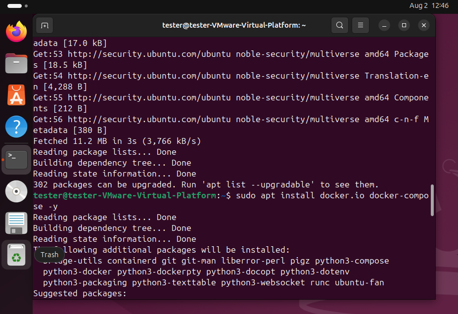

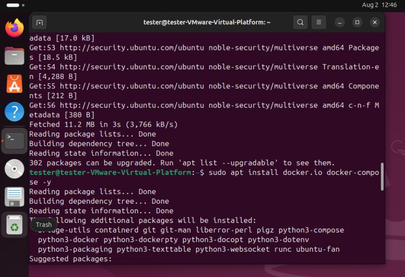

    First we update APT and install Docker:
    sudo apt update
    sudo apt install docker.io docker-compose -y
    Installing Docker and Docker Compose on Ubuntu via terminal commands .

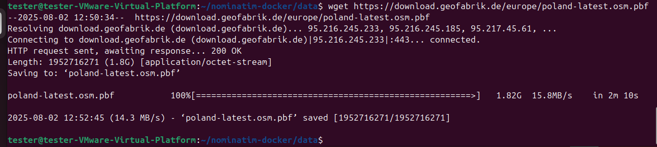

    Then you need to download the data. You can use the geofabrik website as an example:
    https://download.geofabrik.de/
    I decided to download a map of Poland, although I also thought about our neighbours. You can download via a browser or use wget for example:
    wget https://download.geofabrik.de/europe/poland-latest.osm.pbf

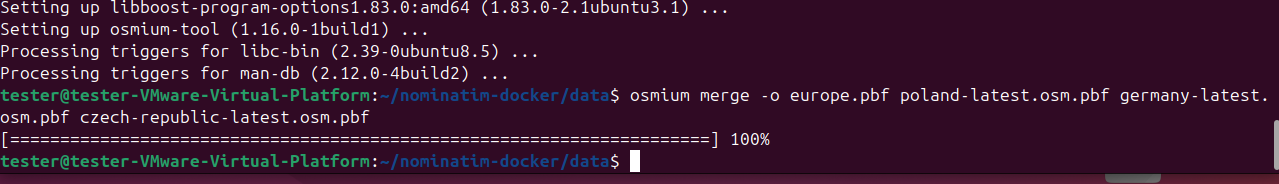

    The map supports a single PBF file, so if you want a larger section of the map, you need to merge the smaller sections using osmium . Below is the merge command, although the final merged version ni
    mkdir data
    cd data
    wget https://download.geofabrik.de/europe/germany-latest.osm.pbf

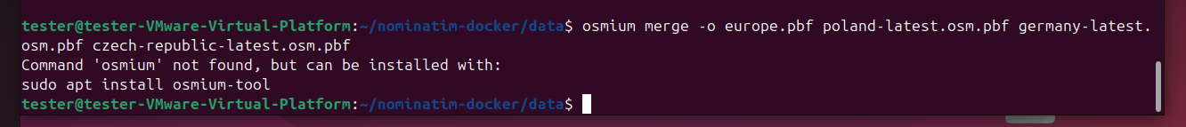

    sudo apt install osmium-tool -y
    osmium merge -o europe.osm.pbf poland-latest.osm.pbf germany-latest.osm.pbf
    cd ..

    If you do not have osmium, it can be installed via APT:
    Terminal showing missing 'osmium' command error while merging OSM files in Ubuntu .
    Any N maps can be combined in a similar way.
    Terminal window showing completed merge of OSM files using osmium merge command .

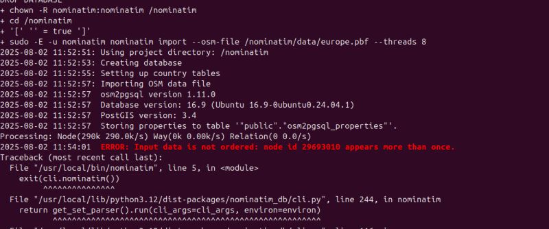

    In theory it should run, in practice there may be some problems. The first is duplicate nodes. These occur when merging maps, for some reason osmium does not remove them. They are evidenced by a message like " Input data is not ordered. node id x appears more than once. "
    Nominatim error message about duplicate node ID in europe.pbf file .
    I've seen a similar situation on Github and it's potentially possible to fix it with my own script, but I haven't tried that yet. In my situation I have reverted to using a single country pbf.

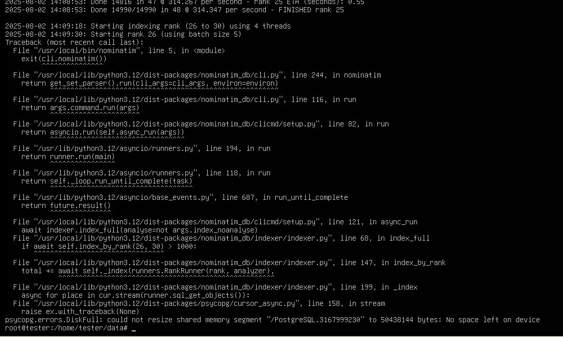

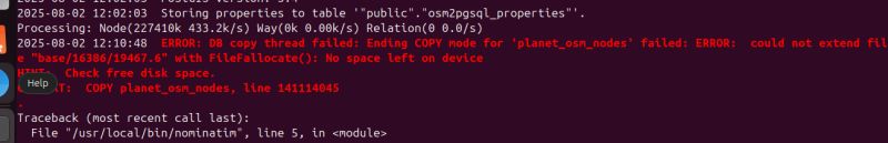

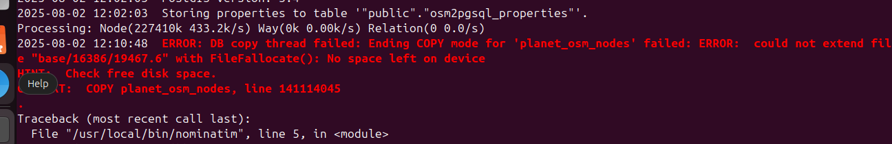

    The second problem is lack of space:
    Nominatim error: no space left on device while indexing PostgreSQL segment .
    You need to ensure that you have enough space on the media used. Also be aware of the size of the shared memory (/dev/shm) of the container, in its case the default 64MB is not enough. This is increased with the --shm-size switch.
    OSM data import error: no disk space left during planet_osm_nodes COPY operation .
    Then you have to use:
    docker run -it --shm-size=4g -e PBF_PATH=/nominatim/data/poland-latest.osm.pbf -p 8080:8080 -v /home/tester/data:/nominatim/data --name nominatim mediagis/nominatim:5.1

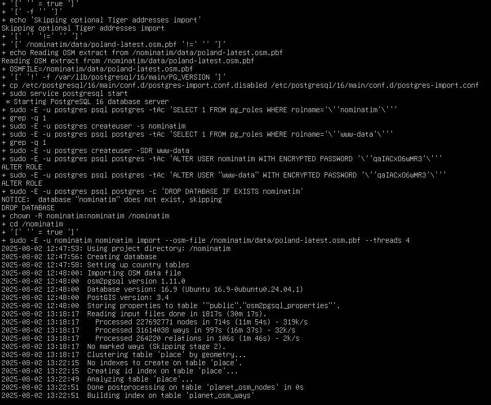

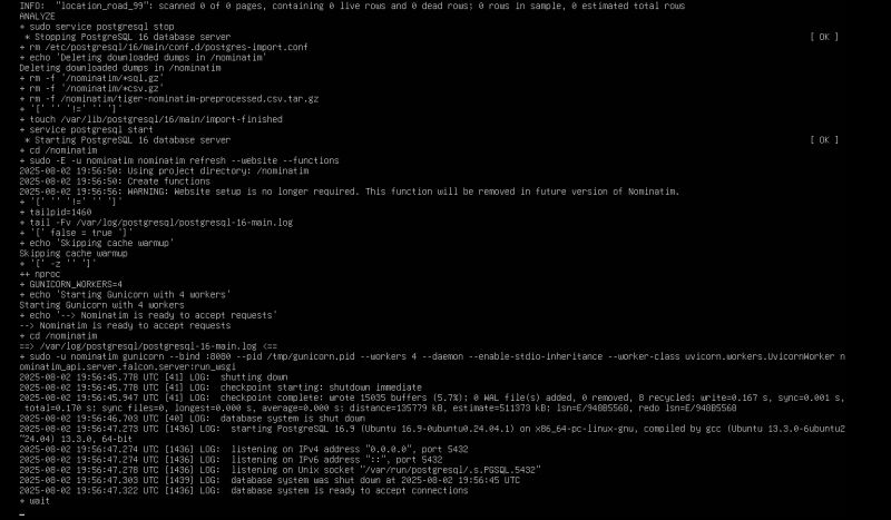

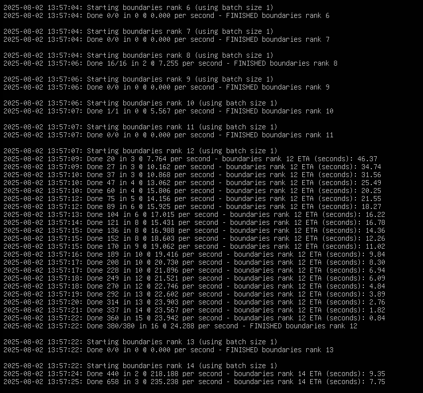

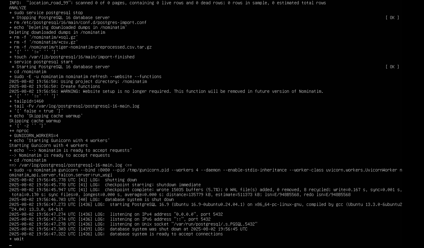

    It should now be up and running. The first firing will take hours. Subsequent launches will be faster.
    OSM data import into PostgreSQL using nominatim tool on Ubuntu console .
    Nominatim Docker loading log showing boundary import progress in terminal .
    Terminal logs showing startup of Nominatim service and PostgreSQL 16 .

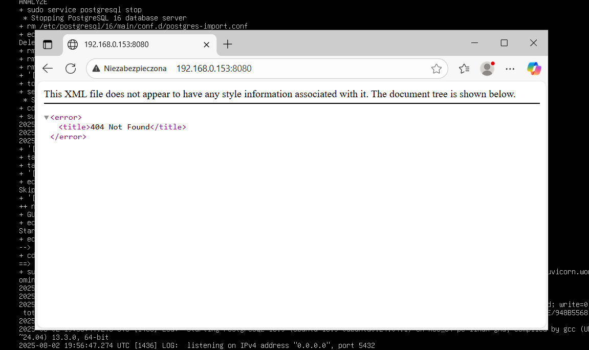

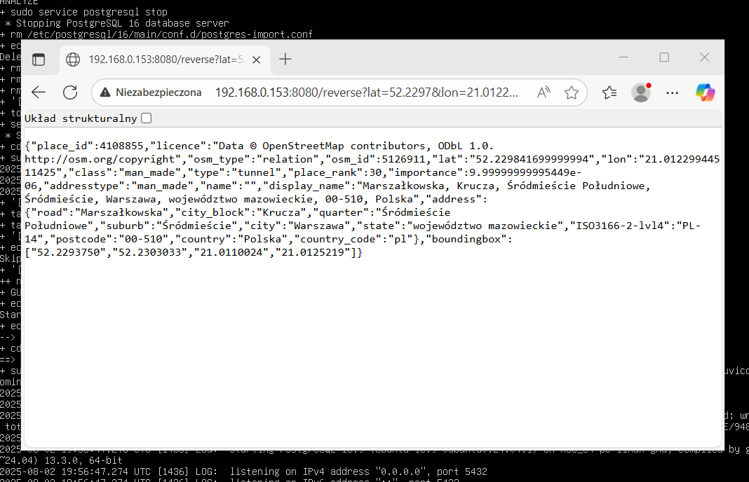

    This is how we get our own map instance. The home page is not available:
    Browser showing 404 error and XML message on page 192.168.0.153:8080 .
    The reverse geocoding service we are interested in, however, works:
    http://192.168.0.153:8080/reverse?lat=52.2297&lon=21.0122&format=json
    Reverse geocoding result in a browser from local OSM server .

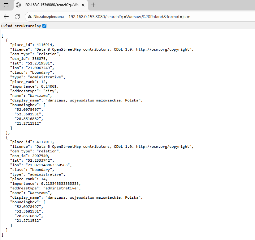

    Similarly, forward geocoding:
    http://192.168.0.153:8080/search?q=Warsaw,%20Poland&format=json
    Nominatim search result for Warsaw, Poland in JSON format in a browser window .

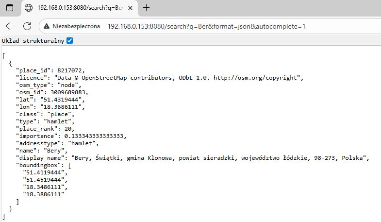

    Search (autocomplete):
    http://192.168.0.153:8080/search?q=Ber&format=json&autocomplete=1
    JSON response from local Nominatim instance for query Ber .

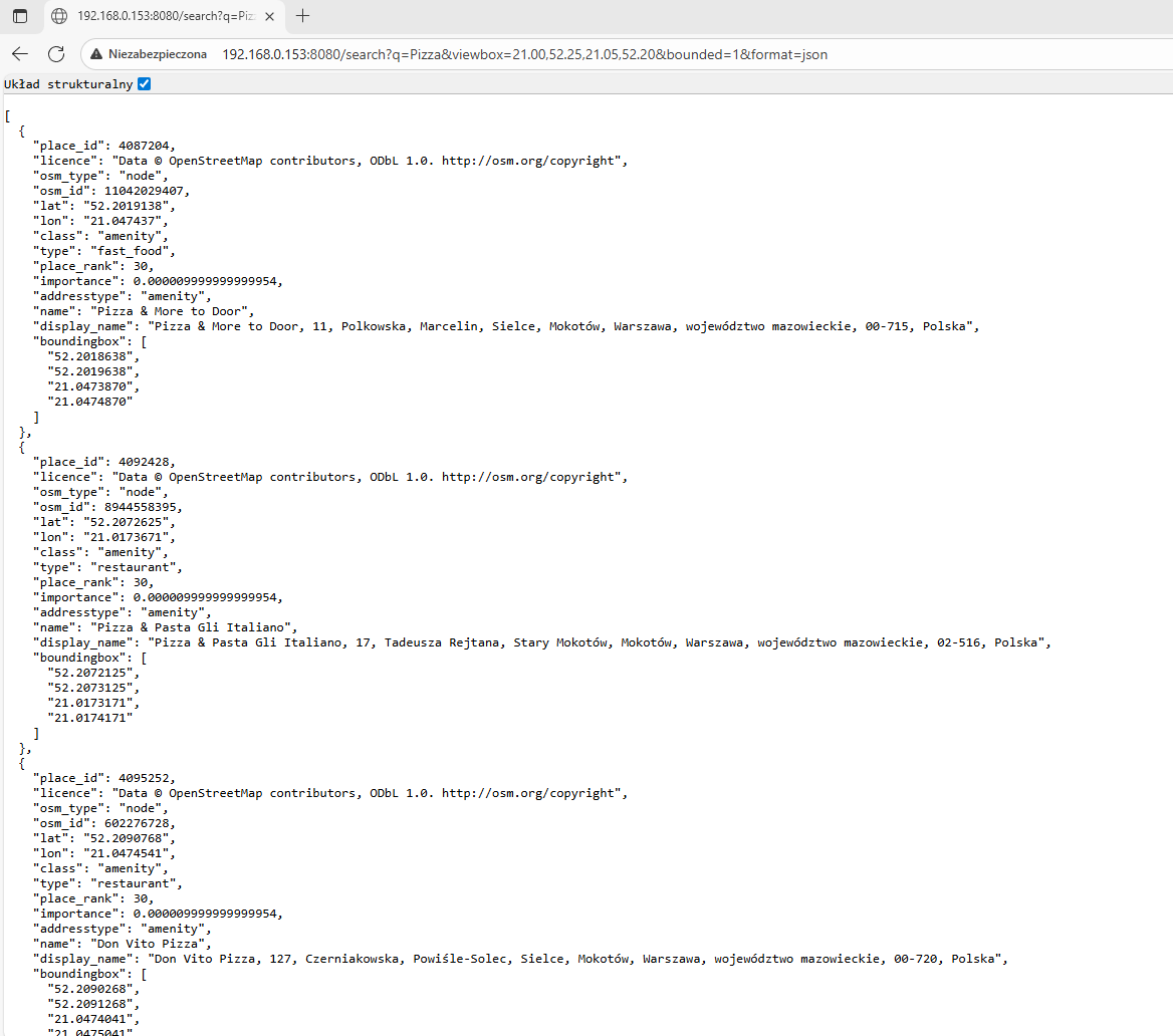

    Search for targets in a given zone:
    http://192.168.0.153:8080/search?q=Pizza&viewbox=21.00,52.25,21.05,52.20&bounded=1&format=json
    Nominatim API query results showing pizza restaurants in Warsaw .

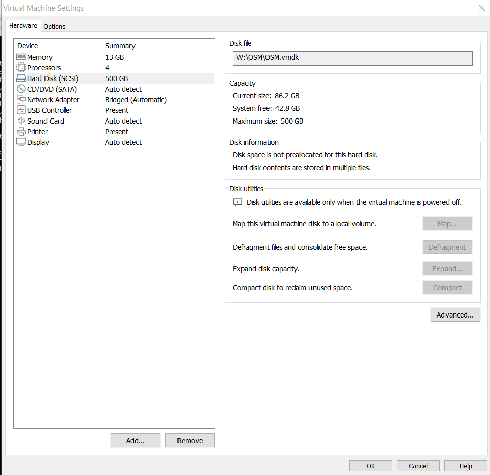

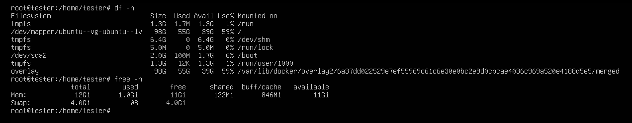

    Information about the machine used for testing:
    Screenshot of Linux terminal showing df -h and free -h commands output
    Virtual machine settings in VMware with 500 GB disk and 13 GB RAM .

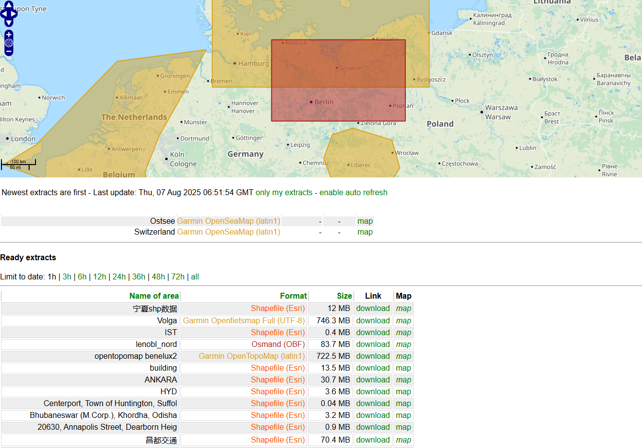

    This site can help with linking maps:
    https://extract.bbbike.org/
    Admittedly there are limits, but you can select an area and download a PBF for it. For example, for the border section of two countries.
    For example:
    Screenshot of a map with selected areas for download in PBF or Shapefile formats. .
    Recent generations:
    https://download.bbbike.org/osm/extract/?count=20;date=1h
    It is important to choose the PBF format, because as far as I can see the limit is higher for it - you can download more.

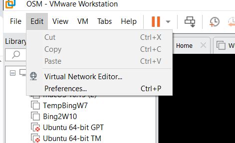

  • Removing unused VMware adapters restored network access
    #4 21634519
    Posts: 14795
    Rate: 12952

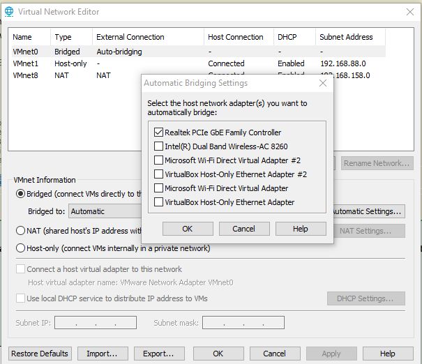

    Another curiosity. The power was out and although the laptop didn't shut down, the vmware crashed.
    It stopped seeing the network - none of the machines were even pinging 8.8.8.8.
    I already thought I was in for a reinstall of machines and OSM, but a solution was found.
    Network edits had to be entered:
    Edit menu with Virtual Network Editor… highlighted in VMware Workstation .
    And there dump all network adapters that are not used by my physical laptop to connect to the external network:
    VMware Virtual Network Editor window with automatic bridging settings open .
    As of now, my two machines with OSM are working and seeing the network again.
