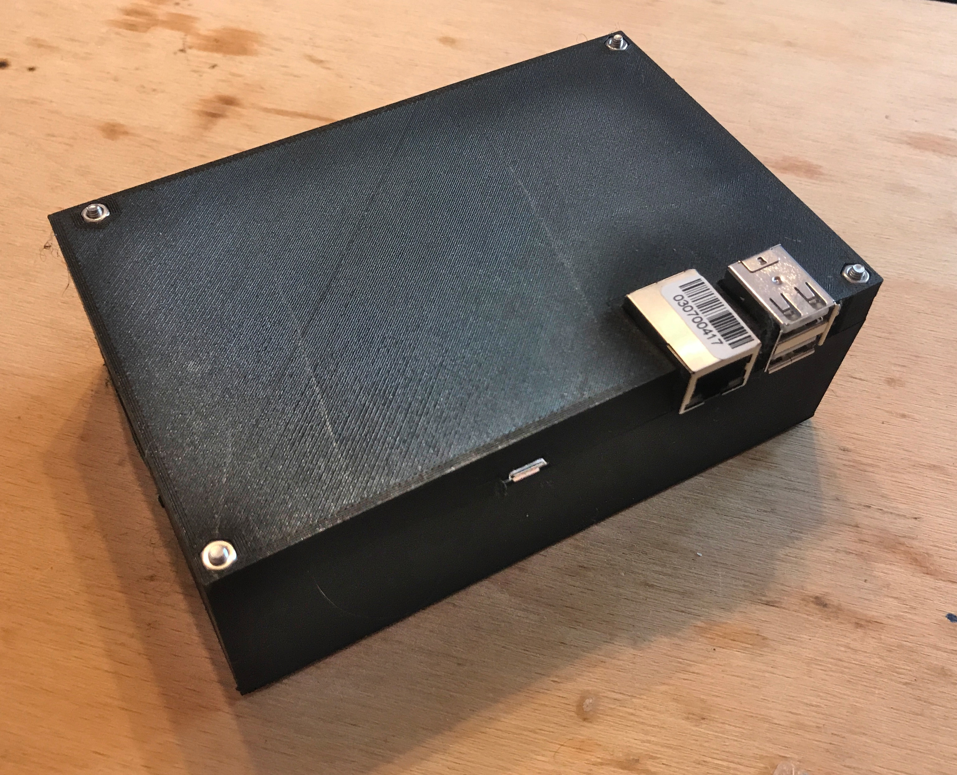

I would like to present the first version of the enclosure for my low-power, noiseless mini-server based on a 480GB SSD and a Banana PI M1+ minicomputer. I designed the enclosure in Blender and printed it on my Ender 3 Pro 3D printer using PLA filament. At the end of the topic I will give its sources for download.

This server is meant to serve me until it breaks down, so it couldn't be left as is. I had to design some sort of enclosure for it.

Modelling the case
I designed the enclosure in Blender 2.79 based on the models mentioned above. I decided that the Banana Pi would be mounted above the drive, and that the whole enclosure would consist of three parts:
- an internal mount (one piece common to the Banana Pi and the disk)
- the top cover
- a lower base
The case will be bolted together with long M3 screws and nuts, as this is a much more robust solution than screwing the screws into the filament itself.
The case will be oriented so that the buttons are brought out on its walls, as well as the Ethernet connector and the SD card slot.
The micro-USB connector from the power supply will not be able to be brought straight out onto the wall, so I will simply make an extension and position it myself in a convenient place.
The SATA connector from the drive will be fully inside the case.
The case will be bolted together with six screws - 4 in the corners with nuts will compress the whole thing, there will be two more in the middle screwed into the filament.

I used four torx screws to screw the final version together:
The final version after printing and assembling:
The audio jack connector is also out:
Buttons too, of course:

I am very satisfied with the case presented here. I'm sure I'll be using it for a long time, the server itself from here goes 24 hours a day at my place (and that's how much it's supposed to go - by the way, it's energy efficient, drawing up to 3W from the mains, and on top of that it's silent thanks to the use of an SSD). The chassis itself could be a little smaller if I had a shorter SATA cable to hand, but I don't see this as a problem. The server will eventually stand in such a place that an extra couple of cm in thickness won't make any difference.
The cost of the case (less than 10PLN) is also very encouraging. I am impressed by how much 3D printing allows.
If anyone would also like to make such an enclosure, I have provided everything needed in the attachments.
