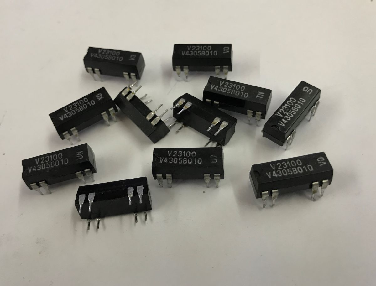

    Today a little tidbit I came across while developing one of my projects. I was looking for a simple way to mechanically disconnect microcontroller/ESP controlled lines, with a minimum of additional components. This is how I came across the very small V23100-V4 dual signal relays. Interestingly, the manufacturer explicitly emphasises in the documentation that the coil can be controlled directly by TTL signals, which is immediately appealing for projects with microcontrollers.
    DIP-encapsulated micro relays to be driven directly from the microcontroller/ESP pin?

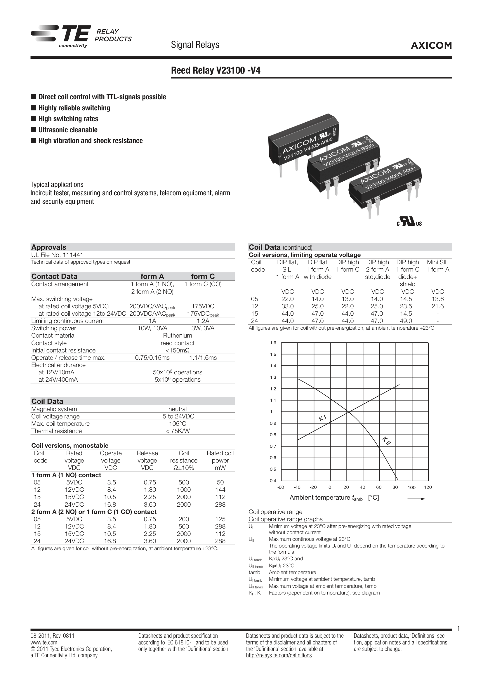

    Consider the parameters from the datasheet:
    - maximum contact current: up to 1 A
    - maximum voltage: up to 200 V
    - maximum switching power: 10 W
    For such a small relay, these are quite reasonable values - especially when it comes to signal applications or small loads. The coil parameters are also interesting:

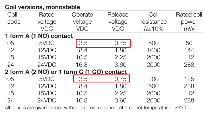

    - coil resistance: ~500 Ω
    - coil power: ~50 mW
    This means that the control current is very low, which is precisely what makes direct control from the microcontroller output possible (at least in many cases). In practice, it is important to check how much current can be drawn from the GPIO. For example, for the PIC18F2550 it is 25 mA:

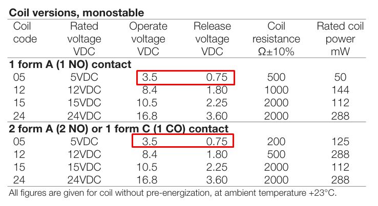

    Assuming a supply voltage of 5 V, about 10 mA will flow through the ~500 Ω coil. Well under the limit. Just what about lower voltages? According to the datasheet note:
    - closing voltage (operate): 3.5 V
    - opening voltage (release): 0.75 V

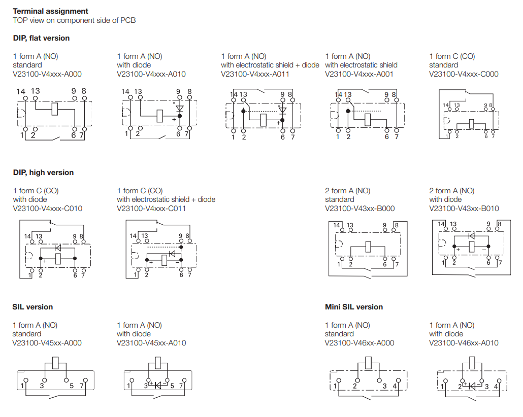

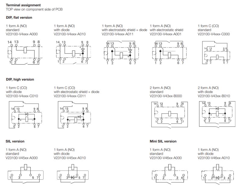

    These values suggest that the relay is designed with low-voltage logic in mind. However, an interesting question arises: in practice, will it also work at even lower voltages than the declared 3.5 V? There is often some design reserve in such components, so I thought I would give it a go with ESP. DIY projects have their own rules, it's not mass production, so you can afford to do more. So it's time for testing.

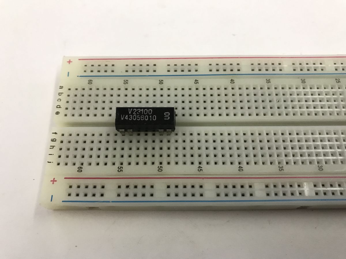

    The whole thing has a standard DIP raster, so it fits on a contact board:
    Leads - yes, there is already a protection diode inside in parallel to the coil, so you can't connect the coil in reverse either:

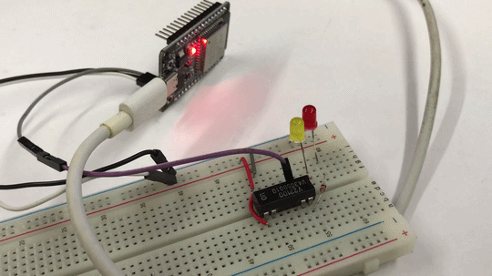

    First test at 5 V - no surprise here rather, the whole thing works.

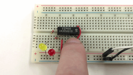

    Second test - controlled from ESP32 at 3.3 V:
    Breadboard with a DIP relay and two LEDs, next to an ESP module with red indicator lights
    Here I've stretched the specification a bit, as the manufacturer announces the contacts close from 3.5 V rather than 3.3 V, but nevertheless the relay works too.

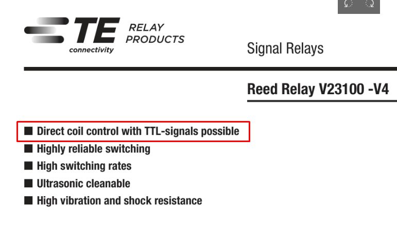

    Where exactly did he write about this? TTL levels are ranges from 0 to 0.8 V for the low state and 2.4 to 5 V for the high state. In the table with the DS of this relay, there is a range from 3.5 V so this is not TTL.
  • #7 21888006
    Posts: 14795
    Rate: 12944
    I was referring to this passage from the catalogue note:

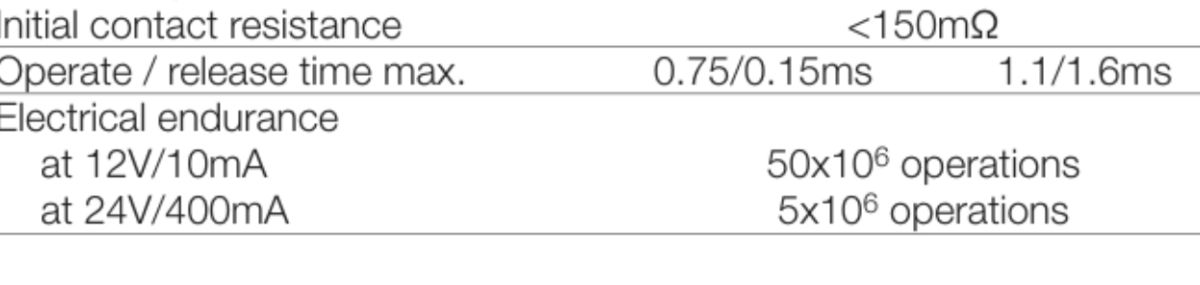

    My question is, what is the guaranteed number of switches. ?
  • #13 21888216
    Janusz_kk
    Posts: 5872
    Help: 228
    Rate: 1479
    rezydent1 wrote:
    I have a question, what is the guaranteed number of switches. ?
    These are hermetic reed switches so they safely last for millions.

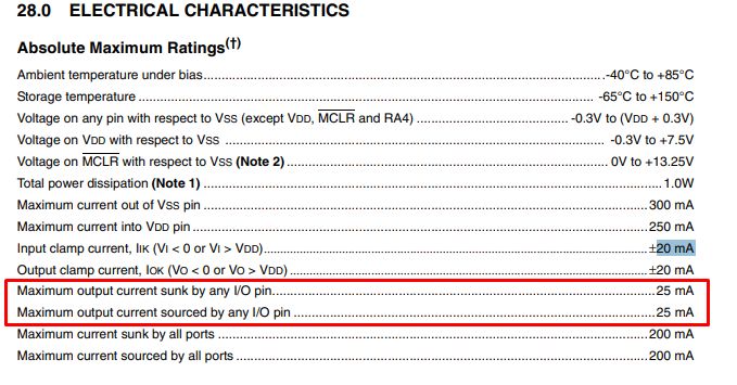

    This means that the control current is very small, which is what allows direct control from the microcontroller output (at least in many cases).
    Control current is one thing, but I assume that a suppression diode must also be inserted in parallel to the relay coil. Will it be sufficient to protect the after all quite sensitive to overvoltage output of the microcontroller?
    Maybe this is also the reason why 99% of circuits use an intermediate transistor (or e.g. the ULN2003 circuit) to control the relay.

    kris8888 wrote:
    Control current is one thing but I assume there must also be a suppression diode inserted in parallel with the relay coil.
    Have you looked at the internal schematics of the relays the Author has provided? Half of these circuits (relays) have an integrated diode.
  • Direct relay drive may still stress the microcontroller output
    #21 21888598
    kris8888
    Posts: 7105
    Help: 537
    Rate: 1935
    krzbor wrote:
    Author? Half of these circuits (relays) have a diode built in.
    Ok, that's not what I mean, because I'm assuming the diode has to be there, it doesn't matter anymore whether inside the relay or outside.
    The point is whether this is enough to effectively protect the microcontroller output. Most likely yes, although personally I have never designed my circuits in such a way that even a very sensitive relay could be controlled directly from the microcontroller output.

    I have a question from ... Another side: is it possible to make a video with sound of how such small relays work?
  • #27 21892910
    Posts: 14795
    Rate: 12944
    Here you have the source video (with audio, undeciphered):
TL;DR: With a ~500 Ω coil, the relay draws about 10 mA at 5 V, and the author reports, "the relay works too" from an ESP32 at 3.3 V. This FAQ helps MCU and ESP builders decide when a V23100-V4 DIP relay can be driven directly from GPIO and when a transistor or more margin is safer. [#21887831]

5 V relay from 5 V MCU GPIO 5 V / ~10 mA Works and stays below a PIC18F2550 25 mA pin limit Simple 5 V MCU designs

  • V23100-V4 thread figures: max contact current 1 A, max voltage 200 V, max switching power 10 W. That makes it a small signal-switching part, not a power relay. [#21887831]
  • Coil data cited in the thread: ~500 Ω resistance and ~50 mW coil power. At 5 V, that implies about 10 mA coil current. [#21887831]
  • The posted operate/release figures are 3.5 V pull-in and 0.75 V release, so 3.3 V ESP32 drive is below the stated operate voltage even if a sample still actuates. [#21887831]
