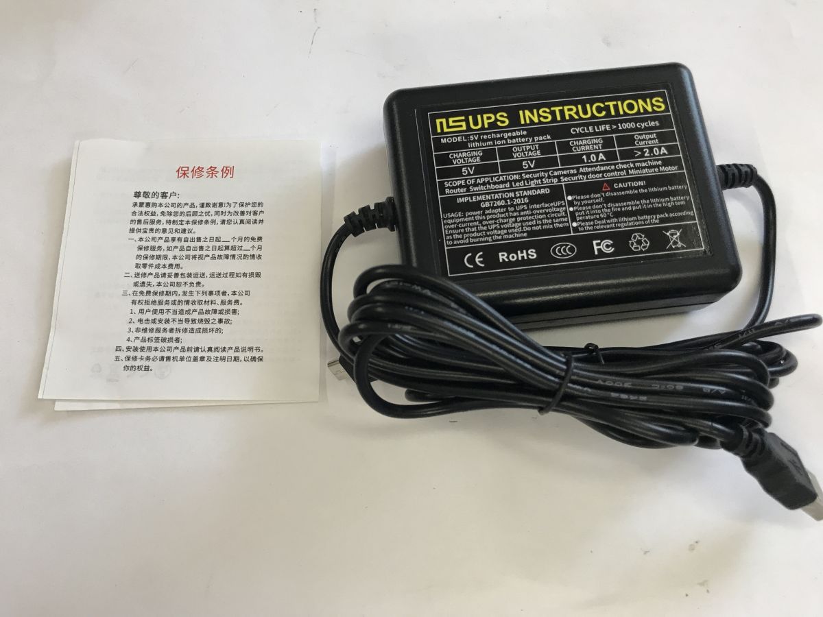

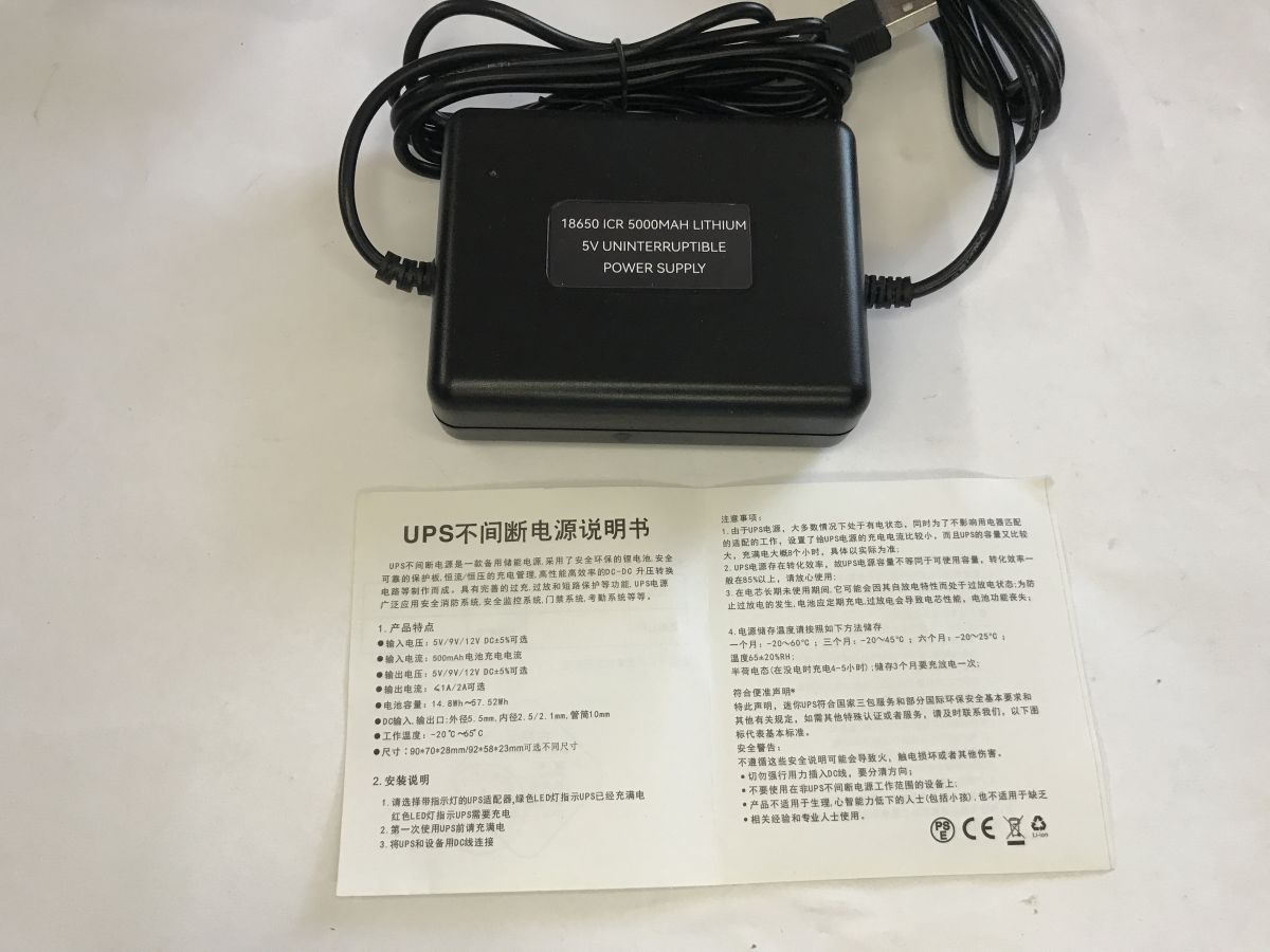

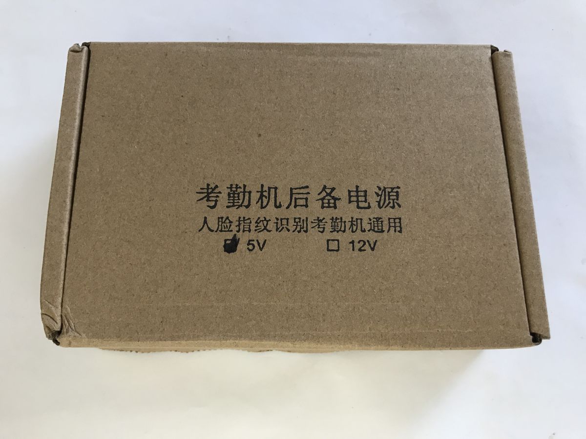

    Let's start with the first one - you can vainly find the model name here, but you can also judge a lot by its appearance. The whole thing is quite expensive, costing £100, and advertised as it is as a "UPS for alarms". The rated capacity is 20 Wh, according to the seller.
    Two tiny UPS for router, camera or Raspberry Pi - capacity test Two tiny UPS for router, camera or Raspberry Pi - capacity test Two tiny UPS for router, camera or Raspberry Pi - capacity test
    The manual is in Chinese, although it manages to read something about a 500 mAh battery capacity. This is strange, on the case it says 5000 mAh. I also see separately the capacity given in Wh, but how come it is from 14.8 Wh to 57.52 Wh?

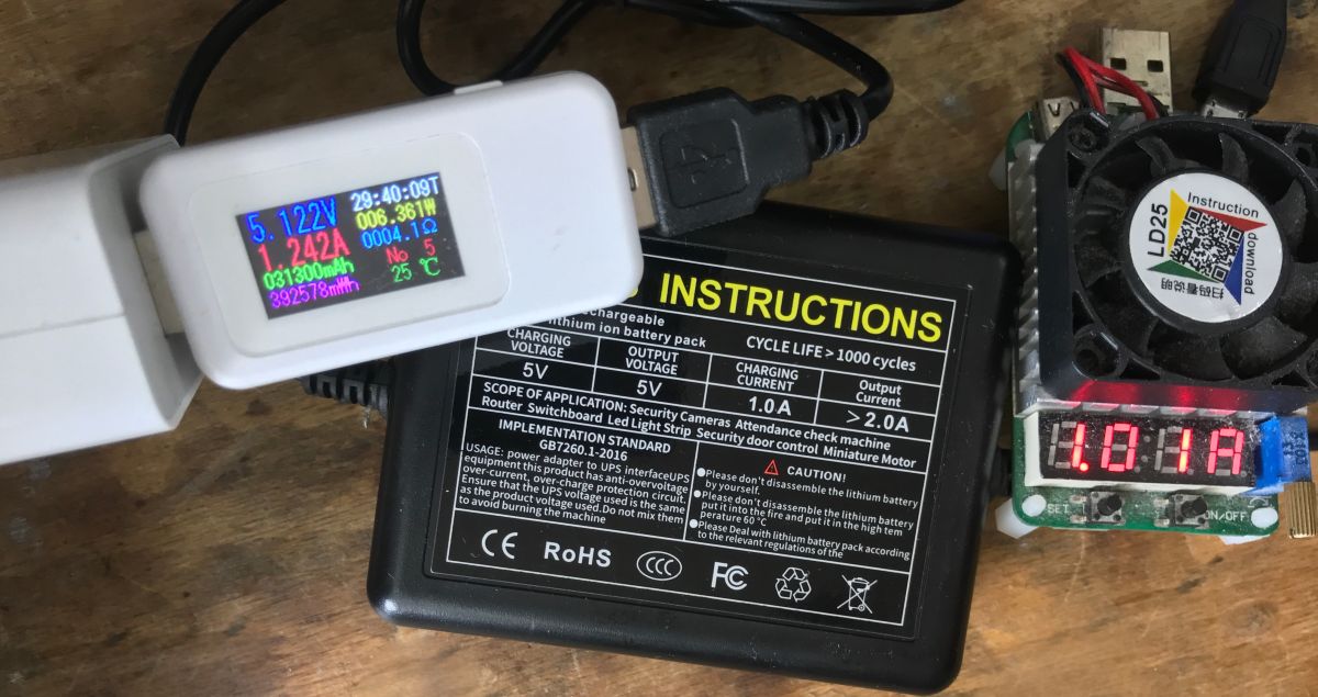

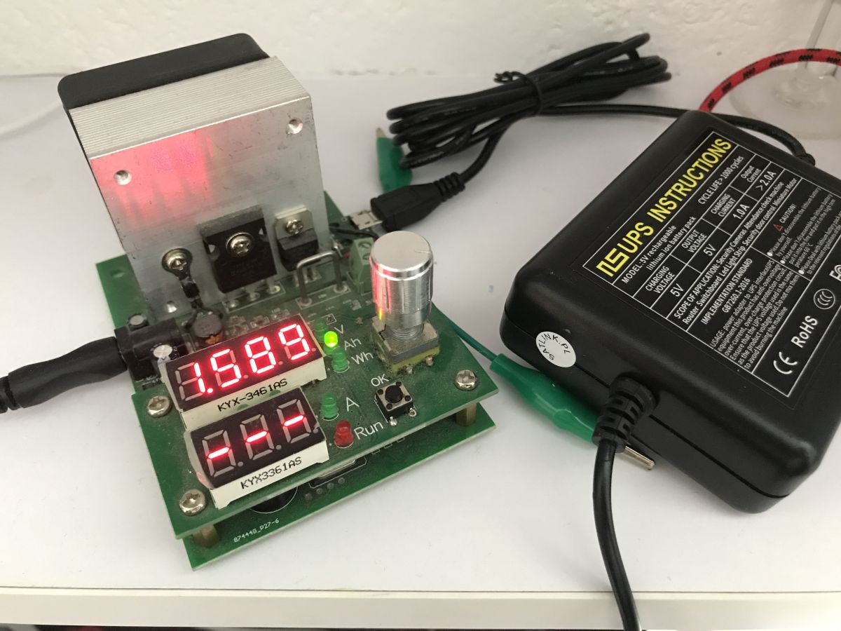

    I charged the whole thing to full, still checking with a USB Doctor meter that I was sure the current draw had dropped significantly. I additionally left it overnight and then measured the capacity with a test load at 1 A.
    The output is 4.5 V at 1 A current, the input is over 5 V and 1.25 A current. This already tells us about the efficiency of such a gadget. With no load (when charged), 0.05 A is drawn.
    I measured the capacitance in the same way, I repeated the test several times, but the results are unrelenting.
    1.6 Ah at 5 V gives about 8 Wh. You could still convert to battery capacity at 3.7 V - 8 Wh/3.7 V ≈ 2.16 Ah, or about 2160 mAh on the cell side (ignoring losses on the inverter; in practice it will be a little less, e.g. 1900-2000 mAh available at the output). Well... that's less than half the promised 5000 mAh. Then again, the 500 mAh in the instructions is rather an error, as the translator suggests charging current.

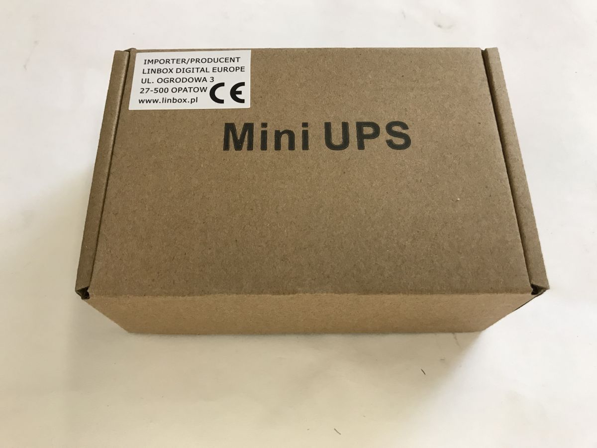

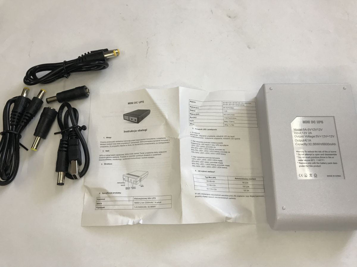

    The second model was even more expensive . We paid a good £150. The seller promises a capacity of 32.56 Wh - we will check.

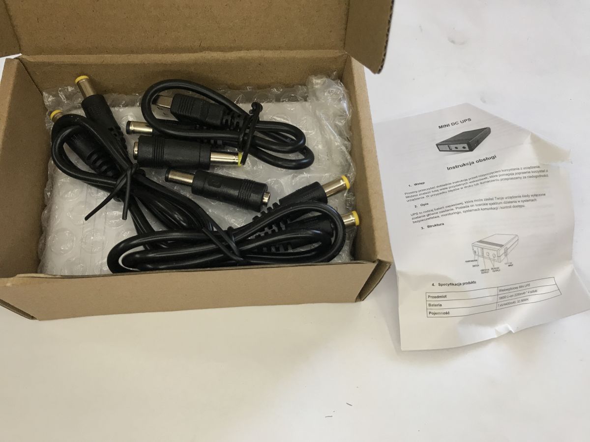

    The set is undoubtedly quite rich. Should that justify the price? In addition, there is also a Polish-language manual. The distributor's contact details are also given there, so we know who is responsible for importing this invention.

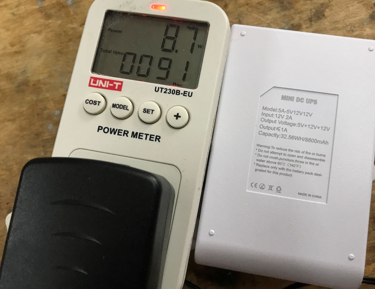

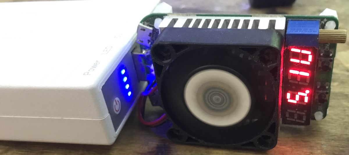

    The device draws up to 10 W from the mains when charging without a load:

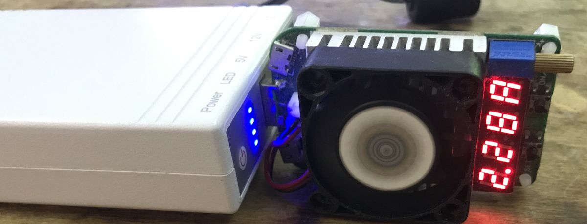

    More than 2 A at 5 V can be drawn:

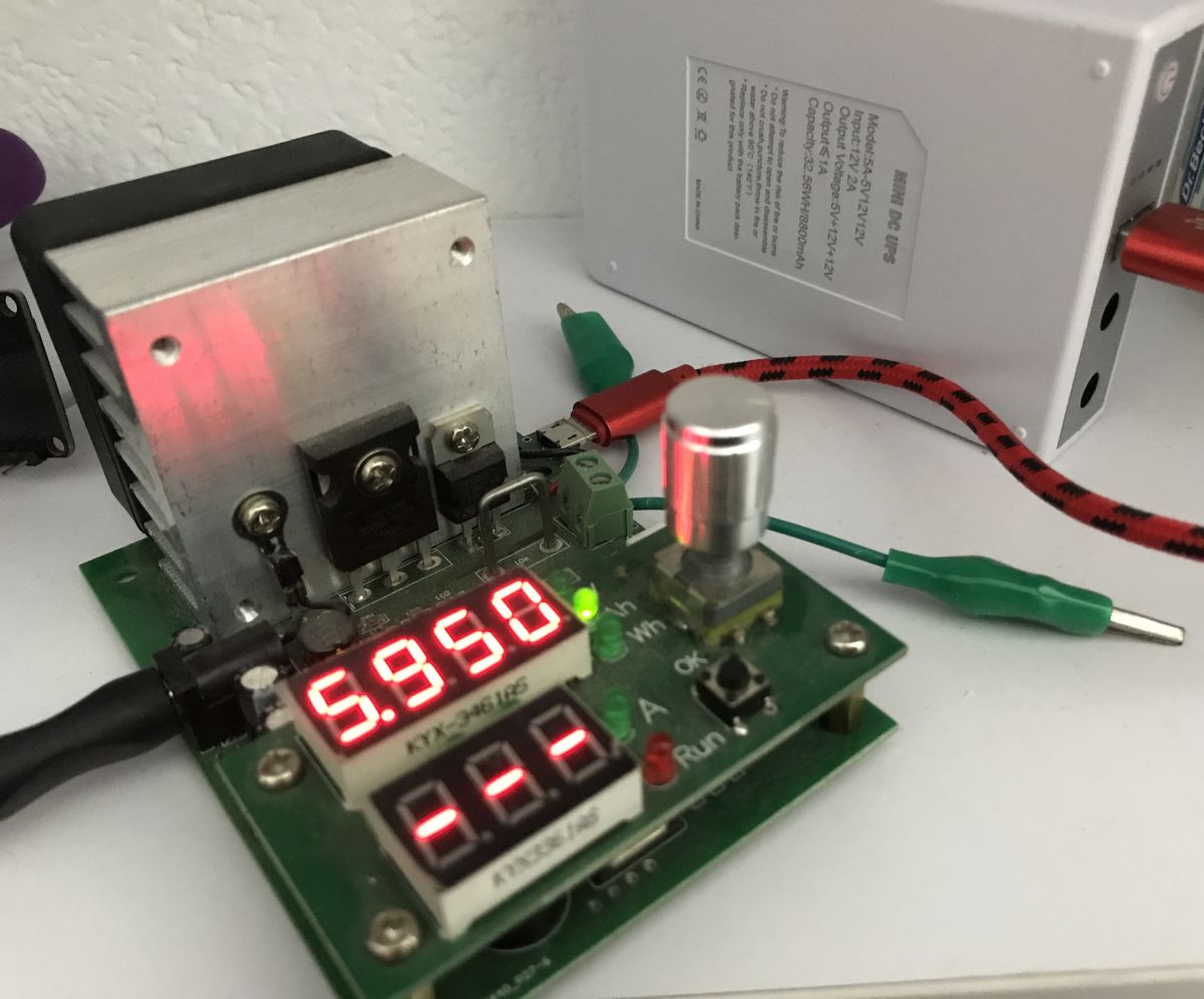

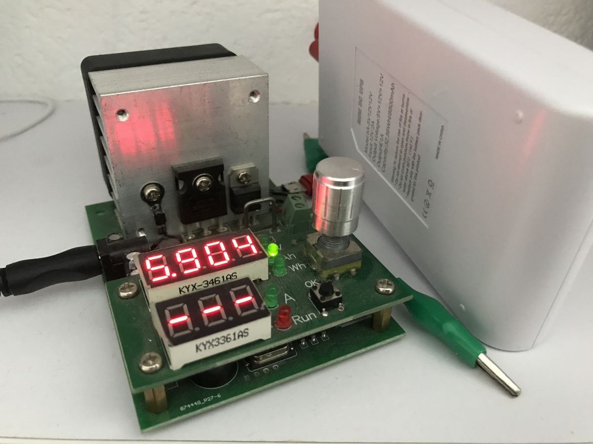

    As before - charging to full and testing. For consistency, test at 5 volts.
    Let's say - 6 Ah at 5 V, or 30 Wh. Here the result is already more in line with expectations, although also a little too small, the error being within 7%.
