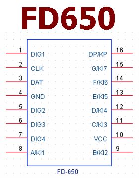

    There is a similar problem with the FD650, on which I based this design. The FD650 is a clone of the TM1650, it also appears under the name HD2015. I have already described it extensively in a topic:
    Running the HD2015 display/button controller after reverse engineering, comparison with TM1637
    The FD650 has the very affliction that it will interfere with our other addresses on the bus.

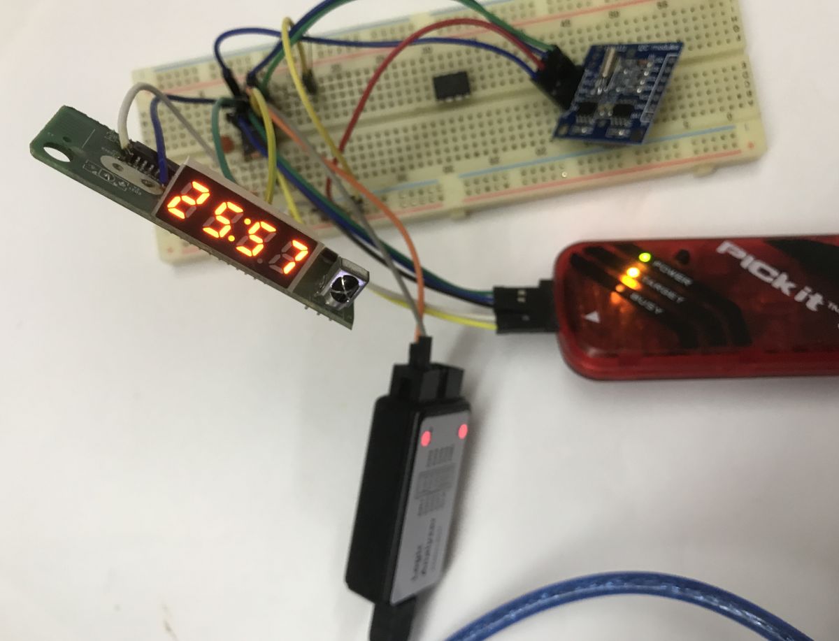

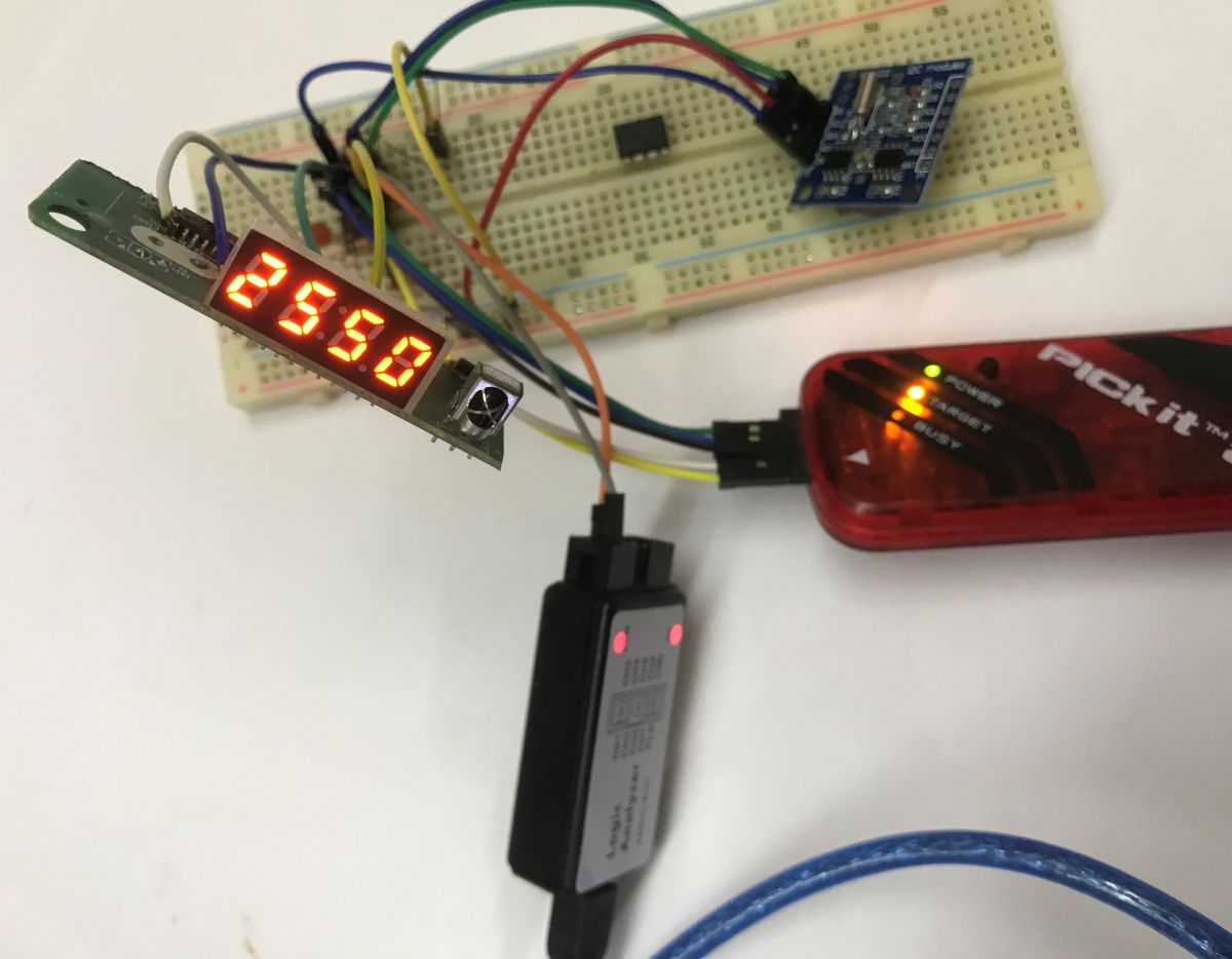

    The project is quite complex, so for simplicity I did the first stages on an Arduino. This was primarily dictated by the desire to check that my module from the FD650 survived the operation. Only after making sure that everything is ok with it will I transfer the code to the PIC.

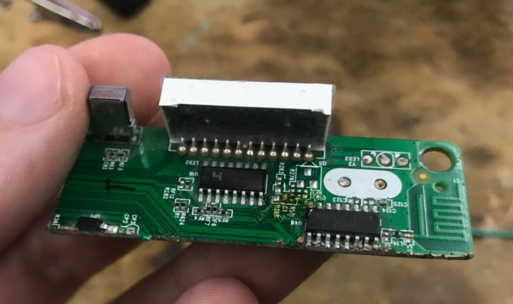

    Module from FD650
    I recovered the module from an old terrestrial TV receiver. The equipment had no remote control and no longer supported the newer standards with DVB-T2. I've been receiving this type of equipment quite often for a while now, so I've been recovering parts from them in bulk. I didn't have room for another board, so I took the liberty of cutting out only what I could use:
    Simple clock on PIC12F683 - three pins, two I2C buses - DS1307 + FD650

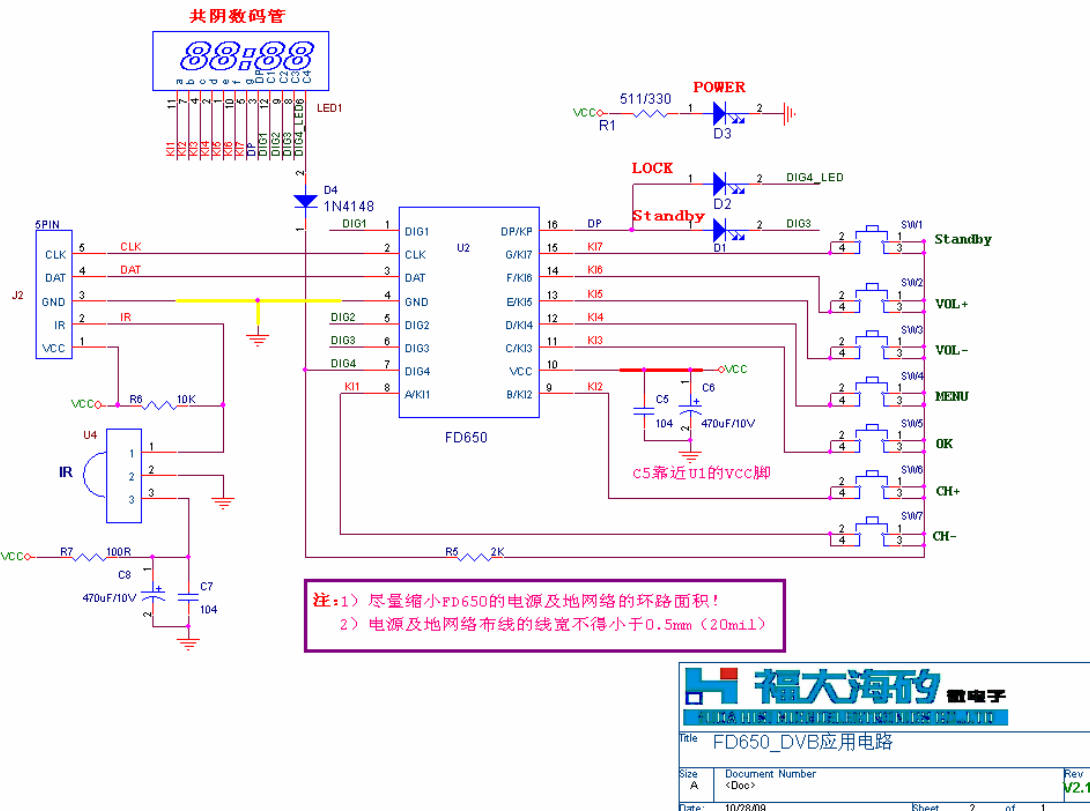

    In addition to the four-digit 7-segment display, there is also its controller, FD650, and some circuitry from RF (unnecessary here - to be removed).
    The circuit on the board may seem incomplete, but nothing could be further from the truth. The FD650 really needs very few components to operate. Below is a sample application of it, which is pretty much in line with what I have on the board. I have only removed the buttons.
    As you can see, you don't even need many resistors - just the 2 kΩ one from the buttons. The LED display doesn't need extra resistors at all.

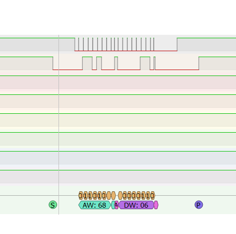

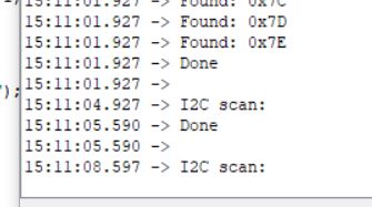

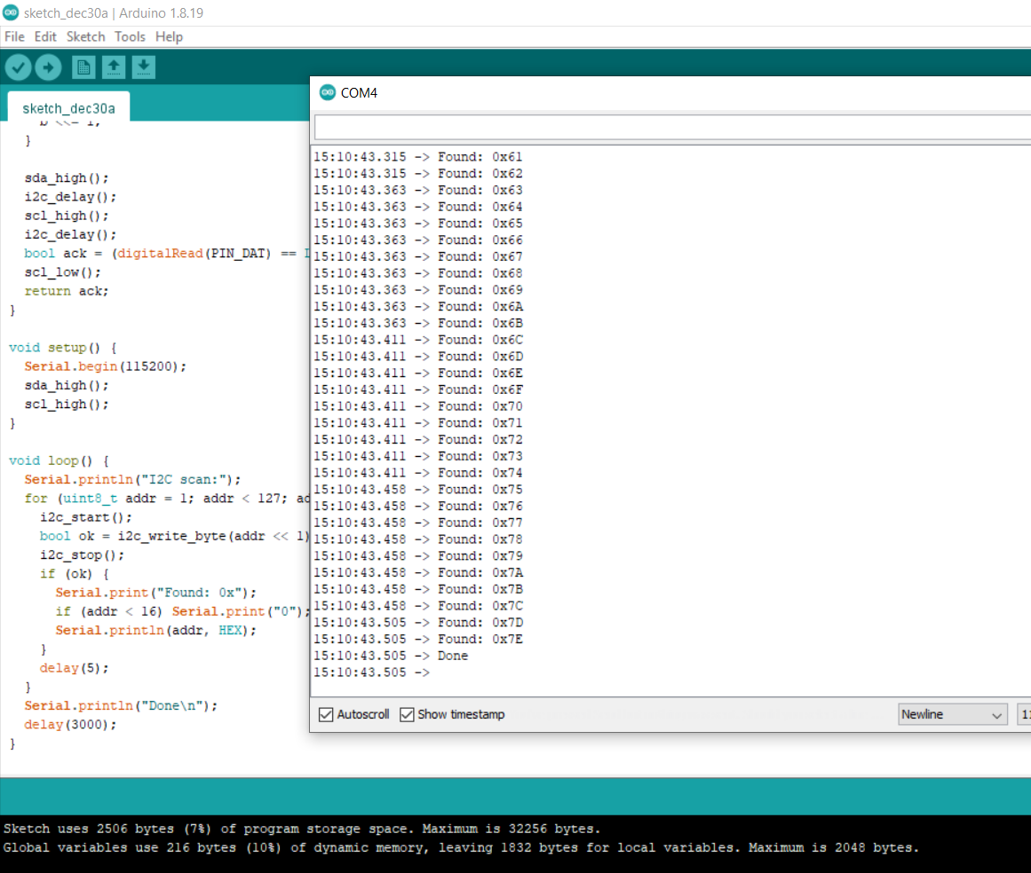

    I2C scan from FD650
    You don't have to take my word for it though. A simple I2C scan is easy to run, just poll consecutive addresses and check the ACK signal. I implemented this on an Arduino for convenience. I didn't even need to give an external pull up resistor (pulling up to the power supply), as the Arduino allows you to configure the pin in this mode. The polling is done in a loop and the active ones are written out to the UART:
    Code: C / C++
    There is only FD650 on the bus, but lots of addresses are reported. In line with concerns.
    For verification I disconnected one of the lines - immediately communication is broken:

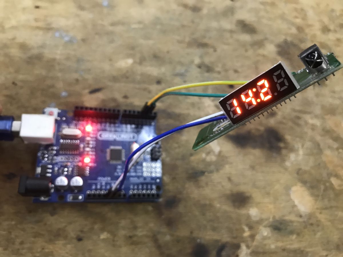

    First segments
    This paragraph will be kept to a minimum as I have essentially repeated this 1:1 work from the previous presentation:
    Everything went straight away and there was no problem with the segments or font. It looks like the segment-to-pin mapping is standardised here, so that most FD650-based tuners (or devices there?) and clones can share the same operating code.

    Simple clock
    I then implemented the showTime function, which simply splits the two numeric values into ones and tens, and then sets them to their respective positions and sends them to the display. I don't operate on a string (character string) here, because I would have to manually shift the number and add 0 for the minutes and hours values from 0 to 9.
    Code: C / C++
    Works:

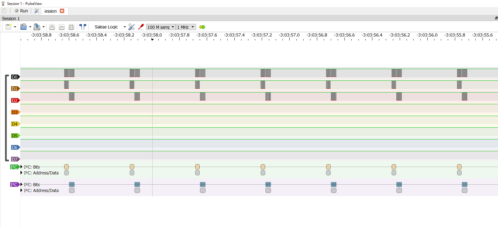

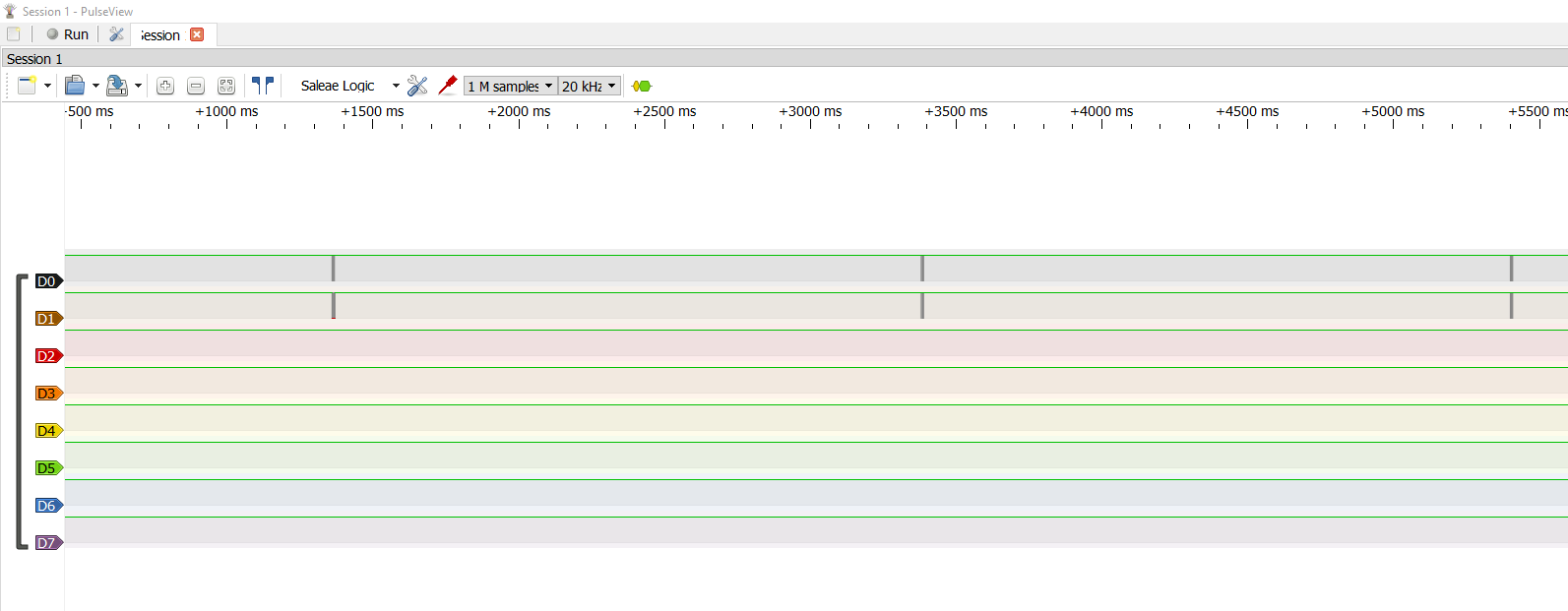

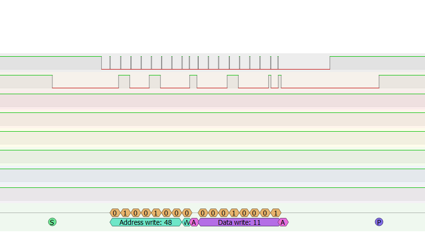

    Let's focus on the communication itself over I2C for now. It's worth taking a look at what's happening on the bus. I used a logic state analyser for this, I have already presented it in a separate topic:
    Salae 24MHz logic state analyser for £40 - analysis of unknown LED display protocol
    I also added an I2C decoder to the collected data to see the bytes being transferred.

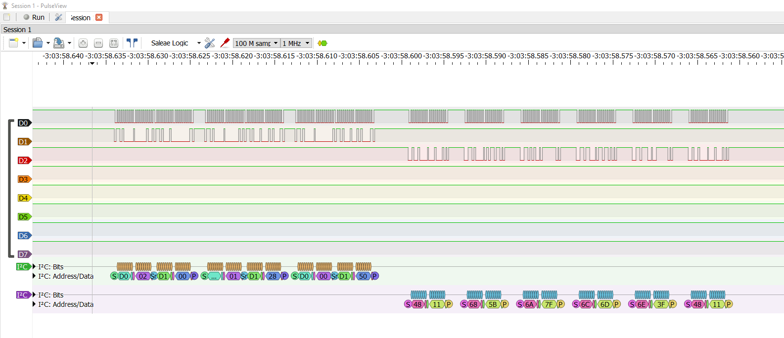

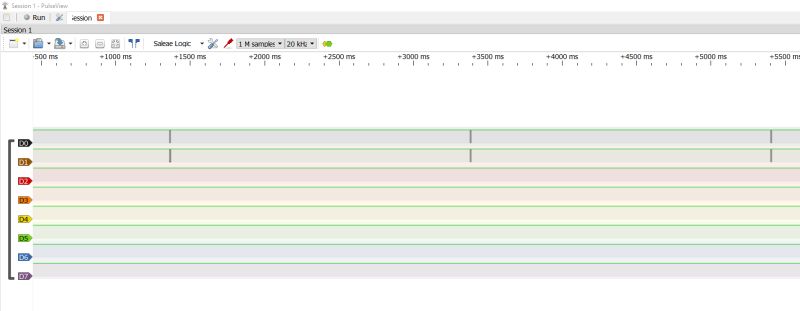

    First, the whole transactions - you can see how the data is sent every (say) 250 ms on the display:

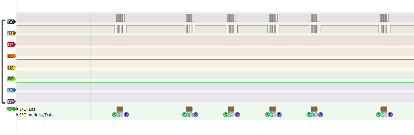

    When zoomed in we see a single operation showTime , this consists of a set of operations to write data to the FD650.

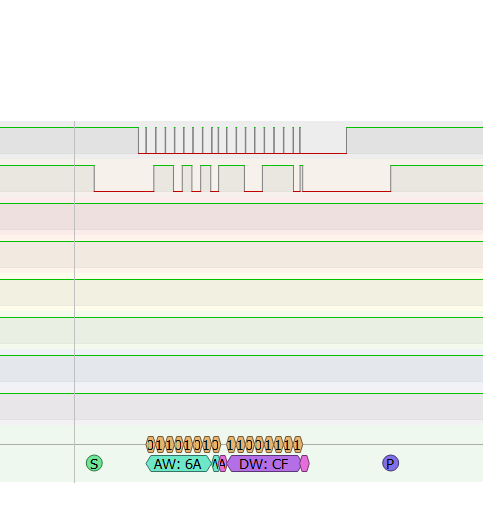

    What we have here is successively running the display (writing 0x11 to address 0x48) and writing four characters (addresses 0x68, 0x6A, 0x6C, 0x6E). The last operation is to re-enable the display - redundant, it was left over from my experiments and I forgot to remove it for the pictures.
    An example close-up of the display enable operation:

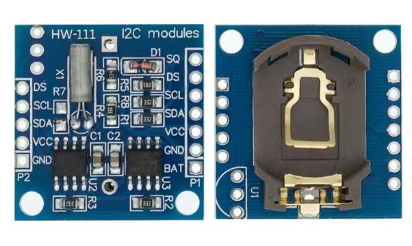

    Now it is time to introduce the DS1307. The DS1307 is a so-called RTC (Real Time Clock), which is a real-time clock chip that is used to keep the current date and time, even when the microcontroller is switched off or reset.
    By using an external backup battery (usually CR2032), the DS1307 can operate independently of the main circuit power supply. Communication with the microcontroller is via I2C.
    My module with the DS1307 still has an EEPROM on board, but I will skip it here for now.

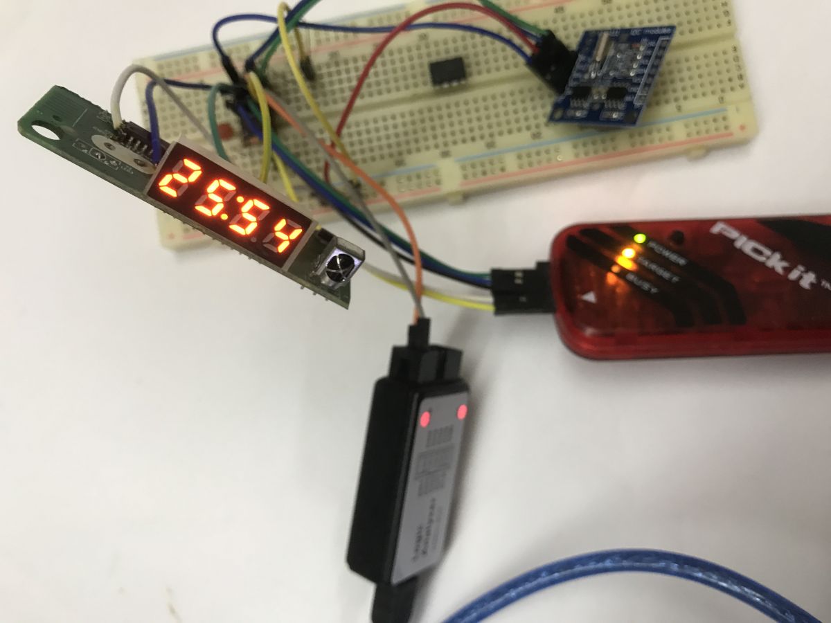

    The pull up resistors turned out to be unnecessary again - the ones from the PIC are sufficient. The code shown works - the time is counted down and displayed. Previously the RTC had to be programmed once, but for now let's assume we did it manually, separately....
    The pictures show the time in mm:ss format, so it may seem odd, but it's more convenient to test this way.
    Simple clock on PIC12F683 - three pins, two I2C buses - DS1307 + FD650 Simple clock on PIC12F683 - three pins, two I2C buses - DS1307 + FD650

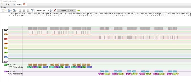

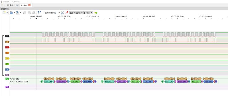

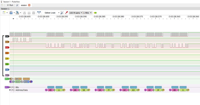

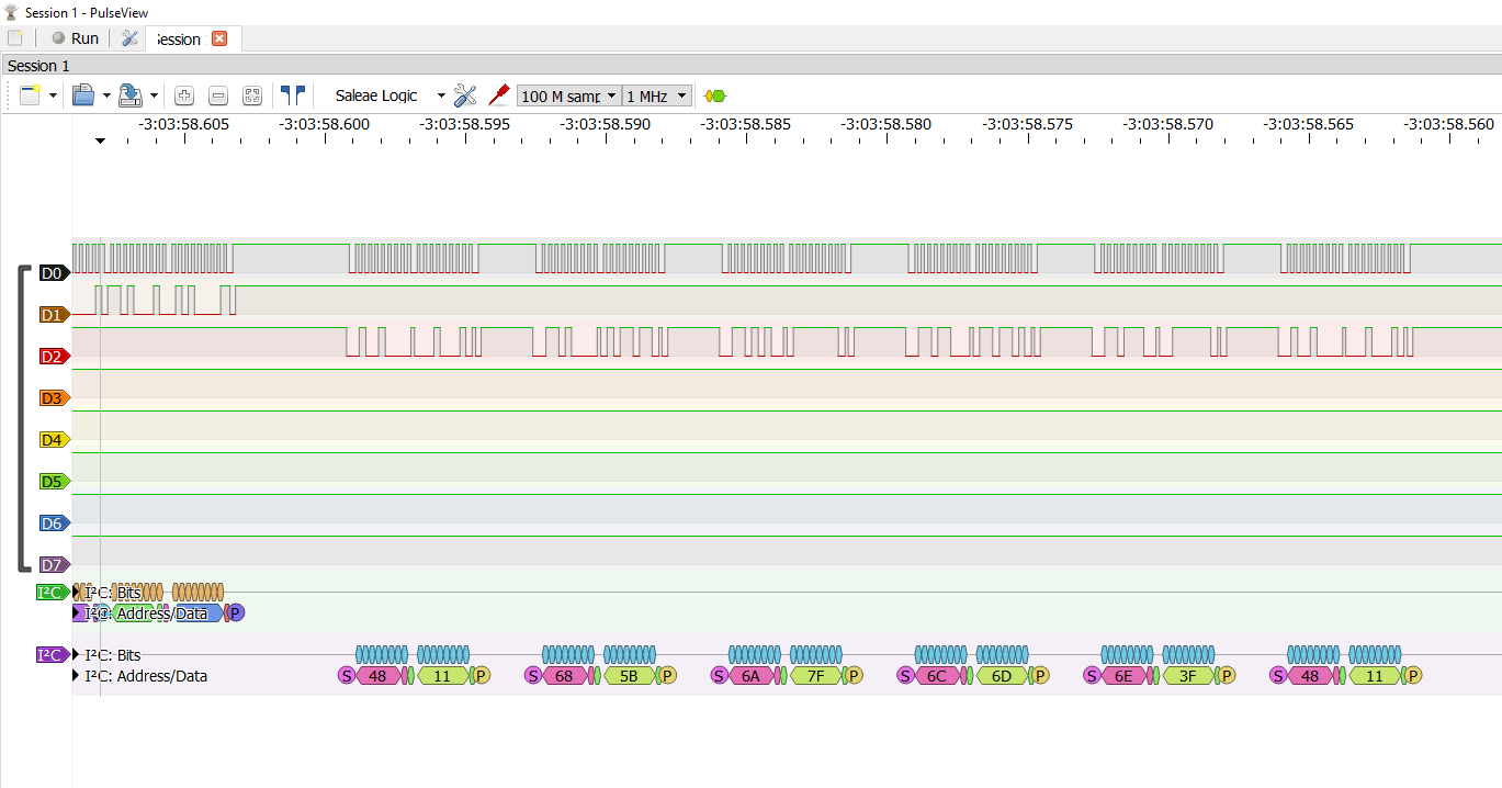

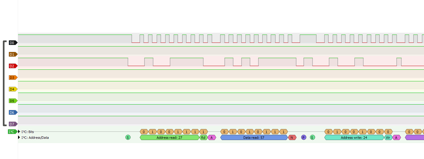

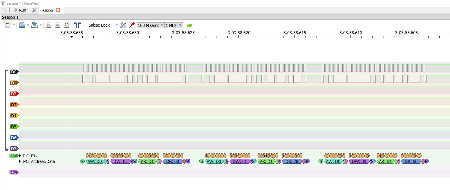

    What does it look like under the hood? I have connected a logic analyser to the D0 (clock), D1 (SDA first) and D2 (SDA second) lines. I have added I2C decoders.
    When zoomed in you can see the correctly decoded transactions. No problems with start/stop conditions, no "ghosts" on the line:
    This is what the time reading from the DS1307 looks like. You can see the characteristic address 0x68 (after shifting and adding the read/write bit 0xD0 or 0xD1) and reading from registers 0, 1, and 2, the value 00:28:50.
    Similarly, the display control. Here you can see the sent segments of the individual digits.

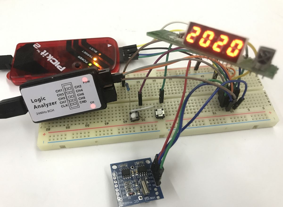

    Key reading
    The next step is to read the keys. I don't have keys on my board, so I added two according to the schematic earlier in the post. I then implemented reading them - reading via I2C from address 0x27. The key code is then returned, as well as a flag as to whether it is/was pressed.
    Code: C / C++
    As a test, I display this code on the display in hexadecimal format. By the way, I added characters 10-15 to the character map.
    Code: C / C++
    The reading can be seen on the analyser:
    This makes it easy to identify the codes of the keys you have:

    The final step is to add the hour and minute setting. These two buttons are sufficient for this. I have assumed that:
    - one just toggles the mode (operation, edit hour, edit minute)
    - the other increases the selected value, a single press increases it once and holding down the key increases it continuously by 1 as long as the key is held
    To do this, I read the keys every loop, examine the current mode (work, edit hour, edit minute), in the case of editing I flash the selected digits and handle the key events accordingly. After editing, the time is saved.
    Code: C / C++
    Result:

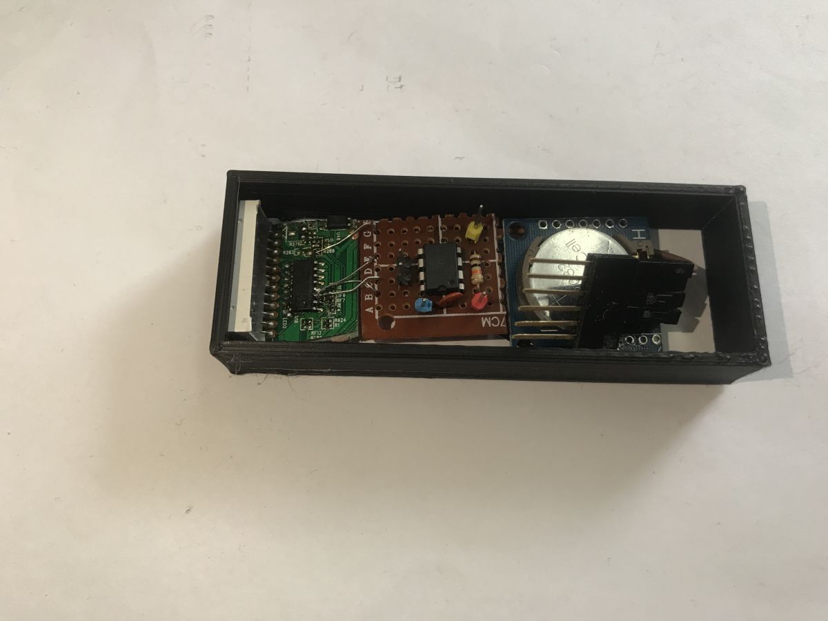

    Case combinations

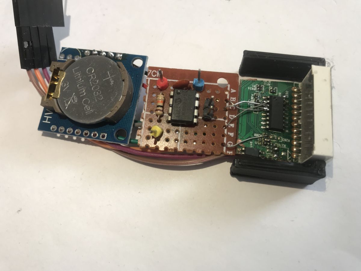

    I have also started making the enclosure, but that will be in a separate topic.
    Summary
    The project proved to be a very interesting and unusual experience. I've run the FD650 before and it wasn't a problem, but here I practiced pin saving (this PIC12F has little free IO, and I may still want to add an alarm soon, an ADC would be useful too) and then general optimisation. In the end, I managed to fit the whole thing on a small PIC and a functional clock came out programmatically.
    Now the hardware can still be worked on - the board shown here could be made smaller, probably by cutting off unnecessary parts of the laminate, and then printing the case on a 3D printer and placing the buttons in a clever way.
    Perhaps I will deal with this in a separate section.
