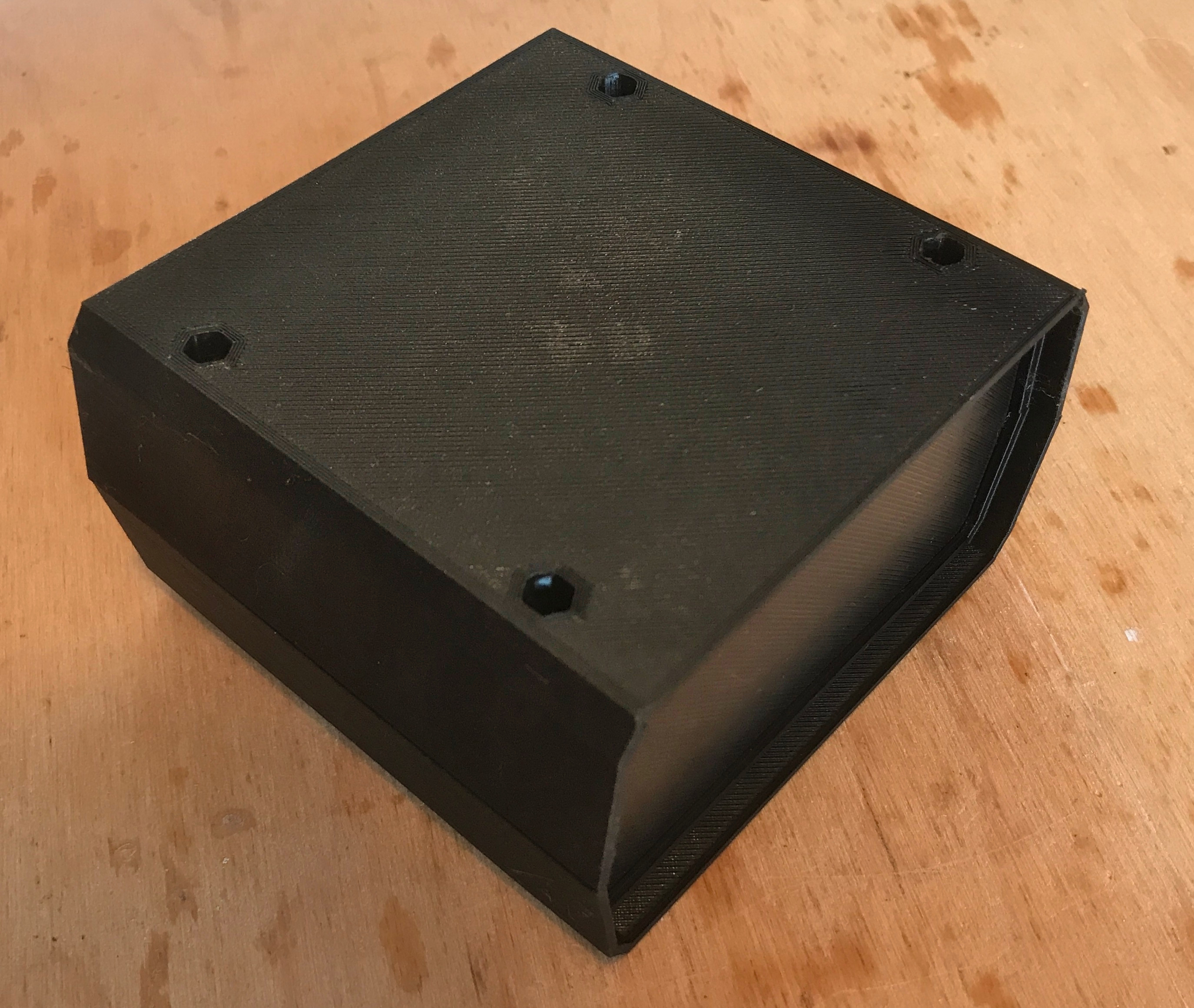

  • Designs a universal 3D printed electronics enclosure in Blender, split into front panel, rear panel, top cover, and bottom cover.
  • Uses a single editable corner with Mirror modifiers plus Boolean cuts, then replicates nut pockets, bolt holes, and legs for four M3 mounts.
  • Builds the case around a 110mm by 60mm footprint with 2mm walls and a 3.15mm-radius M3 nut profile extruded 1.6mm.
  • Prints the enclosure on an Ender 3 Pro in PLA, and the finished case half weighs about 50g and takes less than 7h.
  • Notes that Boolean operations can be finicky, supports are needed for the nut cavities, and the first bolt fit was slightly too tight.

Step 0: Design assumptions
I made the following requirements and assumptions for this case.
Assumptions regarding the overall appearance of the enclosure and its implementation:
- the enclosure will resemble the well-known and popular universal enclosures for DIY projects for hobbyists
- the enclosure will consist of 4 components: front panel, rear panel, top cover and bottom cover
- ideally, the top and bottom covers should be identical
- the housing will be screwed together using screws and nuts (you can screw the screws into the filament and this works well, but such threads weaken over time and a nut solves this)
Assumptions for designing the case in Blender:
- all significant dimensions should be implemented on a grid and be integers (e.g. the height of the case is 50mm, not 50.43432432mm)
- the enclosure should be made, among other things, based on Blender modifiers, so that it can be easily edited (e.g. changing the screw size of the mounts, which are 4 times in the model, should be done once, and the other 3 mounts should update themselves)
- the case should be easy to edit (as above, modifiers, etc)

Step 28: How to mount the case
We also need to determine how we will mount the enclosure. I decided to use 4 M3 bolts and nuts, such:
We will model the bolt holes right away, but we will start with the M3 nut model.

Step 45: First print of the case
The model shown above I have decided to print in its entirety. It does not yet include the mounts for the electronics board to the inside of the case, but these are not necessary as it is only one half of the case. We can attach the tiles to the other half.
The model above requires supports which need to be included in Cura (or the Slicer we are using). These are only needed for the nut locations.
Model in Cura:
Visible supports:
Entire case:
Housing in the process of being printed:
Printed:
When removed from the printer:
A glance at how the supports have printed:
Supports removed:
Nut fitting:

Final result
I printed the enclosure in ''Standard'' settings with Cura.
The case half weighs about 50g and took less than 7h:
The panel (without holes) weighs about 12g and took just under 1.5h:
I only gave the panel one side so that I could present the centre of the case in the photos on occasion:
