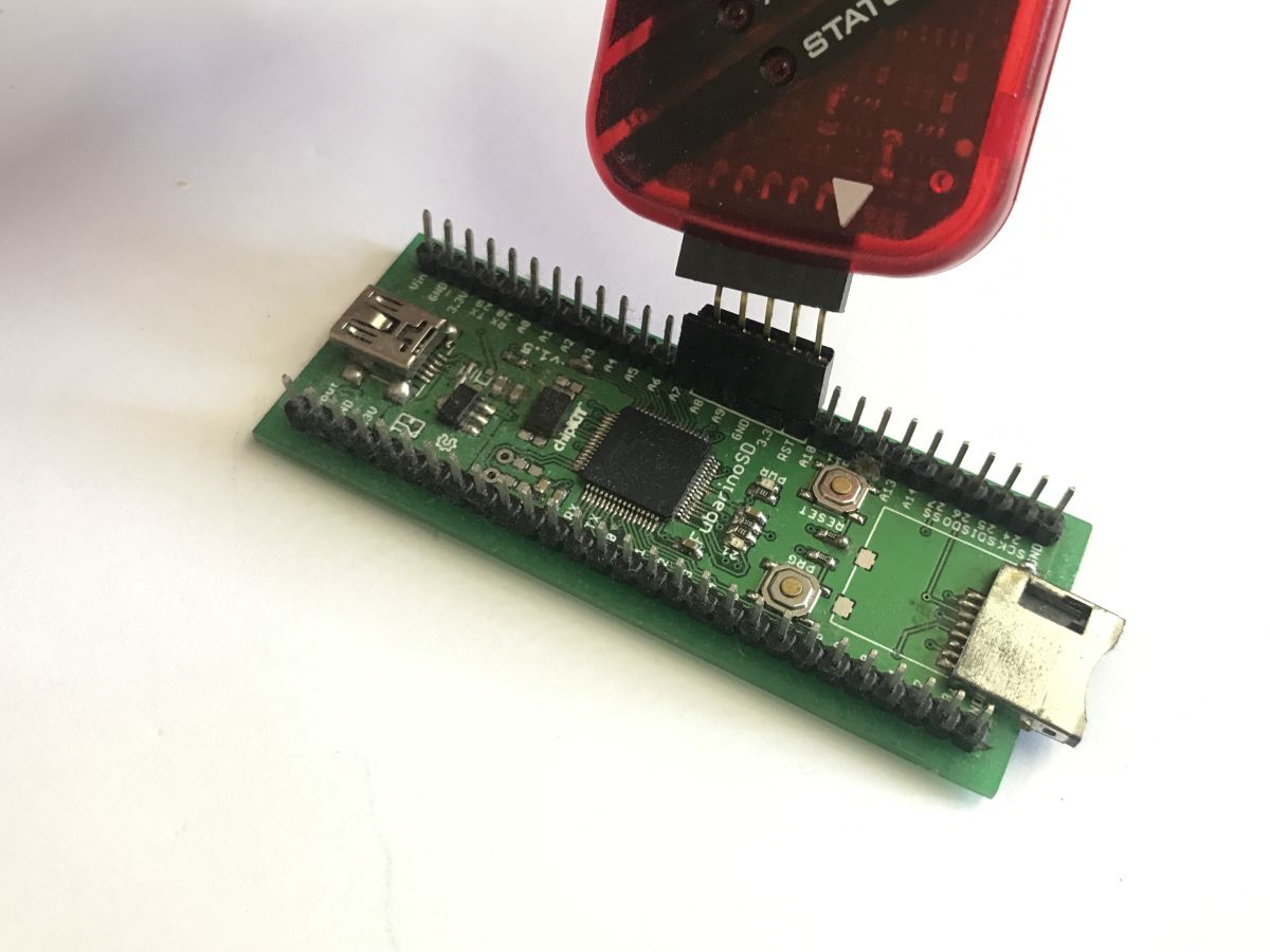

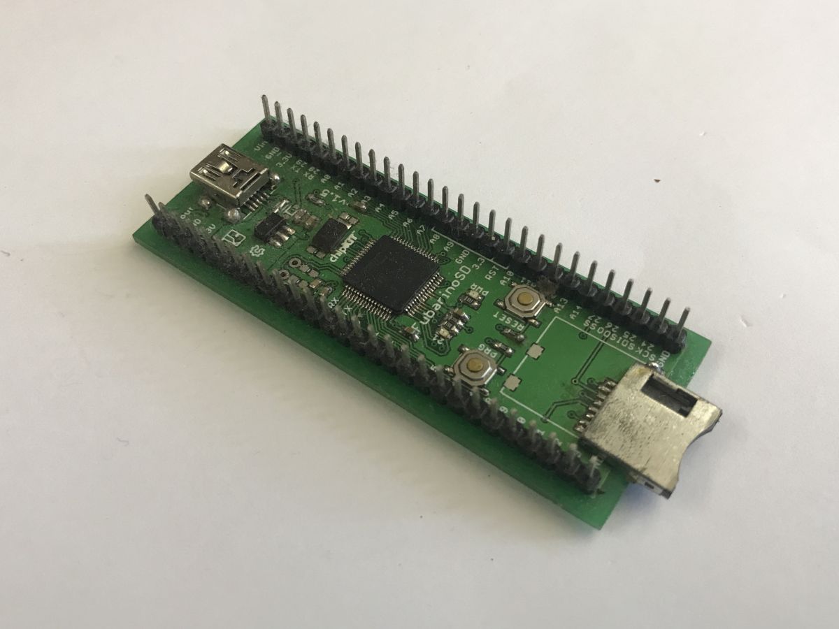

    PCB used
    The experiment is based on the Fubarino SD board with a PIC32MX795F512. The PIC32MX795F512 is a 32-bit microcontroller equipped with a MIPS M4K core clocked at up to 80 MHz. It has 512 KB of Flash memory and 128 KB of RAM. The Fubarino SD board itself is suitable for such tests, as it exposes the necessary pins and allows for the connection of a hardware programmer.

    Programmer used
    The PIC32MX does not come with a factory-loaded bootloader, and as I want to programme it from scratch, I need to use ICSP. ICSP (In-Circuit Serial Programming) is an interface developed by Microchip, allowing the microcontroller to be programmed and debugged whilst mounted directly on the target board. For programming via ICSP, I used the PICKIT3, a popular programmer that is also compatible with newer 32-bit microcontrollers. My board has clearly separated ICSP pins, so it’s easy to connect to it:

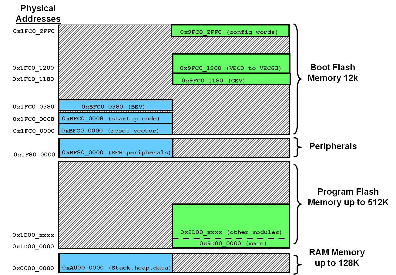

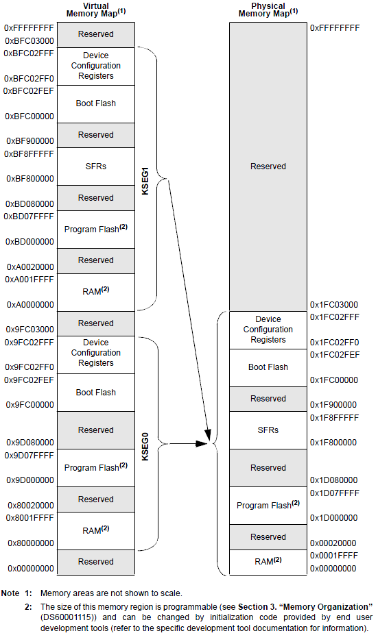

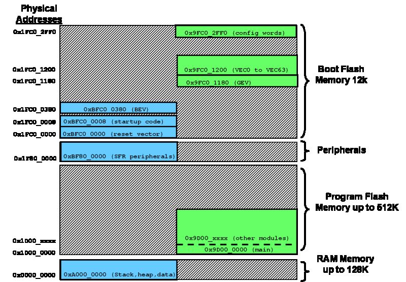

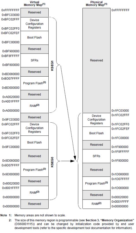

    PIC32MX795F512 memory map
    Understanding the memory map is essential for bare-metal programming, as the MIPS architecture divides the address space into different virtual segments. The KSEG0 segment shown in the diagrams is cached and is used primarily for executing code from Flash memory, whilst KSEG1 bypasses the cache, which is essential for the correct handling of peripheral registers (SFRs) and the reset vector.
    Programming the PIC32MX795F512 from scratch without external libraries – part 1
    The first diagram illustrates the division of the 4-gigabyte virtual address space into kernel segments (KSEG) and user space (KUSEG). It shows that the KSEG0 (cached) and KSEG1 (uncached) segments point to the same 512 MB base area of physical memory. Fixed mapping (FMT) simplifies the architecture and eliminates the need to reconfigure the MMU after a reboot.
    The second diagram illustrates the direct mapping of physical memory to specific virtual addresses. Program memory (Flash) with the physical address 0x1D000000 is read more quickly at the address 0x9D000000 (KSEG0) thanks to the cache. Hardware registers (SFRs), on the other hand, are accessed from the virtual address 0xBF800000 (KSEG1), which forces access to the physical hardware by bypassing the cache.
    Source: https://developerhelp.microchip.com/xwiki/bin...view/memory-organization-overview/memory-map/

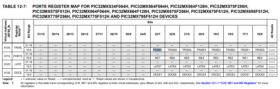

    Rather than getting bogged down in complex systems, I’ll focus on the basics – making an LED blink in a simple way. In the MIPS architecture, peripherals are memory-mapped (Memory Mapped I/O). I access them using the non-cached virtual memory KSEG1 (the segment itself starts at ‘0xA0000000’, and the peripheral register block lies within it at addresses starting from ‘0xBF800000’). This is quite important for hardware, as read/write operations must go straight to the pins and not get stuck in the L1 cache. I’ve taken the register addresses themselves from the data sheet; below is an example for TRISE (0x6100):
    Instead of using Microchip’s header files (dozens, if not hundreds, of files), I define the pins manually.
    In PIC32 microcontrollers, each port has three main registers:
    1. TRIS (Tristate) – specifies the direction (1=Input, 0=Output)
    2. PORT – used to read the pin state.
    3. LAT (Latch) – used to write the pin state.
    Furthermore, the hardware provides atomic registers: CLR, SET and INV. Writing to ‘LATEINV’ will cause a hardware bit inversion, which is significantly faster than the C operation (‘LATE = LATE ^ 0xFFFF;’).
    For example, for TRISE, the result is 0xBF880000 + 0x6104, i.e. 0xBF886104.

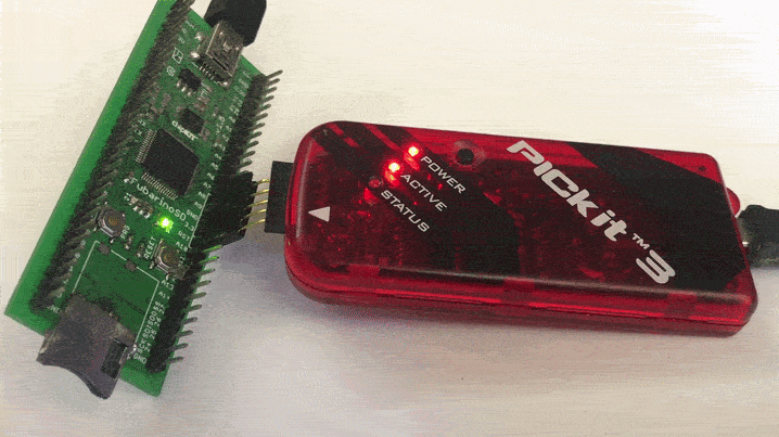

    Final presentation
    I’ve uploaded the code, a moment’s wait and… the LED is flashing!
    As you can see, headers and external libraries aren’t needed if you just want to make the LED blink. But what next?
