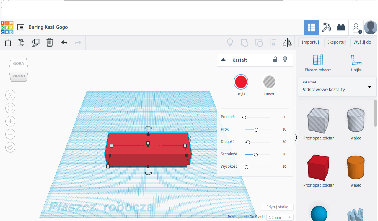

Drawing case with external dimensions 90x60x40mm, walls 2mm, front and back panels 1mm thick.
We start by selecting the Cuboid from the menu on the right and placing it in the centre of the working plane. We then set its dimensions to 90x60x20.
This will be the outer dimension of one half of the casing. This can be done on the object menu or by editing the dimensions that appear on the dimension lines.
We click LPM on this object and ctrl ctrl v, move the copy to the side and set its dimensions.
These will be the internal dimensions of the housing half after taking into account the assumed wall thickness i.e. our Hole should be 86mm and raised above the working plane by 2mm using the black triangle.
This can only be raised in front, side view by rotating the working plane using the cube in the top left corner.
