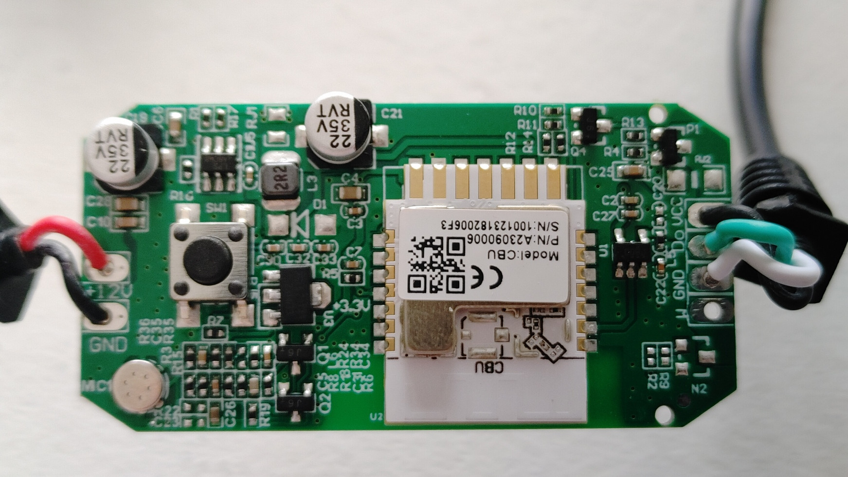

Hi all! I just got two of these outdoor addressable LED Spotlights (RGBW+IC) that use a CBU. Disassembly was a bit destructive and cracked the case that held the circuit board, but it'll still be usable when it's done.
Photo of a circuit board with a CBU module and electronic components.
Circuit board of JBT-WF1-XC004-YWY module with pin labels
Close-up of a circuit board with markings and LED lights.
Close-up of a circuit board with electronic components.
I was successfully able to backup the factory firmware (attached) and install OpenBeken using BK Flasher, but haven't been able to make much progress since then. I can't seem to figure out how the GIPOs control the lights. I used the GPIO doctor on all the pins, but none will cause the lights to light up in any way (they did work before I flashed OpenBeken). I've only been able to identify that P24 is the button by using the "Set Input P-up," and pressing the button to see the change. Other than that, I am hitting a wall.
Text Description
- Microphone (TODO) on P23
- SPI MISO17
- SPI MOSI16
Device seems to be using CBU module, which is using BK7231N.

I did find out from the backup that BK Flasher identified the use of SPI, MOSI, and MISO. You'll have to forgive me, as that is getting beyond my level of knowledge and it's a bit of a foreign language. I did my best to trace out the pins on the board and what components they are connected to. Here's what I found:

p.kaczmarek2 16 Jan 2024 07:55
This looks like individually adressable LEDs, the DO (Data Out) marking also indicates this. Have you tried our experimental SPI driver? 1. Start driver startDriver SM16703P 2. Init Driver - replace... [Read more]
pborrelli 16 Jan 2024 15:51
You Sir are a genius and a saint! I ran the SPI Driver commands and got light! Two of the four lit up, one blue and the other white. I then powered it down to get a picture of the chip on the LED board: ... [Read more]
p.kaczmarek2 16 Jan 2024 16:18
WS2814A ... well, to be honest, it's the first time ever I see this chip, but it bears a significant resemblance to WS2812 LEDs. Let's check the datasheet: https://obrazki.elektroda.pl/6439973400_1705418166_thumb.jpg... [Read more]
pborrelli 16 Jan 2024 17:44
Good to know that it's new equipment, and not just that I'm new. I cleared the assignment on P16 and did some poking and prodding and am finally getting somewhere. P8 & P15 are set to relays, and I have... [Read more]
pborrelli 17 Jan 2024 23:30
I've been doing some testing and tuning, but not much to report. I can get all four lights to light up by playing with various settings on the number of pixels and the color assignment going to each one,... [Read more]
pborrelli 15 Aug 2024 20:52
So it's been most of a year now, these sat for about seven months, but I finally picked them up again. I found a workaround that provides correct color and individual control of each LED; though it's... [Read more]
TL;DR: For these 4-light BK7231N CBU spotlights, "Do not set any GPIO role for P16" is the key fix. Leave P16 free for SPI data, toggle P8 and P15 to power the LED section, and test with OpenBeken SM16703P. If colors remain random, ESPHome Beken_SPI_LED_Strip with sk6812 and is_wrgb: True solved correct RGBW control. [#20912797]
