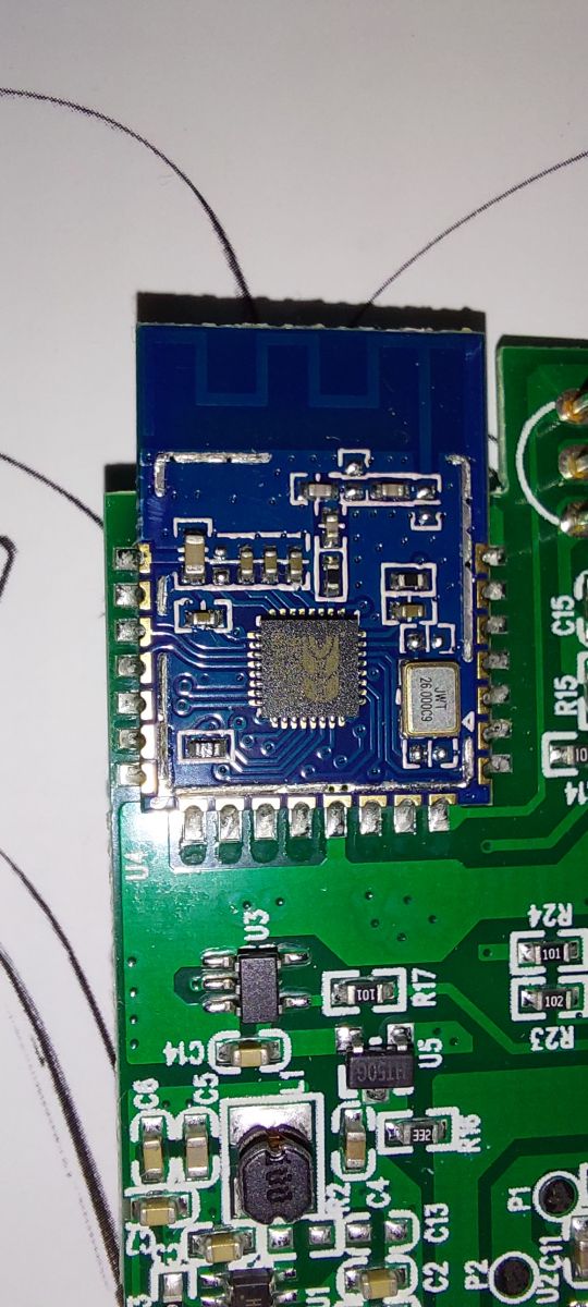

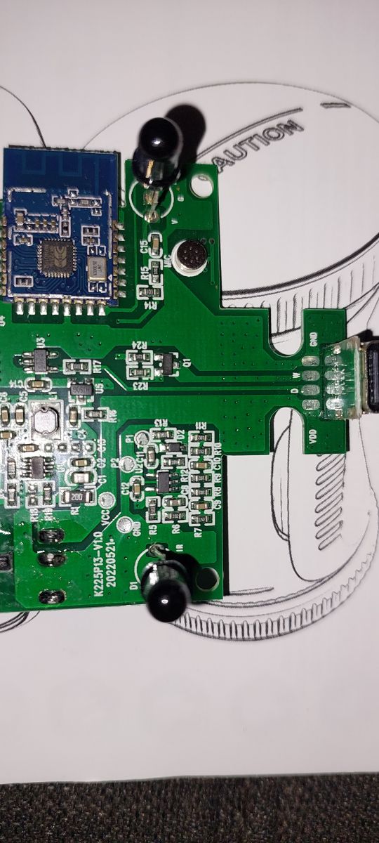

    MOSI and MISO are signals for SPI. Where are the P17 and P16 of CBU connected?
    Can you post more photos? Can you make a list of ICs on the board? How is lamp connected to board?

    I had a quick little old man look.. (I'll post some pics of front and back of board later tonight).. Too many vias to trace with naked eye etc..
    to me it looks fairly stock.. I think the p16 p 17 maybe connected to filter network then op-amp for the Mic[mem's maybe] .
    other than that the package is a little too hard to find info on, it's the NU package if I remember correctly. there are 8 castellations at the bottom of the PCB. [ @ work so this is off the top of the head..]

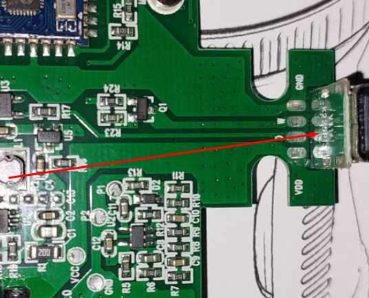

    Most of the devices are using PWM to control LEDs. Some are using SM2135, SM2235, BP5758, etc, "I2C-like" drivers, which are also supported by OpenBeken. And in rare cases, some other RGB control can be used.
    This MISO/MOSI looks like SPI interface, this is why I am worried. I don't think you can treat SPI lines as RELAY or button.
    What is this connector? What is connected there?
    [BK7231N/CBU] Casa Life ALDI Aus - Floor Lamp Mood Lamp - RGB control, SPI? MOSI? MISO?
    Is this power supply connector or LEDs? We need more information.
