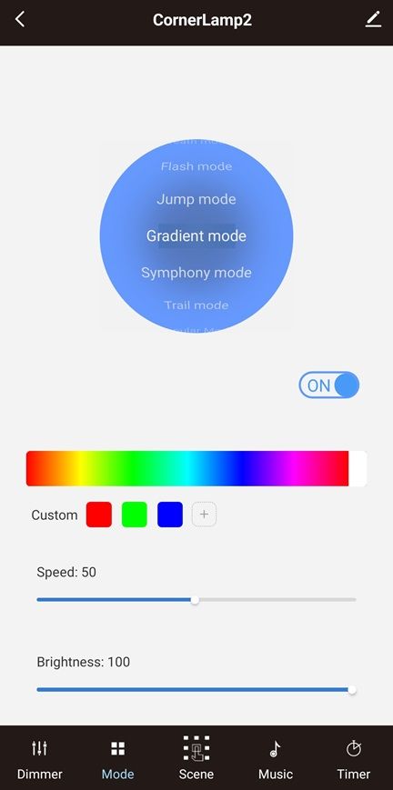

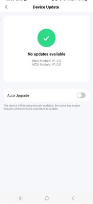

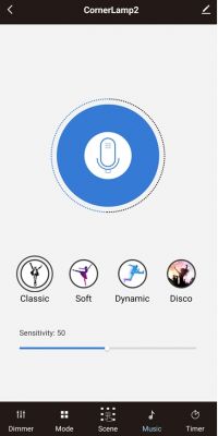

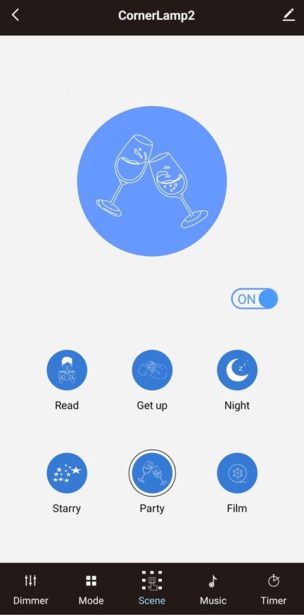

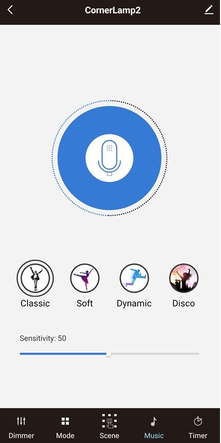

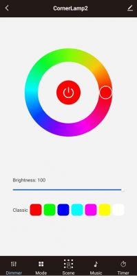

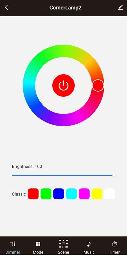

    After I added it to Tuya app this is what options are in it:
    Device update screen showing no updates available.
    App interface for controlling an LED lamp with a color wheel and brightness sliders.
    App interface for controlling a corner lamp with lighting modes and brightness adjustment.
    App interface with lighting settings for a corner lamp.
    Screenshot of the CornerLamp2 app interface controlling a corner lamp, with music mode options and sensitivity adjustment.

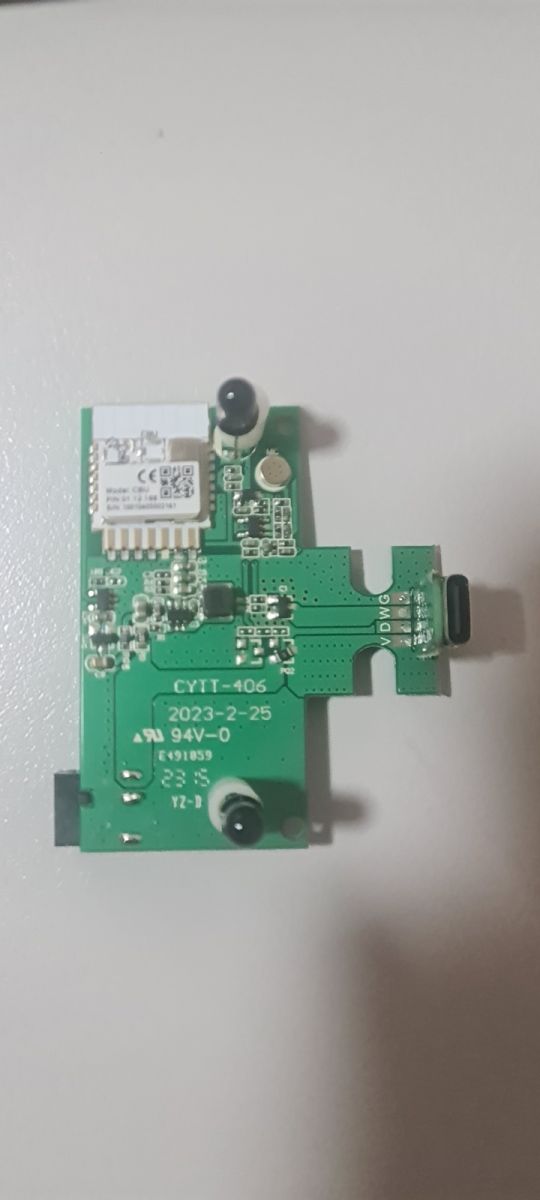

    After opening a few screws from the base I got to the PCB:
    Close-up of a PCB module labeled CYTI-406 on a white background.

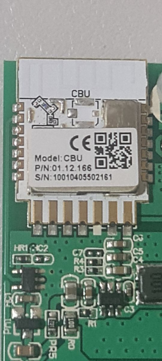

    And there is a CBU module:
    CBU module on a circuit board, technical markings visible

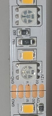

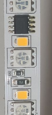

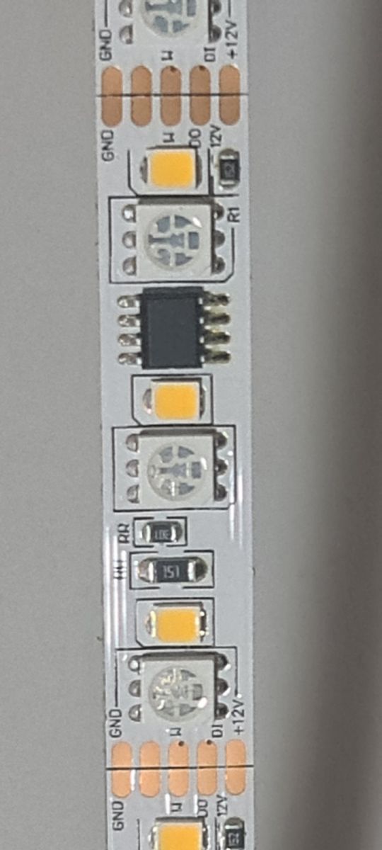

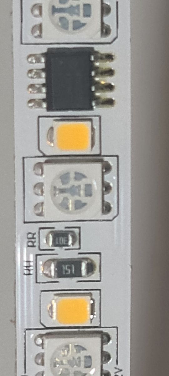

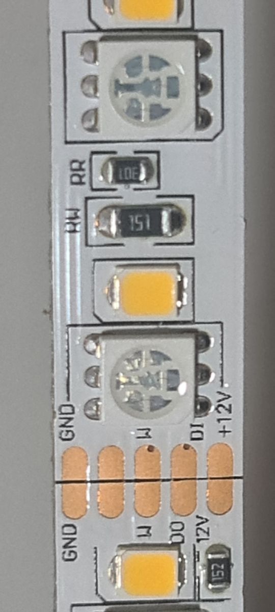

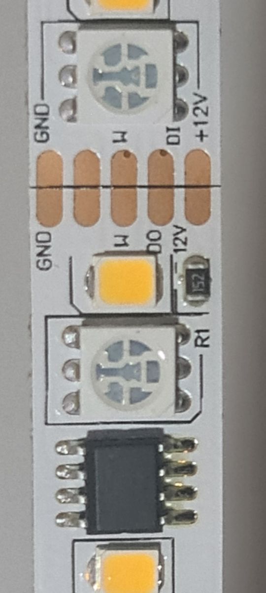

    Below are some pics of the led strip used in this device:
    WS2811 LED strip with a SOIC chip and 3 RGB LEDs.
    Close-up of an LED strip with pin labels and electronic components.
    Close-up of an LED strip with several diodes and a small integrated circuit.
    Close-up of an LED strip with visible components, including diodes and an integrated circuit.

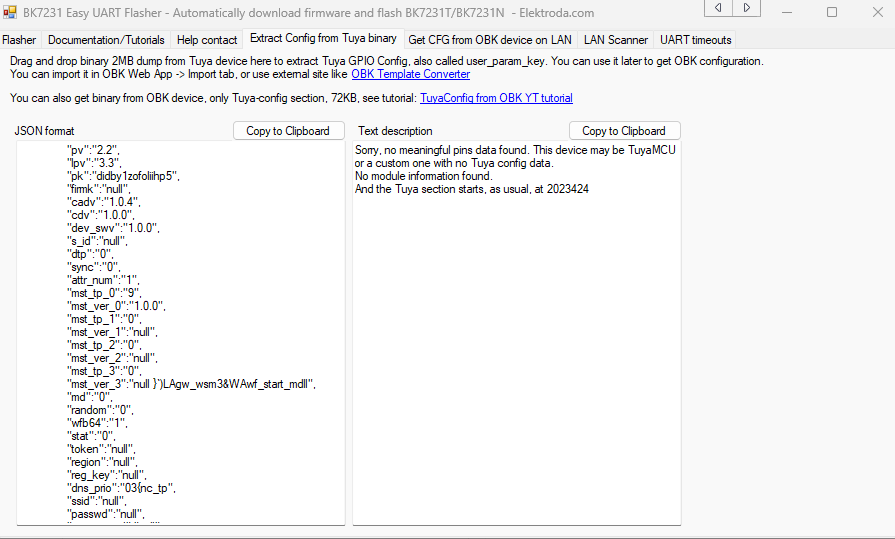

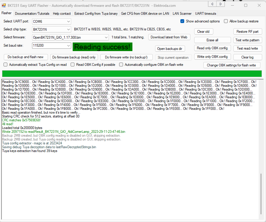

    Next got my hacking kit out and got a Tuya firmware backup (attached):
    Close-up of a PCB with a CBU module visible.
    Screenshot of BK7231N Easy UART Flasher software during data reading.
    OBK configuration extraction did not reveal anything useful - must be TuyaMCU in there somewhere :)
    Screenshot of BK7231 Easy UART Flasher software showing JSON configuration for a Tuya device.

    Sorry, no meaningful pins data found. This device may be TuyaMCU or a custom one with no Tuya config data.
    No module information found.
    I have not flashed OBK to it yet.
    Just wanted to see first what is possible to do with this device.

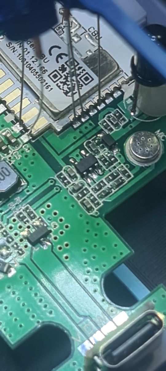

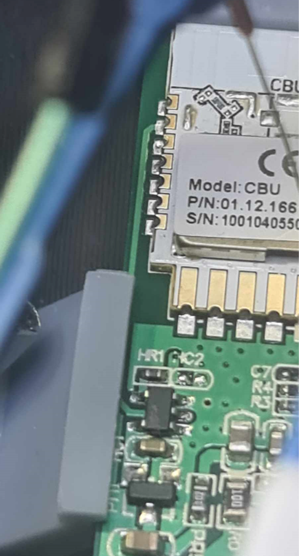

    Hello, can you check where is the data signal of LEDs connected? I think it may be connected to P16, which means there is a WIFI module driving LEDs directly, without TuyaMCU.
    Check Tuya docs to see where P16 is:
    https://developer.tuya.com/en/docs/iot/cbu-module-datasheet?id=Ka07pykl5dk4u
  • #3 20838981
    MnM1
    Posts: 175
    Rate: 13

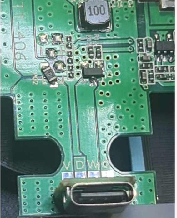

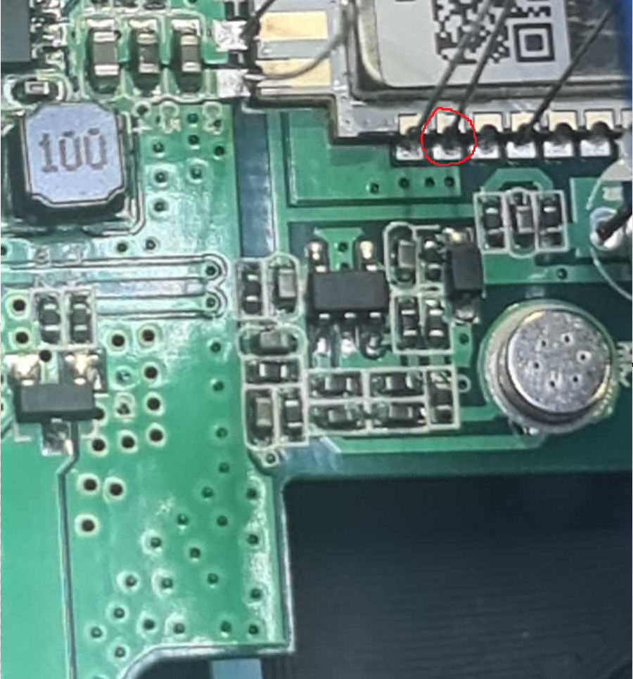

    The data pin seems to go into the unmarked black chip. Not sure if it goes to P16 (marked in red which actually is RX1) from there.
    Image of a green printed circuit board with electronic components and a USB-C port.
    Close-up of a green circuit board with visible electronic components. One pin is marked with a red circle.
  • #4 20838996
    Posts: 14755
    Rate: 12880

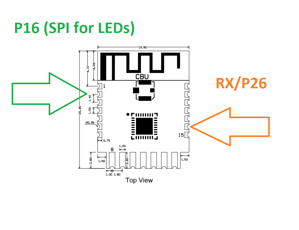

    You have marked RX, not P16. There is a difference between pin 16 on image and P16 of BK:
    2 P16 I/O Common GPIO, which can be reused as SPI_MOSI (Correspond to Pin 12 of the IC)
    P16 (SPI_MOSI) used to control LEDs directly is a pin 2 on the CBU image.
    Diagram of the CBU module with marked pins P16 and RX/P26.
  • #5 20839014
    MnM1
    Posts: 175
    Rate: 13
    I see what you mean - my bad
    There seems to be a trace coming out of P16:
    Close-up of an electronic circuit with a visible module and markings on the circuit board.
    Seems to be going to the black chip under HR1
  • #6 20839019

    This is RGB + W device, right? So RGB LEDs are addressable and W is driven via PWM?
  • #7 20839026
    MnM1
    Posts: 175
    Rate: 13
    RGB LEDs are addressable. But not sure if W is PWM - how can I tell?

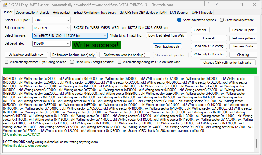

    Added after 4 [minutes]:
    Done.
    Screenshot of the BK7231 Easy UART Flasher program with a Write success! message.

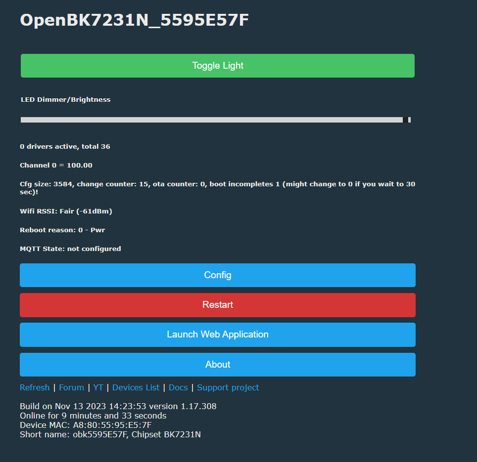

  • #12 20839120
    Posts: 14755
    Rate: 12880
    Once we finish testing with the GPIO doctor, we will also proceed to test the LEDs with current SM16703 driver. I tested it with WS2812 once, and it was somewhat working, but it wasn't perfect.

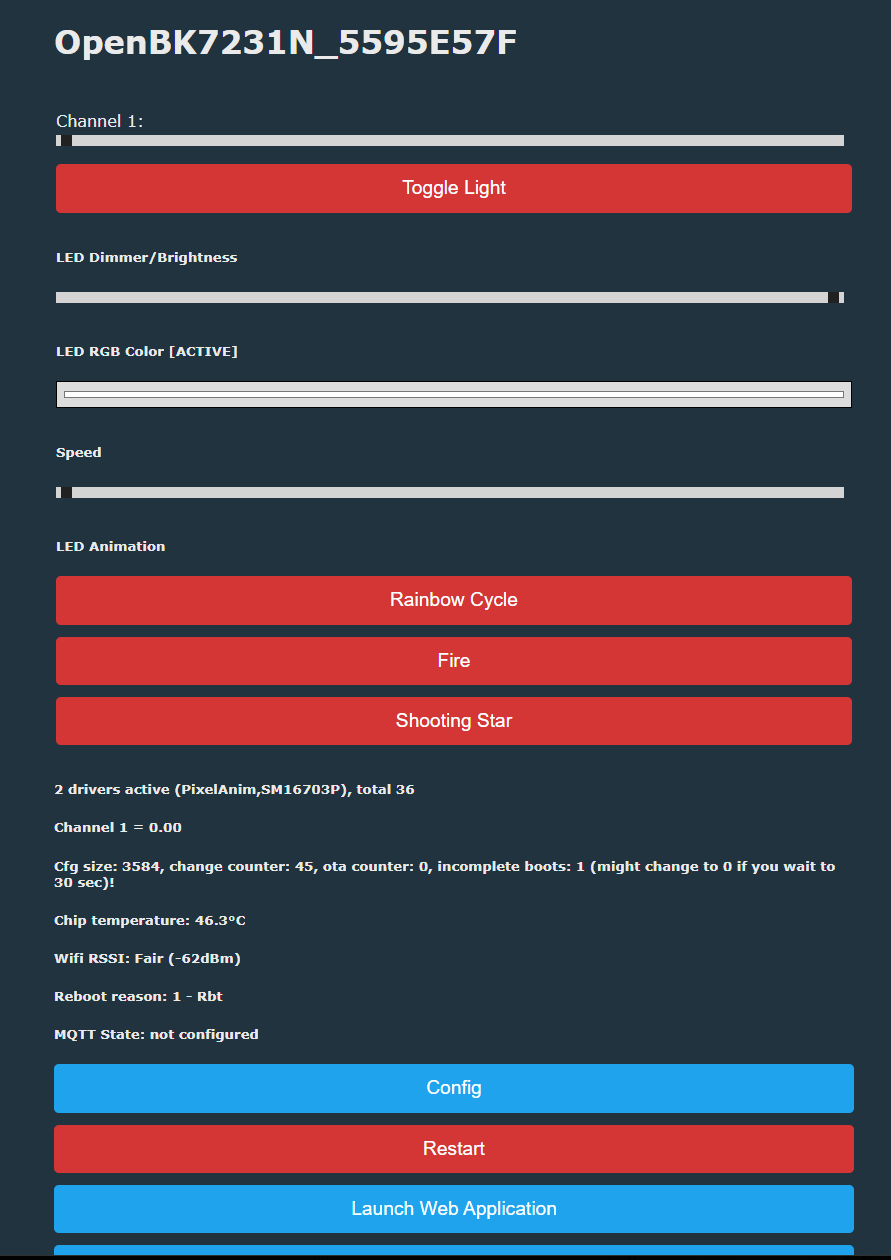

  • #13 20839555
    MnM1
    Posts: 175
    Rate: 13

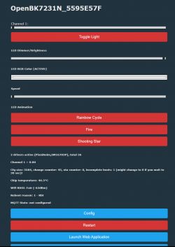

    GPIO Doctor shows that PIN6 = PWM.
    It controls the white color.
    Screenshot of OpenBK7231N interface with configuration and restart buttons and device status information.
    Toggle and brightness work fine.
  • #14 20839562
    Posts: 14755
    Rate: 12880

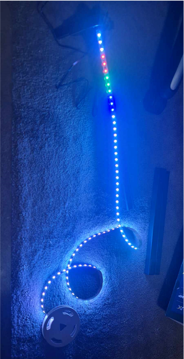

    Ok, now try:
    1. Start driver
    startDriver SM16703P
    2. Init Driver - replace 64 with number of LEds
    SM16703P_Init 64
    3. Set Pixel
    SM16703P_SetPixel 1 255 0 0
    SM16703P_SetPixel 2 0 255 0
    SM16703P_SetPixel 3 0 0 255
    4. Start Output (each call will trigger one)
    SM16703P_Start
  • #15 20839565
    MnM1
    Posts: 175
    Rate: 13

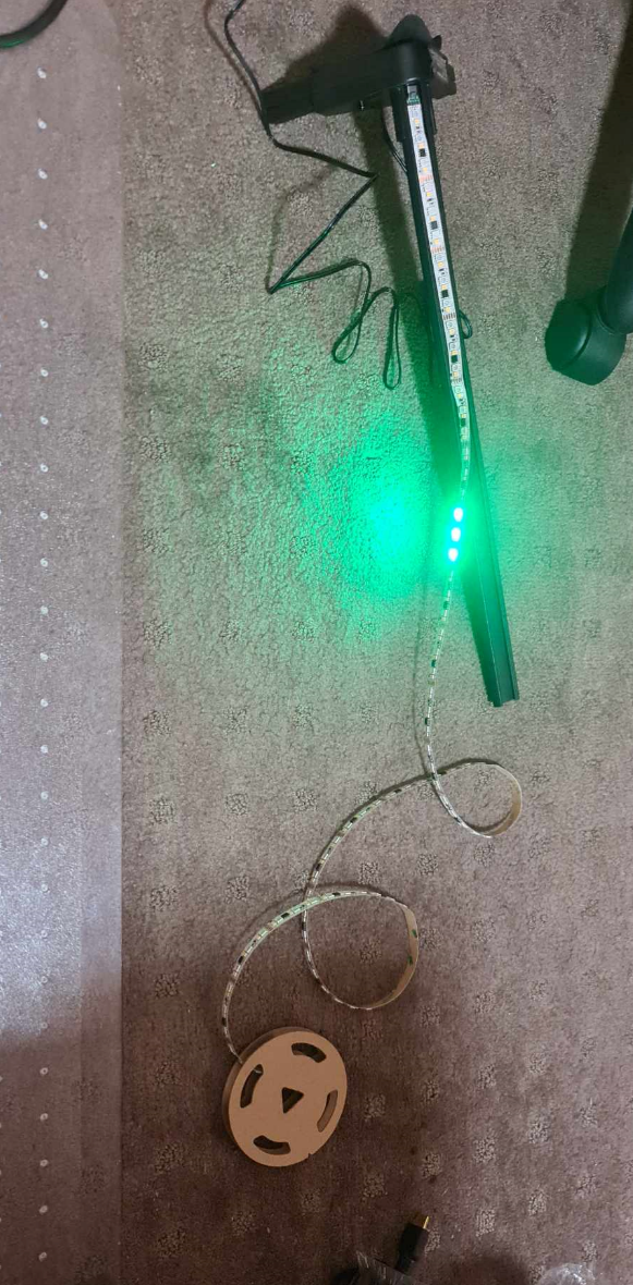

    OK, I get this:
    LED strip on the floor with multicolored lights.
    The first 3 LEDs are cool white.
    The second lot of 3 LEDs are RED.
    The third lot of LEDs are GREEN.
    The fourth lot of LEDs are BLUE.
    The rest of the LEDs are cool white.
  • #16 20839567
    Posts: 14755
    Rate: 12880

    This got the script running.
    However, it is not working as it should.
    - The first 4 sets of 3 LEDs are always white.
    - While 3 colors "travel" through the LEDs (not always the same 3 colors, they do change during the loops), the whites are changing (sometimes to purple, other times to blue).
    - Not sure if this loop was supposed to be forever, but after completing a few loops, the device got stuck on this:
    LED strip with glowing green LEDs placed on a carpet.
    Added after 11 [minutes]:
    Did a bit more testing.
    After the loop completes the first time, it leaves the first 5 sets of 3 LEDs as white, while the rest of the LEDs are blue.
    Added after 6 [minutes]:
    If I put the exact number of LEDs I have (90), the loop completes once, leaving behind the first 5 sets of 3 LEDs as white, while the rest of the LEDs are blue.
    Then it waits a long while and does a second loop, leaving all the LEDs blue.
    After that, it seems to do nothing at all.
    If I put 87 as the number of LEDs, the loop seems to be going a few more times, but then it seems to be crashing on green, as mentioned before. Also, it does strange things like it seems to loop on the 7th set of 3 LEDs only, before crashing on green.
    Also, the "travelling" LEDs - the RED seems to be purple, not red. Green and blue are OK.

  • PixelAnim fire animation misbehaves on BK7231N lamp
    #25 21286785
    MnM1
    Posts: 175
    Rate: 13
    Hi @p.kaczmarek2
    I stared testing this corner lamp with Pixel Animation.
    I am on the latest firmware - 1.17.764 for BK7231N
    My startup.bat is:
    SM16703P_Init 90
    startDriver PixelAnim
    The web page loads and it looks like:
    Control interface for LED lamp with animation features on OpenBK7231N.
    However the animation is not quiet OK for me. This is how the fire animation behaves:
    Not sure about the whites on this item - if I enable Flag 4 and I move the Color Temp slider all leds go off.
    The video above was done without any Flags enabled.
    Can you please see if you can workout what the issue can be?
    Many thanks.
  • #26 21307717
    MnM1
    Posts: 175
    Rate: 13
    Hi @p.kaczmarek2 - did you manage to look at the video I posted? If there is a fix please let me know so I can try it.
  • #27 21307849
    Posts: 14755
    Rate: 12880
    Hello, does setting red, blue and green colors through the web interface works correctly? What happens if you try to set colors via commands, let's say, first turn off the LEDs, then set first color to red, second to green, third to blue?
  • #28 21308133
    MnM1
    Posts: 175
    Rate: 13
    I have tried from the web interface - the colors seem to be changing OK.
    However, when I have tried from GUI:
    SM16703P_SetPixel all 0 0 255
    or
    SM16703P_SetPixel all 0 255 0
    or
    SM16703P_SetPixel all 255 0 0
    nothing happens.
