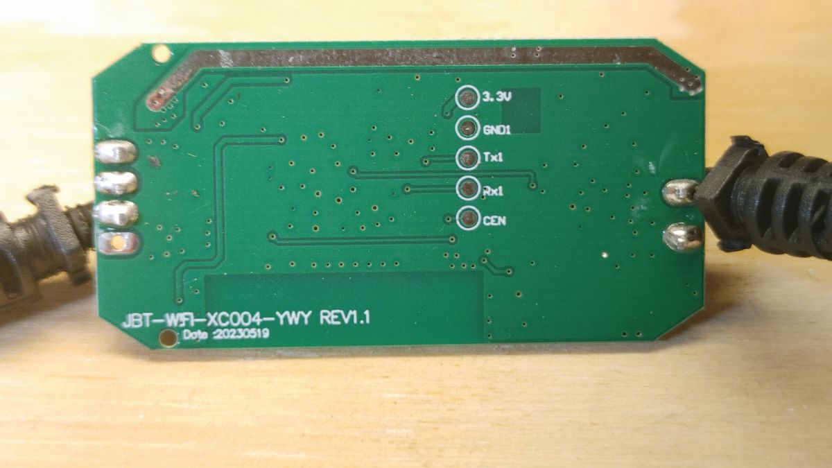

  • Hi all! I just got two of these outdoor addressable LED Spotlights (RGBW+IC) that use a CBU. Disassembly was a bit destructive and cracked the case that held the circuit board, but it'll still be usable when it's done.
    Photo of a circuit board with a CBU module and electronic components.
    Circuit board of JBT-WF1-XC004-YWY module with pin labels
    Close-up of a circuit board with markings and LED lights.
    Close-up of a circuit board with electronic components.
    I was successfully able to backup the factory firmware (attached) and install OpenBeken using BK Flasher, but haven't been able to make much progress since then. I can't seem to figure out how the GIPOs control the lights. I used the GPIO doctor on all the pins, but none will cause the lights to light up in any way (they did work before I flashed OpenBeken). I've only been able to identify that P24 is the button by using the "Set Input P-up," and pressing the button to see the change. Other than that, I am hitting a wall.

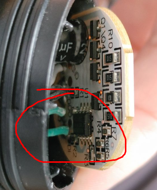

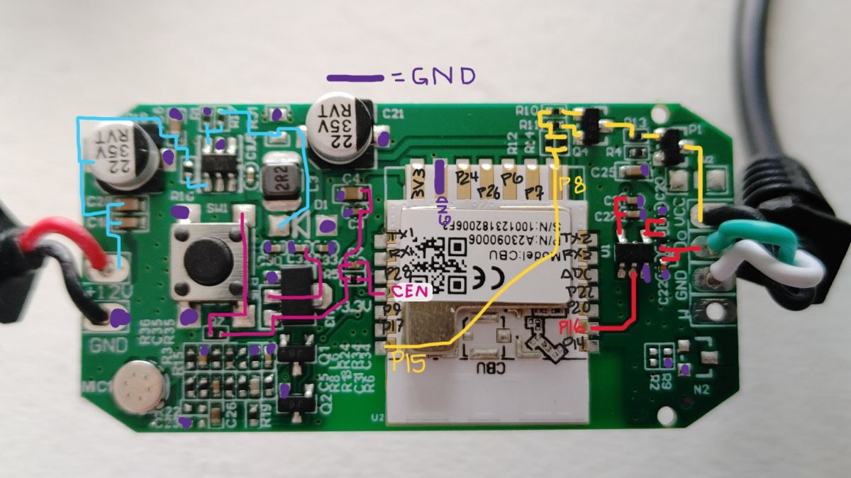

    I did find out from the backup that BK Flasher identified the use of SPI, MOSI, and MISO. You'll have to forgive me, as that is getting beyond my level of knowledge and it's a bit of a foreign language. I did my best to trace out the pins on the board and what components they are connected to. Here's what I found:
    Circuit board with CBU module and labeled pins and pathways.
    I've spent the past three days reading and learning; these threads seem similar to my device:
    [BK7231N/CBU] Casa Life ALDI Aus - Floor Lamp Mood Lamp - RGB control, SPI? MOSI? MISO?
    Deciphering Pin Configuration & JSON Readout for Marlrin RGBCW Corner Floor Lamp (MOSI/MISO)
    [BK7231N - CBU] Teardown of Aldi (Australia) CasaLux Smart Led Corner Lamp
    If there's any recommendations or literature that informs how to make this work, please let me know. I've been searching, but haven't found the solution yet.

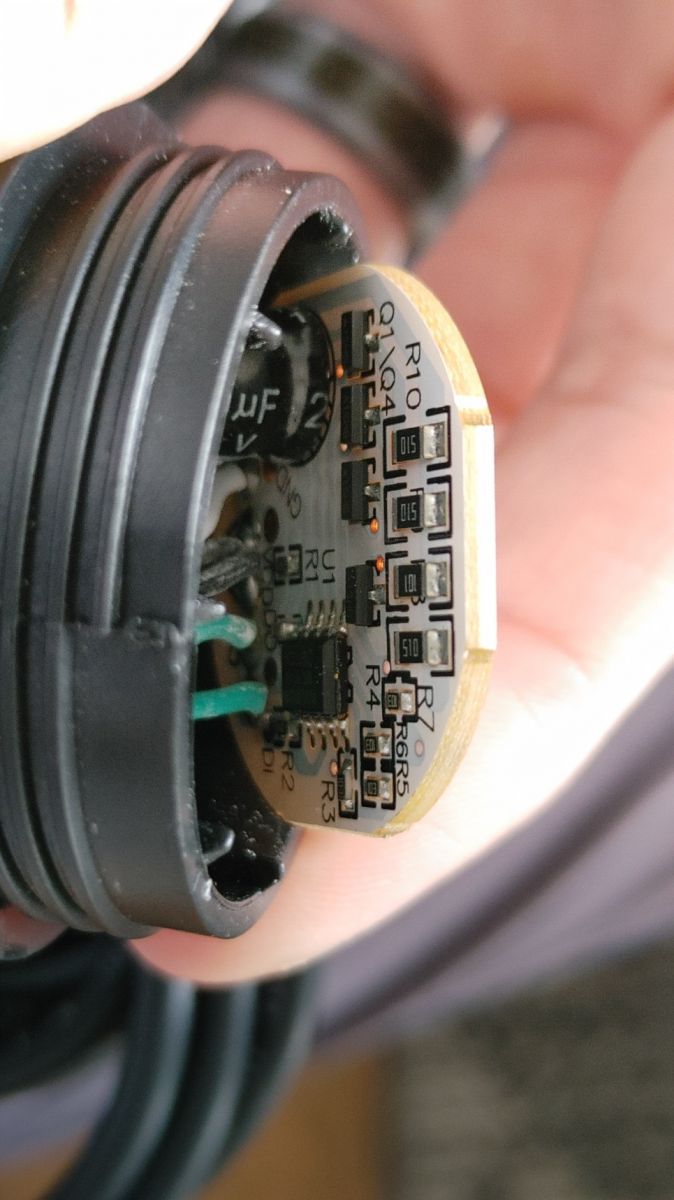

    What is the marking here:
    Close-up of a circuit board fragment with visible electronic components and traces. A marked area with the DO (Data Out) label.
  • SPI driver worked once, then stopped after reboot
    #3 20912759
    pborrelli
    Posts: 10

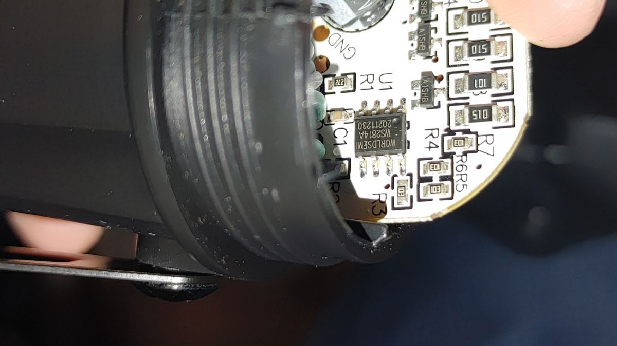

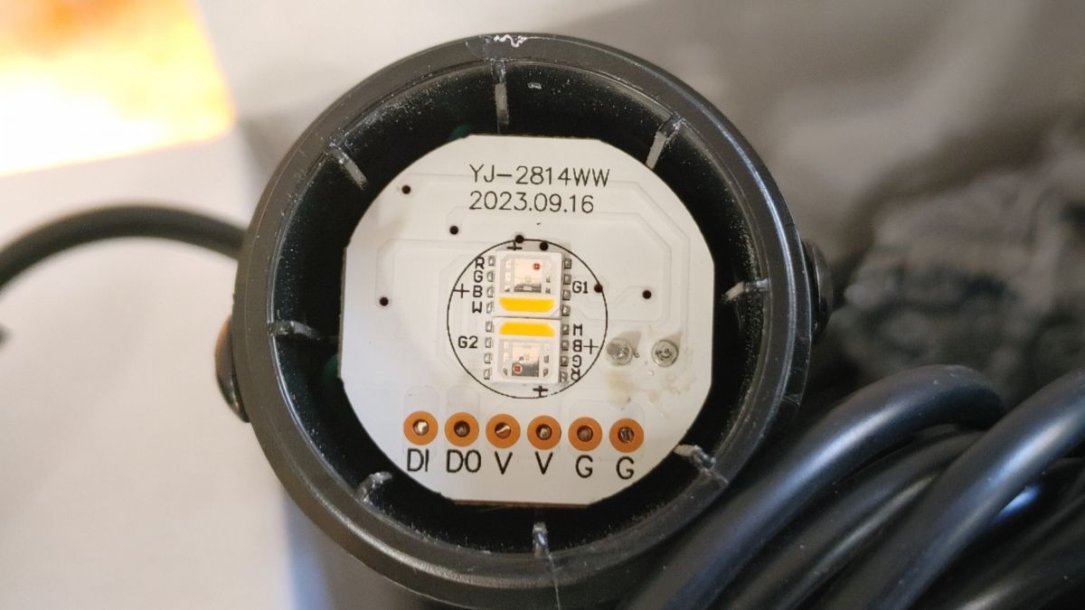

    You Sir are a genius and a saint! I ran the SPI Driver commands and got light! Two of the four lit up, one blue and the other white. I then powered it down to get a picture of the chip on the LED board:
    Close-up of WS2814A chip on a PCB board.
    It appears to be WS2814A LEDs ... ? Again, I'm out of my league here.
    Problem now is I can't get it to light up again after powering down and back up. I set everything back the way it was, but rerunning the SPI Driver commands is doing nothing now. What am I missing?
    I've set the GPIOs P8, P15, and P16 to be PWMs or Relays, but nothing appears to be working. What are the recommended GPIO settings for the SPI Driver? I'm going to keep tweaking with it, but it's got me scratching my head at the moment.
    Thank you again @p.kaczmarek2 I don't know how you keep on top of all the posts in this forum, as well as the modifications to the firmware!
  • Try SM16703P driver commands on P16
    #4 20912797
    Posts: 14755
    Rate: 12881

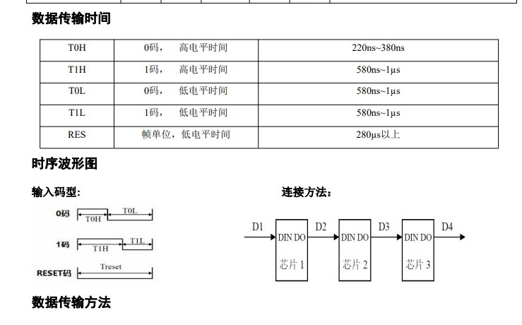

    WS2814A ... well, to be honest, it's the first time ever I see this chip, but it bears a significant resemblance to WS2812 LEDs.
    Let's check the datasheet:
    Timing diagram and connection layout of WS2814A circuit.
    Timings are similiar... but frame is 32 bit, and not 24 bit like WS2812B.
    This would require some adjustements to our driver, but still, our driver should theoretically at least be able to lit some random colors on that....
    Futher testing might be needed, but it would require hooking an oscilloscope to the DO pin.
    Alternatively, can you try:
    SM16703P_Init 4
    SM16703P_SetPixel 0 255 255 255
    SM16703P_SetPixel 1 255 255 255
    SM16703P_SetPixel 2 255 255 255
    SM16703P_SetPixel 3 255 255 255
    don't forget to start the driver as well.
    Do not set any GPIO role for P16, just start driver, and run the commands I gave.
  • P8 and P15 control the spotlight relays

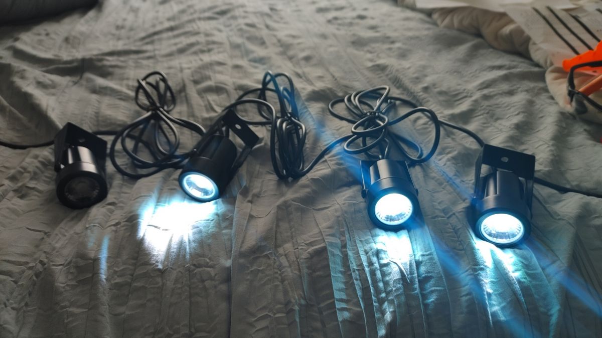

    I cleared the assignment on P16 and did some poking and prodding and am finally getting somewhere. P8 & P15 are set to relays, and I have to toggle either or both on to get light output.
    The first three of the four spotlights turn on with a blue light (They go 1 to 4 from RIGHT to LEFT).
    Four LED spotlights with cables on a bed, three of which emit blue light.
    I plan to do more testing by changing the parameters, but work is starting to get in the way of play!

    Light output is ... interesting. Sometimes when entering the Start command, I may only get two of the lights, and one was warm white one time. If I mess with the toggle buttons on the main console, the lights will sometimes turn off without turning back on. Also, if I enter the commands and try to start the lights before toggling on the relays, it won't work.
    It's exciting to get somewhere with these. I'm happy to do more testing and tuning, is there a writeup on the SPI Driver?(nevermind, I found them). I'll go do some things and report back the findings, not sure how much I can do because of the 32 bit frame, but I'm going to play anyway.
  • Unpredictable RGBW mapping due to 24 vs 32 bit packing

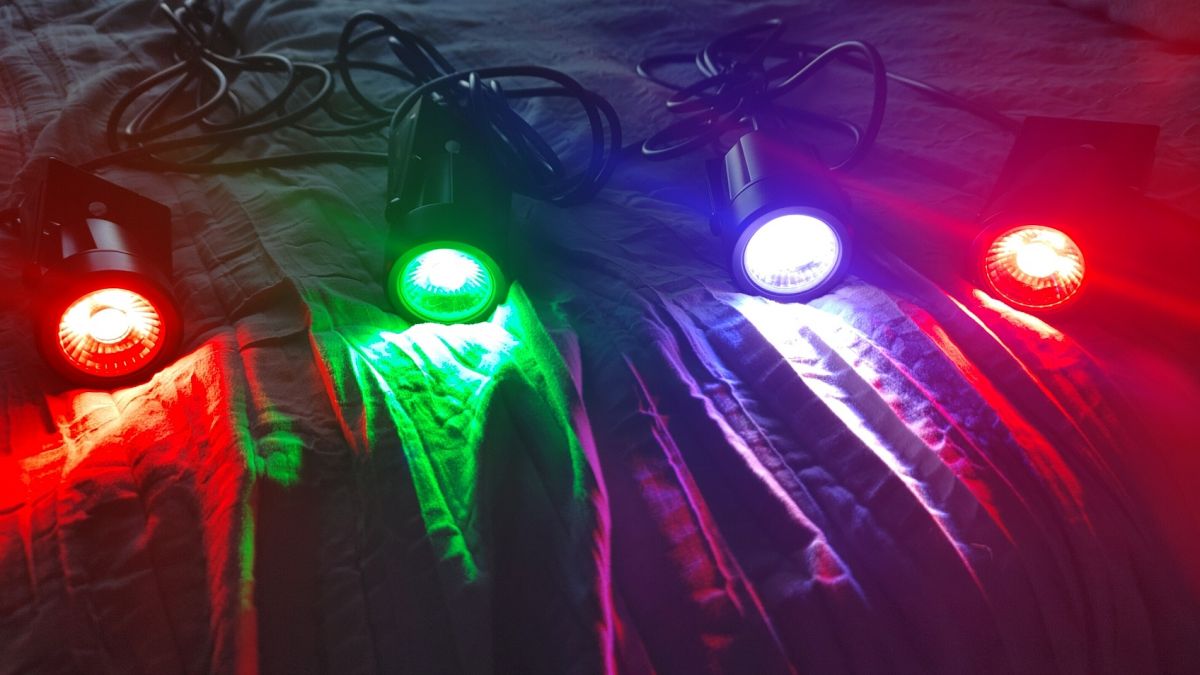

    I've been doing some testing and tuning, but not much to report. I can get all four lights to light up by playing with various settings on the number of pixels and the color assignment going to each one, but there's no pattern or predictability to them. This is of course due to the 24 vs 32 bit data packaging.
    I wish I knew how to write C, I'd be happy to make adjustments. That's well above my pay grade.
    In the meantime, I'm happy to do more testing, and when this is up and running properly I'll do a full teardown write-up.
    Four spotlights emitting different colors: red, green, blue, and white, placed on a dark background.

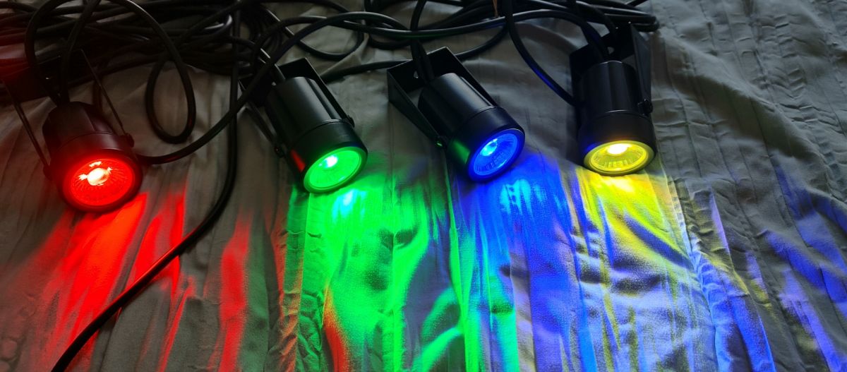

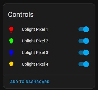

    So it's been most of a year now, these sat for about seven months, but I finally picked them up again.
    I found a workaround that provides correct color and individual control of each LED; though it's with ESPHome and not OpenBeken. It turns out the WS2814 are known to be a variant of the SK6812 with a white channel. I was able to use the "Beken_SPI_LED_Strip" platform in ESPHome and set the chipset option to "sk6812" and the color option "is_wrgb" to "True." This set the correct color on each led and and allowed individual control. I think having a data packet for the white channel pushed the correct 32bit full data packet and corrected the problem.
    I don't know if there's a way to leverage this in OpenBeken, but it could be a quick workaround for using WS2814 LEDs.
    Control panel with options for four uplight pixels, each with an individual toggle switch.
    Four LED spotlights emitting light in red, green, blue, and yellow colors.

Which GPIO settings are recommended for OpenBeken SPI LED testing on this BK7231N device, especially for P8, P15, and P16?
Leave P16 unassigned, and use P8 and P15 as relay-style power controls. The direct guidance was: "Do not set any GPIO role for P16, just start driver." Later testing showed the LEDs only came alive when P8 and P15 were toggled on first. On this board, P16 behaves like the SPI data path, while P8 and P15 appear to enable power or sections of the LED hardware. [#20912797]
What does the Tuya JSON dump mean for a CBU spotlight, including fields like key1_pin, expowctrl_pin, micpin, MOSI, and MISO?
It is the factory configuration map that exposes how the BK7231N CBU firmware expected the hardware to work. In this dump, key1_pin=24 matched the pushbutton, expowctrl_pin=8 suggested external power control, micpin=23 matched the microphone input, and MOSI=16 plus MISO=17 pointed to an SPI-style peripheral path. The same dump also listed lednum=12, firmware swv=1.0.20, and module CBU. [#20911851]
Why do P8 and P15 need to be toggled like relays before the SPI-driven LEDs start working on this Ligency spotlight?
They appear to gate power to the LED subsystem or related stages. The user reported that setting P8 and P15 as relays and toggling either or both on was necessary before any light output appeared. If SM16703P_Start ran before those relays were enabled, nothing happened. That behavior fits a board where the data pin alone cannot drive LEDs until one or more power-enable lines are active. [#20912961]
How can I tell from the PCB markings and traces whether a smart spotlight uses individually addressable LEDs instead of simple PWM RGBW channels?
Look for a data-chain marking and serial LED topology, not four separate RGBW power channels. In this case, a DO marking on the LED board strongly suggested data-out chaining between LEDs, and that led directly to trying the SM16703P driver. The board then lit partially under pixel commands, confirming individually addressable behavior. A simple PWM RGBW lamp would respond to direct GPIO-to-channel testing instead. [#20911963]
What causes random colors or unpredictable LED behavior when driving WS2814A lights with a 24-bit OpenBeken SPI driver?
The random output comes from frame-length mismatch. The thread identified WS2814A as similar to WS2812 timing-wise, but using a 32-bit frame, while the OpenBeken test path behaved like a 24-bit RGB driver. That mismatch shifted color data and produced cases where only some of the 4 lights responded, sometimes blue, sometimes warm white, and without a stable pattern. The hardware was alive; the payload format was wrong. [#20912797]
Where should I probe with an oscilloscope on a WS2814A LED board to verify the data signal and timing from a BK7231N CBU module?
Probe the DO-labeled data path on the LED board. The thread explicitly suggested hooking an oscilloscope to the DO pin because that point should reveal whether the BK7231N side is sending valid timing into the addressable LED chain. That is the fastest way to separate a GPIO or power-enable problem from a protocol problem. It also helps confirm whether the 32-bit stream is being framed correctly. [#20912797]
How does the 32-bit frame used by WS2814A affect compatibility with OpenBeken’s SM16703P driver?
It makes the current test driver only partially compatible. The OpenBeken SM16703P path could still light "some random colors," but the thread noted that WS2814A needs 32-bit frames, not the 24-bit structure used by WS2812B-style RGB data. That means a driver change is needed for correct RGBW ordering and predictable per-pixel control. Without that change, test output proves activity, not full compatibility. [#20912797]
