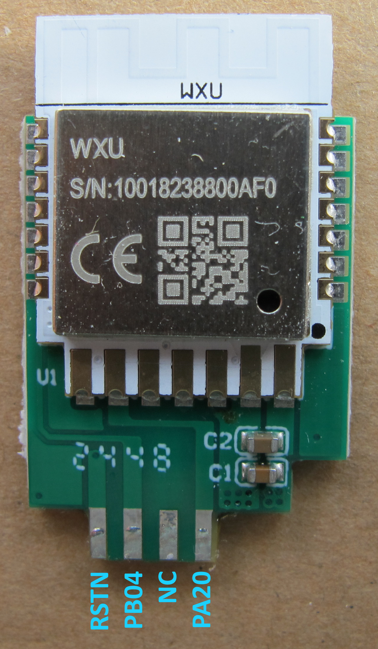

Here I will demonstrate how the internal flash of the Xradiotech/Allwinner XR806 (and XR809 - see note at bottom) can be read to file in Windows. Although there is not yet an OpenXR806 cloud-free alternative firmware to use on devices that have the XR806 at heart, flash firmware backups are useful in development and research and for general backup purposes.
One Tuya module seen in the wild based on XR806 is the WXU (T103C-HL). Also available as WXU-IPEX - datasheets attached.

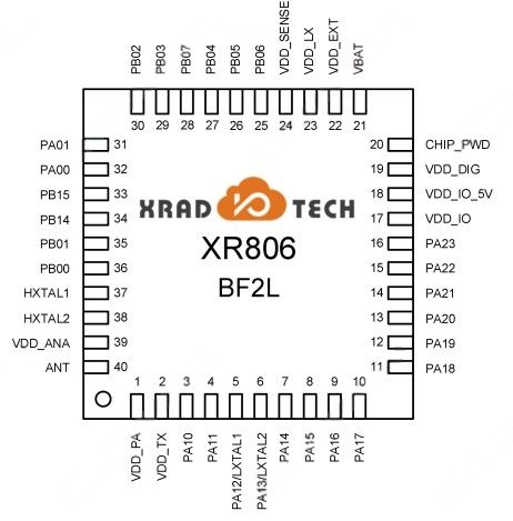

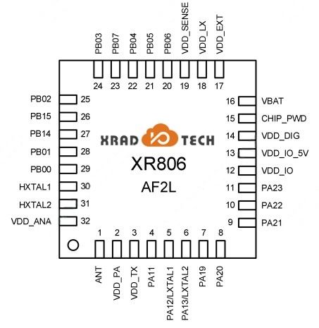

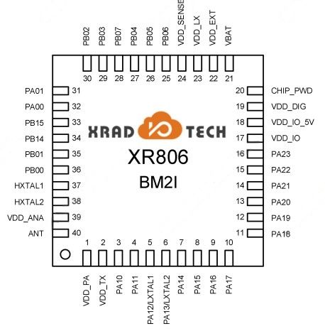

XR806 uses 5mm x 5mm QFN40 package and 4mm x 4mm QFN32 packages for different feature lists.
Pin layout diagram of the XR806 chip by Xradiotech Pin diagram for XR806 BM2I Diagram of XRADIO XR806 chip with pin labels.

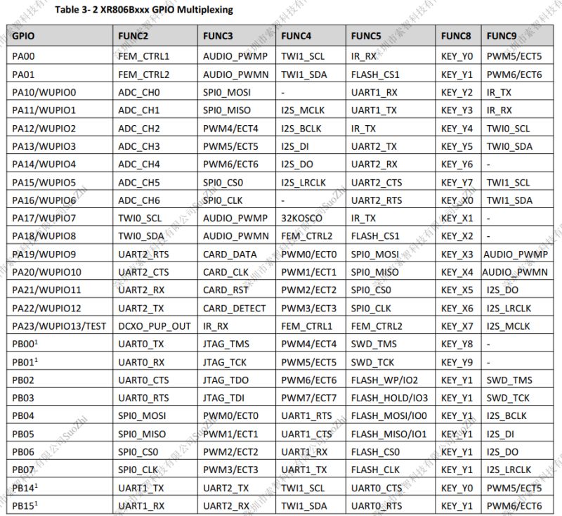

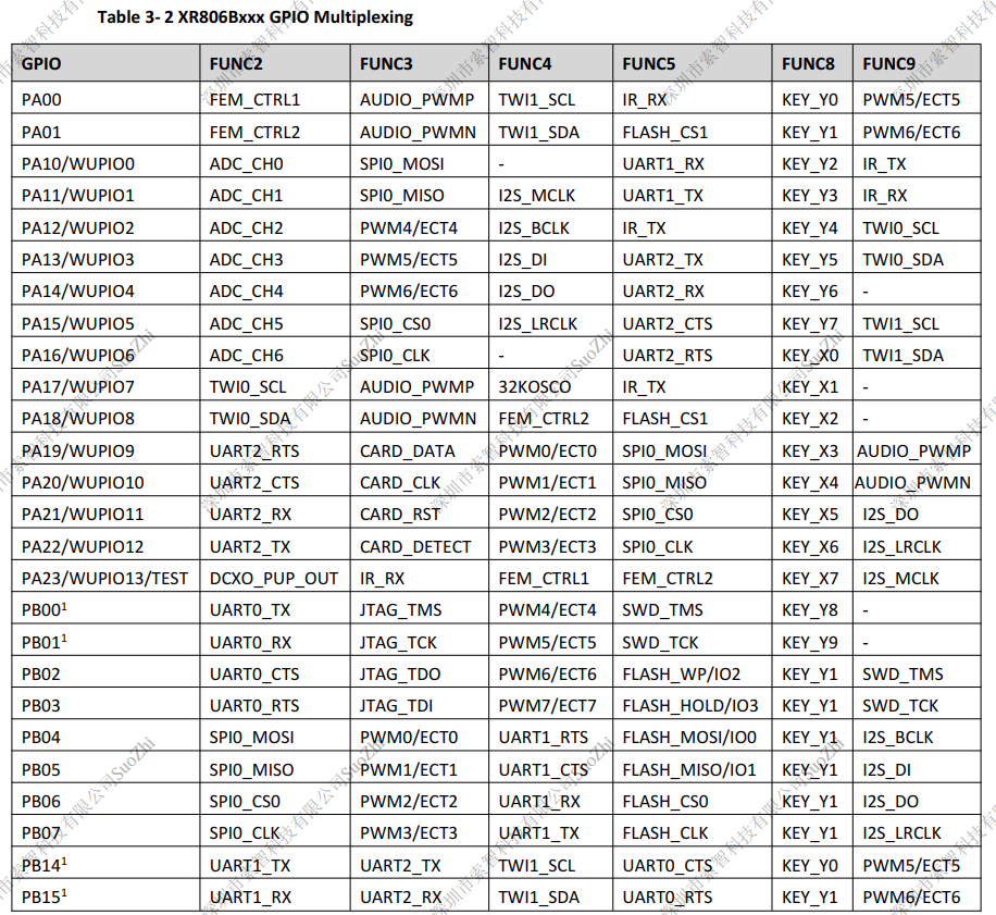

Table showing GPIO multiplexing for XR806Bxxx.

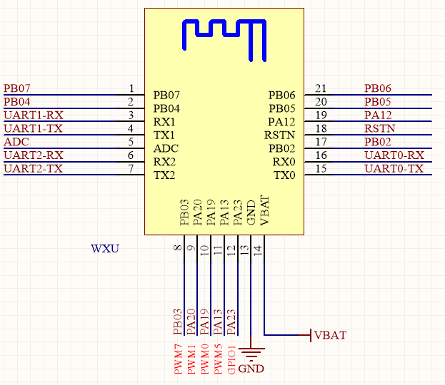

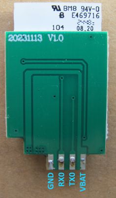

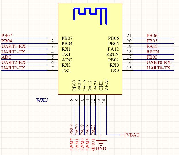

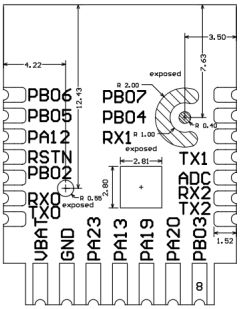

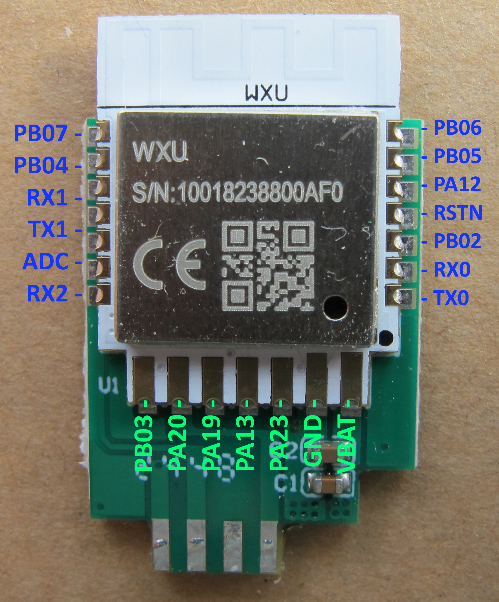

To get into UART download mode PB02 needs to be pulled to ground at power-on.
on the WXU PB02 is the 3rd pad up from the bottom on the right-hand side of the module as you look at the top
Schematic of an integrated circuit with GPIO and UART connections.
or from the bottom:
Diagram of electronic circuit pins with labels.

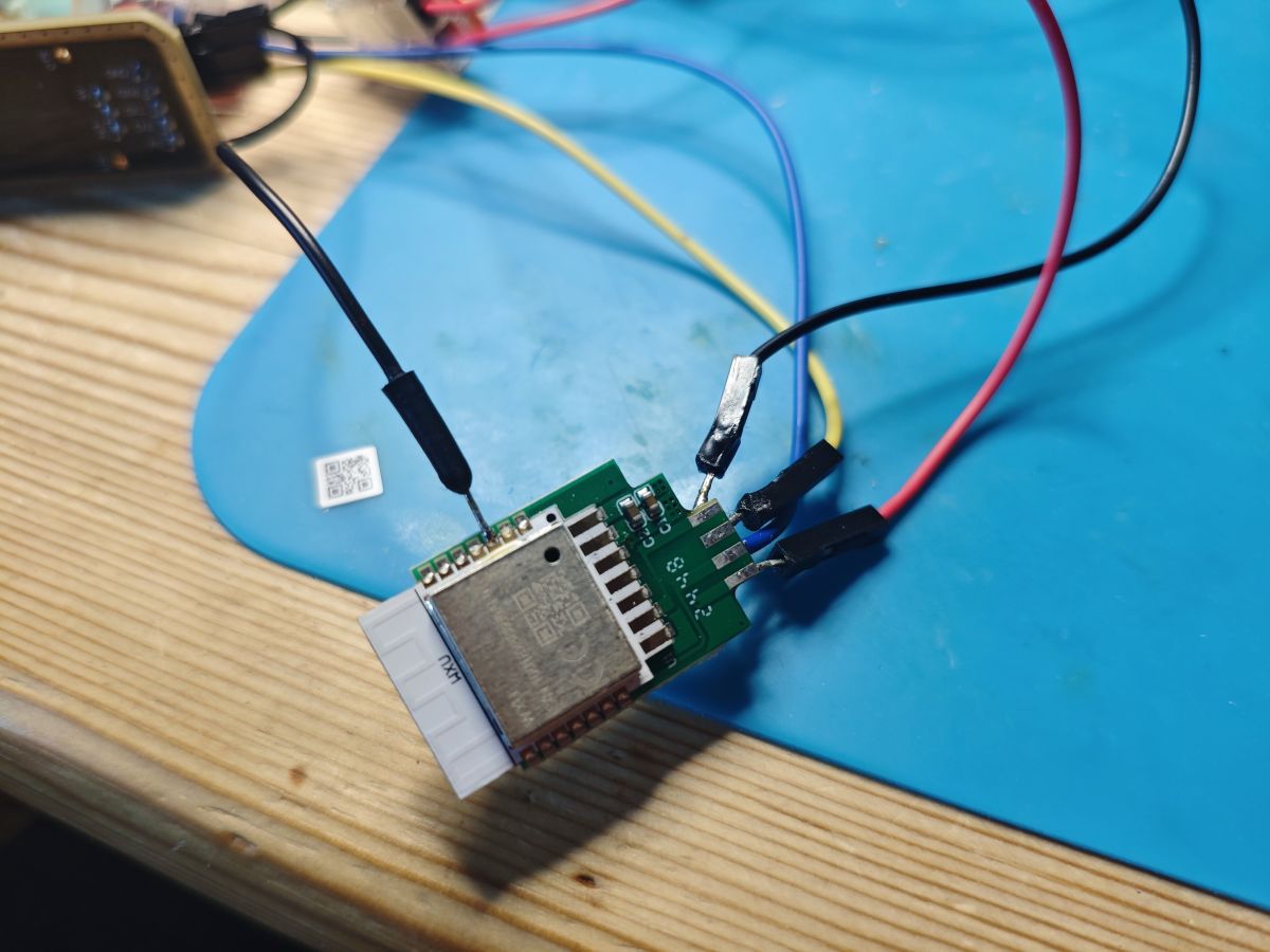

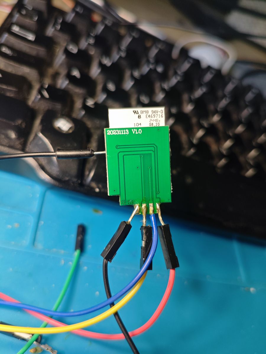

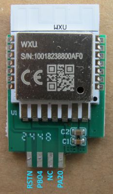

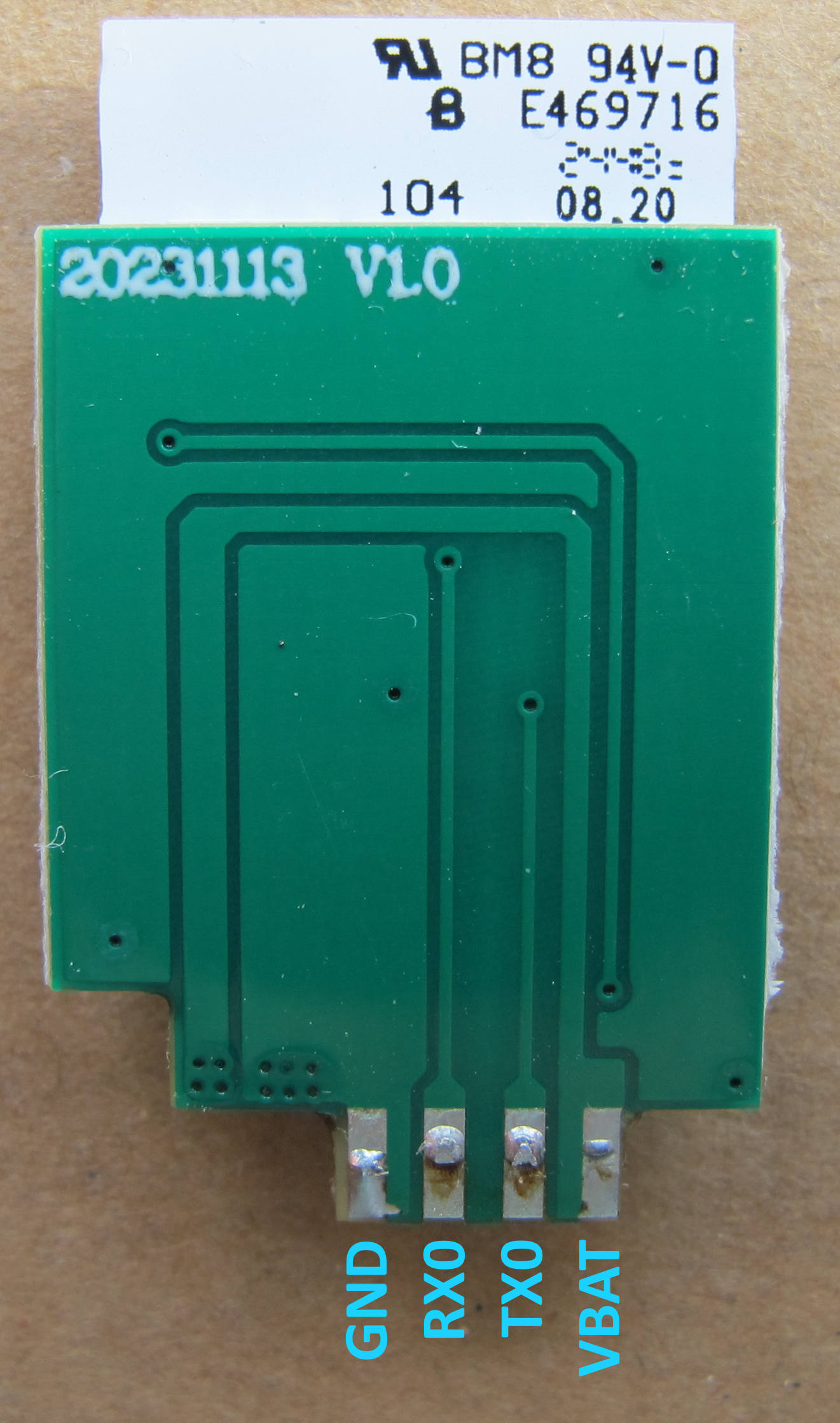

and again from the top with WXU shown mounted on PCB from TRV16, which I will also use to demonstrate flash backup
Soldering can be performed direct to WXU contacts or, in the case of this WXU on PCB from TRV16, I have chosen to solder to the breakout pads instead for all but PB02.
Electronic module with markings and QR code Printed circuit board with labels and connectors.
Electronic module with wires on a blue mat. Green PCB with attached colored wires against a keyboard background.
USB-TTL RX -> XR806 TX
USB-TTL TX -> XR806 RX
3.3V -> XR806 VBAT
USB-TTL GND -> PSU GND -> XR806 GND

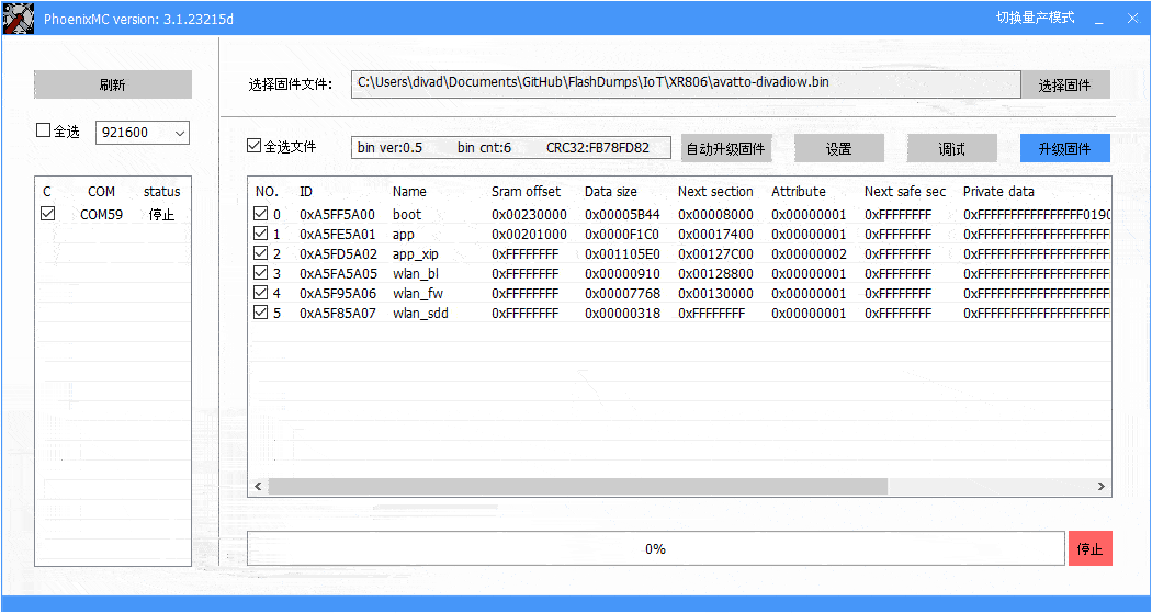

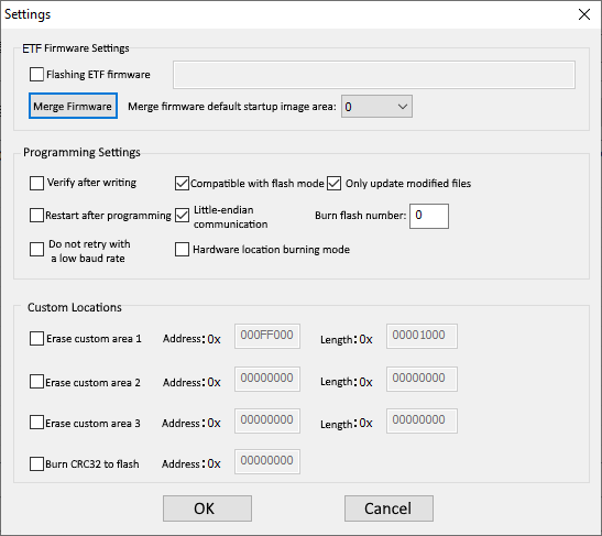

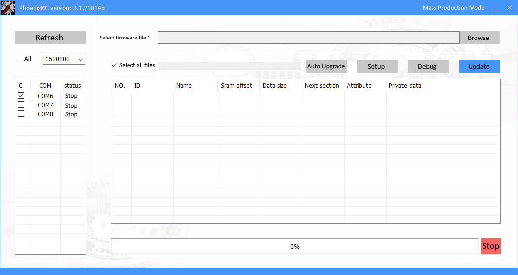

Flash writing and reading is performed in the PhoenixMC program, available from https://github.com/openshwprojects/FlashTools/tree/main/XRadioTech-AllWinner
Main text areas are in Chinese, so here are some translations to aid navigation
PhoenixMC software interface for firmware updates.
Graphical user interface for a flash memory operation application. Screenshot of software settings window for firmware programming.

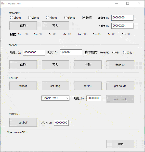

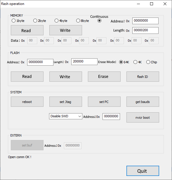

Connect XR806 as above and power on. Set appropriate baud on the main page (this may need to be lower if your wires are too long or you're using pogo pins), open the Debug menu. It should communicate with the XR806 and unlock the text fields. Change the length box text to 200000 and click Read.
Animated read image
Flash operation application window with various options and settings.

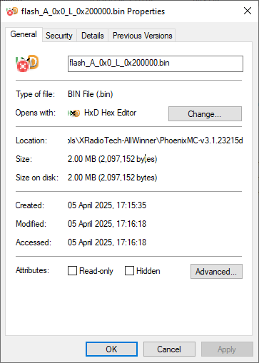

Flash backup will be saved to file called flash_A_0x0_L_0x200000.bin in the PhoenixMC root folder
Properties window of the binary file flash_A_0x0_L_0x200000.bin in Windows.
In this mode you can also read the flash ID. eg:
Dialog window with a warning from the phoenixMC program, showing BROM version and flash ID.
which looks to be Winbond W25Q16JV or W25Q16DV in my case.
