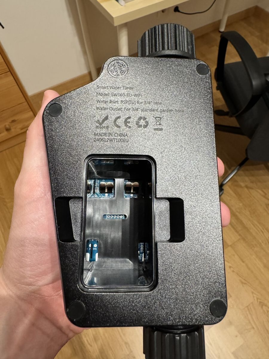

    Hi,

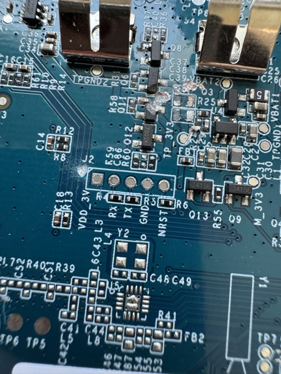

    I have bought an Avatto SWT60 Smart Watering Timer Irrigation timer.
    I paired it to the SmartLife app, and extracted the local key from my Tuya cloud project. However, the device constantly restarts with a hardware watchdog reset reason, and it is only controllable via wifi for mere seconds before each restart (so 2-3 seconds in every 2-3 minutes). The manufacturer didn't look into the issue, they simply refunded me instead of fixing the problem. I'd like to make use of the device, hence I'm considering using OpenBeken.
    Has anyone ever encountered this device? Is it using a dedicated microcontroller + a tuya board, or using the tuya board as the brain?
    Attached is a picture of the available test pads.
    Avatto SWT60 smart irrigation timer held in hand. Image of the interior of the Avatto SWT60 smart irrigation timer with visible test pads.
    I'd like to contribute to the development of OpenBeken by dumping the firmware, and maybe trying to analyze whatever's in the firmware. I have a logic analyzer, oscilloscope, multimeter, so all the tools needed to get information that is required to analyze this product.

  • 5-pin port pinout and watchdog reset diagnosis
    #3 21147996
    Cramp1017
    Level 4  
    Posts: 10
    >>21147957
    Okay, so I poked around with my multimeter (will poke around with an oscilloscope & logic analyzer tomorrow), the 5 pin port looked very interesting.
    Pin1: 3V3
    Pin2, 3: Pulled low
    Pin4: GND
    Pin5: Pulled high
    How could I identify with a logic analyzer which port is TX? I guess I should get some output at boot, correct?

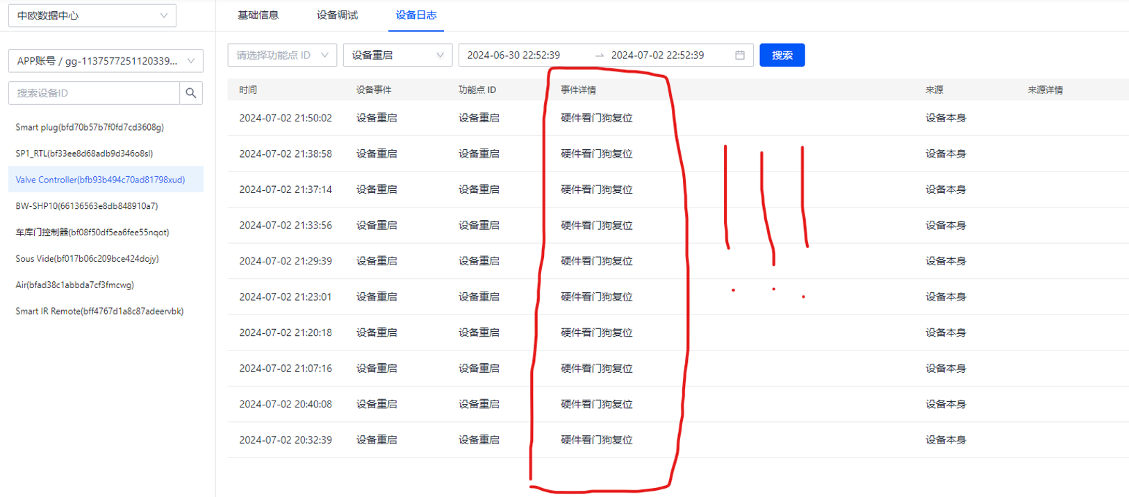

    With regards to the watchdog, see the following (unfortunately Mandarin since I made the screenshot for the manufacturer) screenshot:
    Screenshot of device log with hardware watchdog reset errors in Mandarin.
    The error reason is 'hardware watchdog reset' and it happens in jittery, but periodical manner.

    what does the inside look like? please post pictures.
  • Allwinner XR806 identified, UART pads inaccessible
    #5 21148498
    Cramp1017
    Level 4  
    Posts: 10
    >>21148045

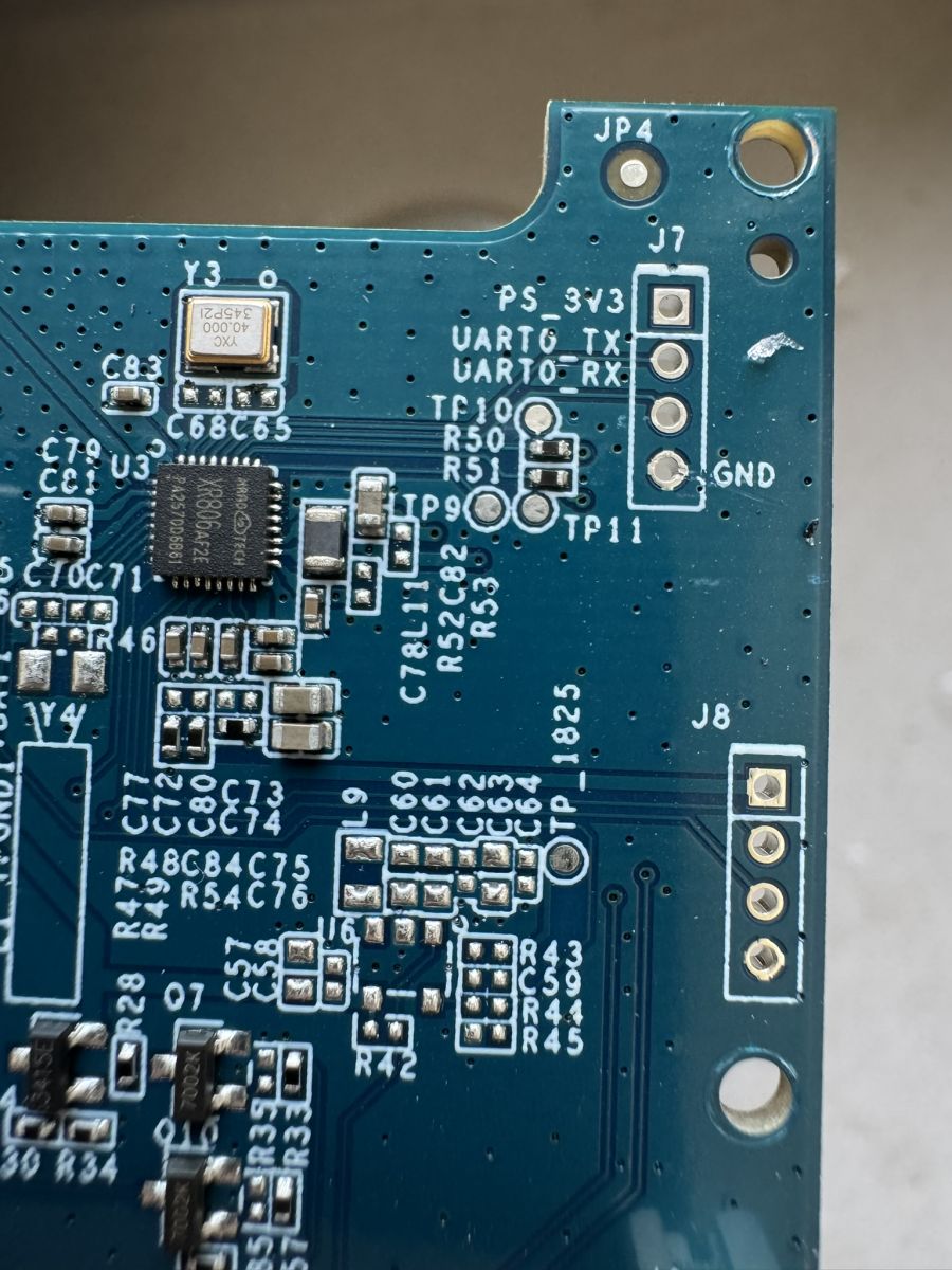

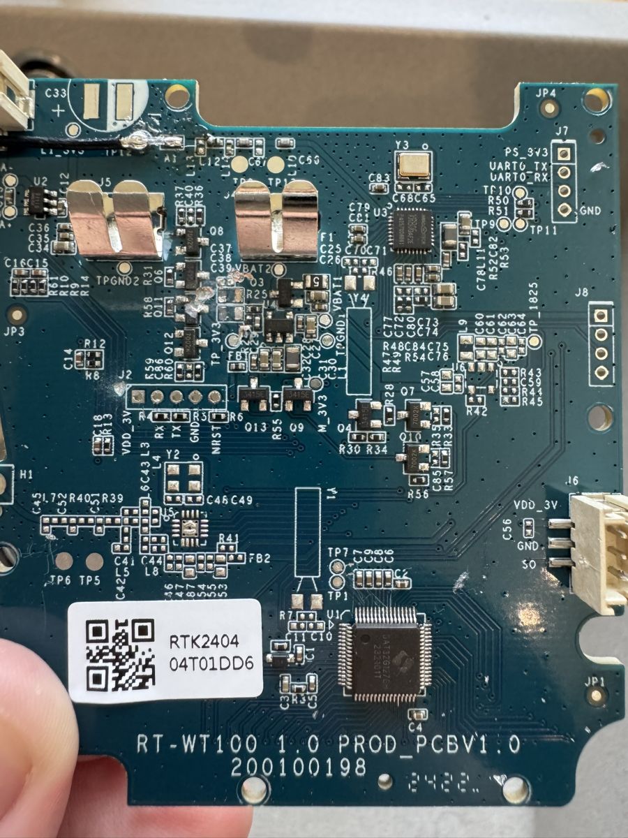

    I tried taking it apart, unfortunately the internal screws are covered with silicone and they are not accessible, only by destroying the water seal.
    Added after 39 [minutes]:
    >>21148498
    Given I got refunded for it and I had no use for it without wifi, in the name of science I sacrificed the poor thing. (Ignore the mosfet that got destroyed in the process :D)

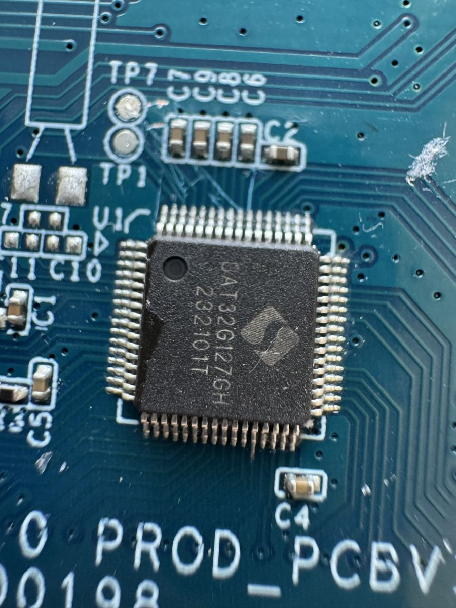

    Close-up of a circuit board with an Allwinner XR806 chip. Close-up of a motherboard with visible electronic components and UART test points. Close-up of a circuit board with visible components and markings. Close-up of a printed circuit board showing test points UART2_RX, UART2_TX, and GND, with a PS_3V3 marking. Motherboard with various electronic components, including an Allwinner XR806 SoC chip.
    It has an Allwinner XR806 SoC, and the most of the UART test points are not accessible without breaking the device.

    ooh! an XR806. I've been angling to get to one to try the XR809 build on, though the XR806 does have a different SDK I think.
    Interesting.
    That BAT32G127 MCU is also seen in this https://www.elektroda.com/rtvforum/topic4064181.html
    One or more of those RX/TX pads must be good for boot log capture and then maybe firmware dump? Assuming you can get it into uart download mode.
    Added after 38 [minutes]:
    looks like only PB02 needs to be pulled low to get XR806 into download mode, as opposed to PB02 and PB03 on XR809

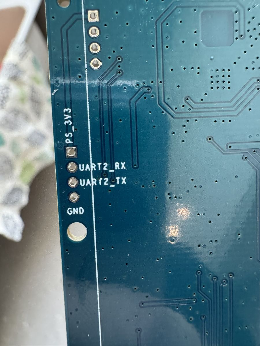

    Okay, I can get boot logs on UART2, can reset the tuya chip by pulling NRST low. But I just cannot get it to go to download mode (https://www.elektroda.com/rtvforum/topic4063735.html - phoenixMC_v3.1.21014b.exe), there's nothing on UART0/1/2 when I pull PB02 low.
  • #12 21148718
    Cramp1017
    Level 4  
    Posts: 10
    See the bootlog attached.

    I managed to get the board into bootloader mode and connect with the older PhoenixMC. I can dump the memory perfectly, but unfortunately the flash dump is all zeros :(

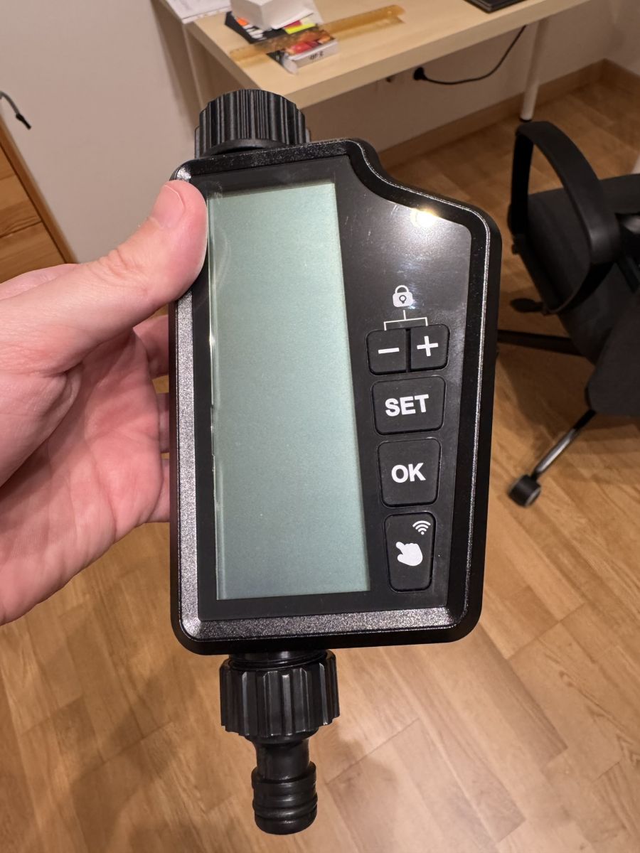

    It's not totally dead, just the screen broke (and of course the water sealing) while I forced it apart. It was fully potted with silicone.
