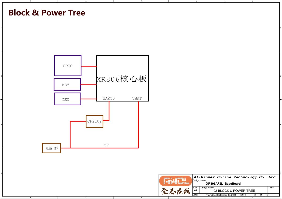

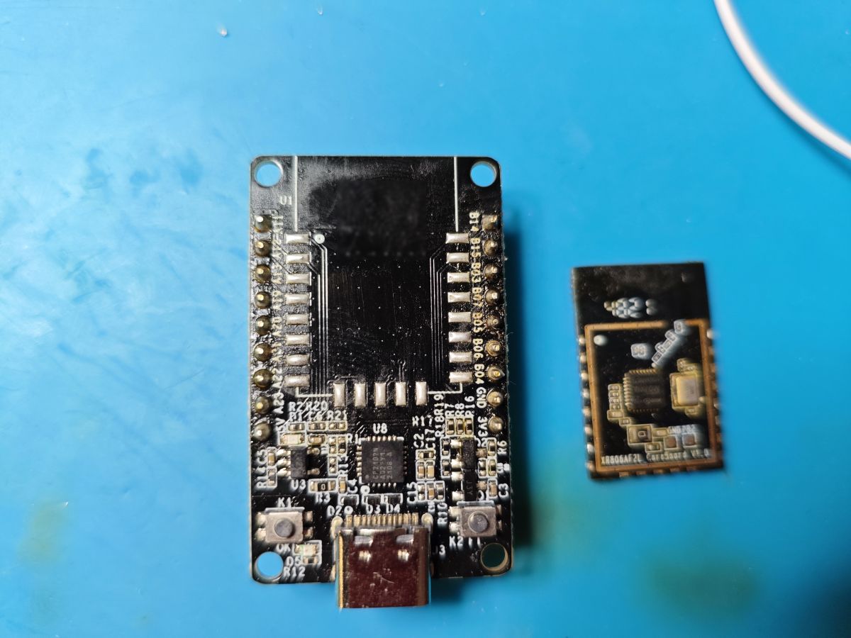

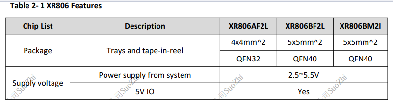

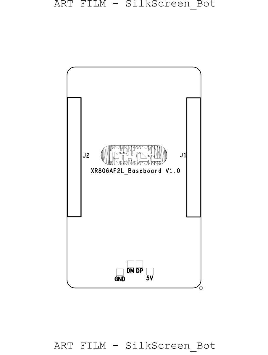

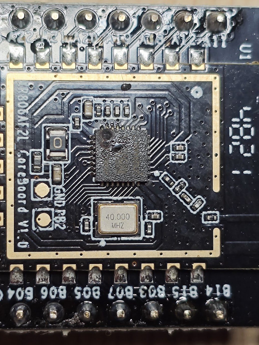

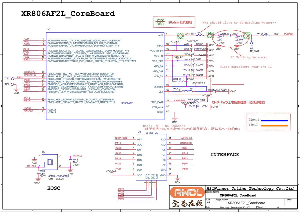

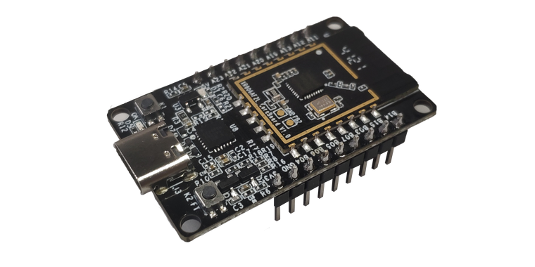

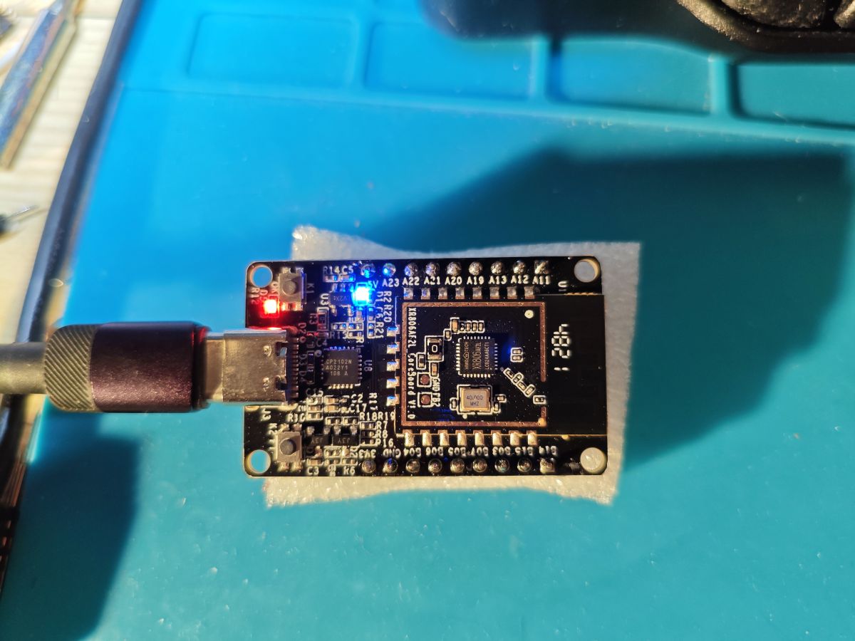

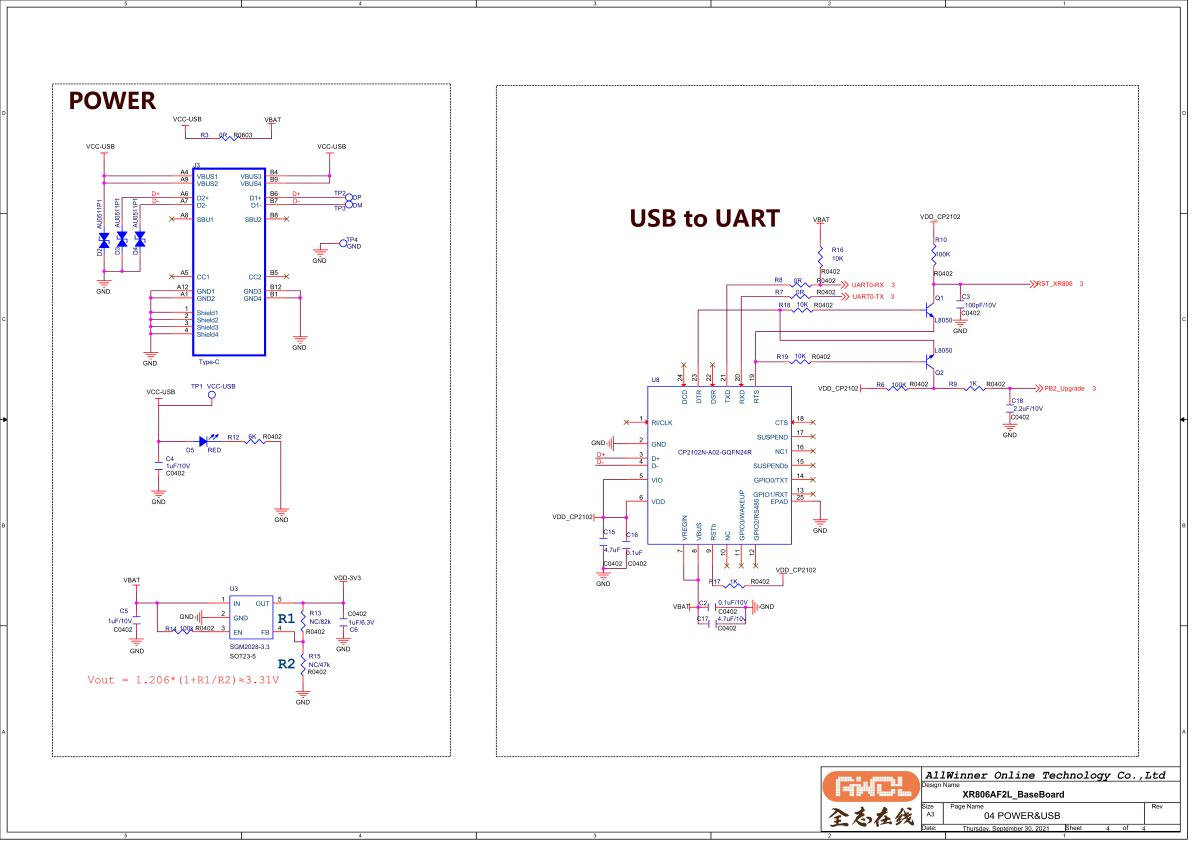

Why did one AllWinner/XRadioTech XR806AF2L_Baseboard V1.0 board let out magic smoke after about 10 minutes on normal 5V USB-C power, and what parts should be checked first?
The exact cause was not proven, but the failed board ran for about 10 minutes and then the XR806 chip itself was reported as the burnt part. Check the USB-C area first, then trace 5V into the module supply path and inspect the LDO, USB-UART section, and any solder debris. The thread also raised a concrete fault path: a short between 5V and D+ or D-. That makes connector wiring and bridge soldering the fastest first inspection points. [#21466570]
How can I identify whether an XR806 dev board failure was caused by the XR806 chip itself, the USB-to-UART converter, the LDO, or a USB-C wiring fault?
Start by isolating which section still works. 1. Check whether the USB-UART still enumerates and produces serial traffic. 2. Measure whether the LDO outputs the expected rail while USB-C is at 5V. 3. Inspect whether the XR806 package shows visible damage or heats immediately. In this case, the board owner stated plainly, “XR806 chip,” after the failure, which ruled out a simple USB-UART-only fault. If serial and regulation survive but the SoC does not boot, the XR806 is the prime suspect. [#21466370]

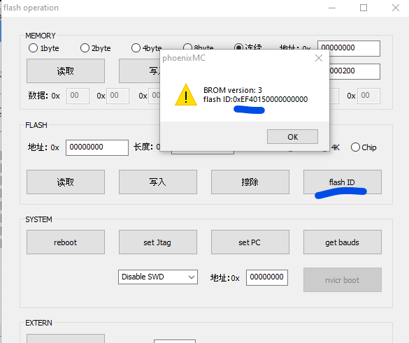

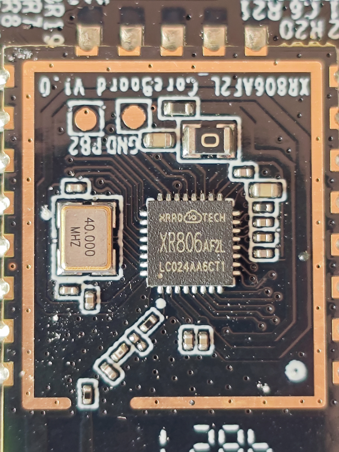

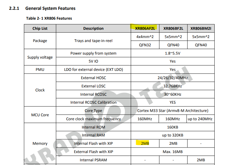

What flash chip is fitted on the XR806AF2L baseboard, and how do I verify whether it uses a Winbond W25Q16JV or another SPI NOR part?
The photographed board was linked to a Winbond W25Q16JV-class device, described as a 16Mbit SPI/Quad flash. Verify it by reading the package top-mark, comparing it with the Winbond part page, and checking whether your dump size and flash tool settings match a 2 MB device. The boot log itself showed mJedec 0x0, so visual chip ID and successful full-chip erase or dump are more reliable than that early console line on this board. [#21466260]

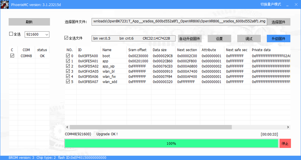

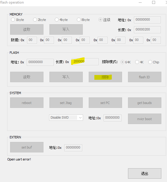

How do I dump and reflash firmware on the XR806AF2L baseboard using the available AWOL_XR806AF2L_BaseboardV1.0_Dev_Board.bin image and UART tools?
Use UART flashing and a full erase before writing the image. 1. Dump the original flash first; the owner got two dumps before the first board failed. 2. Use the shared AWOL_XR806AF2L_BaseboardV1.0_Dev_Board.bin from the linked dump repository. 3. Full-erase the chip, then flash the image and confirm boot over serial. Later testing also showed “2mb” full erase was the normal recovery path during XR806 experiments, so matching flash size matters. [#21466260]

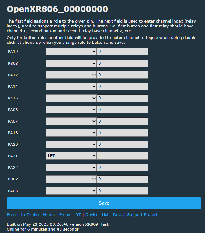

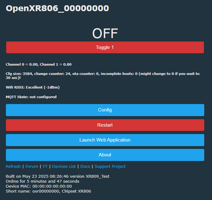

Which OpenBeken build first booted successfully on XR806, and what changed compared with the earlier failing test images?
The first clearly successful XR806 build in the thread was OpenXR806__xradios_21ccaf291737.img. It booted on June 25, 2025, reported XR806 SDK v1.2.2, driver XR_V02.06.10, and heap size 185260. Earlier images either produced bin too big errors or no serial output at all. The effective changes were the XR806 memory fix, newer SDK path, and later build adjustments around partitions and XIP-related image layout. [#21588899]

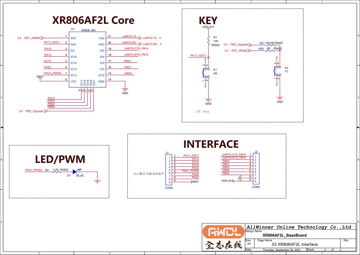

How can I use Tuya MDA and PB14/PB15 on XR806 to test the TuyaMCU driver and query dpIDs from a fake PID JSON document?
Connect Tuya MDA at 9600 baud to XR806 pins PB14 and PB15, then start the TuyaMCU driver inside the OpenBeken test build. The thread confirmed that exact setup worked: with Tuya MDA on PB14/PB15, the driver started and could query dpIDs from a fake PID JSON document inside TMDA. That makes it a practical bench test before wiring a real Tuya MCU product, because you can validate serial framing and datapoint parsing first. [#21588923]
