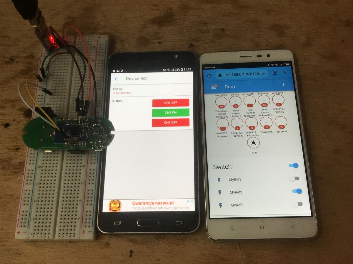

  • Open source firmware was built for the XR809/XR3 WiFi module, turning a door sensor into a Tasmota HTTP and Home Assistant compatible device.
  • The firmware uses the XR809 SDK in C on ARM Cortex-M4F, reuses the built-in shttpd web server, and adds GET handling for status, pairing, reset, and LED control.
  • XR809 runs at 160MHz and provides 384KB SRAM plus 2MB Flash ROM.
  • Tasmota Control and Home Assistant could read the door and button states, and Home Assistant could also switch the onboard LED.
  • The implementation is still early and messy, with buffer-overflow concerns and WiFi resets when batteries were too discharged.
  • Open source firmware for XR809 compatible with Tasmota HTTP/Home Assistant

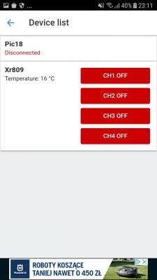

    - our firmware must offer a simple website (both for configuration and for Tasmota HTTP)
    - our firmware must be able to read the state of the button and door opening sensor
    - our firmware must offer pairing and RESET functions (we must be able to somehow enter our WiFi credentials once)

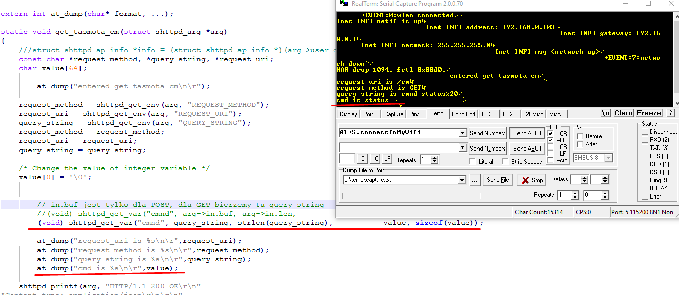

    Tasmota HTTP protocol
    All Tasmota HTTP can be visualized with one GET request sent via HTTP from the client (here: phone from Tasmota Control or machine with Home Assistant) to the server (our XR809 device).
    GET query:
    GET /cm?cmnd=status HTTP/1.1
    Host: 192.168.0.110
    User-Agent: HomeAssistant/2020.12.1 aiohttp/3.7.1 Python/3.8
    Accept: */*
    Accept-Encoding: gzip, deflate
    Sample answer:
    HTTP/1.1 200 OK
    Content-type: application/json
    {"Status":{"Module":0,"DeviceName":"Tasmota","FriendlyName":["Tasmota","Tasmota2","Tasmota3","Tasmota4"],"Topic":"tasmota_EC3F8F","ButtonTopic":"0","Power":0,"PowerOnState":3,"LedState":1,"LedMask":"FFFF","SaveData":1,"SaveState":1,"SwitchTopic":"0","SwitchMode":[0,0,0,0,0,0,0,0],"ButtonRetain":0,"SwitchRetain":0,"SensorRetain":0,"PowerRetain":0},"StatusFWR":{"Version":"0.1(pic18f)","BuildDateTime":"2020-11-07T11:57:45","Boot":6,"Core":"0","SDK":"0","CpuFrequency":80,"Hardware":"ESP8266EX","CR":"367/699"},"StatusNET":{"Hostname":"tasmota_EC3F8F-8079","IPAddress":"192.168.0.50","Gateway":"192.168.0.1","Subnetmask":"255.255.255.0","DNSServer":"192.168.0.1","Mac":"5C:CF:7F:EC:3F:8F","Webserver":2,"WifiConfig":4,"WifiPower":17.0},"StatusSNS":{"Time":"2021-01-10T19:27:53","DS18B20":{ "Temperature":16},"TempUnit":"C"},"StatusSTS":{"Time":"2021-01-10T19:27:54","Uptime":"0T00:41:19","UptimeSec":2479,"Heap":24,"SleepMode":"Dynamic","Sleep":50,"LoadAvg":37,"MqttCount":0,"POWER1":"OFF","POWER2":"OFF","POWER3":"OFF","POWER4":"OFF","Wifi":{"AP":1,"SSId":"5G_FULL_POWER","BSSId":"30:B5:C2:5D:70:72","Channel":9,"RSSI":98,"Signal":-51,"LinkCount":1,"Downtime":"0T00:00:03"}}}
    This answer is in JSON format.
    This is a necessary minimum which allows you to read the status of the device. The state of the device is in two places:
    - Power ": 0 - here the 0 is a bit-coded state of successive relays (or buttons). The number is written as decimal.
    - "POWER1": "OFF", "POWER2": "OFF", "POWER3": "OFF", "POWER4": "OFF", -the relays/states are here repeated, but in a readable format. The number of states is automatically determined from the table ["Tasmota", "Tasmota2", "Tasmota3", "Tasmota4"] .

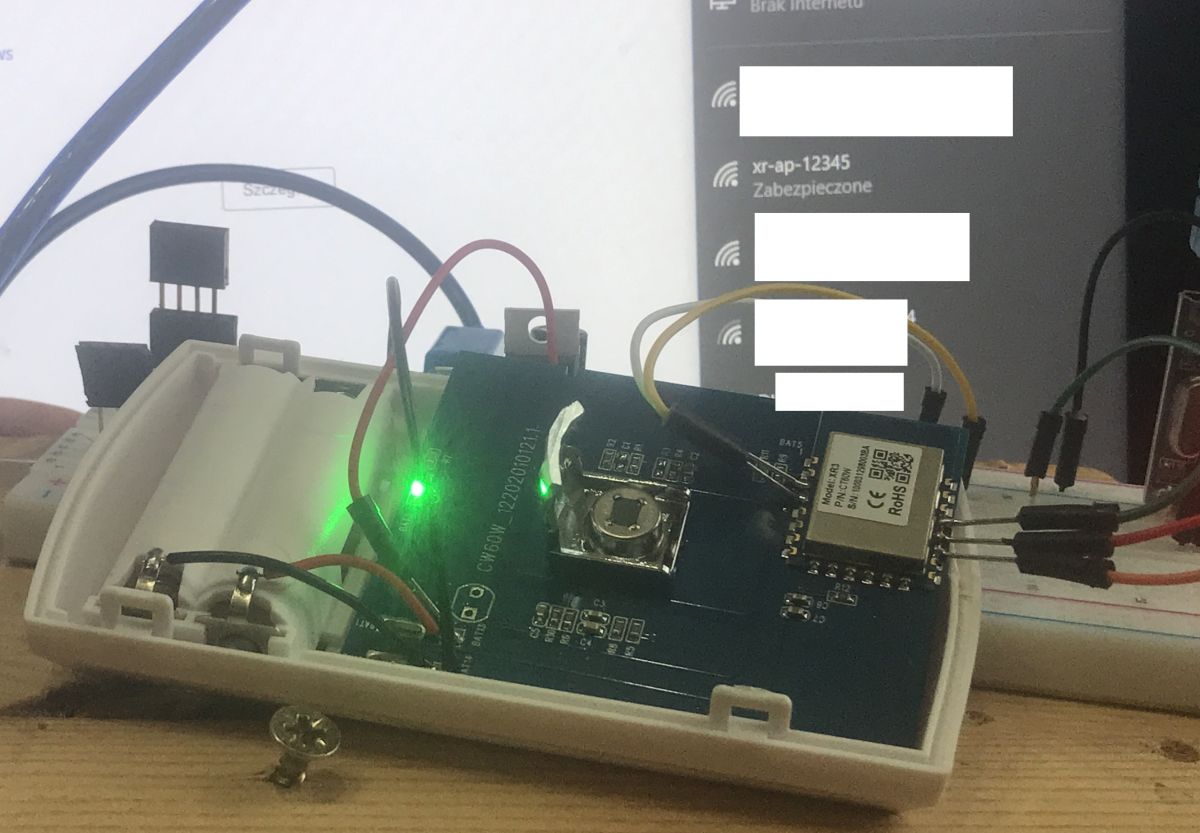

    Hardware connection
    XR809 is programmed via UART just like ESP8266.
    So let's prepare the cheapest dongle, USB TO TTL HW-597 (jumper set 3.3V logical levels):
    Open source firmware for XR809 compatible with Tasmota HTTP/Home Assistant Open source firmware for XR809 compatible with Tasmota HTTP/Home Assistant
    In addition, according to the catalog note:
    datasheet wrote:
    During firmware burning, both PB02 and PB03 need to be connected to a low level. When the module works properly, PB02 and PB03 cannot be connected to a low level
    For this pin EN - otherwise RESET - (to be able to reset the system). The board is battery powered.
    So the connections made:

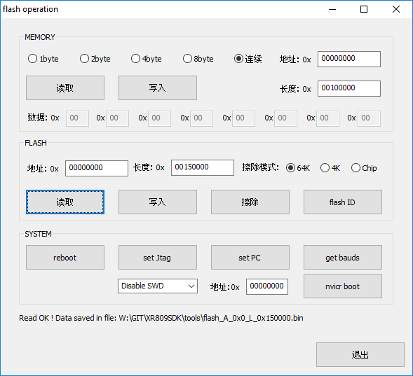

    Burning the XR809 firmware
    The compiled firmware is in file xr_system.img , this can be found in XR809SDK\project\at_demo\image\xr809 .
    Now we need to use the programmer software, phoenixMC.exe
    This program requires that the UART port is not in use, so remember to close the port in Realterm or whatever terminal we are using.
    This phoenixMC.exe has chinese interface, but I figured out how to use it.
    Here are the steps on the GUI (we open the generated img file):
    On the hardware side:
    1. connect RESET to ground
    2. connect PB02 and PB03 to ground
    3. disconnect RESET from ground (it can be in the air)
    In other words, while booting, PB02 and PB03 must be on ground to enter programming mode.

    Then click Burn:
    It should start uploading the firmware:
    Upload ready:

    This command will connect XR809 to our WiFi.
    Does our command work?

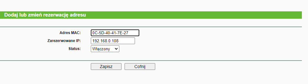

    We can find out about the success of the process from the router logs.
    In addition, it is worth checking if this is the MAC address that XR has (in AT there is a command to know it) and whether the ping command sees it (and ceases to see when we disconnect the power).

    And now the best part - it is now already compatible with Tasmota Control from Google Play.
    https://play.google.com/store/apps/details?id...s_software.TasmotaControl&hl=pl&gl=US
    After adding device by IP, the result in Tasmota Control:
    Of course, all these data are placeholders, i.e. everything is hardcoded.
    Parsing of GET parameters
    For a moment I was wondering why GET parsing is not working for me. This function is responsible for him:
    (void) shttpd_get_var ("cmnd", arg-> in.buf, arg-> in.len, value, sizeof (value));
    For POST it worked.
    But the implementation of the function is self-explanatory.
    Code: C / C++
    arg->in.buf is an argument text buffer for POST, not GET.
    For a GET, it needs to be given a string of GET arguments, like this:
    (void) shttpd_get_var ("cmnd", query_string, strlen (query_string), value, sizeof (value));
    After this change for the query GET /cm?cmnd=status we get:
    This way we can extract the values of the GET arguments.

    First, I will add a website button to change XR809 wifi into an open Access Point.
    The XR website is at src/net/shttpd-1.42/examples/source.h.
    "Reset AP" button added:
    We also need to add GET query support, just as before, this time for path /reset_ap:
    And the function to handle it:
    Code: C / C++
    (I note right away that it would be better to wait 1 second in the main loop and then change the network state, because in the current version we will not get a response to this GET because the XR809 will disconnect immediately)
    After pressing the button, we lose contact with the module and its WiFi network appears:
    After connecting to this network, at IP address 192.168.51.1, we can reconfigure the module:
    Here is our password and SSID (you still have to make the field to be of the password type, but it's not a problem, it's an HTML issue):
    (actually I did not create an open AP here, but an AP with a known SSID and password, but it's the same. You could also add randomization of this "12345" in the SSID so that it includes the MAC for example)

    Fixed IP
    Due to the way Tasmota HTTP works (our device is a server, and we ask for its status), a fixed IP will be useful here. To make things simple, I did it by reserving the IP address for the MAC address on the router:
    This could also be done via a specific host name and DNS.
    Final test with Home Assistant
    Finally, I tested the module from Home Assistant using the Tasmota HTTP support Python scripts described here:
    https://www.elektroda.pl/rtvforum/topic3789324.html
    that is the updated version of this plugin, HTTAS by JiriKursky:
    https://github.com/JiriKursky/httas
    ATTENTION - for the moment httas version from Github will not work with newer Home Assistant versions . This is due to a change in the way coroutines are handled. You will get an error: " ValueError: Coroutine not allowed to be passed to HassJob . "
    Therefore, I recommend downloading my corrected version:
    httas-fixe...210306.zip (6.91 kB)You must be logged in to download this attachment.
    In /config/configuration.yaml I set up the device location:
    Code: YAML
    Then you need to reboot Home Assistant. In my case, it immediately detected XR809 after booting up:
    "MyRel1" here is the door open state, "MyRel2" is the button state, "MyRel3" is the LED state.
    The status of the LED can be changed from the Home Assistant. The other fields are read-only.
    Short demonstration:
    Open source firmware for XR809 compatible with Tasmota HTTP/Home Assistant Open source firmware for XR809 compatible with Tasmota HTTP/Home Assistant Open source firmware for XR809 compatible with Tasmota HTTP/Home Assistant

    5. Add MAC XR809 IP reservation on the DHCP settings of WiFi router (so IP won't change during some network outage or something)

  • XR809 firmware read and flash verified
    #11 19491815
    Posts: 14795
    Rate: 12953
    Today I tested programming and reading the firmware of the @varguit user device.
    Everything works fine.
    I can upload firmware:
    Here are my connections. I used the same wire colors as @varguit. I just didn't have a battery, so I powered it all with 3.3V LDO.
    WiFi from XR809 appears without a problem:
    Reading the (factory) firmware also works:
    I also made OCR of the characters from the program's gui and translated them into English:
    ?? \ - Read?
    ?? - Write?
    ?? - continuous
    ? ? ? ? - by translate to "Eliminate wedge", but that's probably about the size of the buffer
    I can load both Flash and Configuration:
    Sometimes I got "read payload data error", but after a few tries everything was fine
    The loaded firmware can be opened in Notepad ++, of course most of them are not readable, but the text constants in ASCII format can be read. I wonder if IDA PRO would decompile it, I have to try it sometime.
    We can also see the original names of the files with the source code there:
    I attach firmware dumps (before the first pairing)
    memory_A_0...200000.zip (459.76 kB)You must be logged in to download this attachment. flash_A_0x...000000.zip (7.4 MB)You must be logged in to download this attachment.
    PS: @varguit, haven't you tried choosing a lower speed here?
    PS2: Did you pair your device before ripping firmware? Maybe some update broke something?
    PS3: maybe you have too low voltage, are you using new batteries?

    First of all, thanks for buying the same sensor and test it.
    After many trials and errors I still can't flash it.
    Following your information, I also tried reading original firmware first and it works, I get exactly the same result as in the image below:
    I can save the original image, so, I'm pretty sure everything is right on the connections and communications part but it looks like something is wrong when checking the first block. I also tried to remake the xr_system.img, but still no succes. Maybe I have to buy a different UART (mine is very old and windows 10 drivers are not supported)
    PS: right now I am not sure if it works, but have you tried setting lower speed here?
    Yes, I've tried with different speeds, from 9600 to the maximum, always getting the same error.
    PS2: have you paired your device with Tuya before flashing it? as far as I know it should not matter, it's not like tuya-convert, but... I didn't pair mine here. I only paired the door sensor from the first post with tuya before flashing, not the PIR sensor now.
    Yes, it was paired, but I've deleted from the SmartLife app as well. I hope this is not the reason.
    PS3: have you tried new batteries?[/quote]
    Right now, I'm powering it from an arduino, directly to the battery contacts, as you do.
