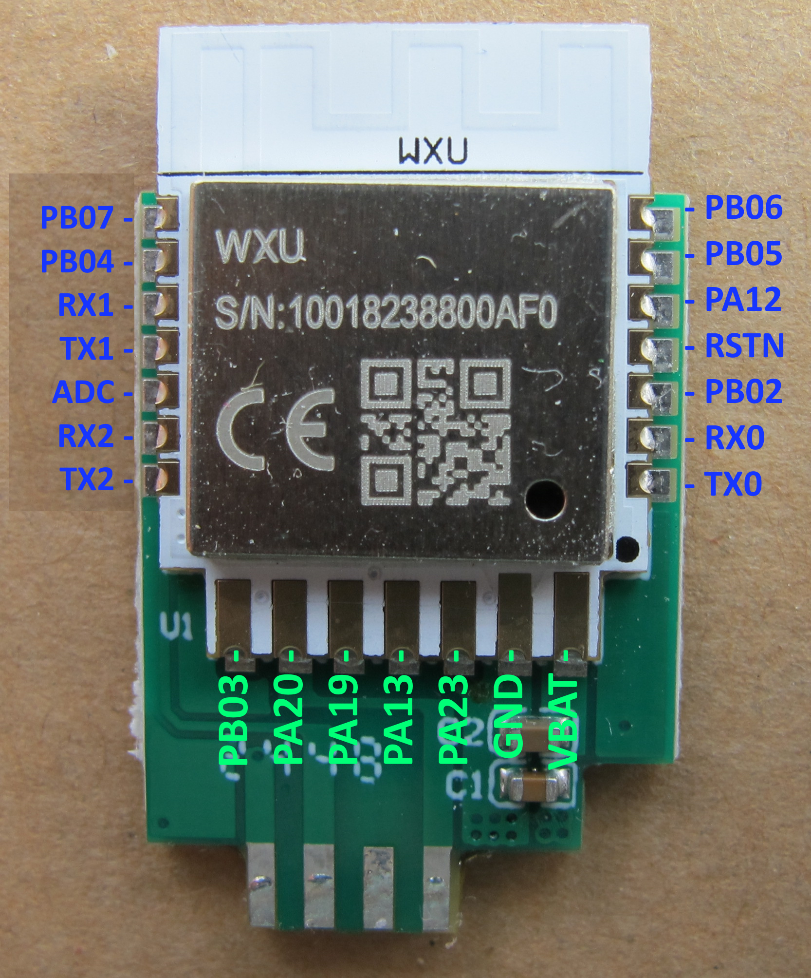

  • Here I will demonstrate how the internal flash of the Xradiotech/Allwinner XR806 (and XR809 - see note at bottom) can be read to file in Windows. Although there is not yet an OpenXR806 cloud-free alternative firmware to use on devices that have the XR806 at heart, flash firmware backups are useful in development and research and for general backup purposes.
    One Tuya module seen in the wild based on XR806 is the WXU (T103C-HL). Also available as WXU-IPEX - datasheets attached.
    To date on Elektroda XR806 has been spotted in:
    Avatto TRV16-WIFI radiator valve
    Avatto SWT60 Smart Watering Timer
    Allwinner development board
    Also: QOTO QT-08W Solar Power Smart Water Valve
    XR806 uses 5mm x 5mm QFN40 package and 4mm x 4mm QFN32 packages for different feature lists.
    Pin layout diagram of the XR806 chip by Xradiotech Pin diagram for XR806 BM2I Diagram of XRADIO XR806 chip with pin labels.
    Table showing GPIO multiplexing for XR806Bxxx.
    To get into UART download mode PB02 needs to be pulled to ground at power-on.
    on the WXU PB02 is the 3rd pad up from the bottom on the right-hand side of the module as you look at the top
    Schematic of an integrated circuit with GPIO and UART connections.
    or from the bottom:
    Diagram of electronic circuit pins with labels.
    and again from the top with WXU shown mounted on PCB from TRV16, which I will also use to demonstrate flash backup
    Backup & Restore of Xradiotech/Allwinner XR806/XR809 Flash in Windows: Guide & Demonstration
    Soldering can be performed direct to WXU contacts or, in the case of this WXU on PCB from TRV16, I have chosen to solder to the breakout pads instead for all but PB02.
    Electronic module with markings and QR code Printed circuit board with labels and connectors.
    Electronic module with wires on a blue mat. Green PCB with attached colored wires against a keyboard background.
    USB-TTL RX -> XR806 TX
    USB-TTL TX -> XR806 RX
    3.3V -> XR806 VBAT
    USB-TTL GND -> PSU GND -> XR806 GND

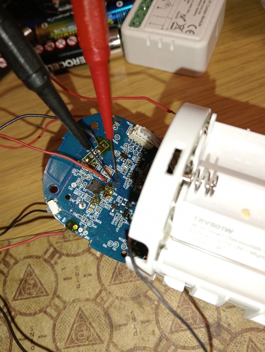

  • TRV801W UART0, UART2 and XR806 reset pads identified
    #6 21745828
    jmkrzyszt
    Posts: 40
    >>21745815
    Boot log from 1.18.128 looks almost the same as 1.18.207, there is only one difference, last number in one line before the last, which is now 0x2200d0.
    Added after 34 [minutes]:
    For those who may want to play with TRV801W:
    Probe tips touching PCB of TRV501W electronic thermostat
    Red probe is UART0 TX, black probe -- UART0 RX. A pad beside the black probe with a red wire soldered to it is PB02 (connect to GND for flashing).
    4 pads at the bootom edge belong to UART2 (there is a red wire connected to its Vdd pad). Behind the probes there are 5 pads (with a black wire hanging of pad 4 -- GND) described as if that was an UART.  I thought that might be UART0 but that occurred not the case, maybe those are connected somehow to Tuya MCU. The 5th, rightmost pad is described as RST and it apparently resets the Tuya MCU, not the XR806. For XR806 reset, a pad connected to its CHIP_PWD pin can be found at ca. half of the distance between the probes and the Vdd wire, there is a bank of resistors/capacitors there, one is missing, and that's the pad closer to the chip.

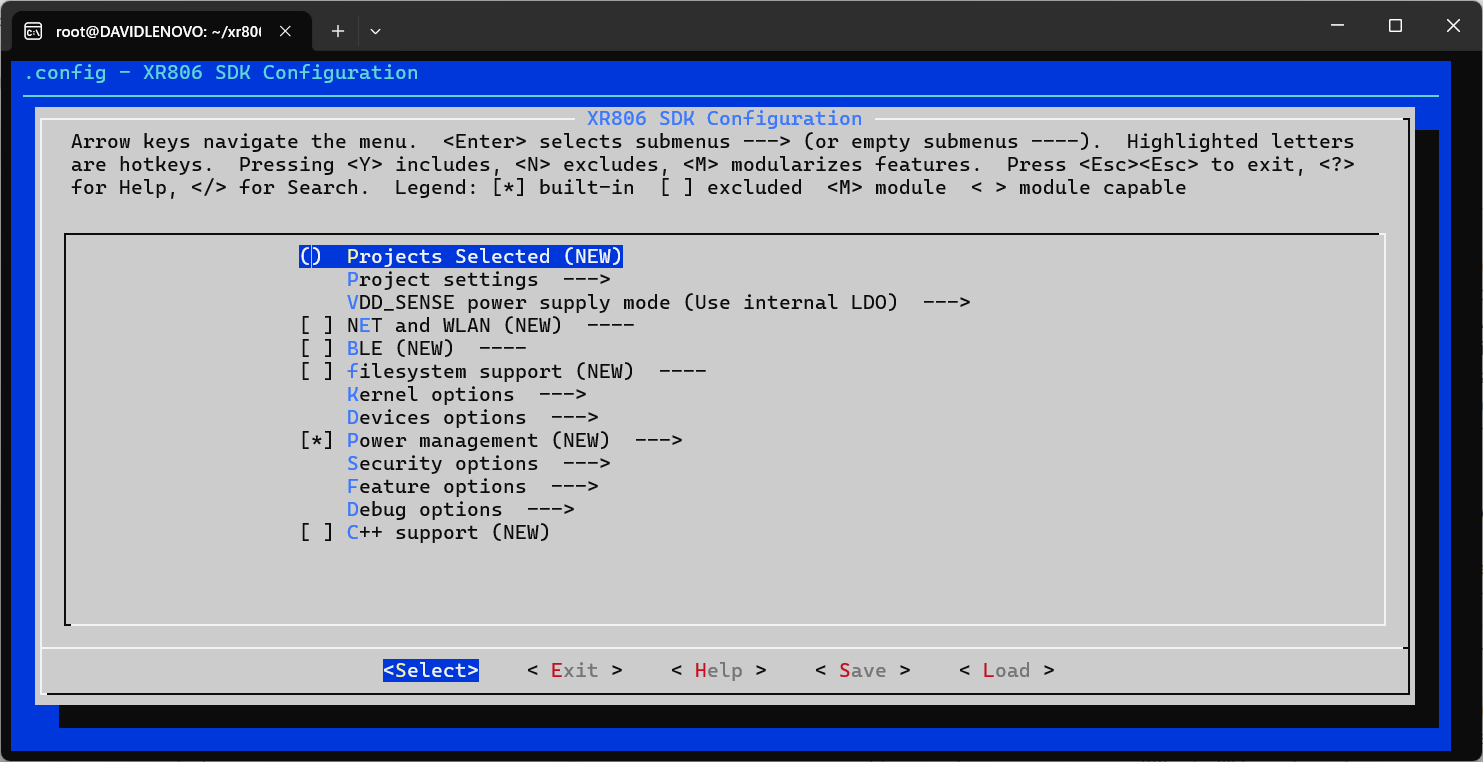

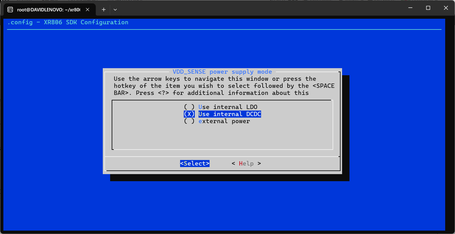

  • Setting VDD_SENSE mode in SDK menuconfig
    #25 21779851
    Posts: 5195
    Help: 446
    Rate: 913
    im just messing with the SDK. if we run make menuconfig in the SDK root we can set the VDD_SENSE mode
    XR806 SDK configuration screen with Projects Selected (NEW) highlighted
    XR806 SDK configuration window with Use internal DCDC selected
    then the saved config looks like this in the .config file when we grep CONFIG_PWR .config

    to change xtal. 32M selected
