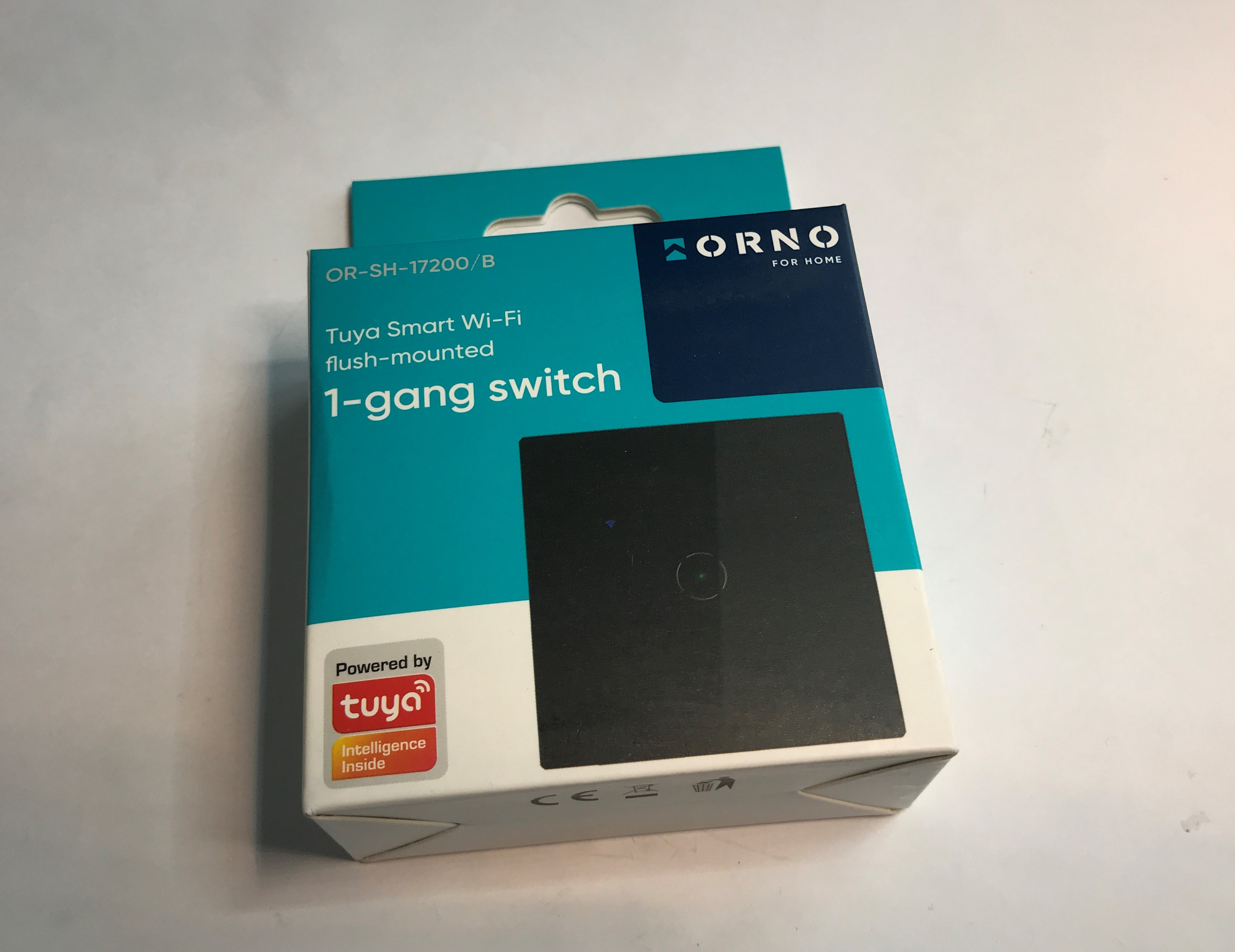

The Orno OR-SH-17200 WiFi Tuya single switch is another product that can be easily freed from the cloud and connected to the Home Assistant. What's more, inside it you will find a CBU module based on the BK7231N, which allows various interesting modifications after changing its firmware. Unlike the CB3S and WB3S, it can even easily handle WS2812 LEDs! Here I will show just the inside of such a switch and demonstrate how to change its firmware.
The unit shown comes in various configurations and colours - we have a white and black option. You can also get it in double and triple versions. The kit comes with a switch (its dimensions are 86x86x35mm), two mounting screws for the box and instructions:
The unit requires a neutral wire for operation.
Here are pictures of the installation instructions and pairing with Tuya. The pairing with Tuya is of no use to me as I am changing the software of this equipment to my own.
Wi-Fi TUYA switch instruction sheet with wiring diagram and technical data .
