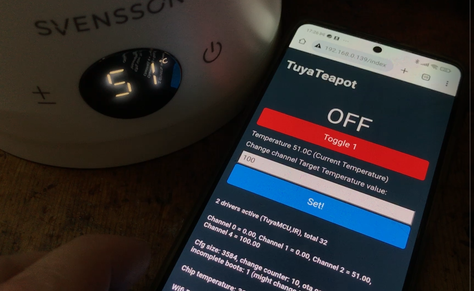

Svensson SMART06B kettle shows 51°C, next to a smartphone running TuyaTeapot app. .
The Svensson SMART06B is a remote-controlled electric kettle compatible with the Tuya app. It offers control over temperature and heating time. Here I will show how its firmware can be changed to make it compatible with Home Assistant. This will also result in it being cut off from the cloud, i.e. we will gain privacy and security.

I found the target temperature in the same way - for it I chose the form of the entry field.
OBK interface showing current and target temperature with relay control button TuyaMCU logs showing DP data, with highlighted field indicating target temperature value .
The whole thing appears to be working:
