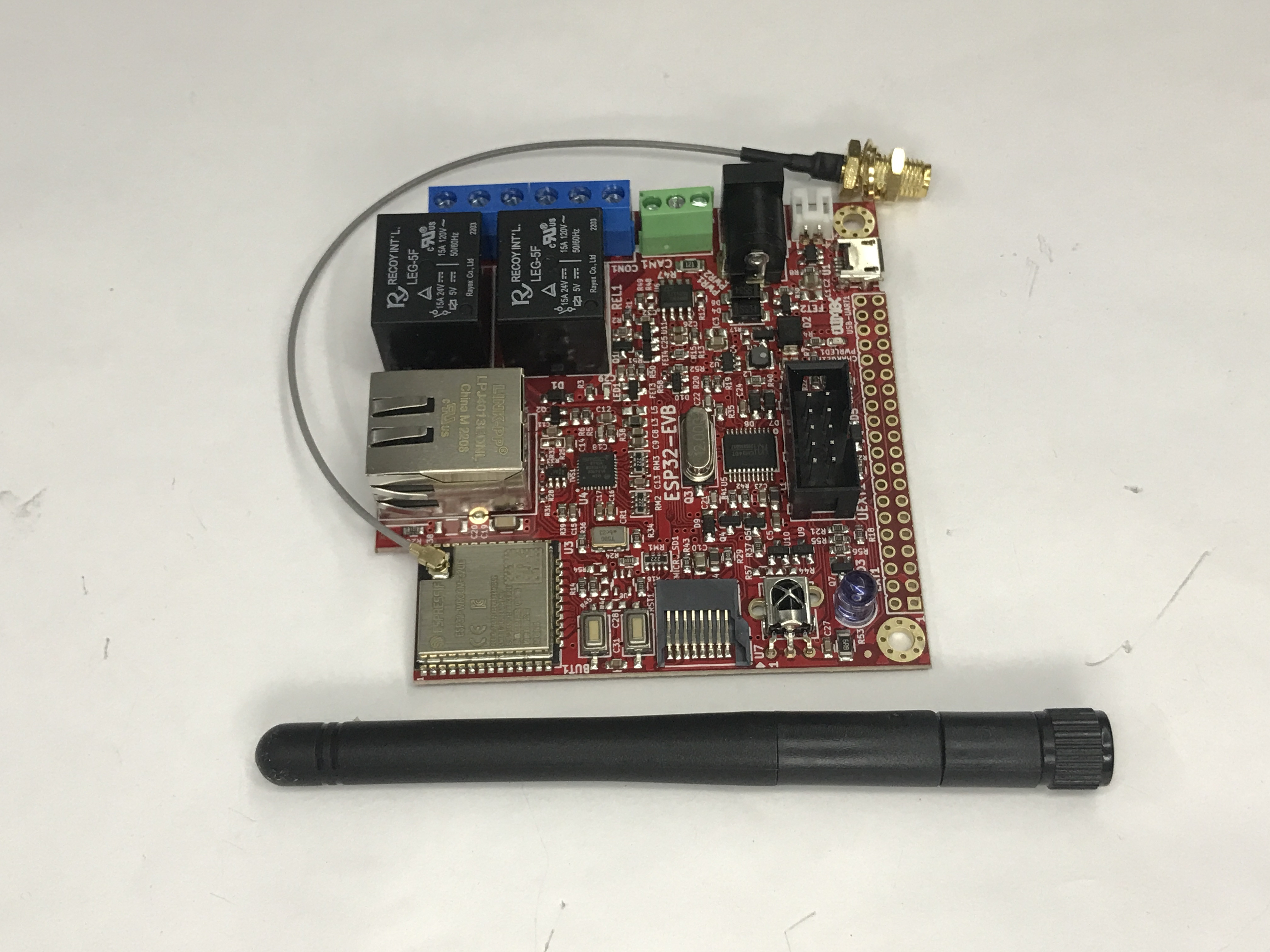

I would like to invite you to a presentation and launch of a fully open source ESP32 development board from Olimex. Everything is available for this project - you can even download the PCB design in KiCad and customise it to your needs. The ESP32-EVB features the ESP32-WROOM-32E Wi-Fi/BT module, an additional LAN8710A wired Ethernet controller, LiPo battery capability thanks to the TP4054 controller, a built-in CAN transceiver, two relays, a USB to UART converter (for programming, among other things), a microSD card slot, an IR transmitter and receiver, and abundant connectors, including Olimex's UEXT to connect additional peripherals.

It came with an antenna and three plastic non-slip feet. Apparently the price is quite high, but maybe it's worth it? Especially since the manufacturer plays open cards - everything is made available.

However, I had a bit of a problem with just getting the LAN up and running. I tried various ways, but it was only when I modified the example to manually reset the controller with a sufficiently long delay that communication started. In this configuration the communication works even when powered by a long USB cable. For verification on Ethernet, I put up a simple "hello world" page that downloads fully over the cable - no Wi-Fi.

How do I rate this tile? Undoubtedly a lot can be done on it, although the price is quite high compared to the simplest base USB to UART + ESP32 converter connections such as the NodeMCU-32S. I certainly praise the variety of projects that can be realised with it - we have relays, we have IR, and there is even an option to connect a microSD card or there CAN bus. In addition, there are ready-made libraries for everything - there were no major problems at all getting the wired Ethernet up and running.
Of the downsides of this board, I guess I could mention a potentially long list of issues from GitHub, although personally I haven't come across any of these problems yet. Additionally, I would have preferred that this 40-pin connector be replaced with something that is better described, and more accurately described on the description layer so that I know at a glance in advance which pin is which - this is just more convenient for me.
