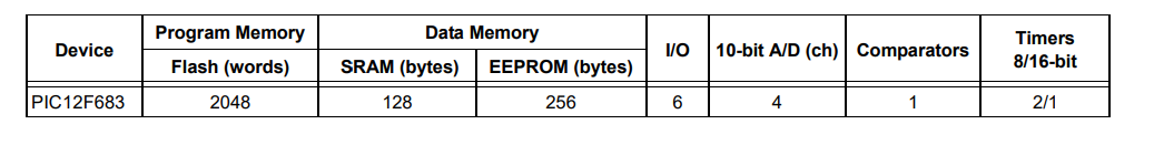

    2048 bytes of Flash for instructions and fixed data, 128 bytes of RAM for variables.... that's not a lot of memory, but it should be enough for a dimmer. The worse thing is that we only have one PWM, and I want to handle two strips:

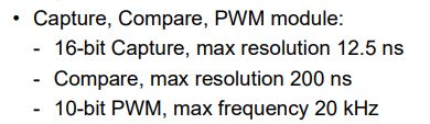

    I will undoubtedly implement the PWM programmatically, via GPIO operations.

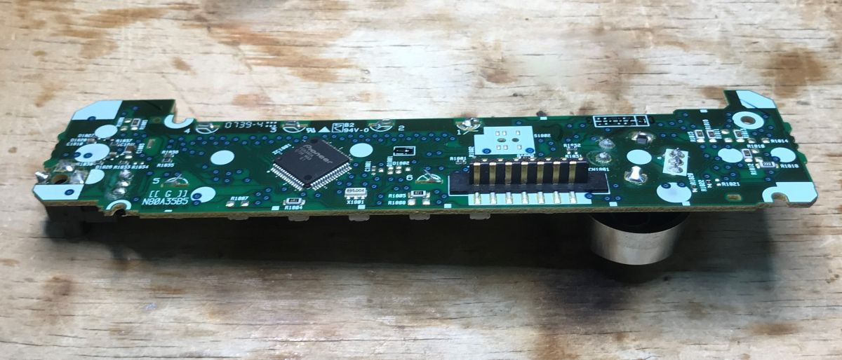

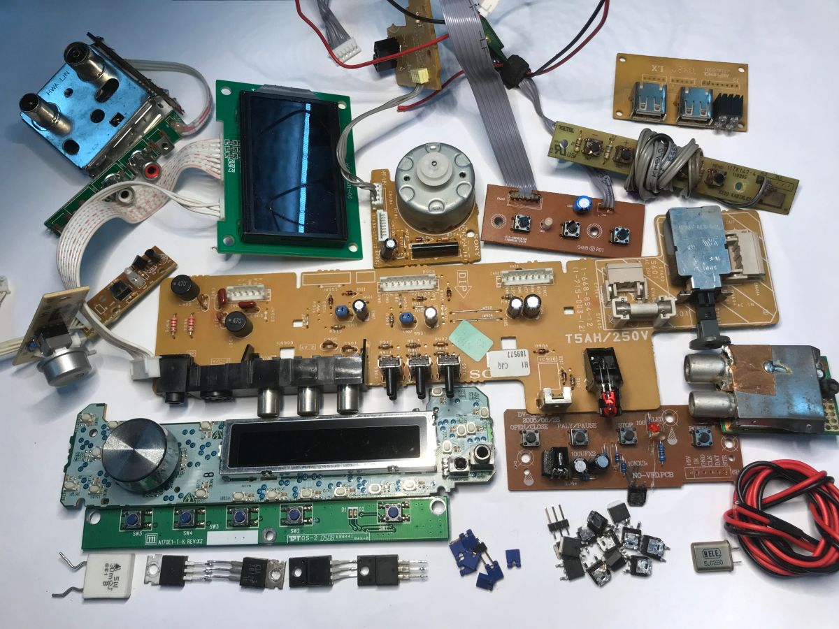

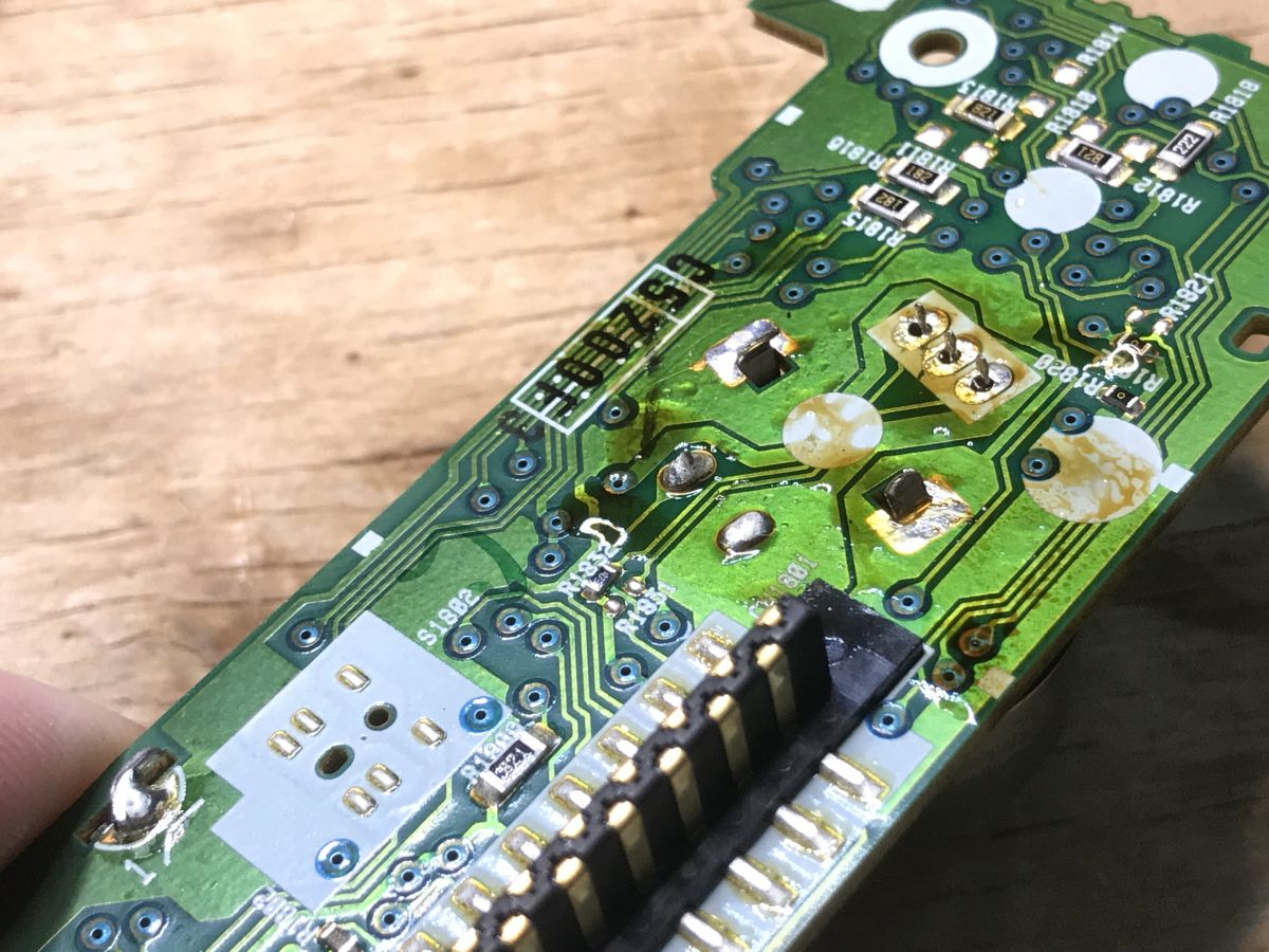

    I try to base my builds on parts from electrical junk, so I started with my collection of selected circuit boards:
    PIC12F683 - two-channel dimmer and encoder support on 128 bytes of RAM

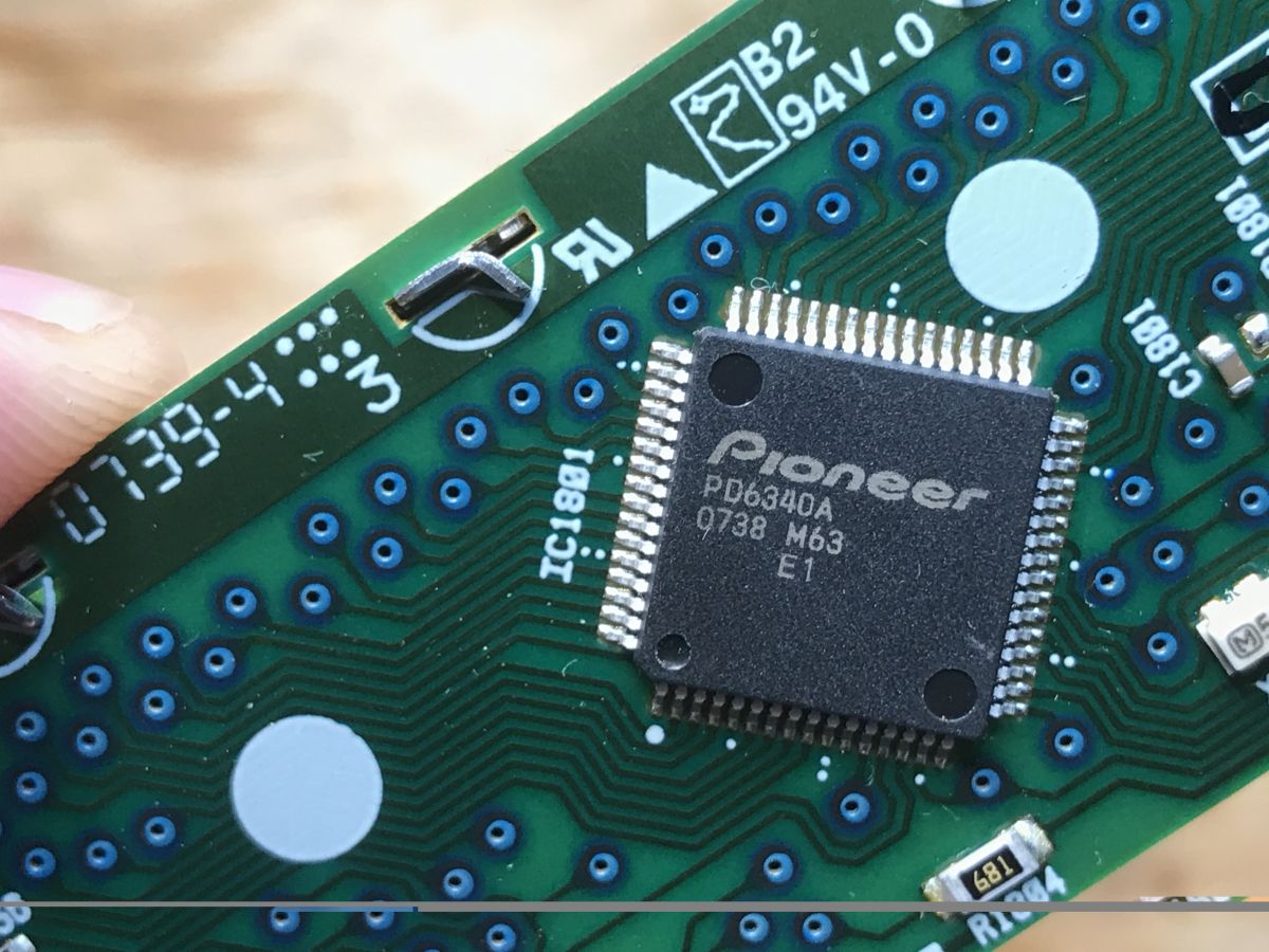

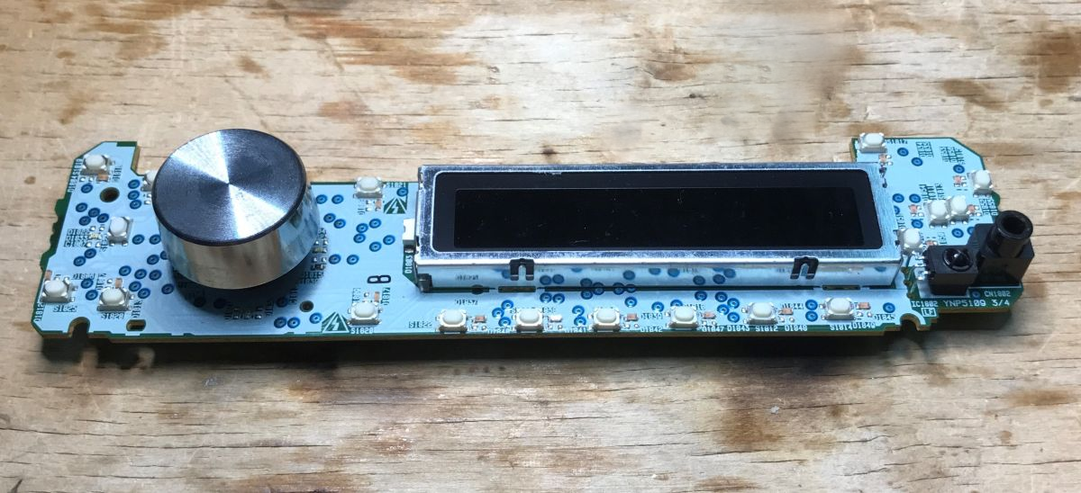

    A module from a car radio caught my eye. There is a display, a controller and encoder:
    PIC12F683 - two-channel dimmer and encoder support on 128 bytes of RAM PIC12F683 - two-channel dimmer and encoder support on 128 bytes of RAM
    The controller is a PD6340A. I could not find its datasheet online, although I did find a diagram of the radio. It is connected to the main controller by some strange two-pin protocol.

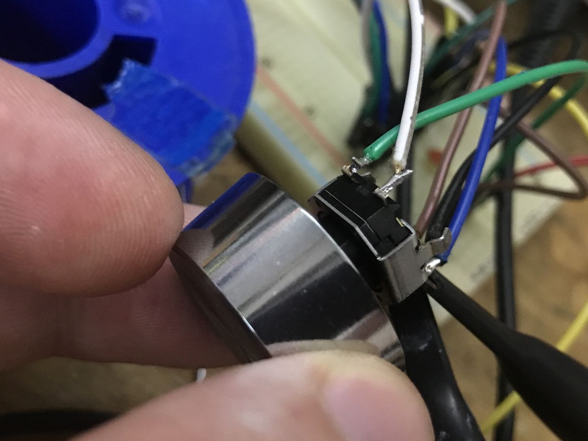

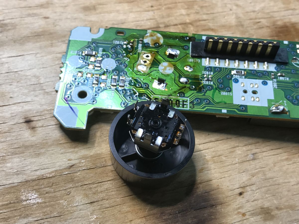

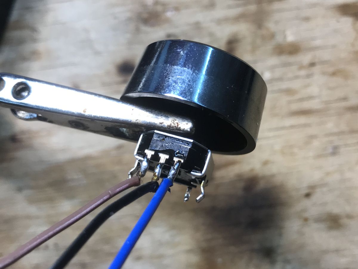

    I soldered the encoder using flux and braid - I apply flux to the solder, then press the braid to the solder with a hot tip. The braid collects the solder from the pads. Then I pull the component out, still helping myself with the soldering iron, as not all the binder will always collect.
    I then specified the encoder leads.
    Here we have:
    - the encoder proper - that is, the "infinite potentiometer", whose outputs are three pins - ground and two signals, these three legs. I have whittled them down and added wires:
    - an extra button - simply pressing the encoder short circuits the circuit

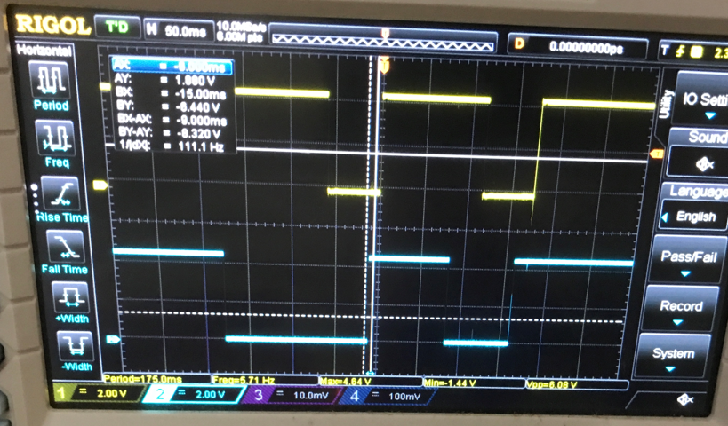

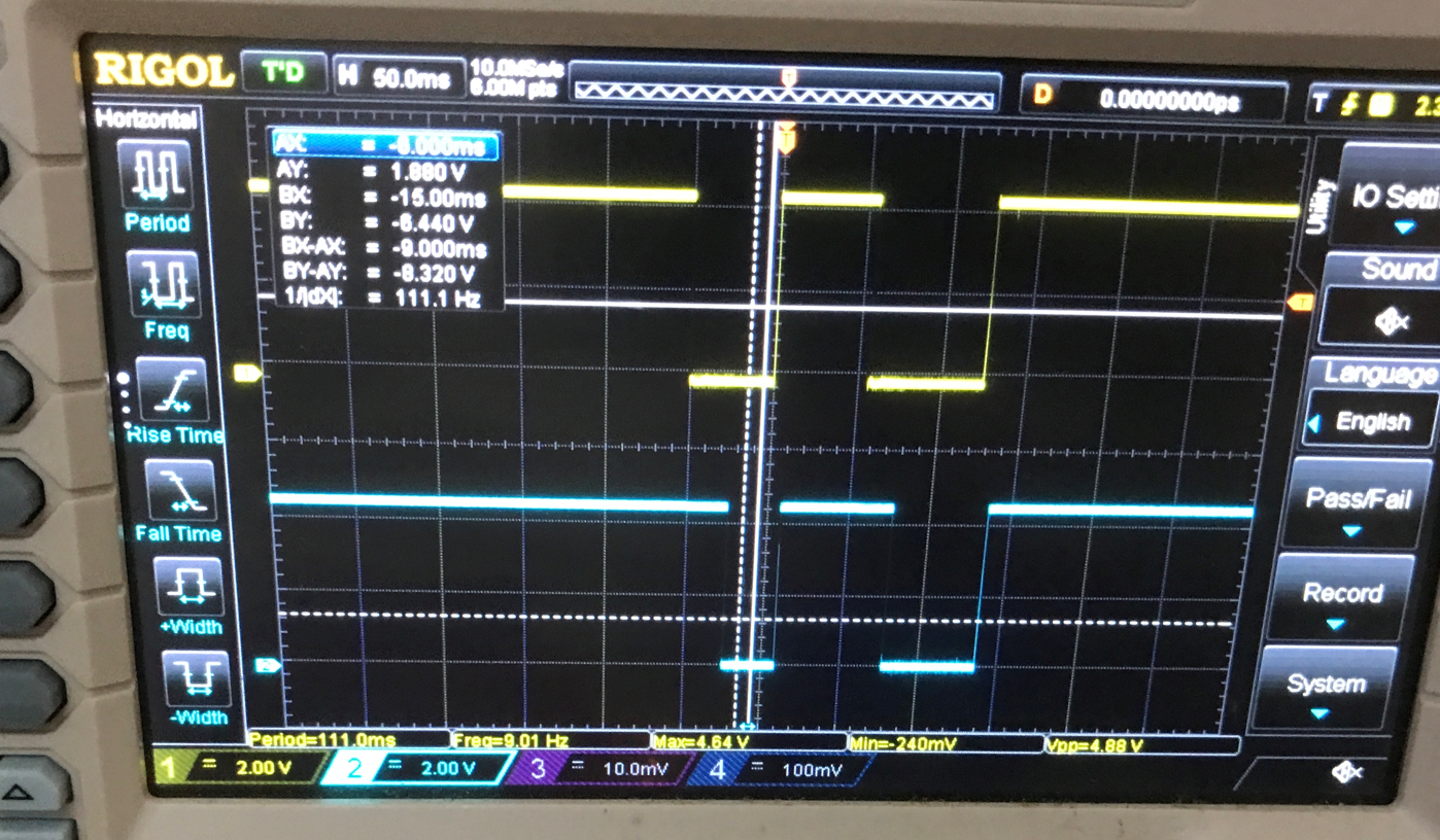

    Effect of encoder on oscilloscope
    I pulled up both outputs (extreme legs) of the encoder to the power supply via 10 kΩ resistors. I connected the middle leg to ground. I connected the oscilloscope probes to the outputs. Let's observe what happens on them.
    Turning clockwise:
    The low state first appears on channel one (yellow waveform).
    Turning left:
    The low state first appears on channel two (blue waveform).
    If there is no movement, we still have a high state on both outputs.
    We already have a stopping point - it still needs to be detected. Let's assume that we sample fast enough. When there is no movement, both digital pins will return 11, but when movement starts we get 10 or 01, depending on which way the encoder is turned.
    So many more of these states - as we have 2 pins (2 bits), we have 2^2 = 4 possible states. Additionally, we want to examine the state before and after, so we have two snapshots of 2 bits each, for a total of 2^3 = 8 possibilities.
    We decompose according to the oscilloscope transitions for the movement (let's assume) to the right:
    - 0b00 -> 0b01
    - 0b01 -> 0b11
    - 0b11 -> 0b10
    - 0b10 -> 0b00
    Any other transition means movement in the opposite direction, except for no change.

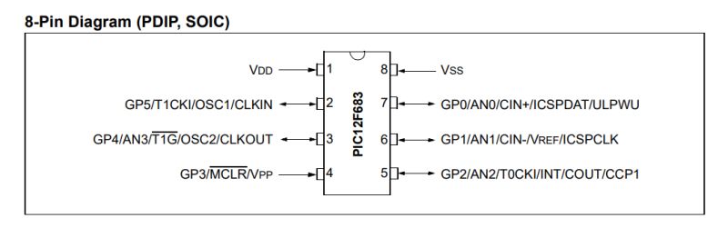

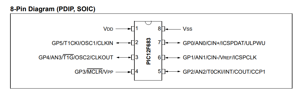

    First we include the header of the PIC used and set its configuration - internal oscillator, no watchdog.
    Code: C / C++
    Then we boot the PIC, disable the anolog pins and comparators, initialise the pin mode (two inputs - TRISIO), set the internal oscillator (OSCCON), enable the built-in pull up resistors (OPTION_REG and WPU - to set the default high state on the encoder outputs) and initialise the variables with their initial values.

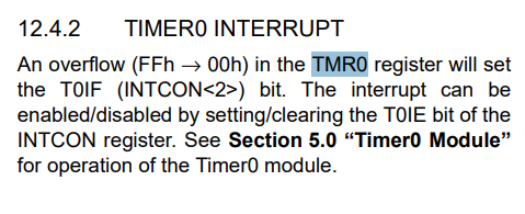

    Flipping the dimmer to timer
    The second necessary fix is to move the dimmer operation to a hardware timer. Such a timer can run at a frequency we specify and call an interrupt where we handle the software PWM creation. I can't just use an off-the-shelf PWM here, because this PIC only has one hardware PWM (based on CCP1).

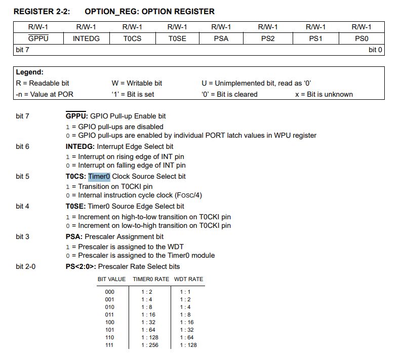

    What needs to be done to start Timer0 with an interrupt?
    First we set bit 5 (Timer 0 clock source) and bits 2-1 (prescaler) in OPTION_REG:

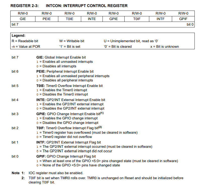

    We then enable general interrupts and Timer 0 overflow interrupts in INTCON:
    You still need to set the value of TMR0, which is the one that will be counted down. The interrupt will be called when 0xFF - > 0x00 of this value is overflowed.
    Personally, I wanted a reasonably fast interrupt, so I selected a 1:1 prescaler, so since Timer0 goes at Fosc/4, TMR0 is incremented at 2 MHz. Now all we need to do is select the value of TMR0 so that our interrupt calls at about 50 kHz. This is because I have 50 degrees of brightness (DIMMER_MAX) and I want about 1 kHz at the output. I can always reduce DIMMER_MAX significantly if I need to and relieve the CPU.
    The last thing to remember is to reset TMR0 to the desired value in the interrupt and to clear the timer interrupt flag.

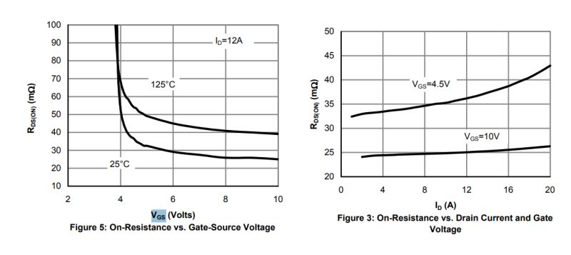

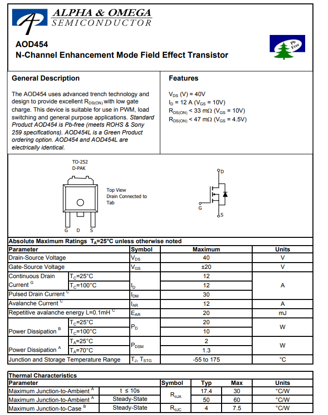

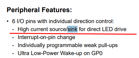

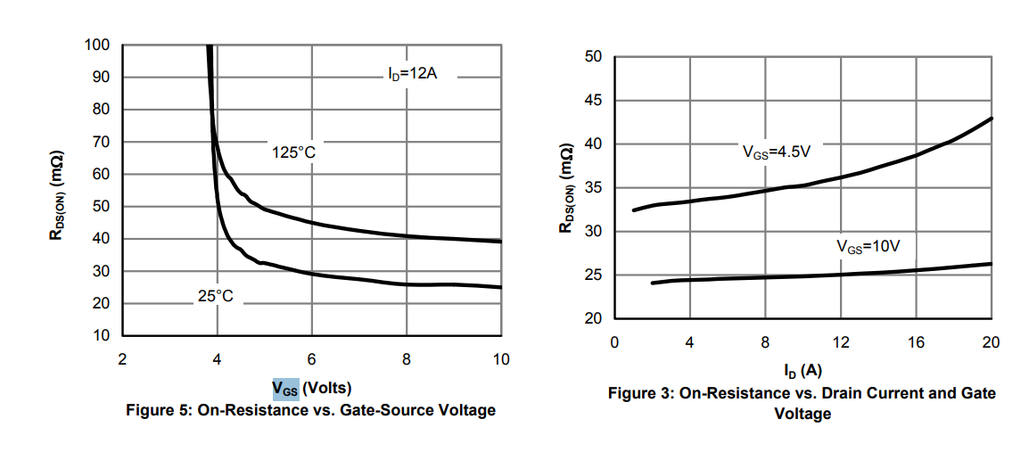

    Transistor selection
    Often when dismantling various electrical junk, I solder and put away transistors. Before soldering, I check their parameters to collect what I can use. One day a couple of D454s, actually AOD454s, ended up in the inverter from the monitor backlight.
    This is an N-type channel MOSFET with a fairly high drain current (12 A at Vgs=10) and low resistance in the open state. The PIC12F would control it directly from its pins (more precisely: via a resistor), so the gate voltage would be 5 V. The datasheet note shows that at Vgs=5 V, Rds(on) is 47 mΩ, which is an acceptable value. Not every transistor can be driven from such a low voltage. For the detailed behaviour of the transistor, refer to the graphs in the datasheet note.
    This is, of course, a considerable simplification, but in such a simple case my choice worked.

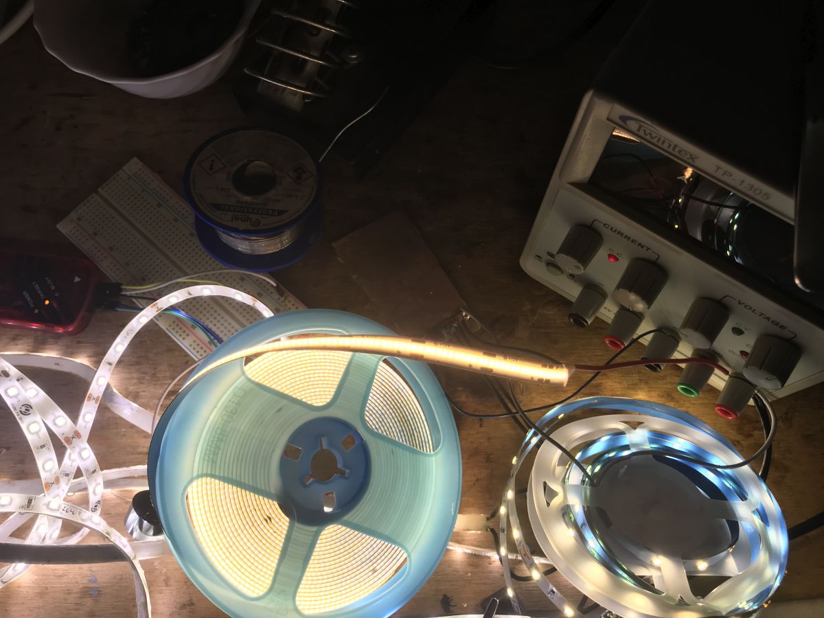

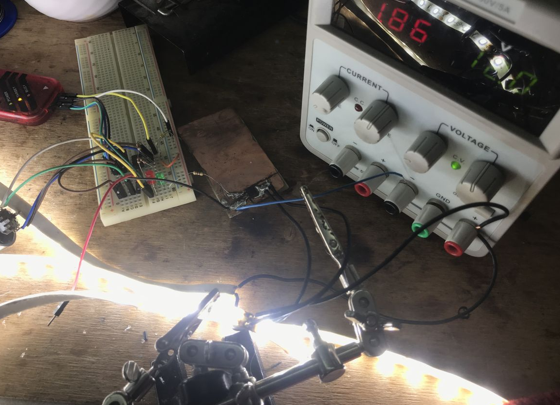

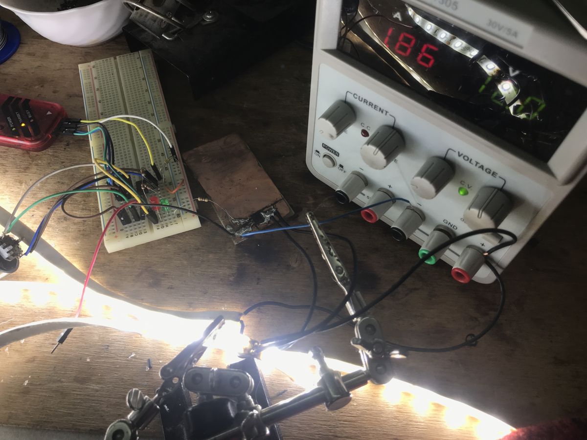

    Tests with LED strip

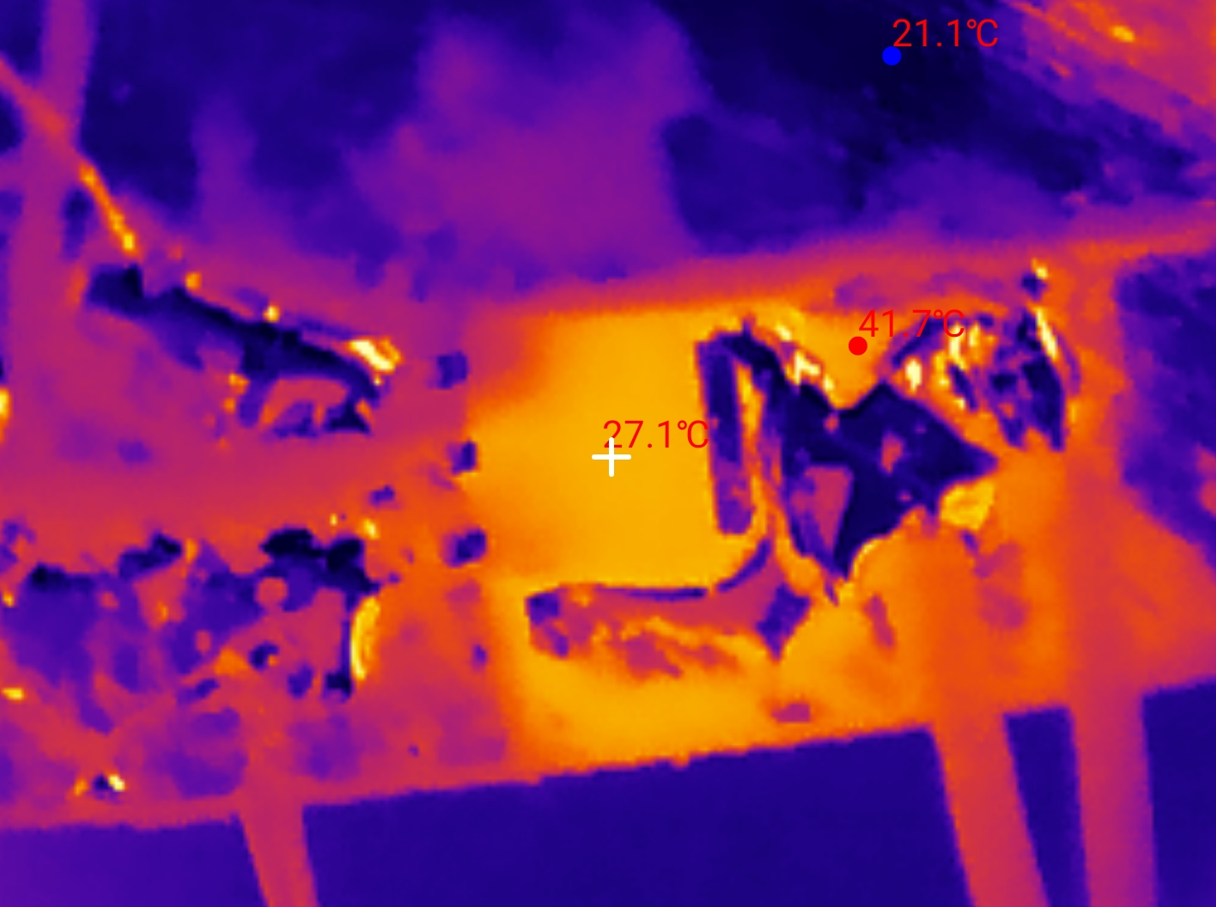

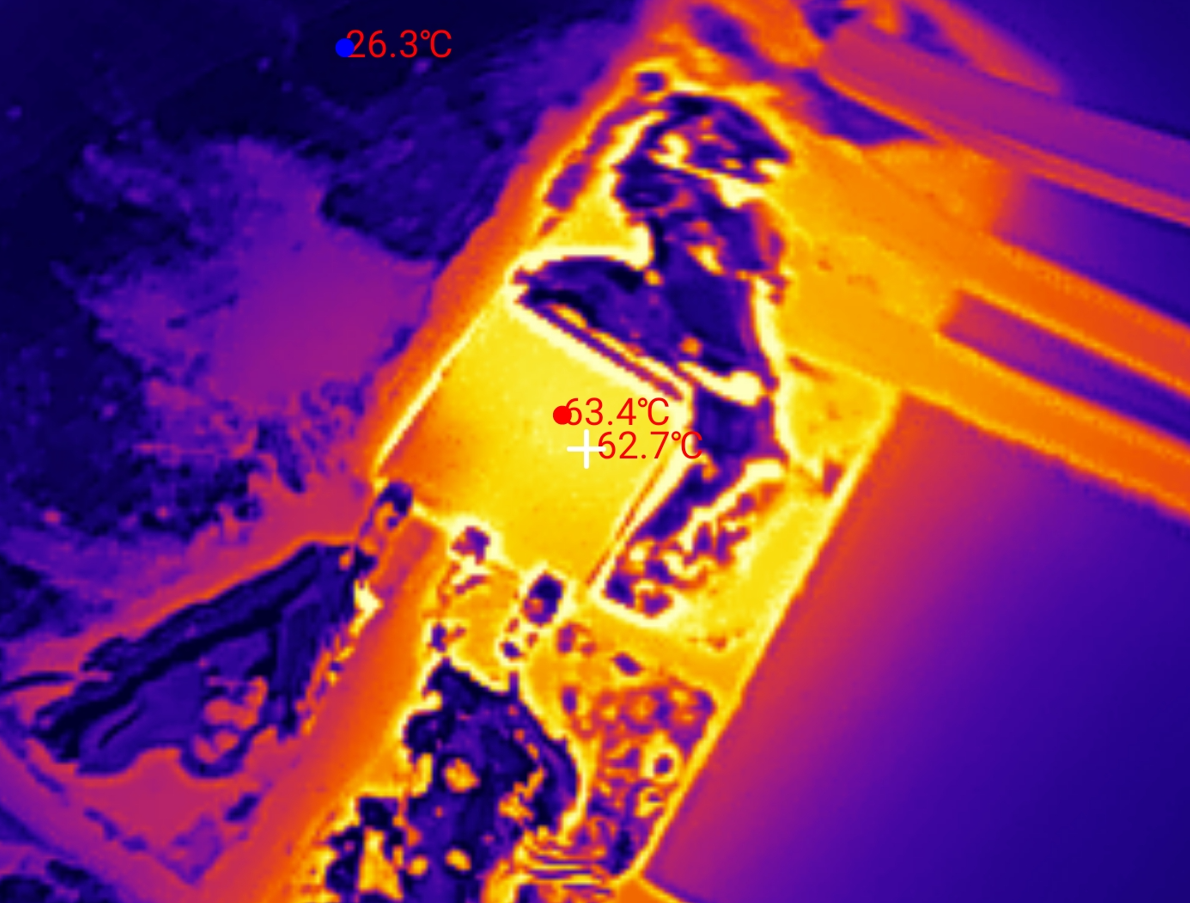

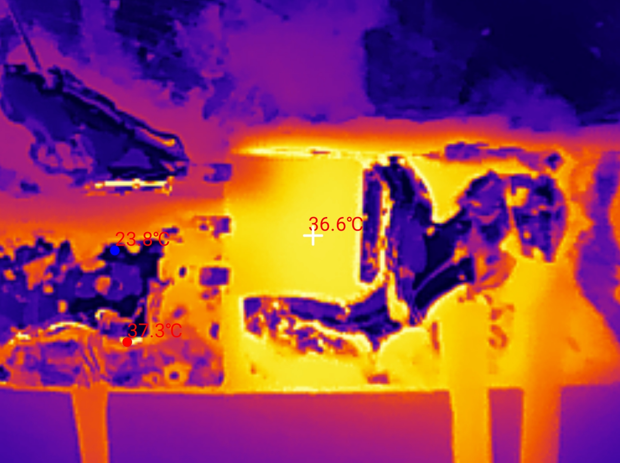

    I wanted to check how much my transistor would heat up. Choosing a transistor along with a gate resistor is not a trivial matter and far beyond the subject of this short PIC presentation so I wasn't expecting sensational results, but I still had to see if it would work at all.
    The transistor was soldered onto a small piece of copper-coated laminate, so heat dissipation was quite reduced, but maybe that's better - you can always improve performance.
    I tested everything with a laboratory power supply at 12 volts, attaching more LED strips to increase the load.
    By the way, I advise you against testing LED strips this way, even the rollers bend from the heat, the adhesive layer under the strip also degrades.
    At a load of 0.66 A, the transistor is cold. This 40 °C is only due to reflection in the binder.
    At a load of 1.85 A the transistor only starts to heat up, it reaches just under 30 °C.
    At a load of 2.9 A, the transistor exceeds 35 °C.
    At a load of 5.1 A, the transistor reaches 65 °C.
    Probably if only some heatsink were added, the temperature would drop even further.
    The results are fully satisfactory to me.

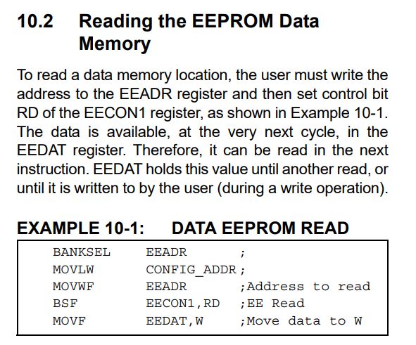

    Write to internal EEPROM
    One shortcoming remains. The dimmer now forgets its setting when it is powered off. Most of the time this is not a problem, as we tend to assume that the PIC is powered all the time, but some people may have occasional power outages and it is not desirable for the dimmer to forget its setting then.
    In the case of very short power outages, one could combine and give extra capacitors on the PIC's power line, but this is unlikely to make sense in the long run.

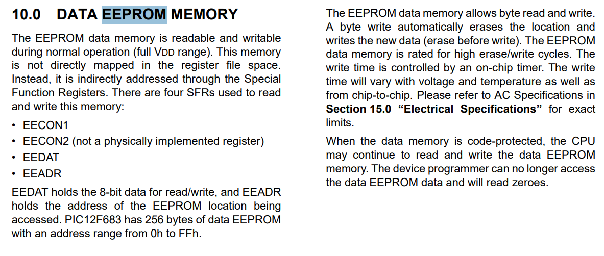

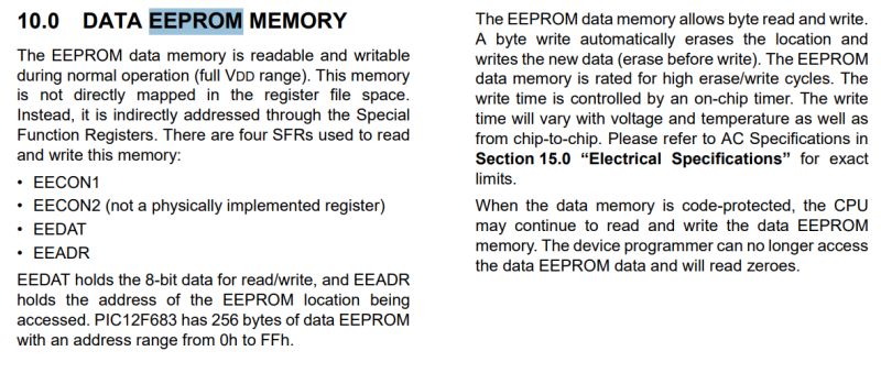

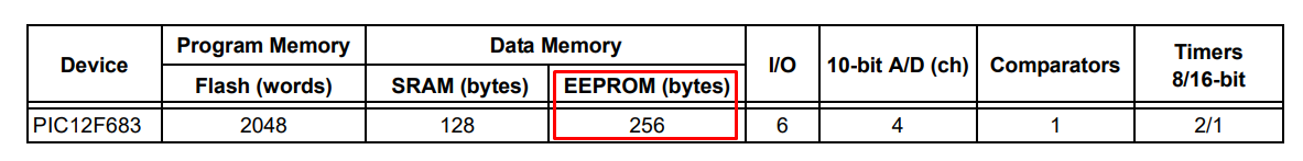

    Fortunately, our tiny PIC has a whole 256 bytes of non-volatile EEPROM:

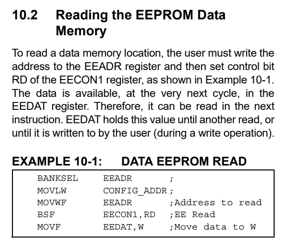

    The embedded EEPROM is controlled by several registers with names starting with EE:
    EEDAT stores the data byte, EEADR its address. EECON1 controls memory operations.

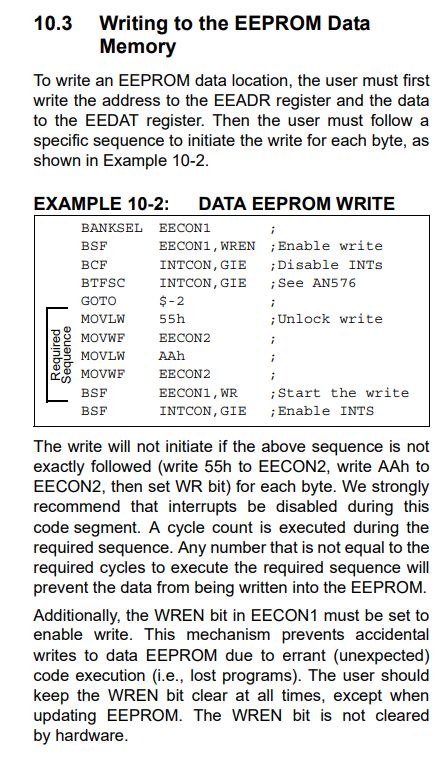

    Write and read operations are also described in the data note.
    Reading is the simplest - simply set the address, RD bit and then read the data.

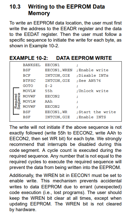

    Writing is similar, but slightly more difficult - we enable the write, disable the interrupts, and then send the magic 0x55 0xAA values, and only then start the write and wait for it to succeed.
    I only need to do the read once after the MCU starts, I do the write with each change.
    Code: C / C++

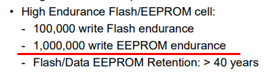

    Optimising EEPROM consumption
    Recording with each change is not an optimal approach. By rotating the encoder we will have a lot of these changes, after all, with 50 brightness levels here we have a good 50 records. This will wear out the EEPROM faster, although with its robustness, it can be solidly argued that it really does take a lot of such 'dimming' cycles to damage it:
    Nevertheless, I will give a simple way how this could be improved. You simply need to reduce the number of writes - you could, for example, save when the user finishes an operation. The question arises how to detect this - probably the easiest way is to reset the cycle counter to a given fixed value when the brightness level changes, and keep decreasing it in the background as long as it is not zero. When it reaches zero after decreasing, then we make a save.

    How much will be the load on the output of the PIC in full brightness state?
    How much will the diode current be in the full brightness state?

    @androot Good idea with the interruptions, I'll try to present it too.
    What specifically are you getting at? Measuring quickly, one LED chain above the window at my place needs 1.5 A at the highest brightness. The one in the kitchen not much less, 1 A. These types of currents at my place are.

  • PIC12F683 resources used in the project: 2048 bytes Flash, 128 bytes RAM, 1 hardware PWM, and 256 bytes EEPROM for saved brightness settings. [#21881566]

  • Measured AOD454 MOSFET temperatures stayed modest in testing: about 30 °C at 1.85 A, above 35 °C at 2.9 A, and about 65 °C at 5.1 A on a small copper-clad board. [#21881566]
The PIC output does not carry the LED strip load current at full brightness; it only drives the MOSFET gate, stated as direct control from the pin "via a resistor." The heavy current flows through the AOD454 and the 12 V LED strip path instead. In the tested design, the load reached as much as 5.1 A, but that was the switched strip current, not PIC GPIO output current. [#21881566]
At full brightness, the LED current is the strip load current set by the connected 12 V strip sections, not a current defined by the PIC pin. The thread does not give a per-diode figure, but it does give measured total load points of 0.66 A, 1.85 A, 2.9 A, and 5.1 A during strip testing. Those values describe the current through the strip and MOSFET in real operation. [#21881566]
Why was the AOD454 MOSFET chosen for switching 12 V LED strips from a PIC12F683, and how do you check whether 5 V gate drive is sufficient?
It was chosen because it is an N-channel MOSFET with high current capability and low on-resistance at gate voltages the PIC can provide. The thread cites about 12 A at Vgs = 10 V and about 47 mΩ Rds(on) at Vgs = 5 V, which makes direct 5 V gate drive acceptable here. The correct check is simple: confirm the datasheet includes a low Rds(on) value at 5 V, not only at 10 V. [#21881566]
What temperature rise is acceptable for an AOD454 MOSFET when dimming LED strips at currents like 0.66 A, 1.85 A, 2.9 A, and 5.1 A?
The thread's test results show acceptable heating for this build: effectively cool at 0.66 A, about 30 °C at 1.85 A, above 35 °C at 2.9 A, and about 65 °C at 5.1 A. Those measurements were taken with the MOSFET mounted on a small copper-clad laminate piece, not a substantial heatsink. That makes 65 °C at 5.1 A a useful upper practical reference for this exact implementation. [#21881566]
